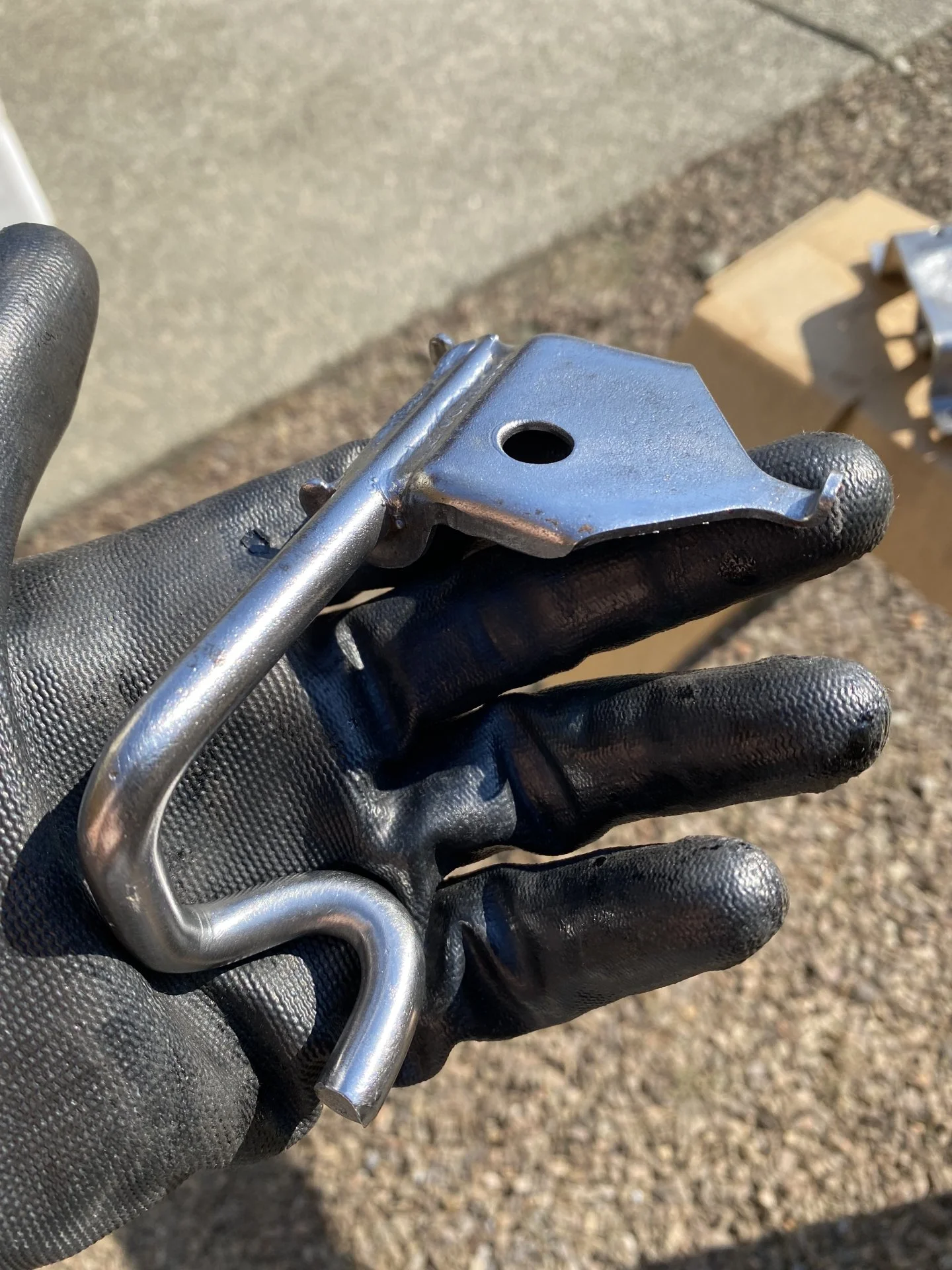

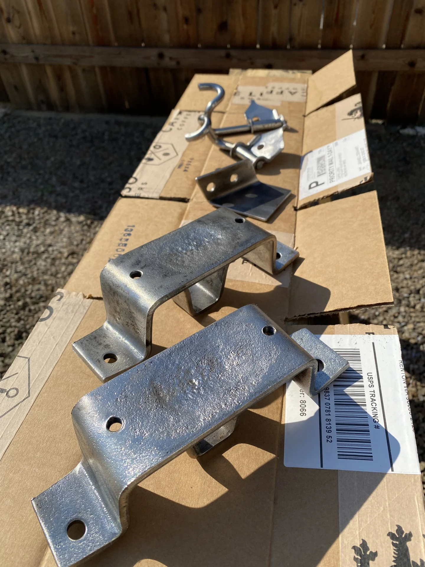

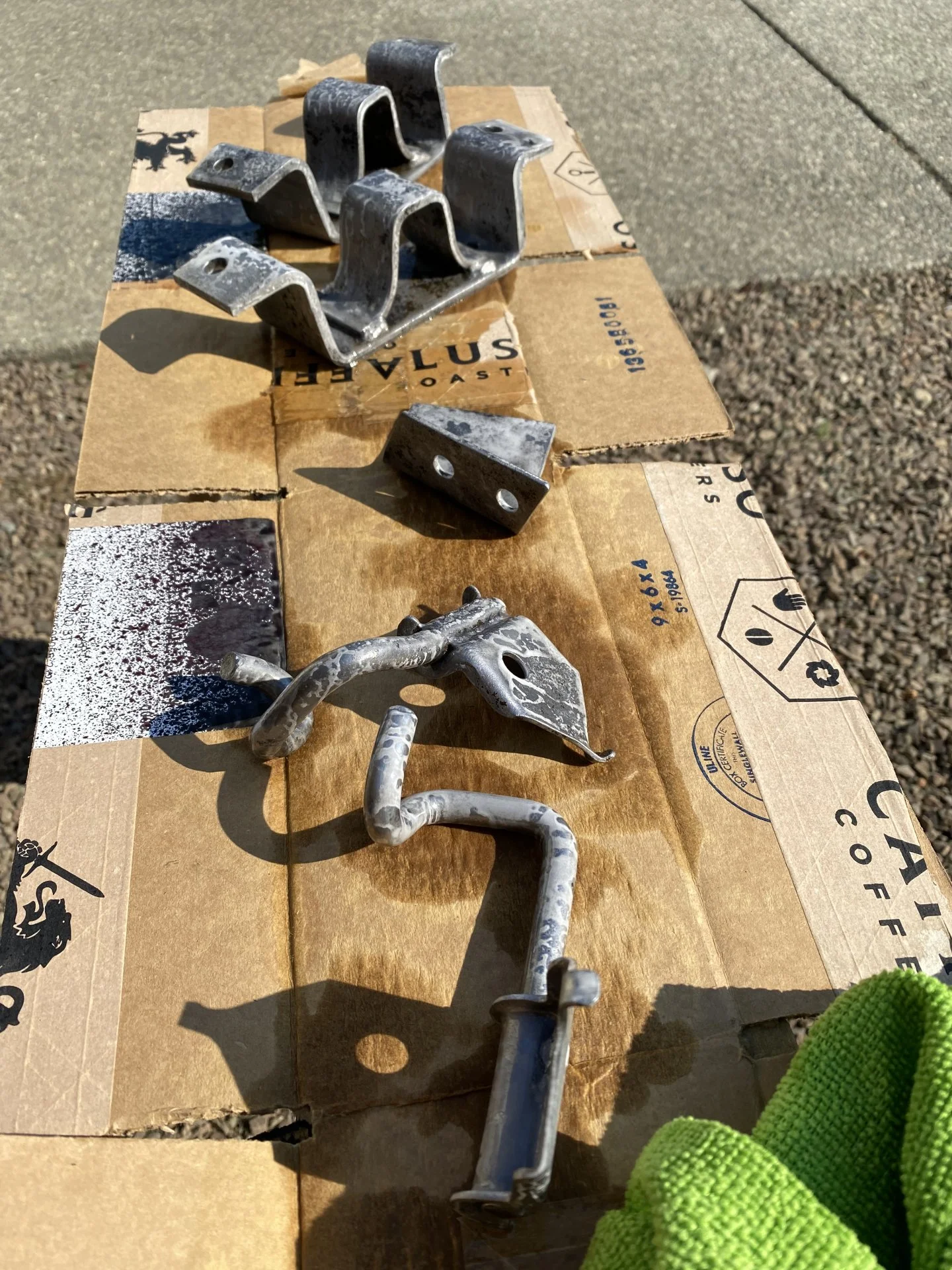

Is it unreasonable to spend days meticulously restoring things like bump stop mounts and exhaust hangers, zinc phosphorus coat them and do no fewer than 2 coats of epoxy primer and 4 coats of chassis paint? Nope, that’s about the right amount.

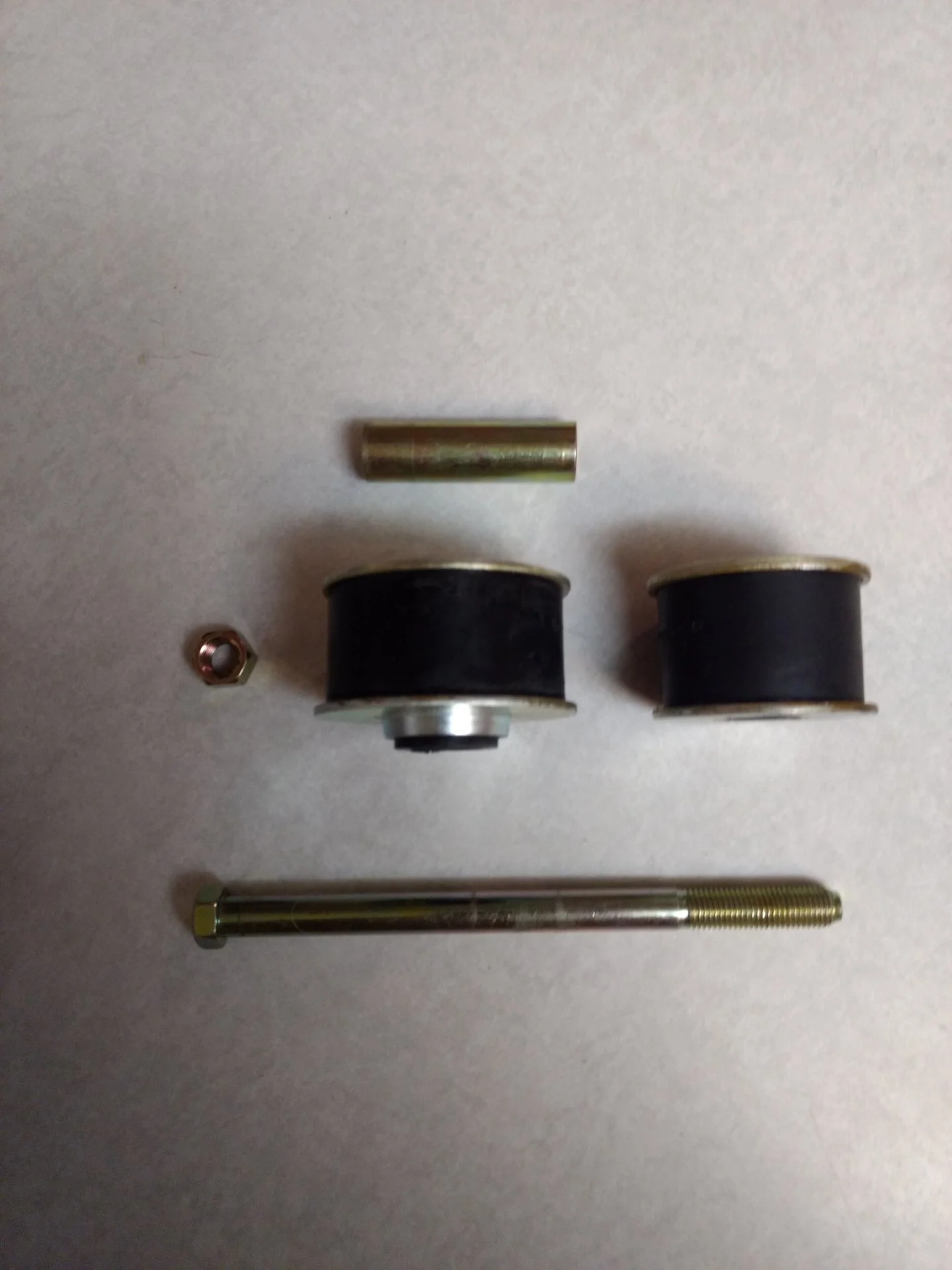

This is the replacement body mount for the rear of cab on my FJ45.
No castle nut. Not sure if there is enough threads exposed when installed to do a double nut. If not wpuld suggest a nylon lock nut. As Mark mentioned check the nuts for looseness. Like Mark washboard roads are common where I'm at.

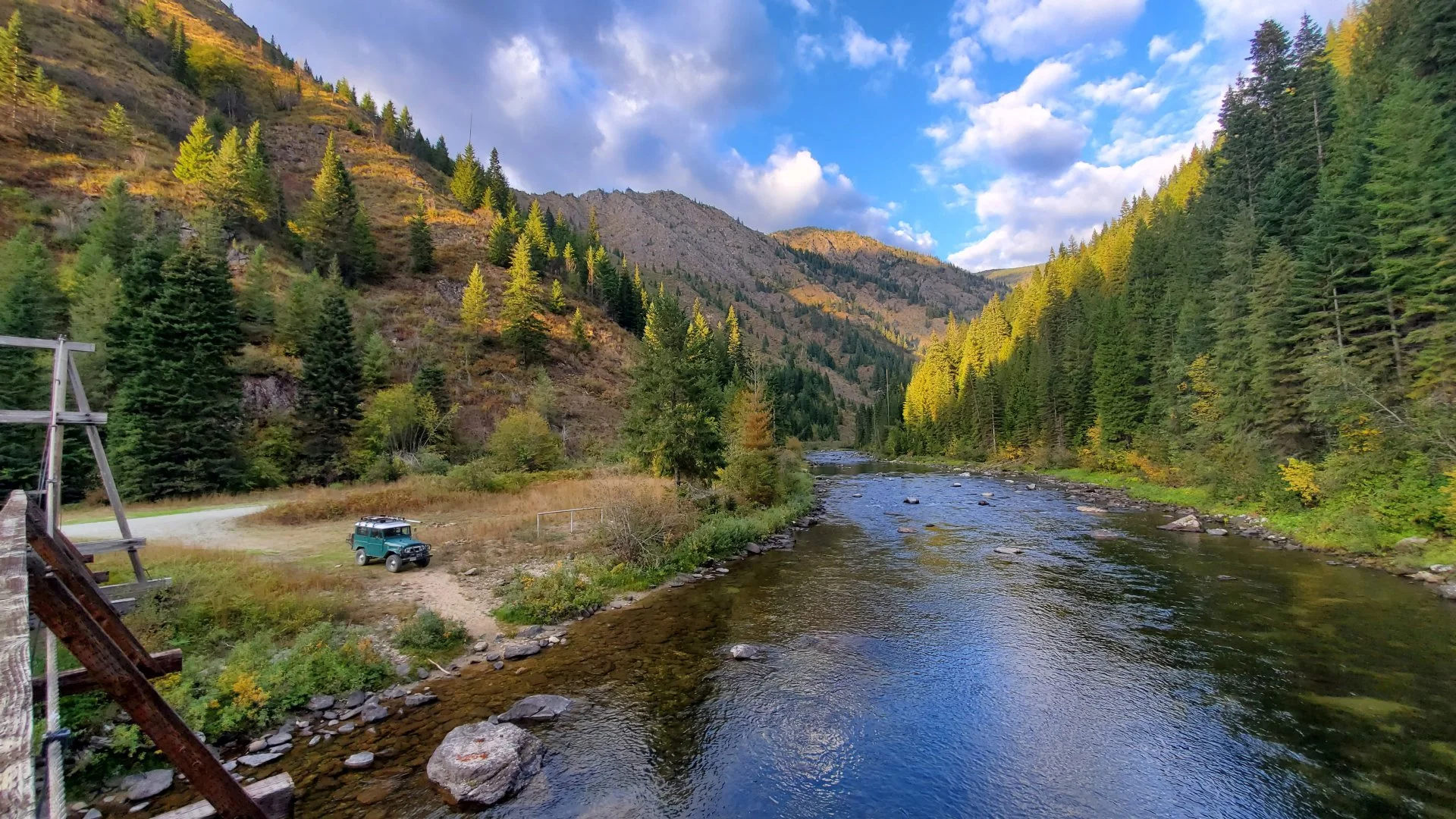

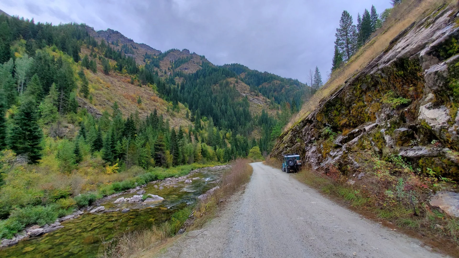

Added 300 something miles to the odometer.
Found some new rattles.
Beautiful place Ryan! It looks like a great place to spend time contemplating the better things in life.

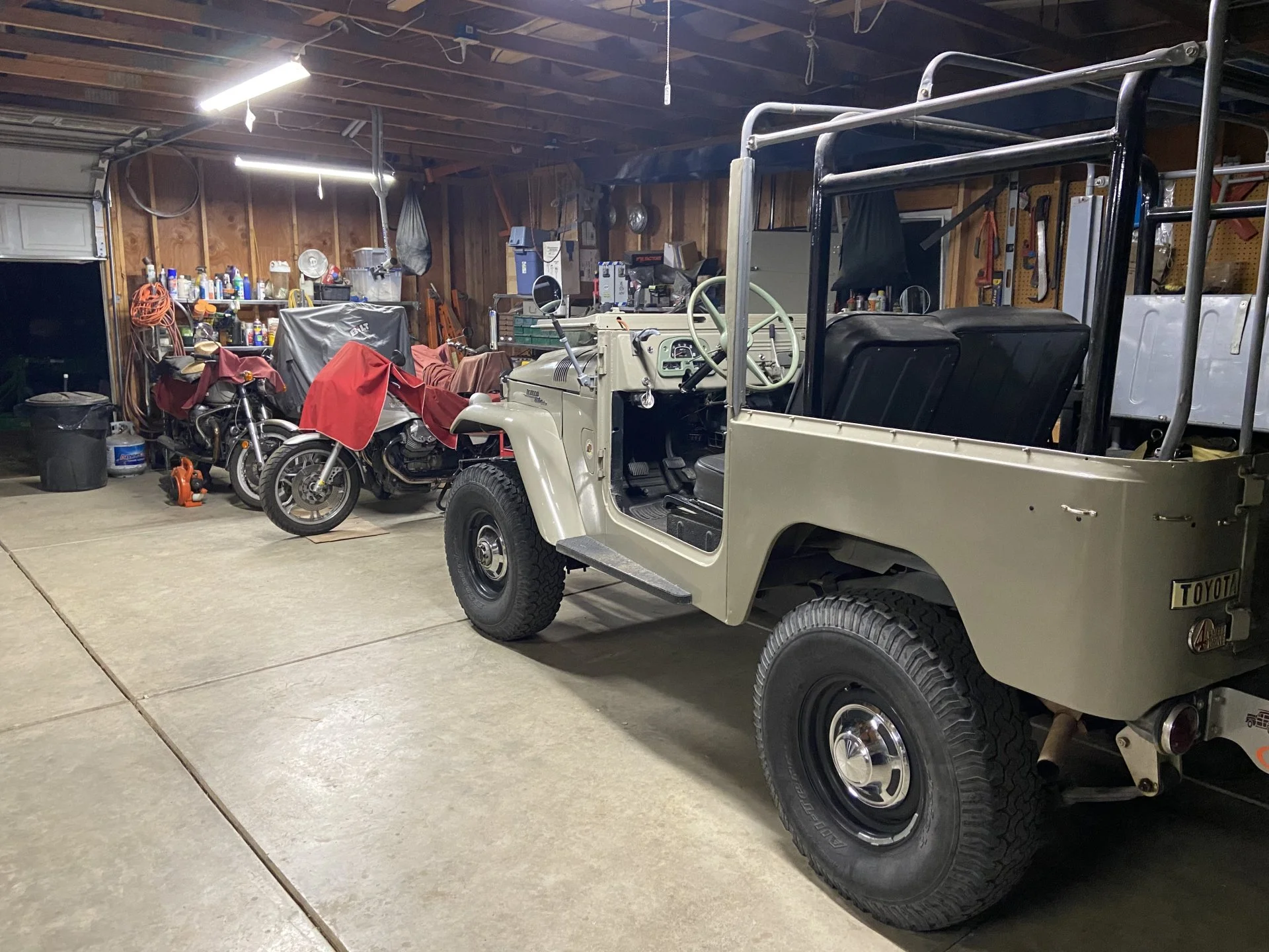

Replaced the fuel pump relay on the TBI and pulled the doors and Paki soft top off. Weather is getting cool enough to enjoy it like this.
Yeah, I needed a break from some things.

Replaced the fuel pump relay on the TBI and pulled the doors and Paki soft top off. Weather is getting cool enough to enjoy it like this. View attachment 3131216
Cool enough. I used to live in the depths of hell. We'd be putting the top on about now. It's having trouble getting higher than 54 degrees today. And we got snow in the local mountains.
