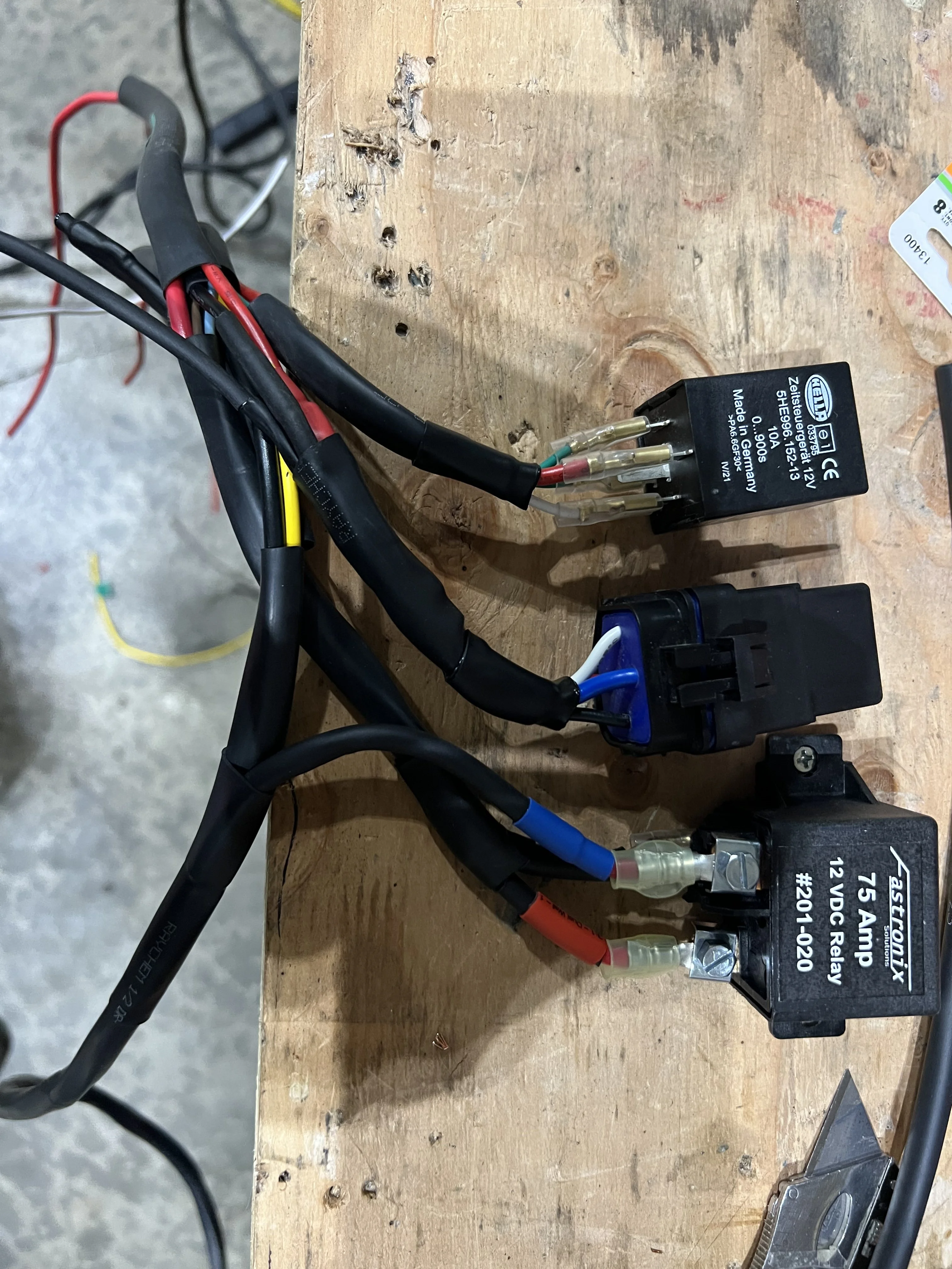

I was running iRapsody relays off amazon rated 80/60, but there are a lot of comments saying they are closer to a 40/30 amp relay. I got invested in a Dakota Digital 75 amp relay, kept the iRapsody for the horns and bought a Hella, Delay off relay. Since I'm running a sniper, I have two fan switches and plan to run the first fan at 190 for the electric fan and 210 for the delay relay. The relay is set for round 150 seconds and if I turn the engine off when the temp is above 210, it'll keep the 75 amp fan relay on for a little over 3 mins....hopefully, no more heat soak.

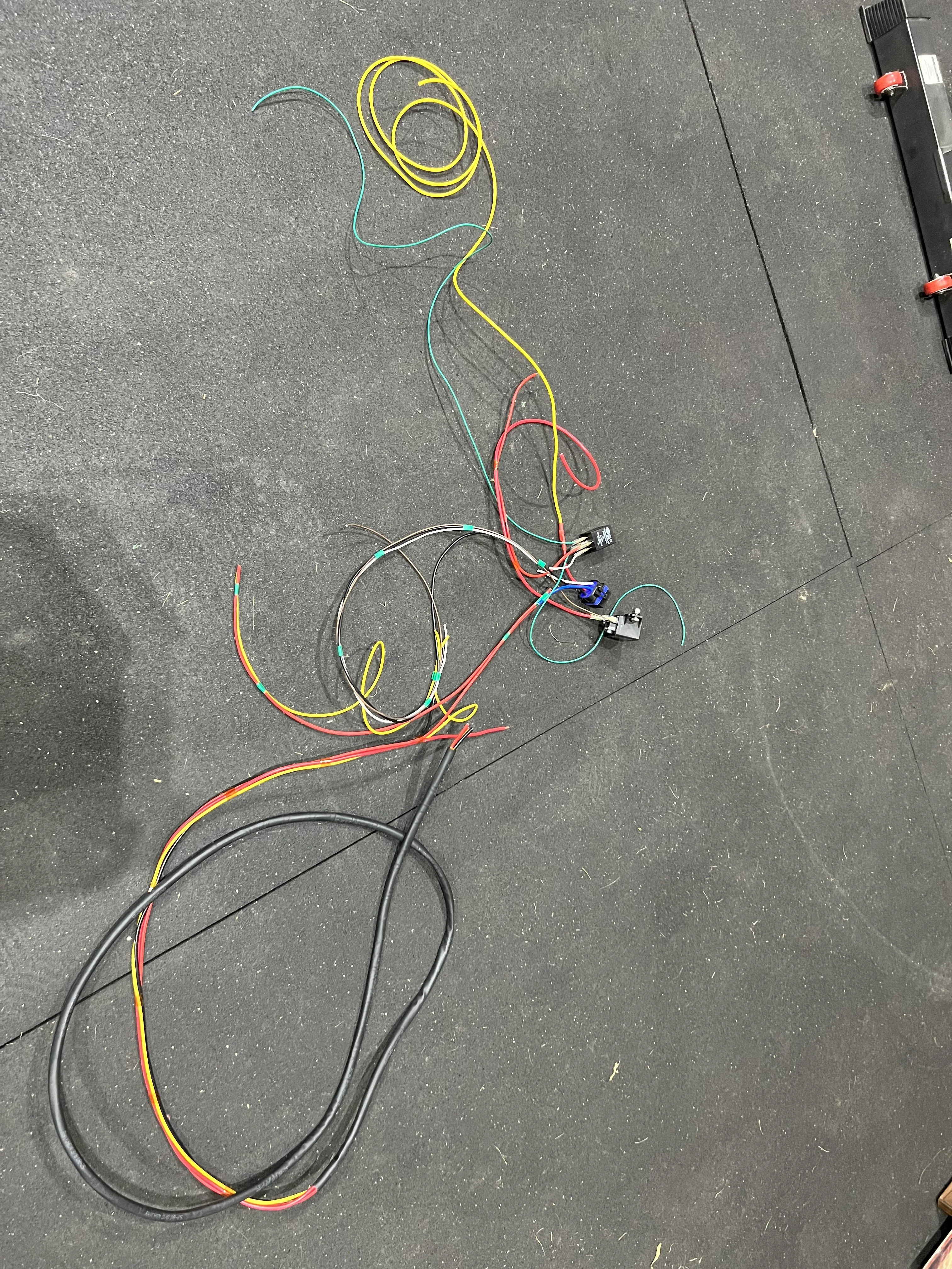

Back to the new wiring. Replace the 14 gauge fan wire with 10 gauge, re-ran the horn wires and consolidate the grounds. Here is what I started with:

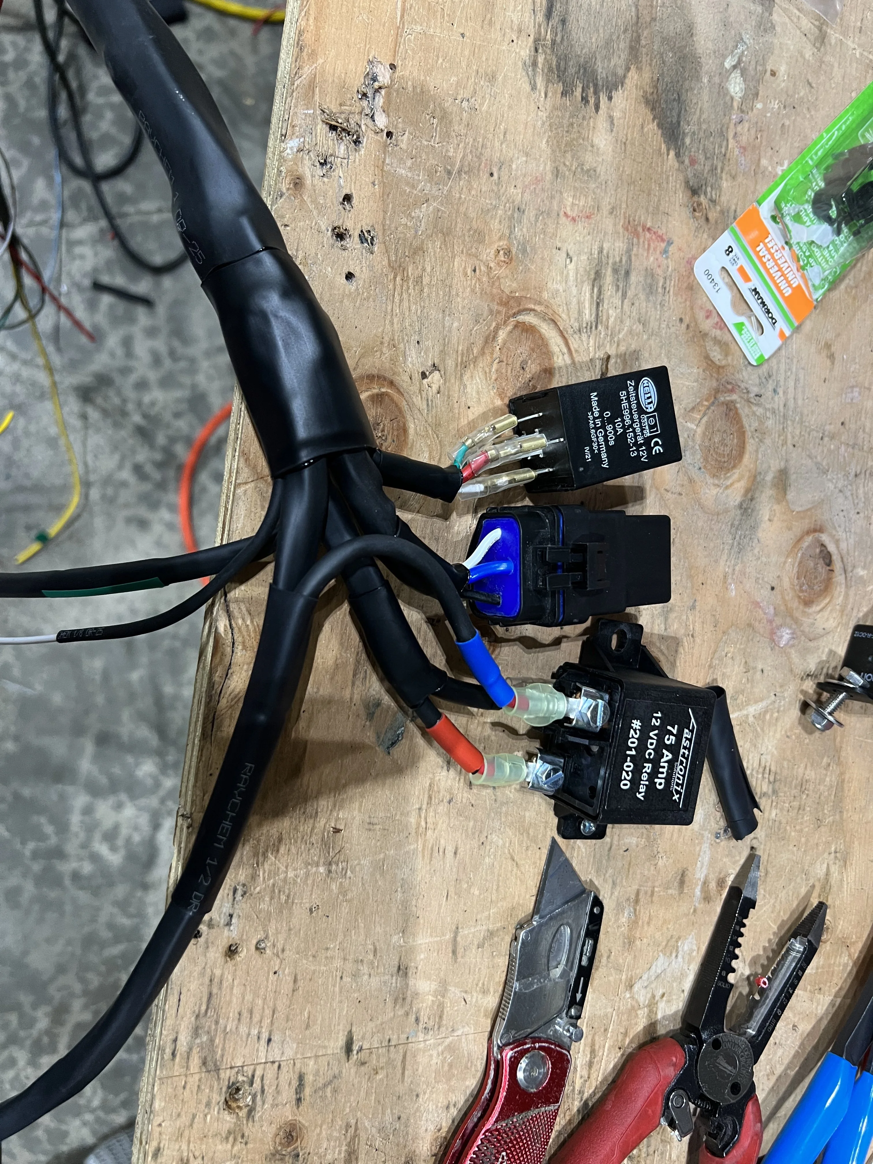

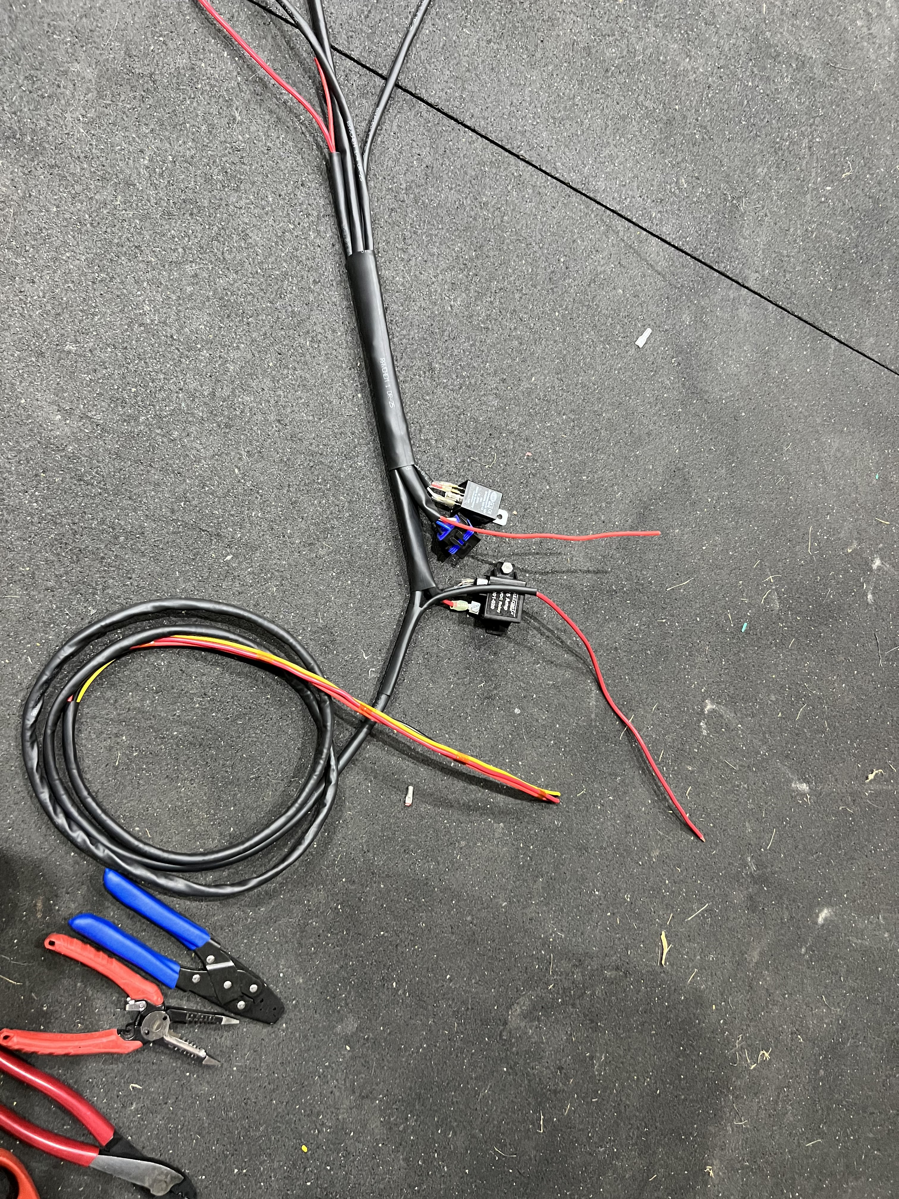

An long, laborious process, wrapping everything in Raychem DR25 and fixing the ends with Raychem SCL.. Here is the progress pick:
With wires going everywhere from relay to fan, relay to ground, relay to switches and relay to power, it was super difficult to route everything with our creating big bulges in the wiring loom. For a couple of the wires, I cut them and then inserted both ends into the same side of a barrel connector to get a clean 180 degree turn. Here is some more progress:
I first put everything together with the wire looms too long, and then cut them to size. I had to label each layer as it removed it so I knew the order to put it back together. I think I took the loom apart around 10 to 15 times to get the right sequence and layering.
Final product, it's no @Coolerman or @ToyotaMatt job, but it'll work under my hood:
