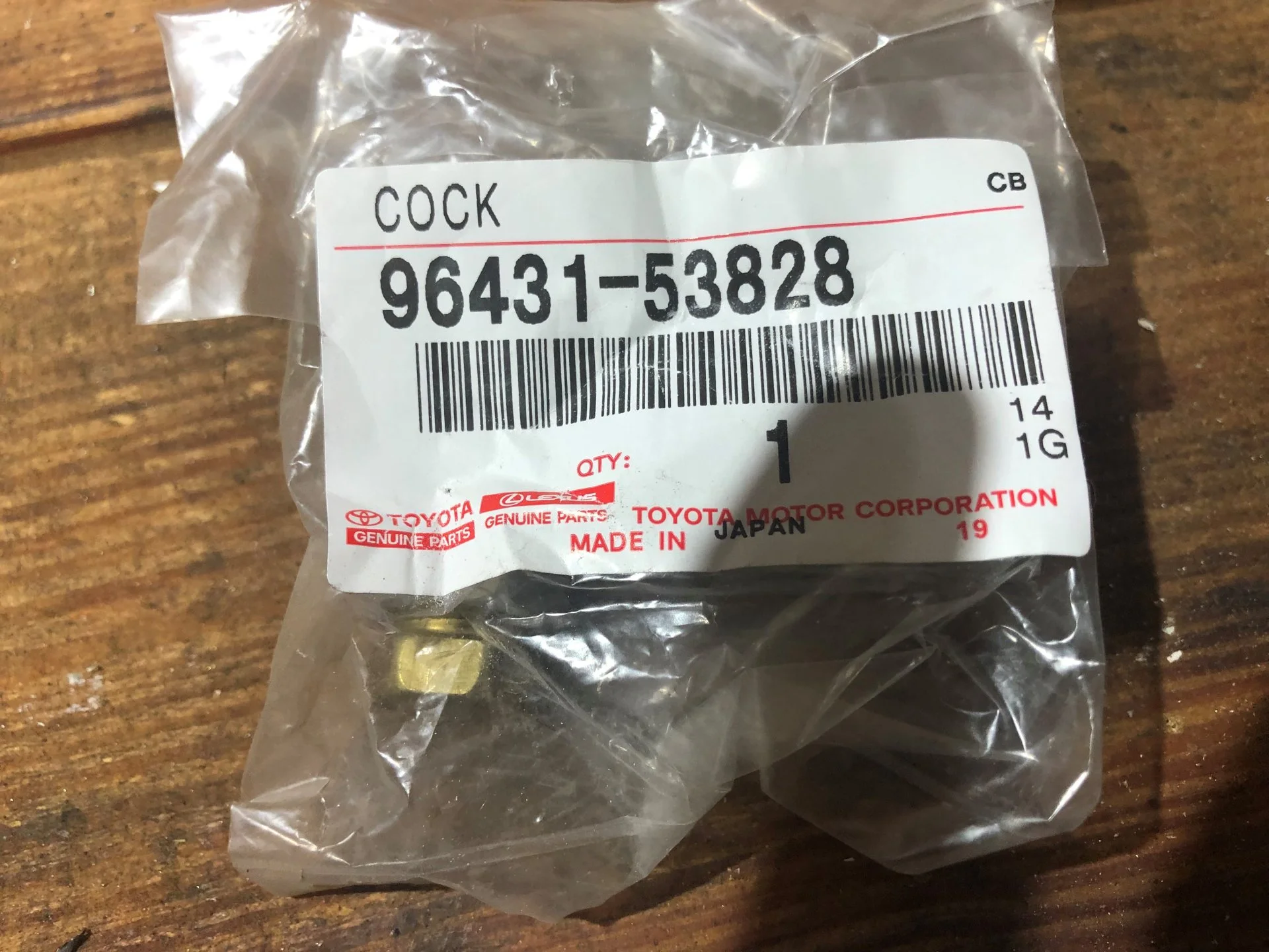

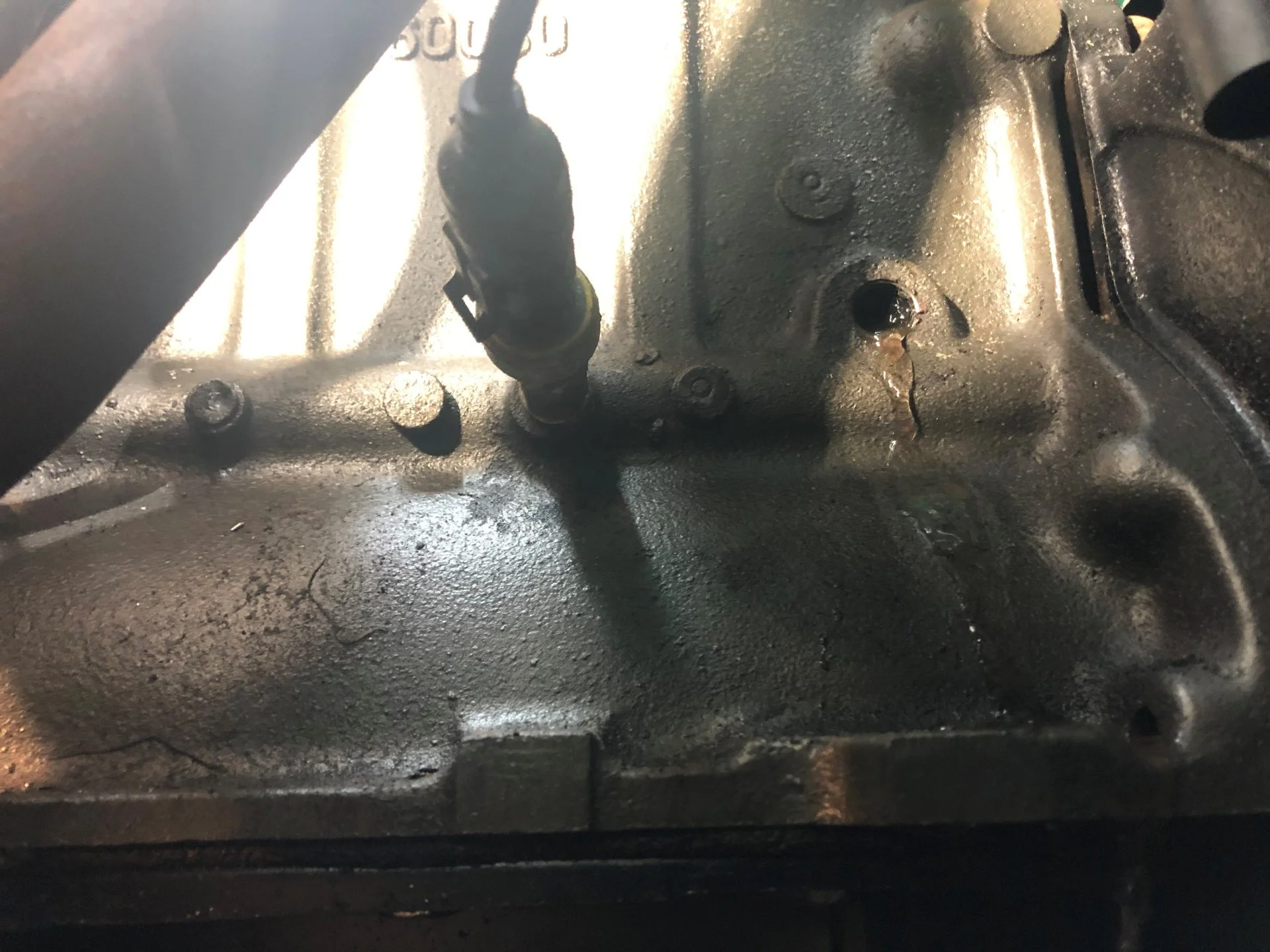

Well, at long last, I decided the time had come to unclog our plugged up engine block drain. Removed the 14mm brass drain cock and had zero flow. Removed the 19mm drain cock housing and likewise had zero flow. Then went at the stubborn plug with an assortment of tools and finally achieved success. At first just a dribble but eventually got a good flow. I had ordered an OEM drain cock but have one of Toyota Matt's with the hose attachment incoming.

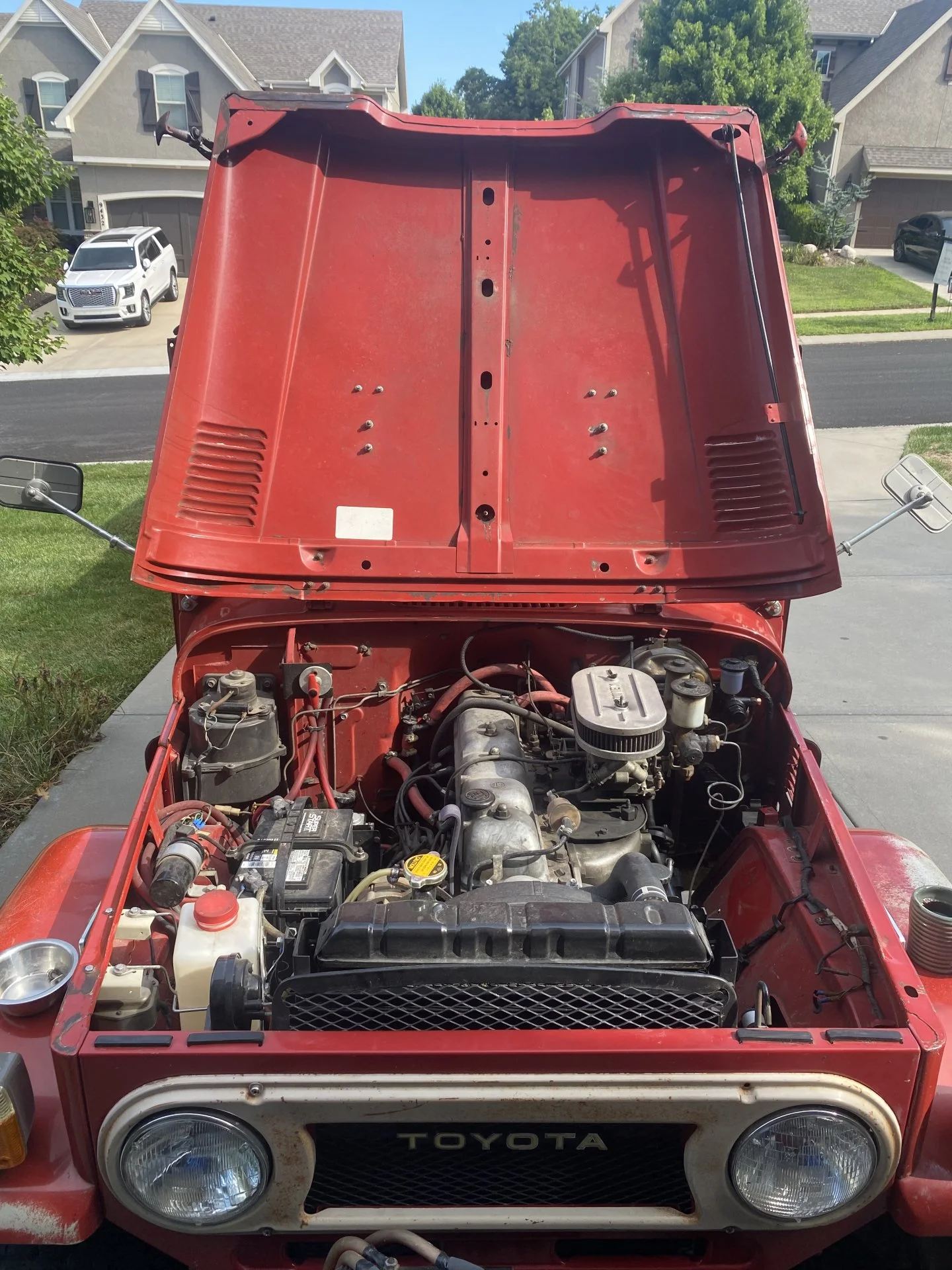

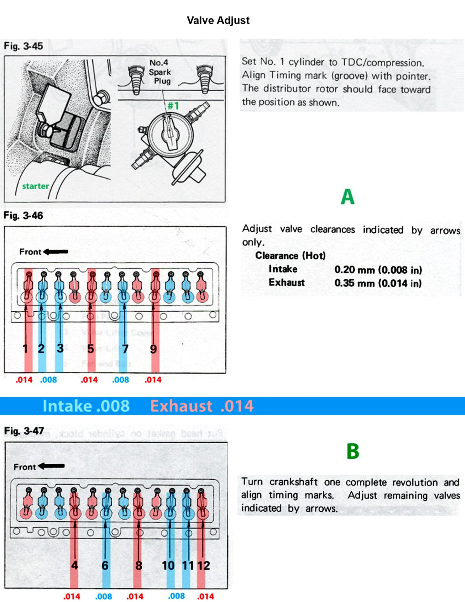

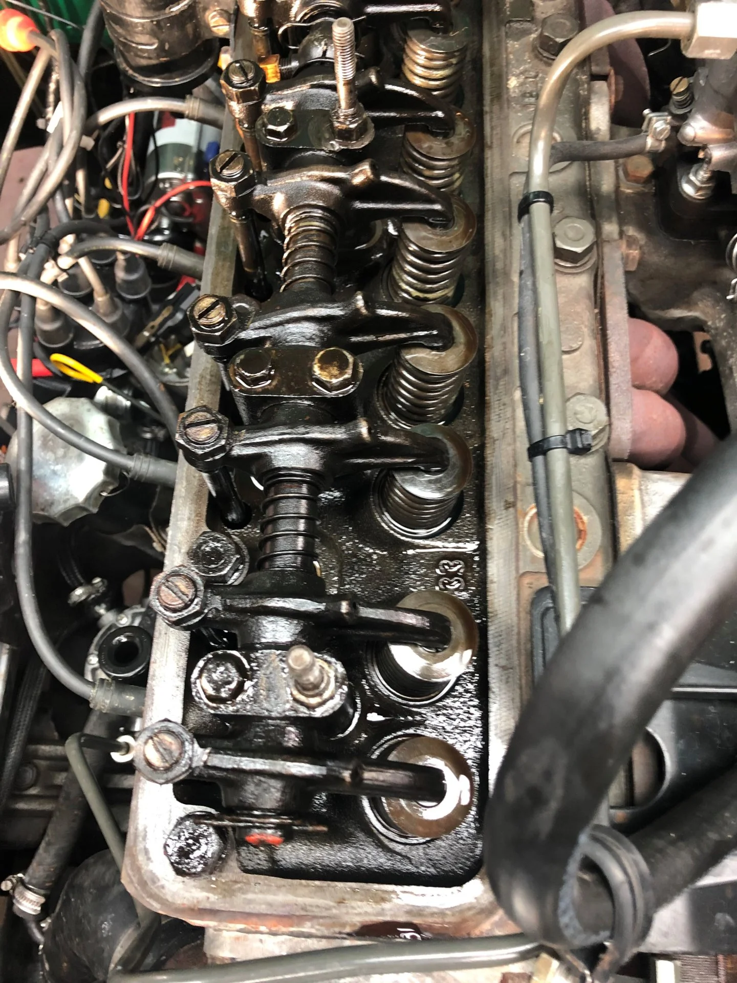

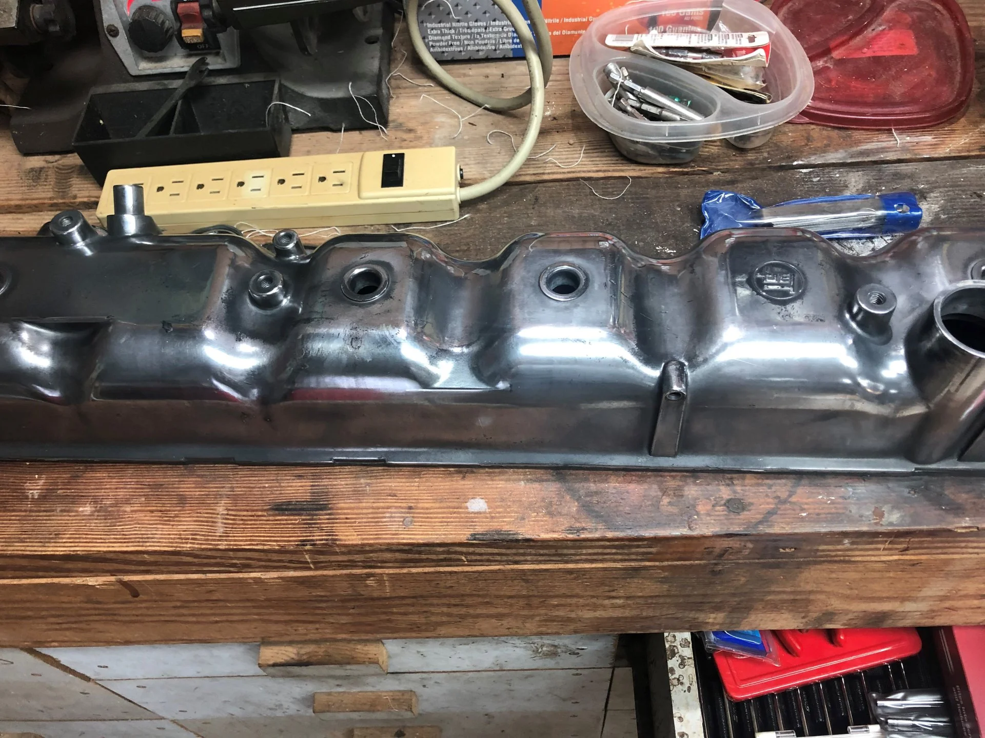

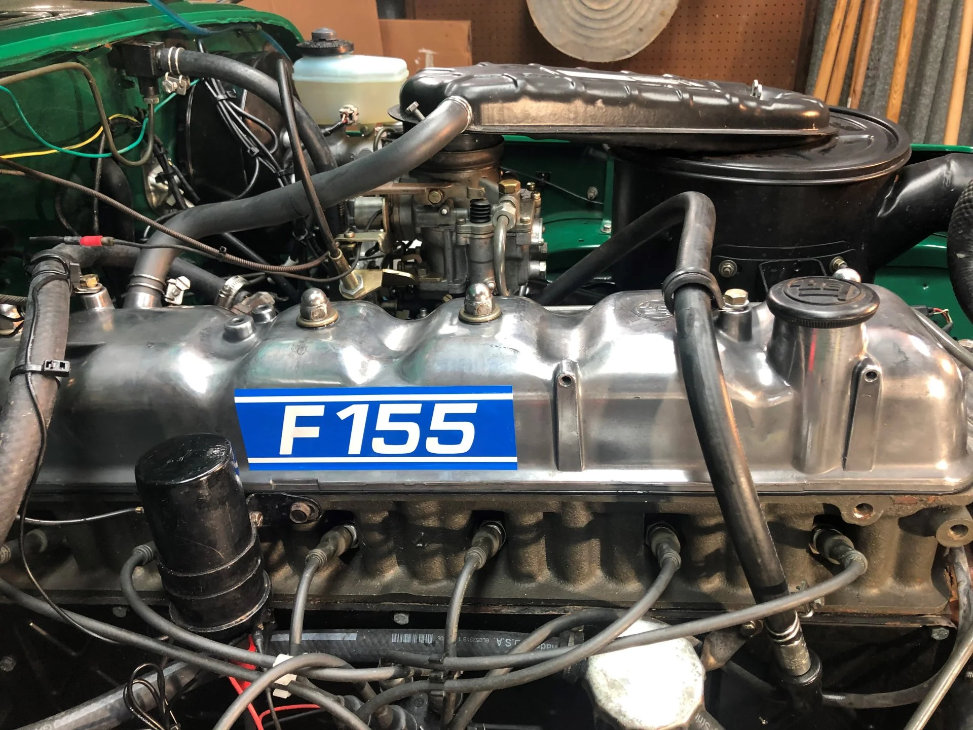

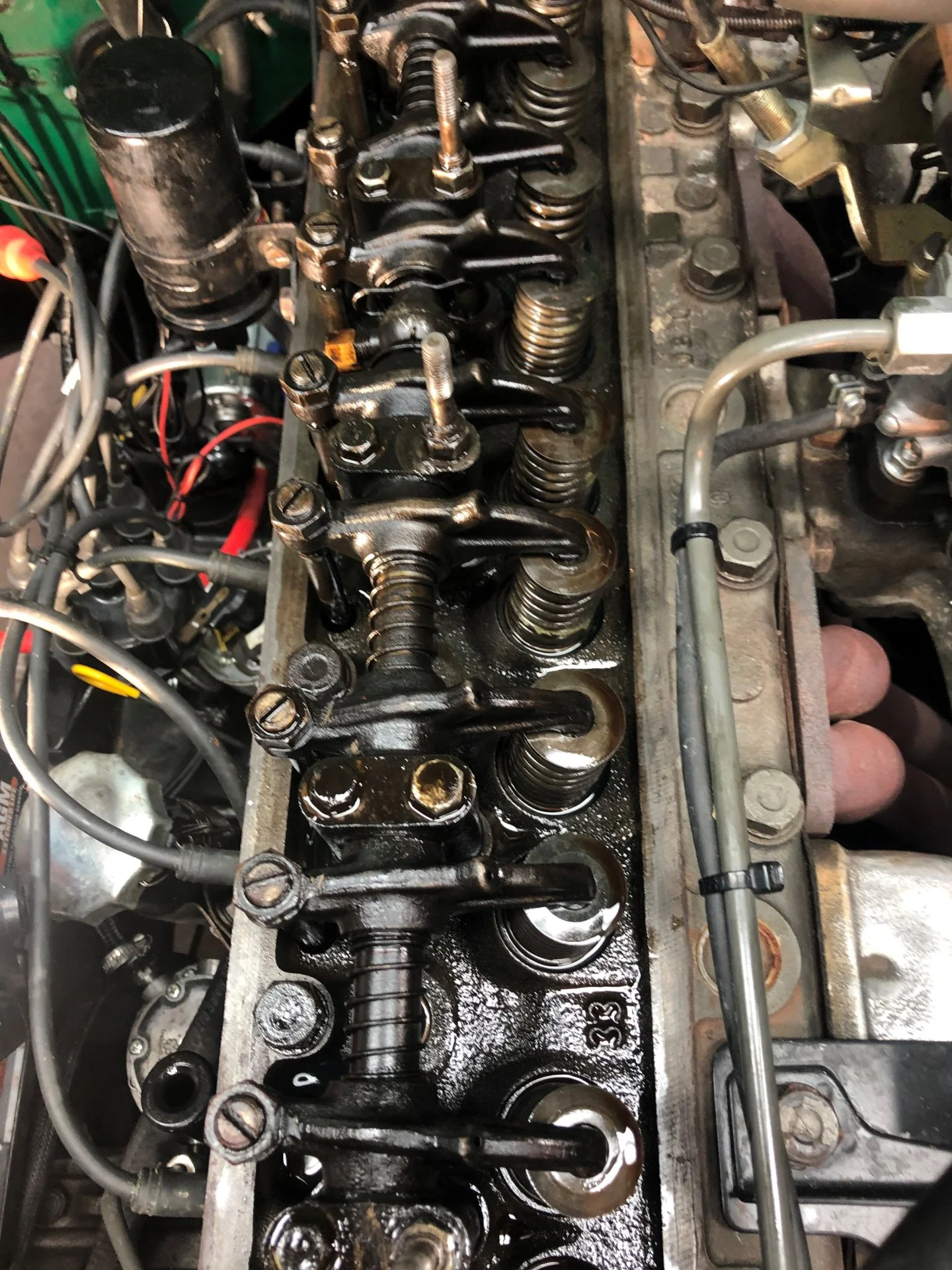

Also, preparing for first my first valve adjustment. Put a bit of shine on an aluminum valve cover; tested remote starter for bumping. Waiting on inbound OEM valve cover gasket.

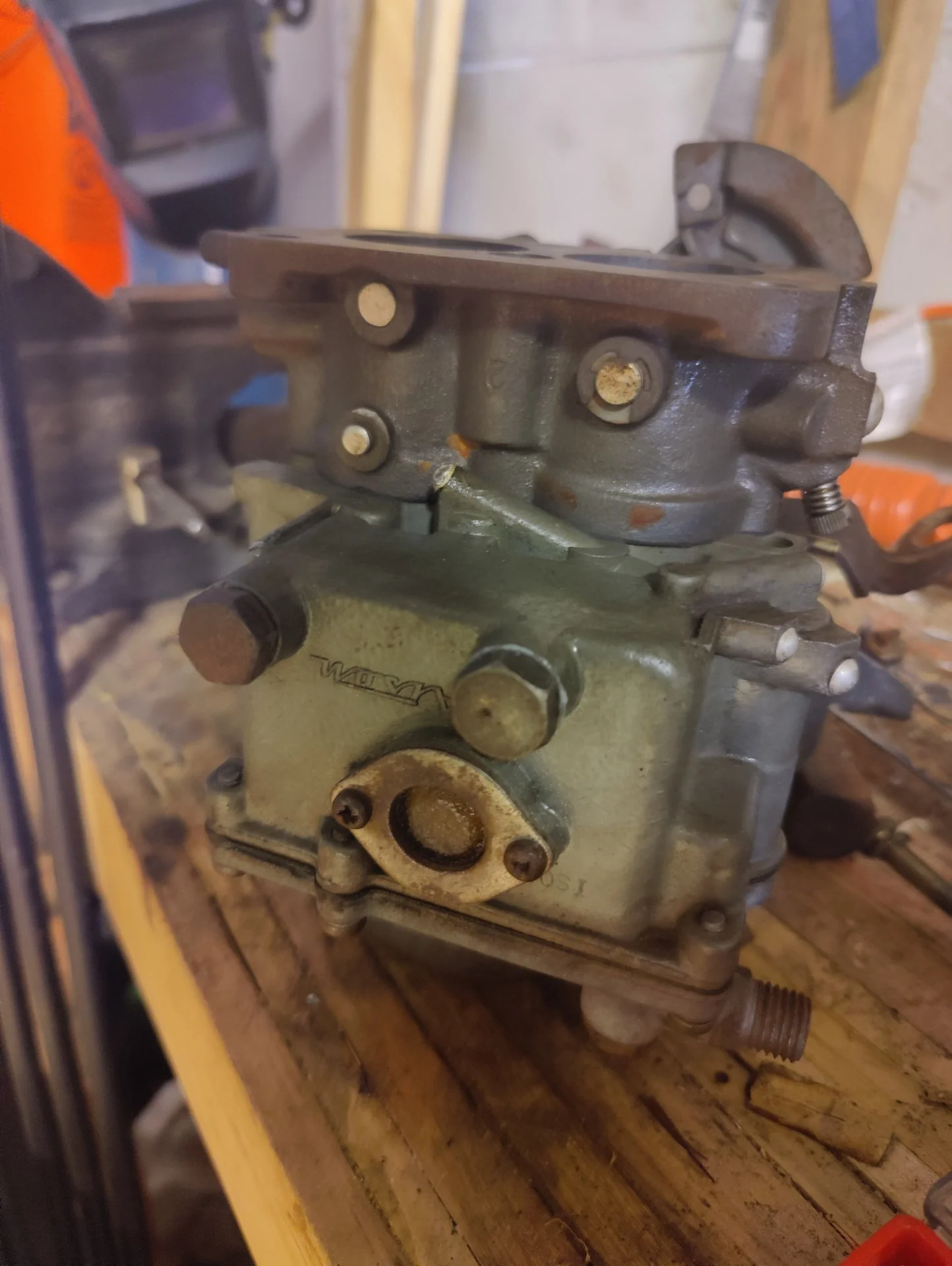

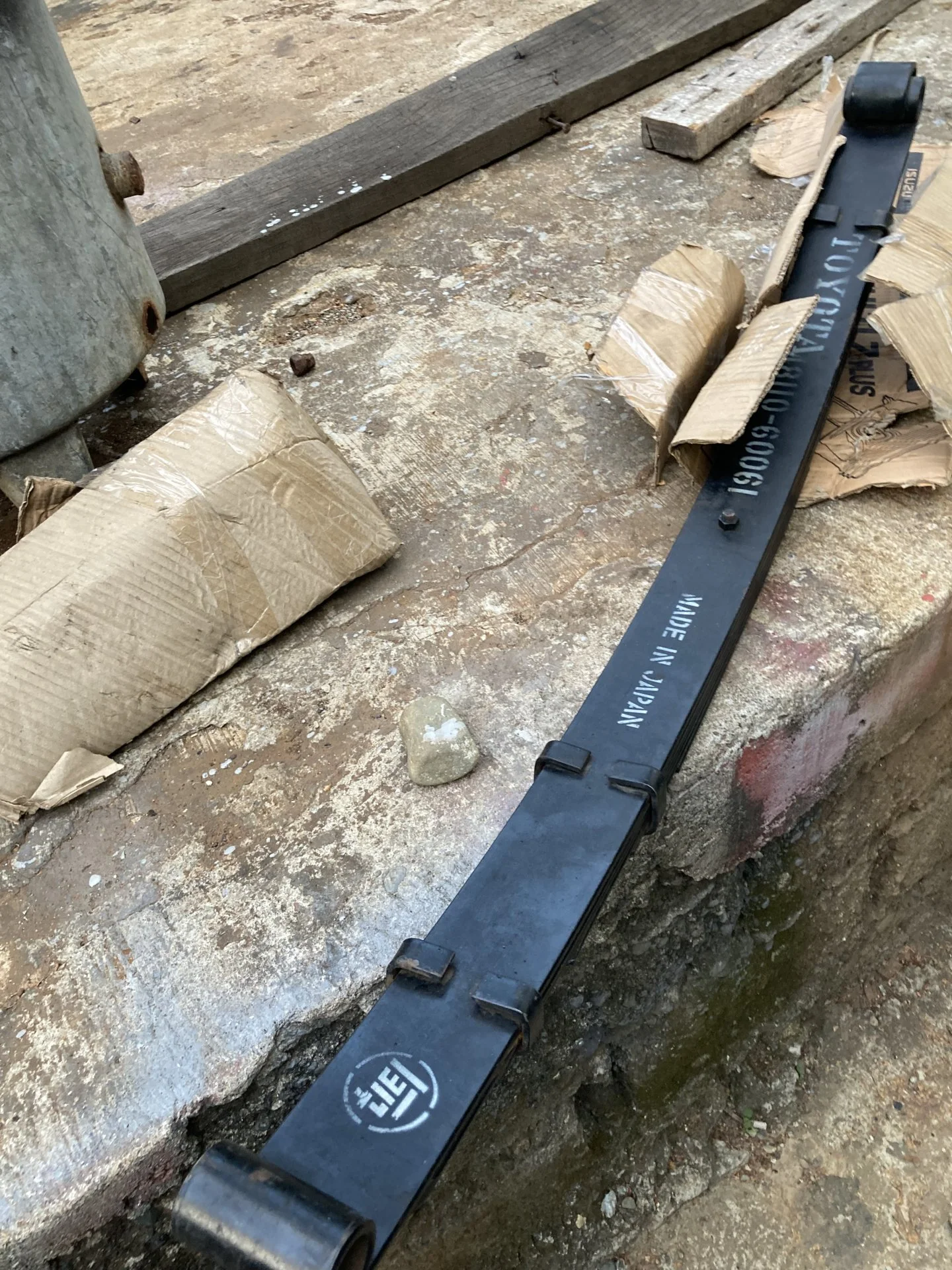

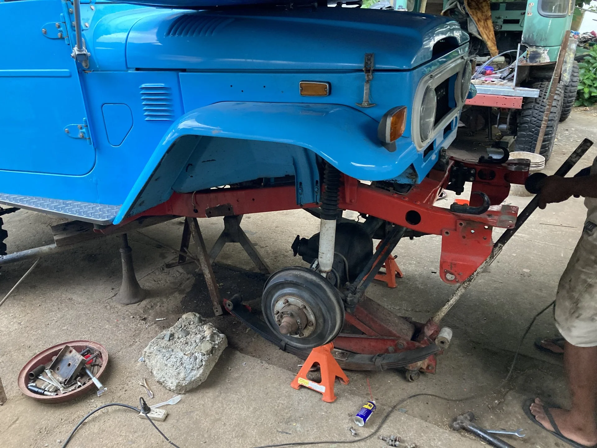

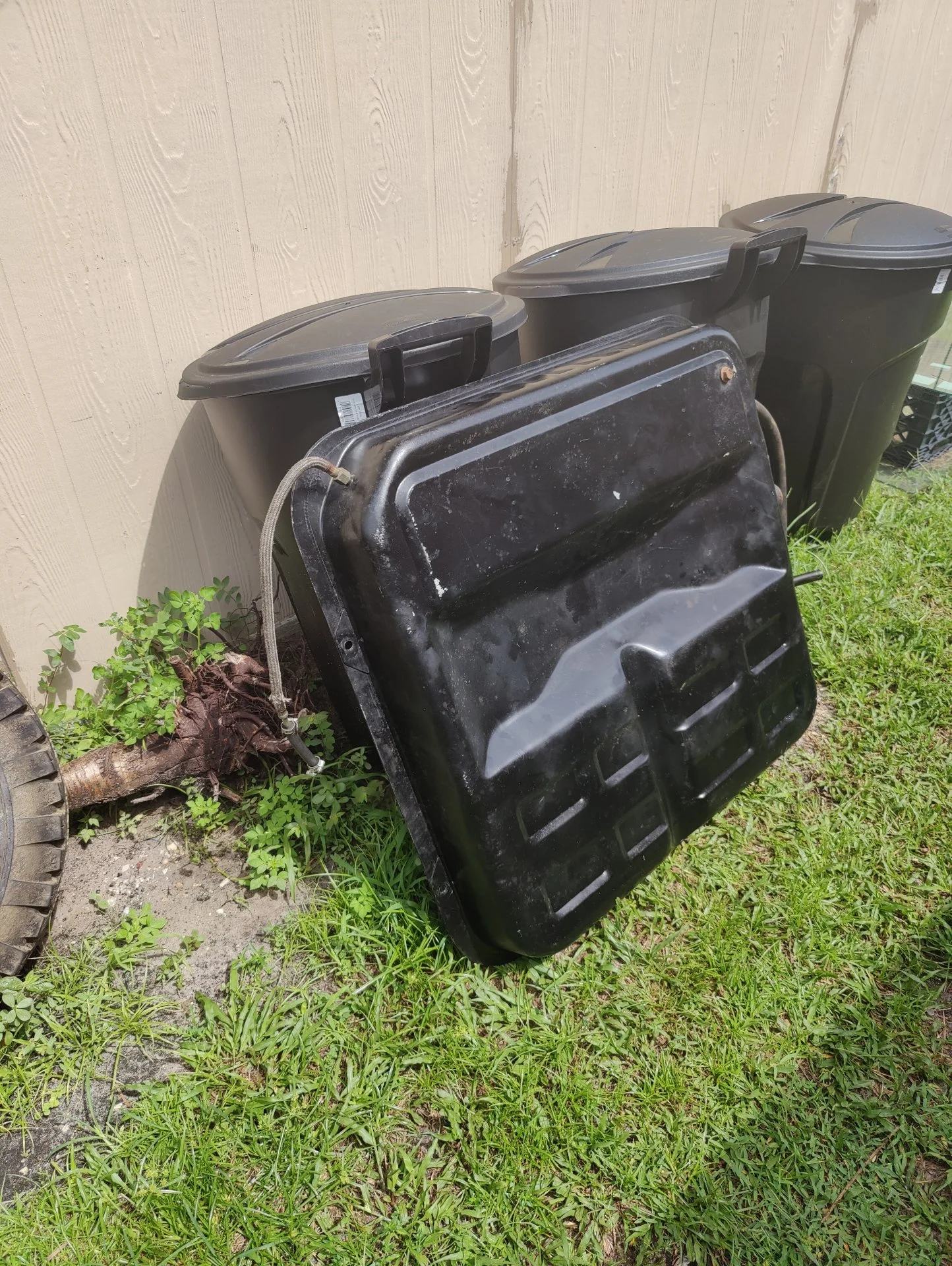

Put more @SLOCRUISER rubber on the truck. Bought a Sniper kit from Mosley. Dropped the tank and inspected the carb and fuel system for fun.
PO said the truck wouldn't idle and he couldn't figure out why. I found out why. The carb was absolutely gross. Almost everything was clogged or caked. Got it clean (for fun) and pulled the tank. The tank is rusty-ish. Gonna try to de-rust it (any tips tricks would be appreciated). The line coming out of the tank to the pump was completely clogged with rust powder and gunk. The hardline from pump to carb dumped sand out of it when I pulled it.

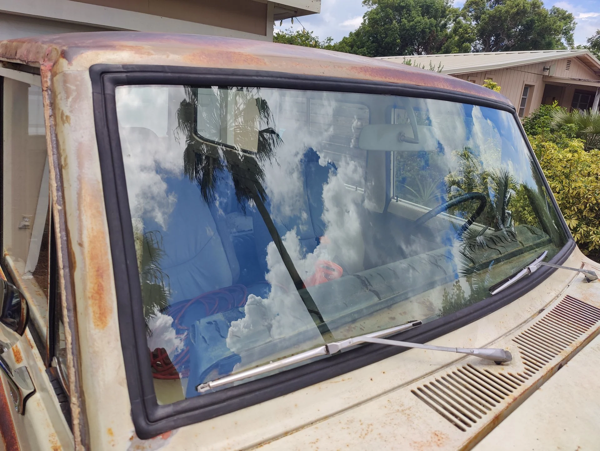

Edit: windshield guy showed up last minute. The dude did an incredible job. I stand corrected. I'd recommend him to anyone in Central Florida that needs a glass guy. Super cool dude. Extremely professional and knowledgable.

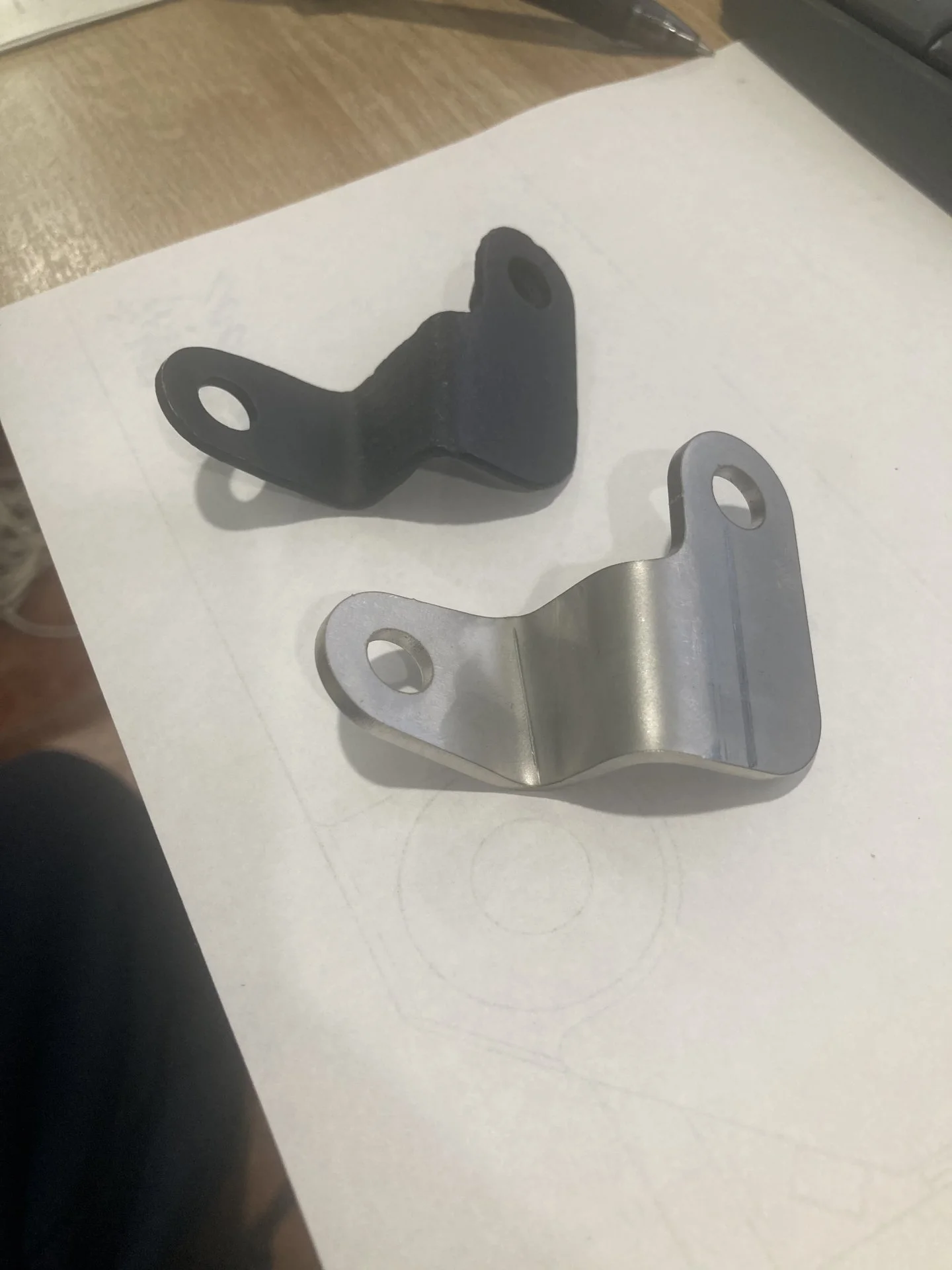

Too excited not to share. Stainless reproduction 72-79 fuel filter brackets going to be available soon, almost every 40 that comes through our shop is missing one. :D
Where does that mount? I have one on a shelf, but didn't know what it was or where it goes.

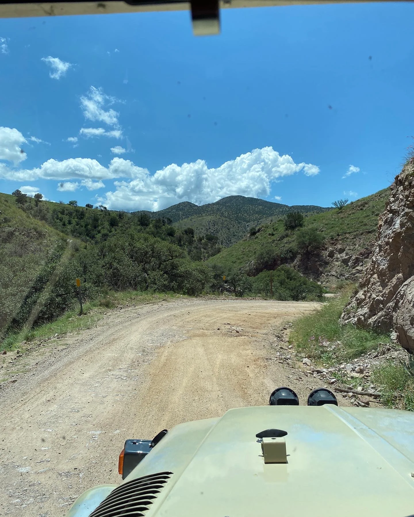

Drove her over the Santa Rita mountain pass into Madera Canyon.
Yeah, you better take a pew-pew with ya!
A mellow trail over the pass.
