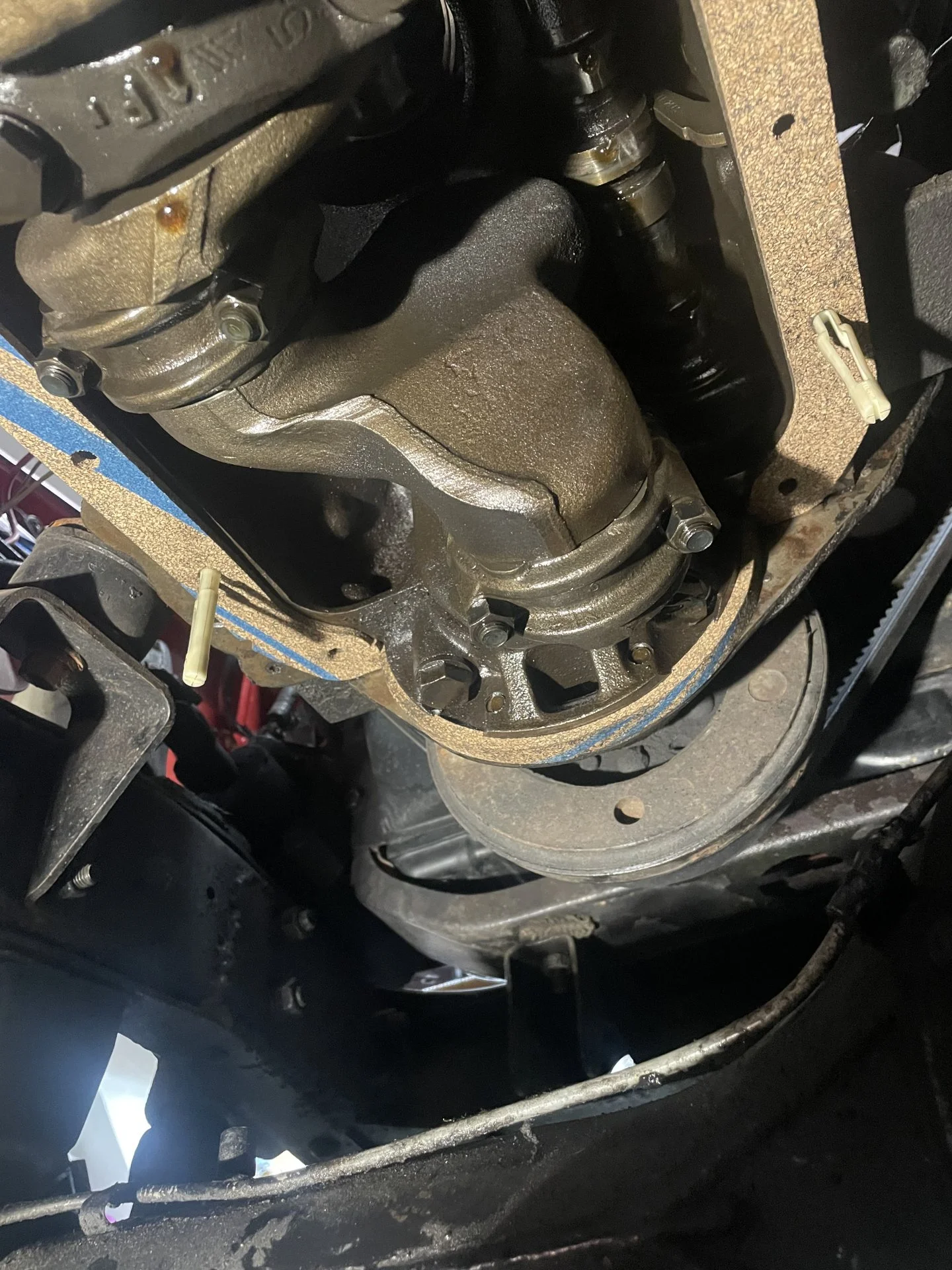

Flushed the rad, new thermostat, finally mounted non rusty oem oil cooler pipe. Please disregard non factory hose clamps.

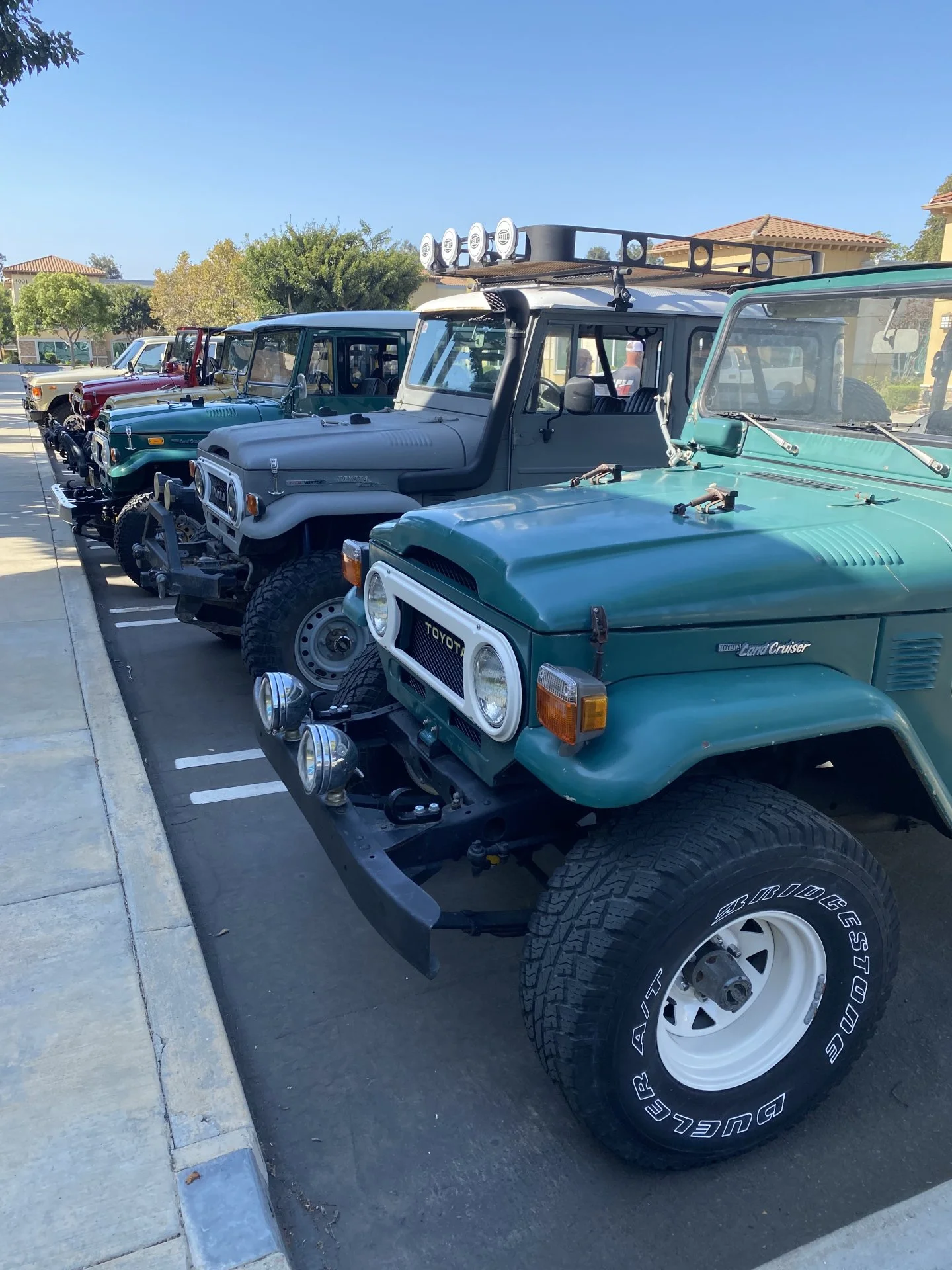

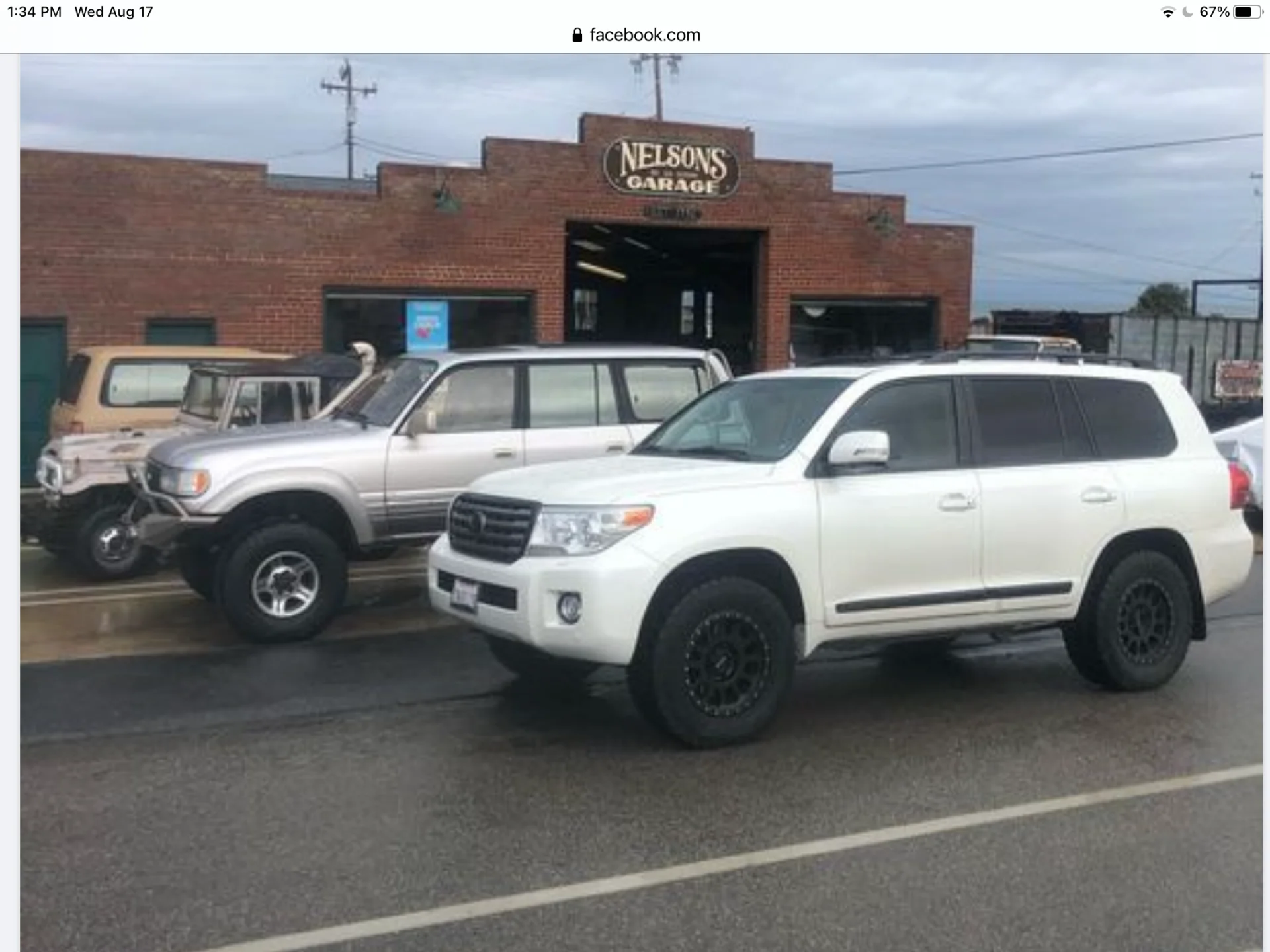

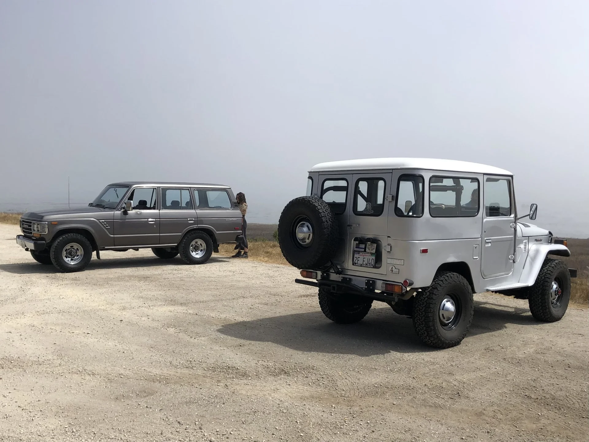

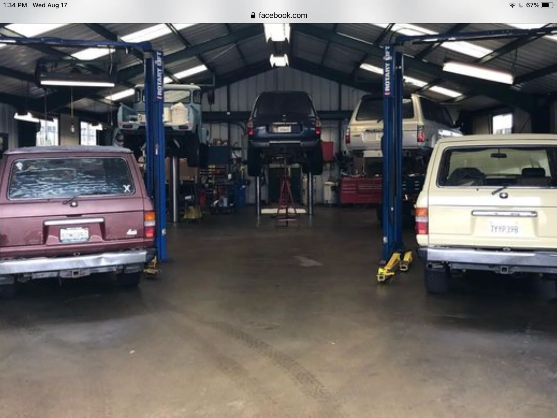

Drove it to the beach (Cayucos, CA) to check out a repair shop (Nelson's Garage) that always has an interesting mix of cruisers there, but closed on weekends when I usually drive by. Talked with Mike, a fellow cruiserhead and great guy about some future work for my 40.
Driving home up Hwy 1 I spotted a clean 62 parked at the beach and had to stop to meet the owners, a really nice couple.
The beach was overcast, but still a good day driving my rig and talking with cruiser people.
Wow. The last one look like taken in the studio .....

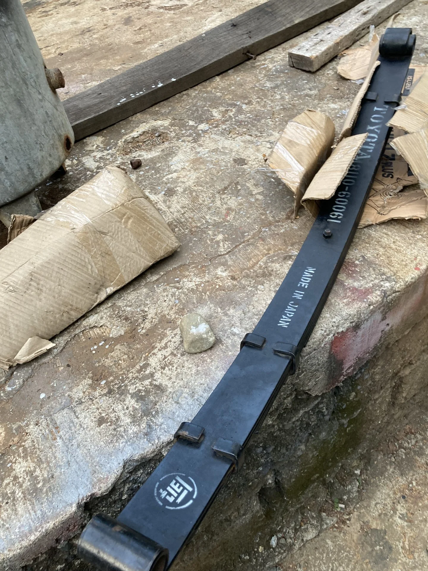

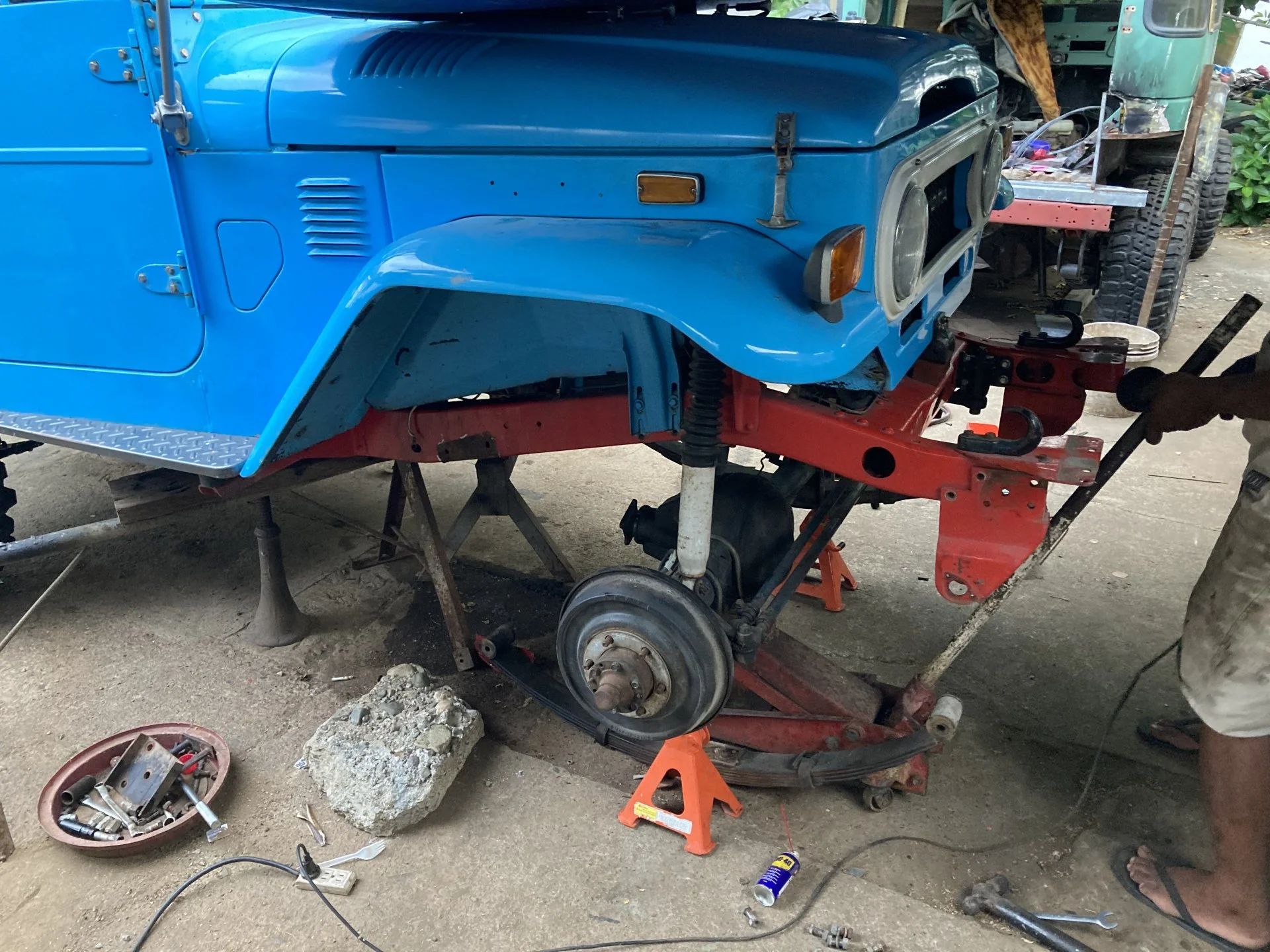

Ditching the 4 inch skyjackers and shackle reversal po did (the po is my dad who's had his fair share of building mid life crisis "bro-dozer" lifted 40 to 80 series. Definitely not my cup of tea).
Still thankful to have nos oem leafsprings that was bought my grandfather some 28 odd years ago.
This embarks my "unpo-ing" the 1974 FJ40LV. Goal is to return it to as close as a stock standard FJ40 when it rolled of the dealership when my grandfather (1st owner) bought it in November of 1974.
reverse the reverse shackle that the PO did on my ‘78. Thanks for this!

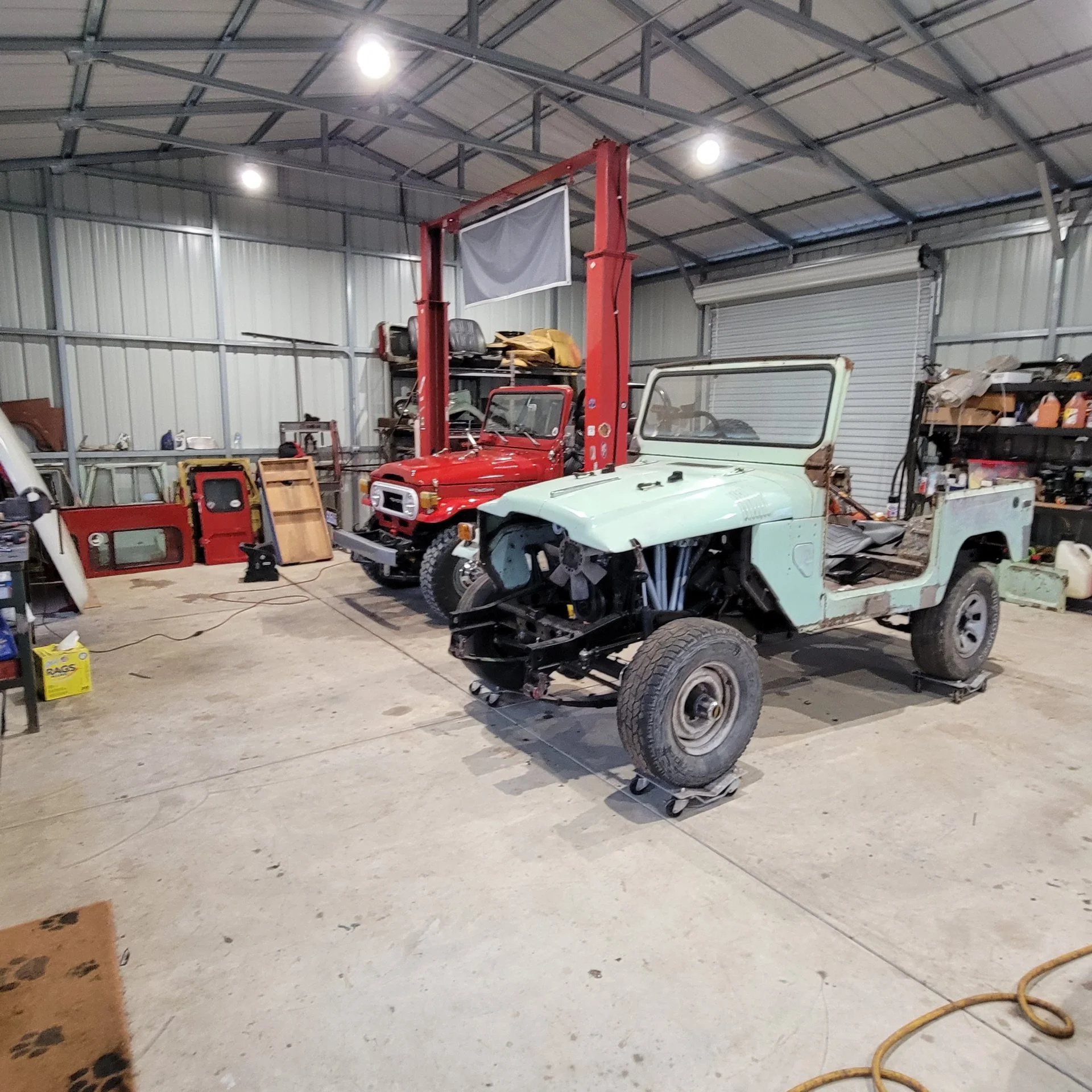

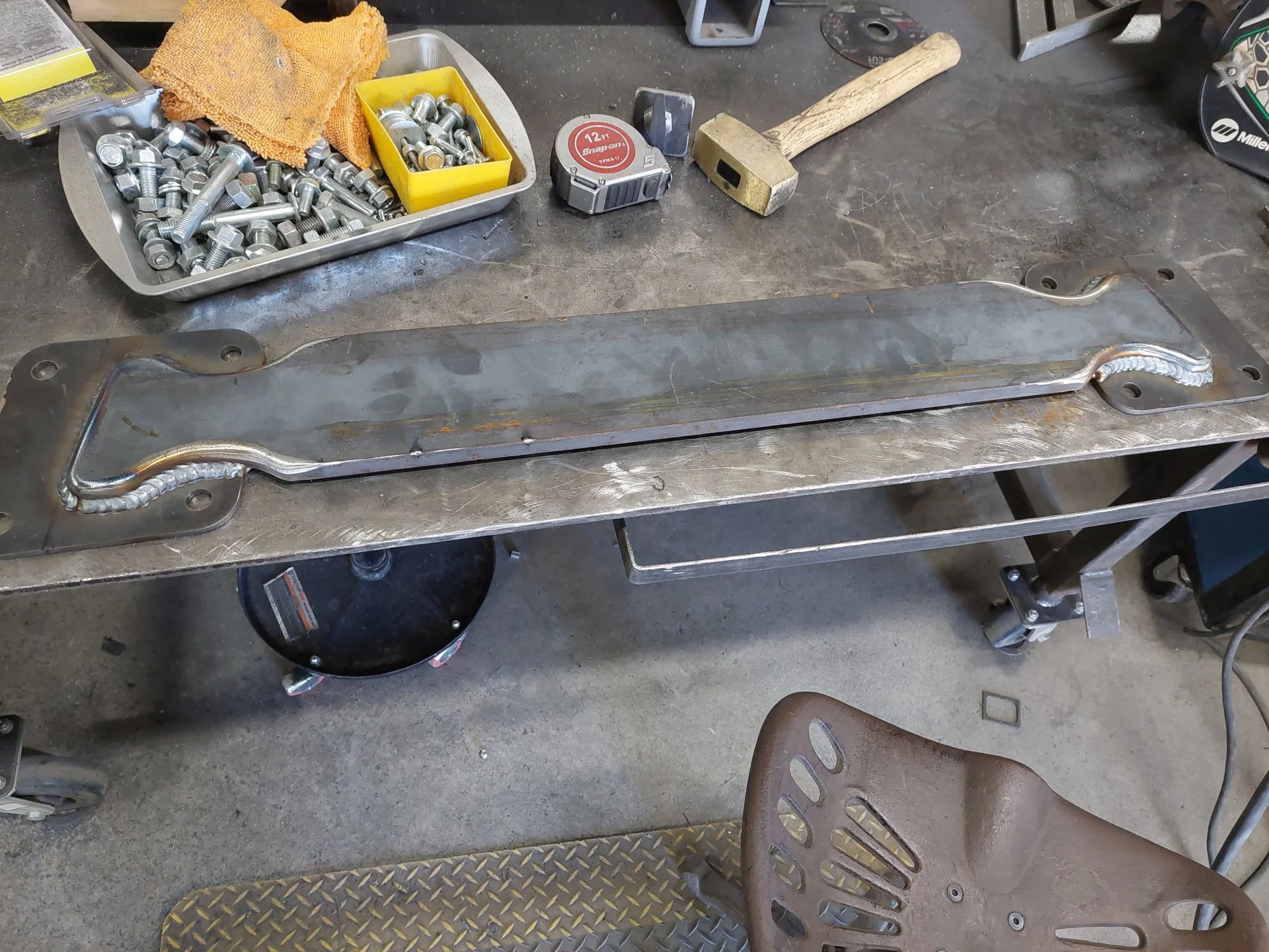

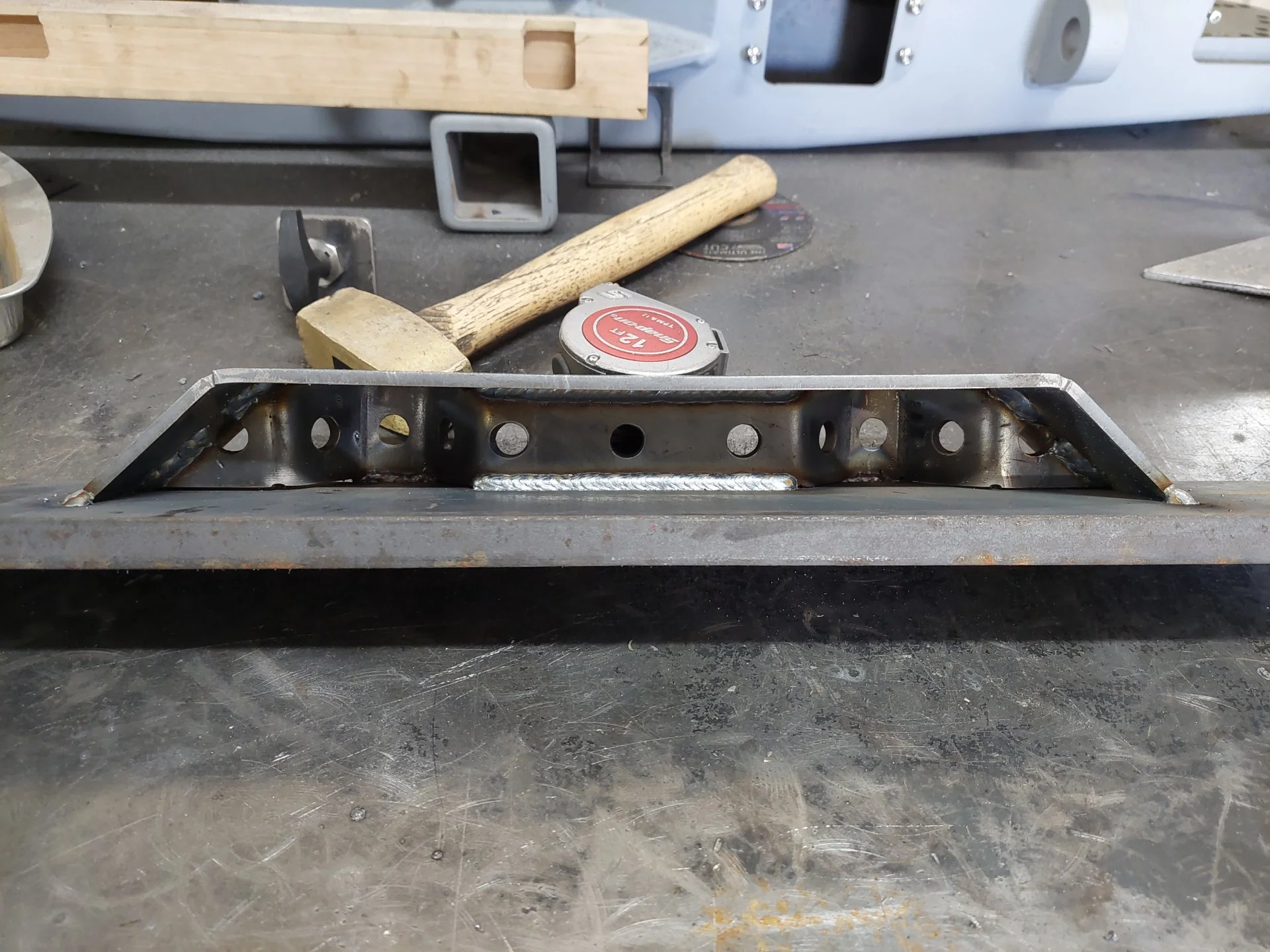

I made some weight savings and then took all of it back with the new crossmember. :rofl:
I also got a true first start out of the new twin turbo monstrosity I'm cramming in there.

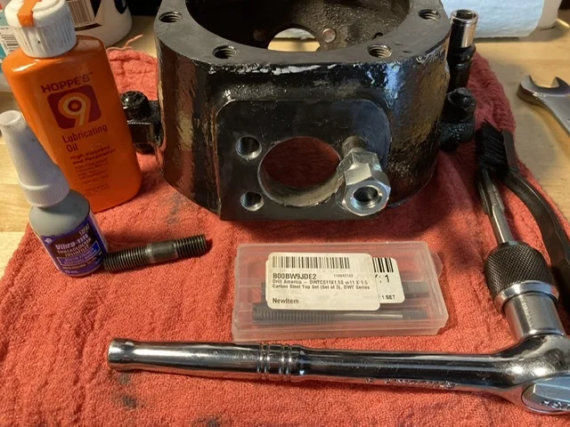

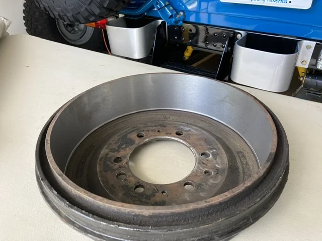

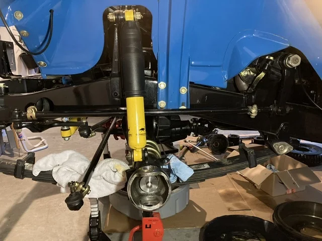

Finished my 1976 non USA drum brake knuckle rebuild. The job took 3 times as long as planned due to ordering the wrong rebuild kit. For South American trucks, with front drum brakes, be sure to order the 9/75+ kits as the wheel bearing oil seal is larger. Also, the amount of degreasing/cleaning/painting was significant.
Borrowed the centering tool from @miller.
Added shims to get pre load at 5.0 lbs within FSM range of 3.9 - 5.0lbs.
All studs were in bad shape so retapped and used new oem studs.
New pads, turned drums, adjusted wheel cylinders (what a blast!) installed new Aisin master and bled system.
New pads, turned drums, adjusted wheel bearings (what a blast!) installed new Aisin master and bled system.
So much more advanced than when I did my disc brake conversion in '94. When I did mine I reused the shims from the disc axle and the nicer set of knuckle bearings, and then threw it all together. Once all together, it had some resistance and moved smoothish... not like with the notched bearings that came out. No FSM, no internet, no one to ask how to do it, and Haynes didn't explain how to convert a drum axle to disc brakes. It was a big Mechano set and I was mixing and matching parts to see what would work together. :cheers:
28 years later and the knuckles are going strong... but past due for a rebuild.

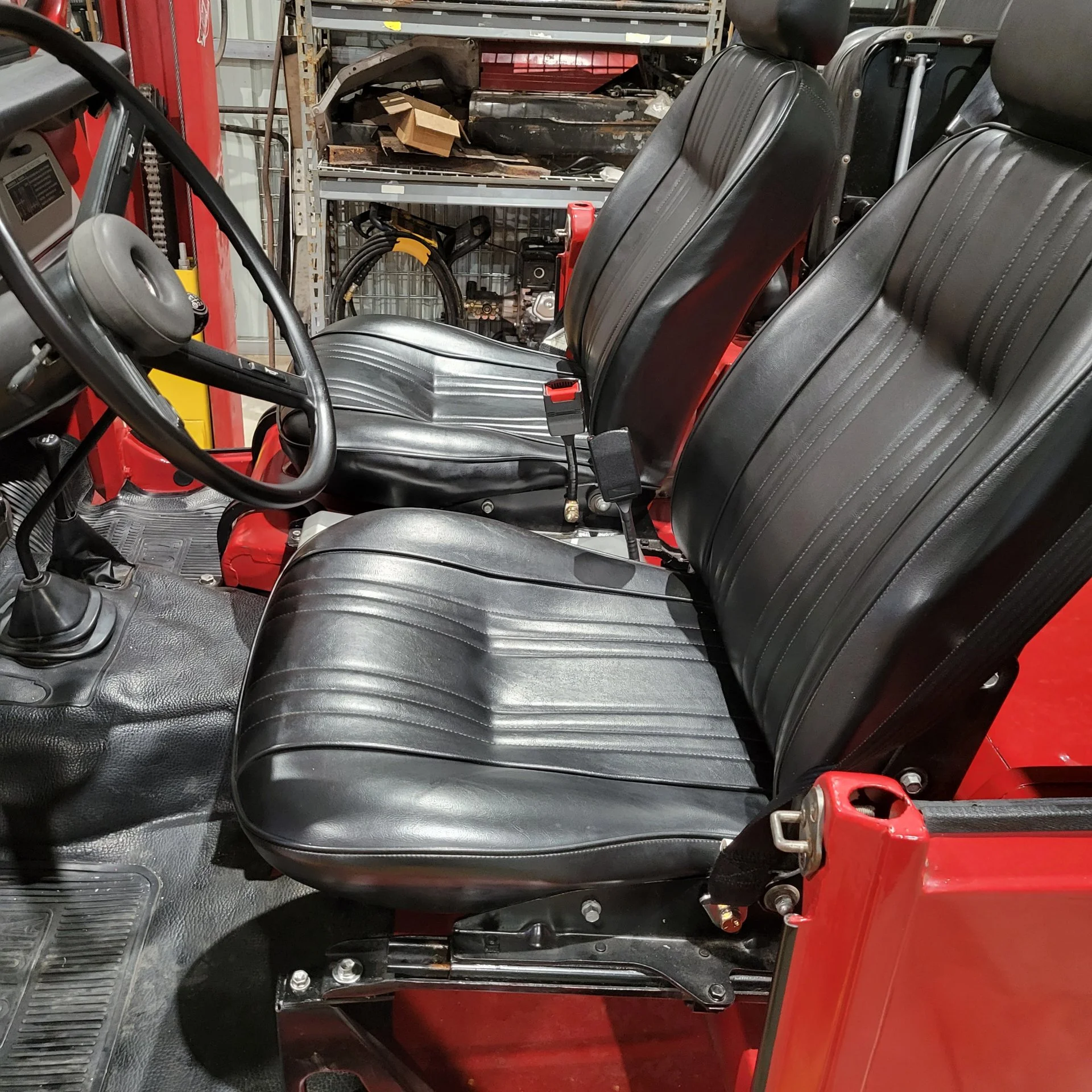

Got 2" of leg room in the '76, then cleaned my shop up a bit.
