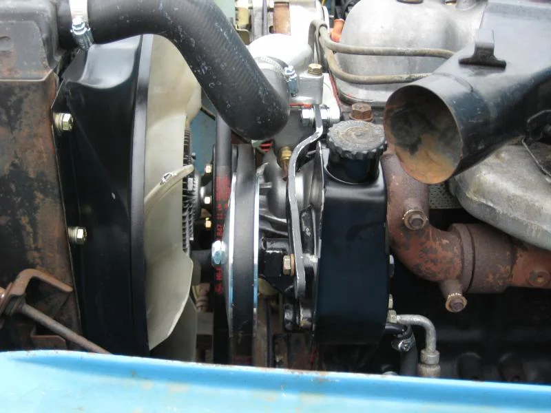

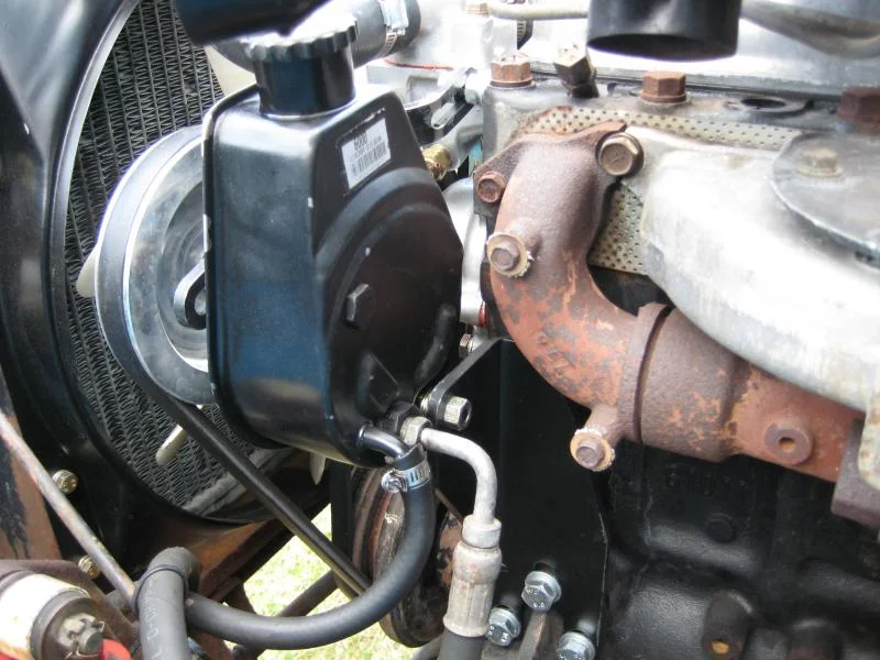

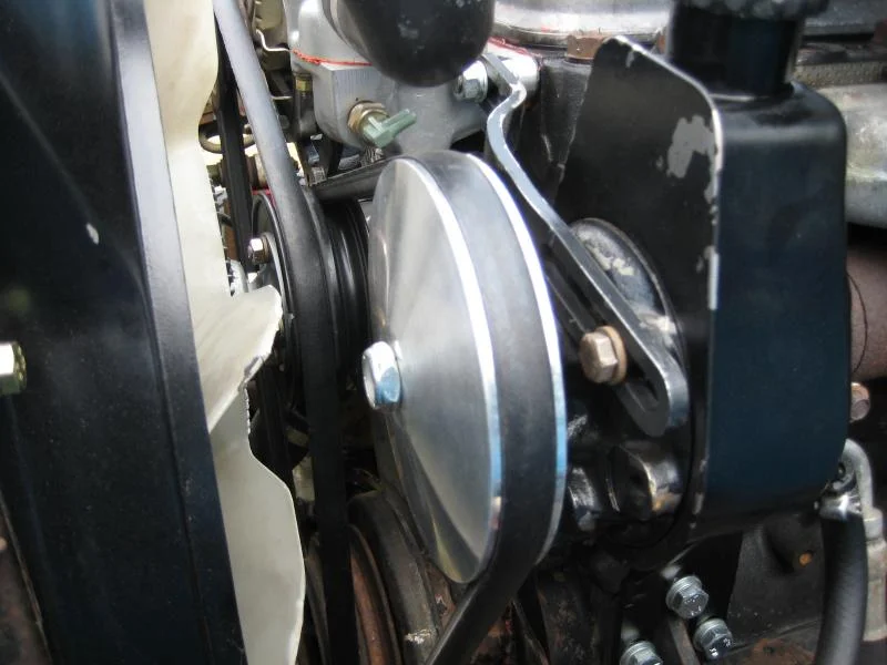

I finally got my power steering pump remounted and it only took me 3 1/2 months...lol. While waiting on new bolts to arrive in mid December I tore my shoulder up. I had rotator-cuff surgery in mid January to reattach two tendons back to the bone. I am now 7 weeks out of surgery and with the help of my son and my daughters boy friend (kinda hard to do 1 handed and needed help tightening bolts) we got her going.

KCruiserm,
Could you post more pix of the bracketry?
Thanks
I got the brackets, pump and pulley from Georg here on MUD (orangefj45). When i mounted the lower bracket on the motor mount bolts it didnt quite fit so i had to grind the top right portion of the bracket to clear the exhaust manifold. After talking to Georg that didnt have to be done because it was designed to fit between the motor mount and the block but it works for me :). From what i have read here on MUD the adjusting bracket is designed to mount on the 5 o clock position bolt on the water pump. I didn't really like that so i bent the bracket to fit on the water housing outlet bolt. This makes it much easier to adjust and get to the bolts.
Here is a link to the bracket info. https://forum.ih8mud.com/merchandis...l-dorry-style-ps-conversion-bracket-kits.html
There are more pic's on this link
Hope this helps
Pretty neat setup......I like it
