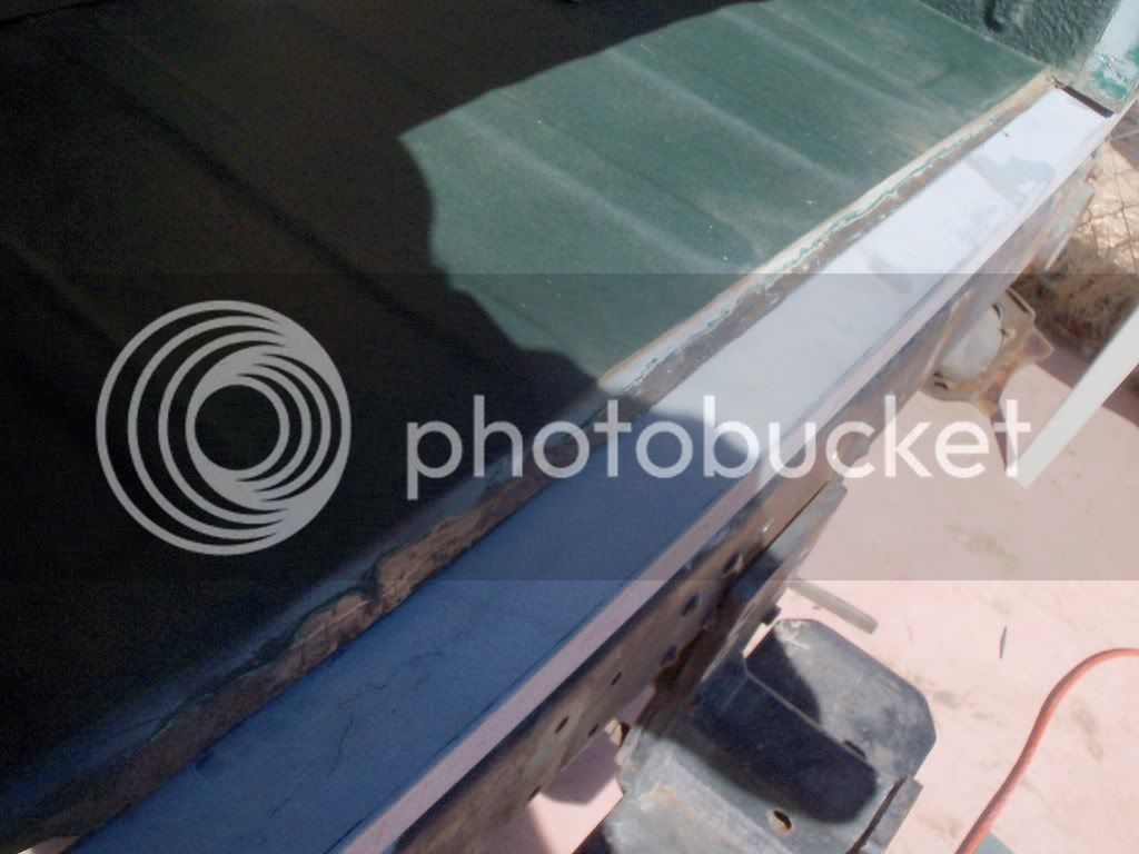

My first post!! cut and drilled this nice piece of steel to replace the cancer.
now needs welding

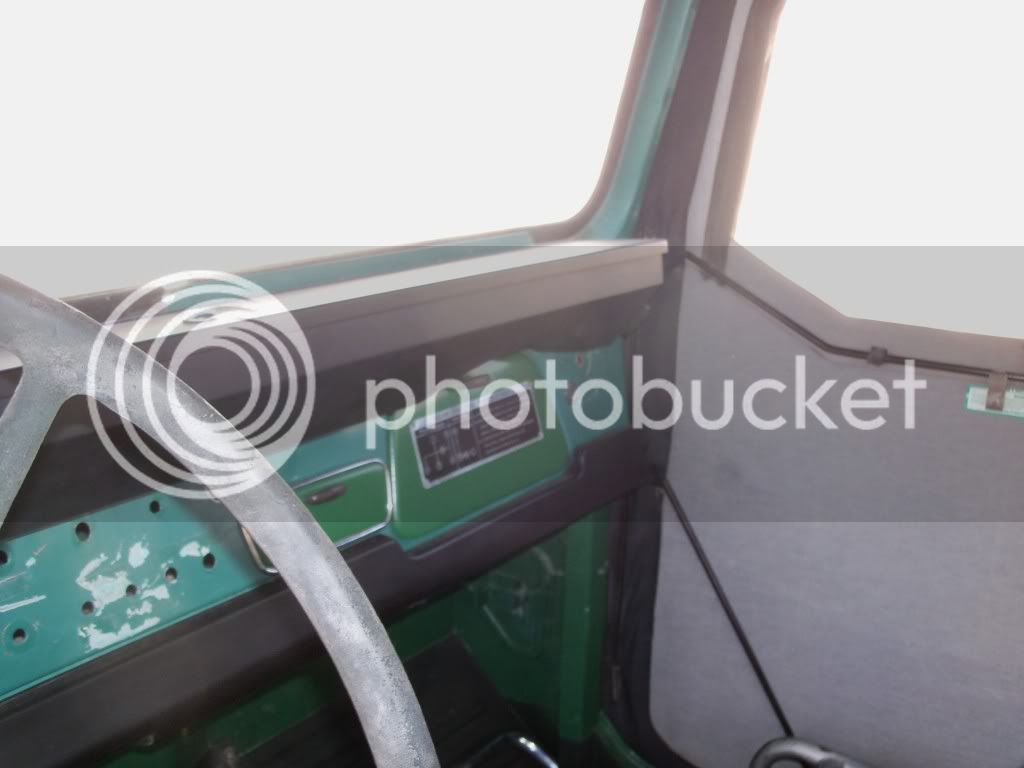

fitted s dash box and new pad as well as painted/ detailed some items

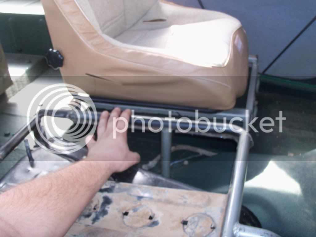

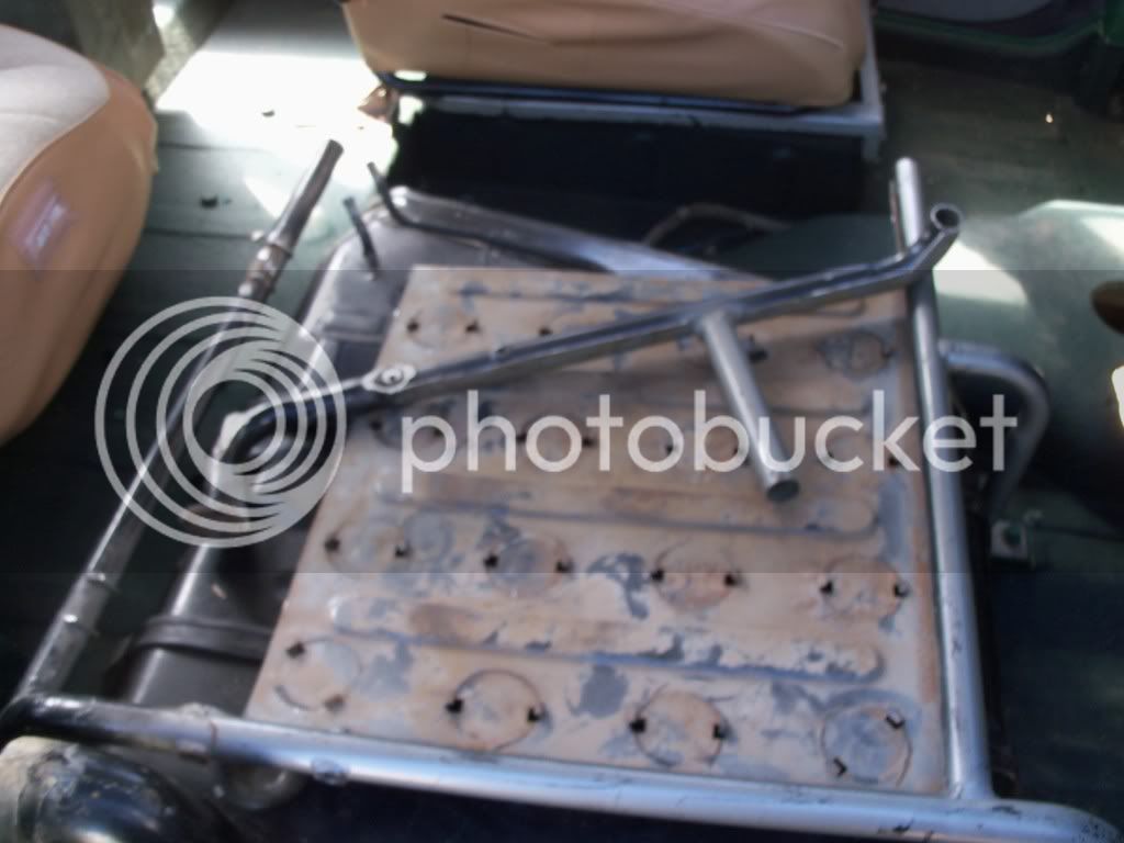

cut up seat frame for custom bucket fitting

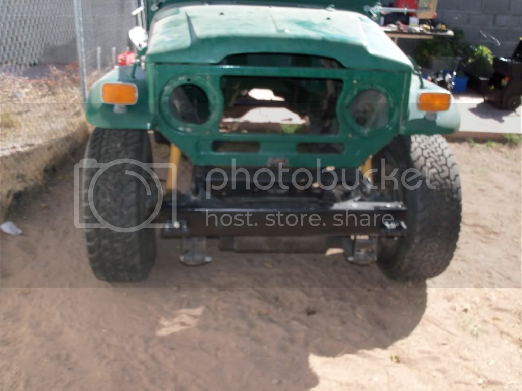

sliced bent bumper ends

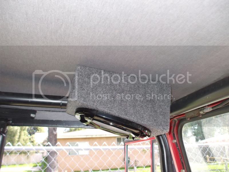

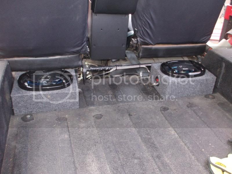

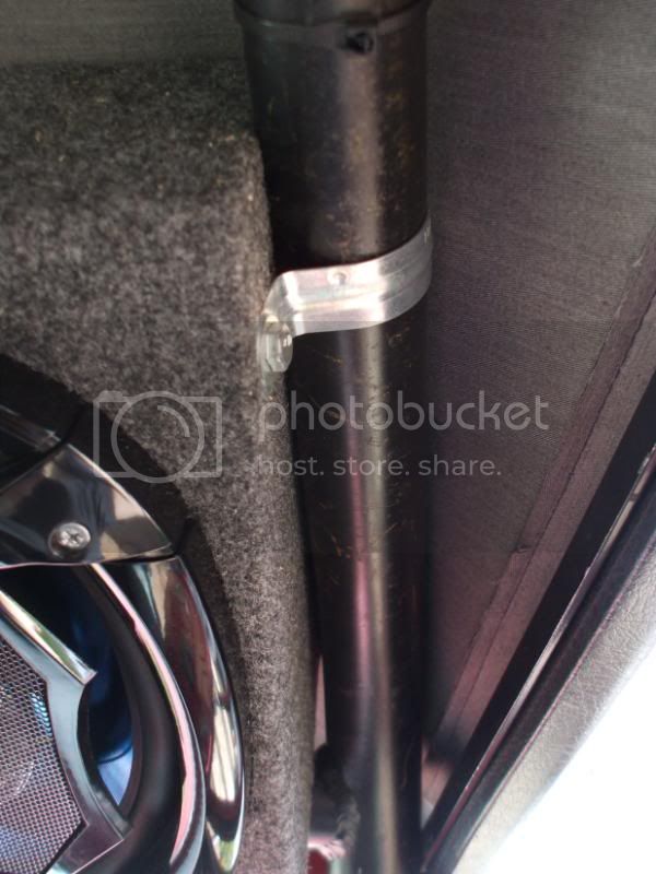

I also installed 4 Soundstorm 6x9 speakers. The front are mounted to the roll bar and the back are bolted to the floor pan.
So now I have good music for my daily commute to work and I can finally shift between Hi & Lo on the transfer case.

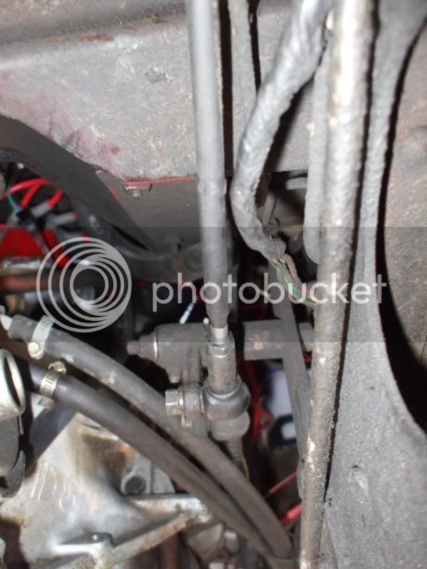

Rebuilt the clutch master with a kit and replaced the slave with a new one. Both were from Beck Arnley and I was pleased with the quality. The kit included all e seals and a new piston. I hadn't realized how bad the hydraulic clutch has been until it was working properly again.
If your clutch is feeling mushy and variable, just bite the bullet and do it before you have to drive home without it.:D

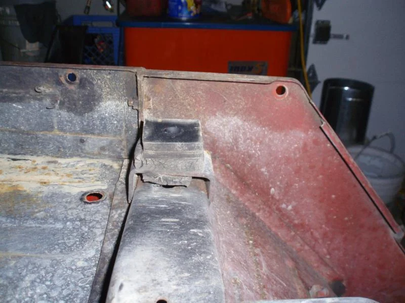

OEM mounts still learning

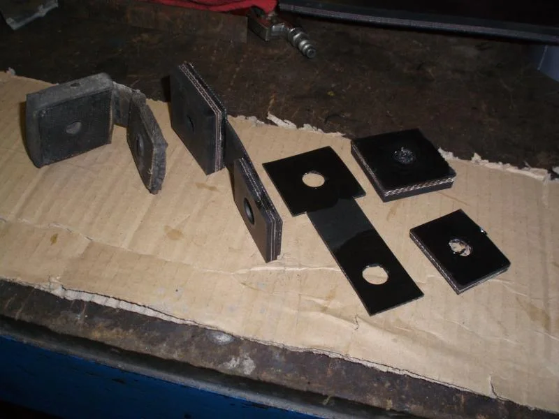

I then sandblansted them and had them plated.
https://forum.ih8mud.com/attachment.php?attachmentid=501817&stc=1&d=1300184753
Then I bought some various conveyor belt material
Cut it to size
https://forum.ih8mud.com/attachment.php?attachmentid=501819&stc=1&d=1300184952

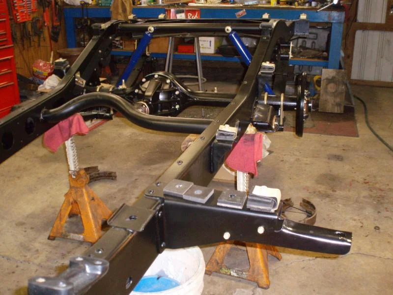

Finally I glued it all togeather with some monkey grip and set them on the frame.
https://forum.ih8mud.com/attachment.php?attachmentid=501820&stc=1&d=1300185114
I was lucky mine were in decent shape and these came pretty good.
I'm still trying to get the attaching thing down --- I read FAQ and got this far but I want to learn to post a comment then a pix another comment and next pix --ect..
anyway this is one of my many resto tasks for my project.

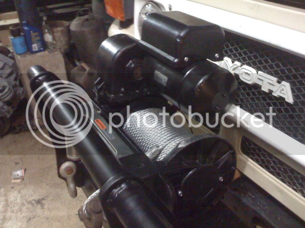

Installed the A1-1000 Aisin winch on the BJ. Tested it on the trails on the weekend...works great. Fast and smooth.
