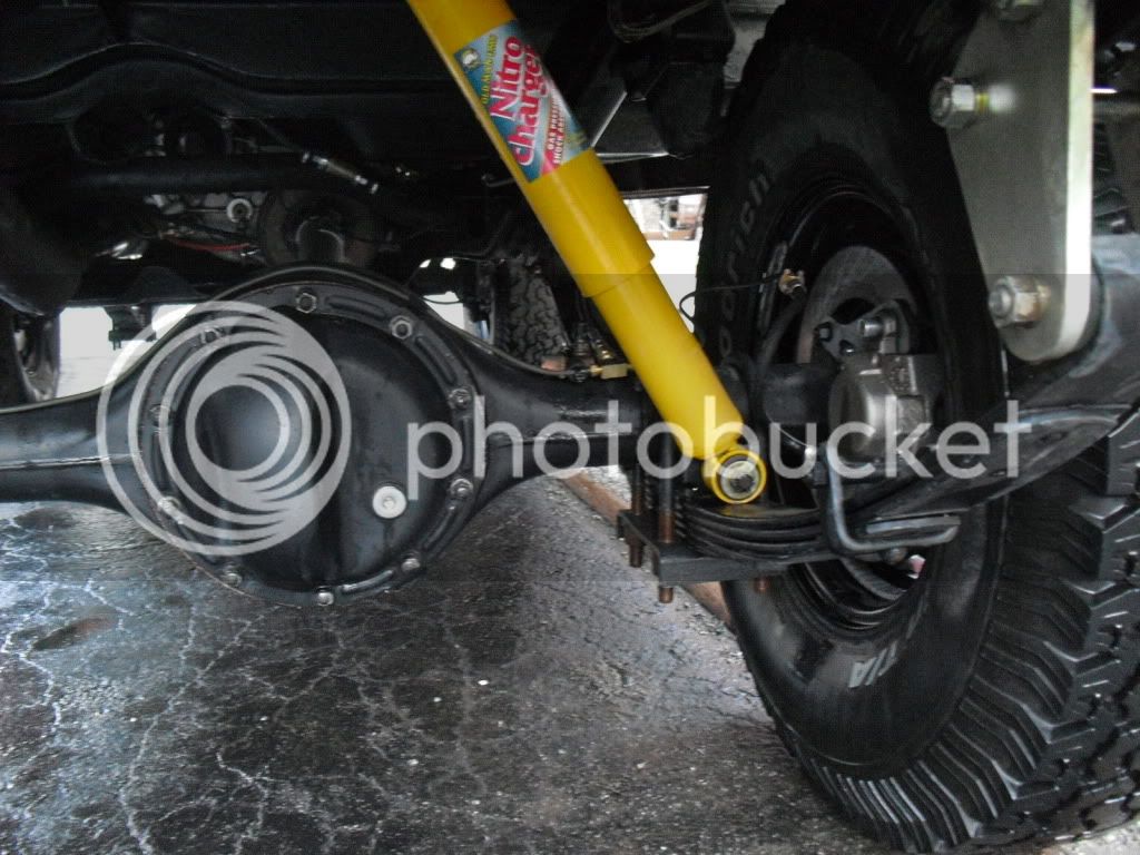

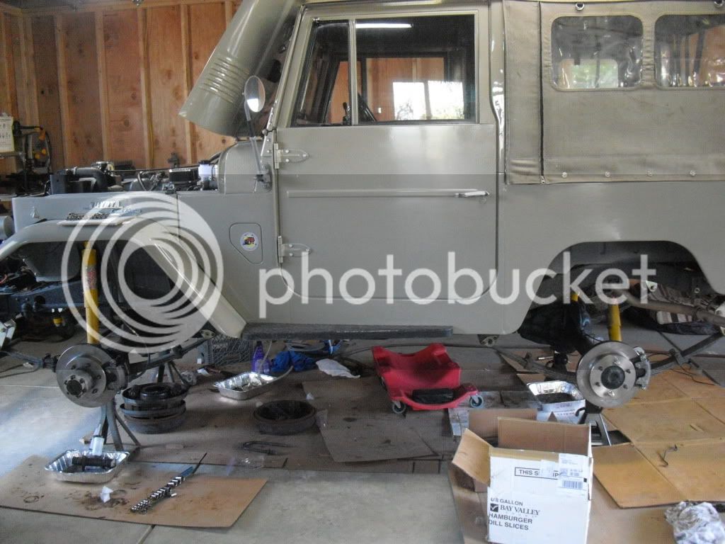

Finished up the discs and installed 4 new Toyota steelies.

No double pumping anymore! I'm running a Wilwood unboosted MC but it stops straight with no fade. I love them. I'm still looking for a disc front axle but went ahead and used the JT Outfitters front bracket with the Monte Carlo calipers and Poser's brackets and discs in the back. If nothing else, I'll be out the cost of the brackets when I find the '76+ axle, but I have to say it was pretty easy and a lot safer than what I had.
This gives me a little breathing room and I won't have to worry about that single circuit master anymore.
hands down my 4 wheel disc was the single best upgrade i ever made to the 40 as its been my DD for 18 years... my 2c :D
I converted to discs in stages...
Front discs was my single best upgrade, and rear discs was the next best. That's in ~20 years and 90,000 miles.:D
