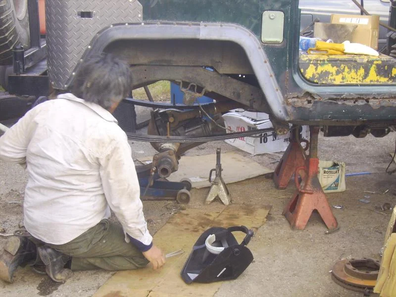

put the F100 springs and the 14 bolt lined up. here's My friend Javier making sure the weld on the perches are good hopefully this will bring my wheel base to a 97" ...and yes the drive shaft will be a short one.
