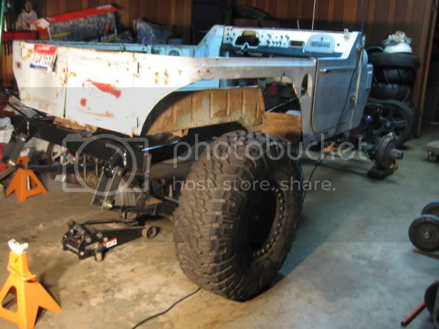

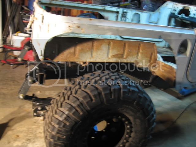

This week my bro and boxed in the rear of the frame, finished fabbing and attached a new rear bumper complete with inset lights and receiver hitch; welded in support struts and built/attached new spring hangers. Also moved the rear shackle hangers back several inches to get the overall WB to ~102".
Next week is to cut the rear wheel-well openings to allow for the moved axle and get the rebuilt axle installed with U-bolt flip kit and start the prep to get the new (to me) SM465 installed.
