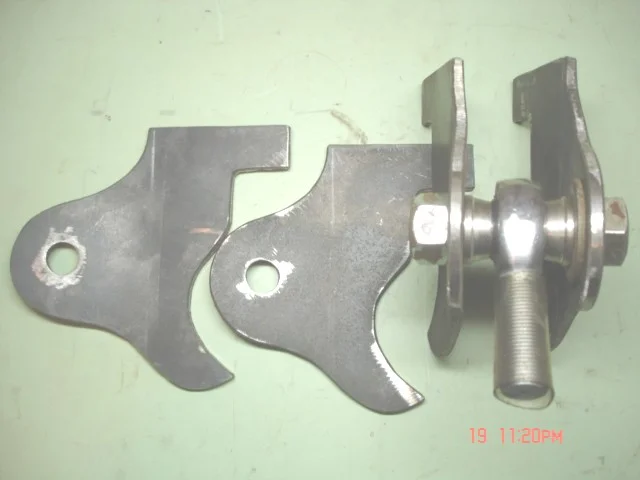

I switched over to the 40 until my new 35 splined axle shafts arrive from being cut & splined for the :pig: :bounce2: So, I've already started fabbin up the hybrid axle & the lower brackets for the links. The brackets will be fully boxed & yes, they're bent to match the angle of my lowers. You can see how one bracket is longer than the other. It's a redesigned y-link suspension.

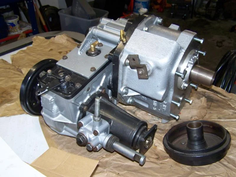

Got the new (to me) SM465 prepped for installation. Assembled the NP203 GRB to the LC T-case, and finished detaching the body in preparation to measure for the lift I am going to need to clear the new drive-train.

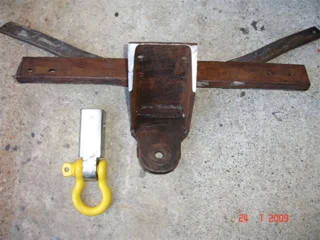

Anyway here's my bit............... Decided to modify my towbar. Here it is before modifications: (Well - Actually I have already hacksawed some steel off the top of the channel section.)

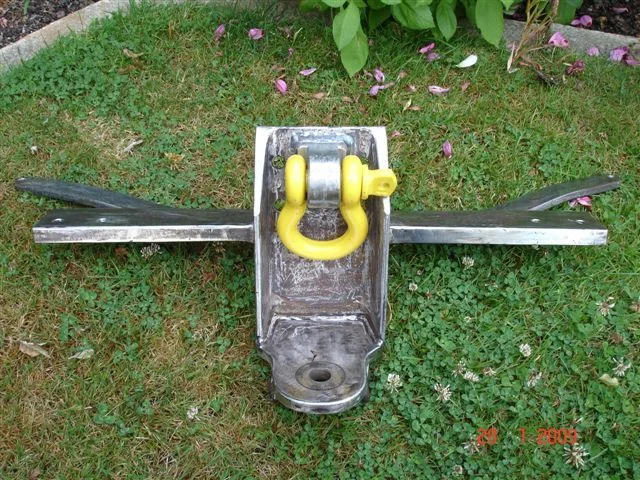

Here it is with a "bow shackle receiver" fitted:
At the same time I ground out all the "bird**** welds" and rewelded them myself:

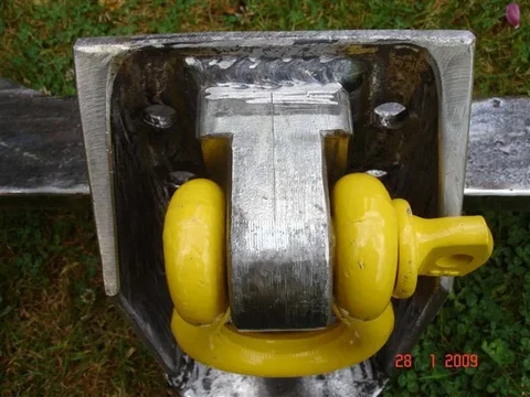

The "bow shackle receiver" was inserted right through the channel-section and then I welded BOTH sides:
But in case that isn't strong enough, I'm fitting a thick backing-plate behind the rear bumper/crossmember with 5 bolts going right through it to secure the towbar. (And there are another 6 smaller bolts holding it in place too.) One of these 5 bolts threads directly into the "square-section" of the bow-shackle receiver ........and all bolts will be high tensile.
