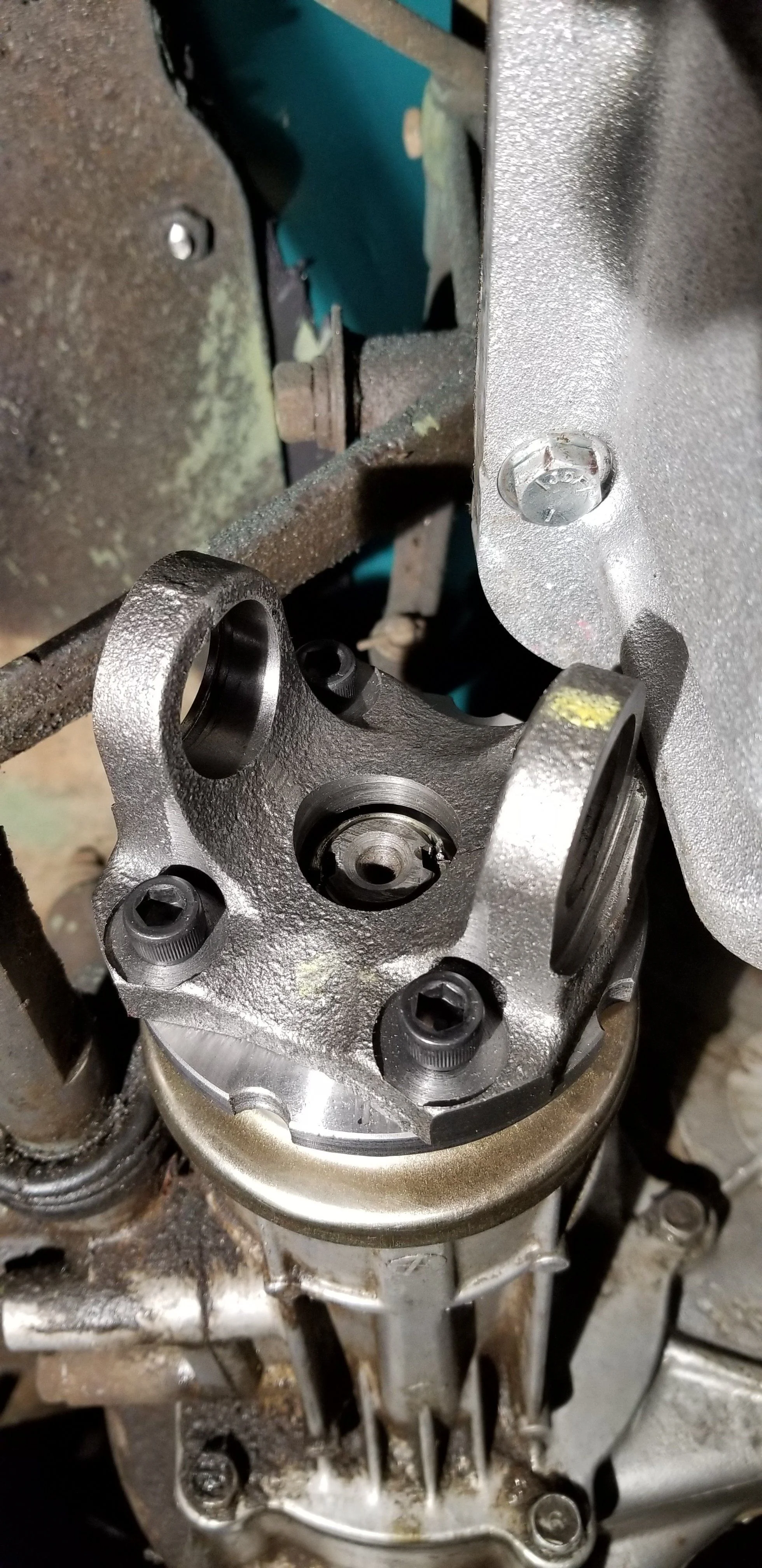

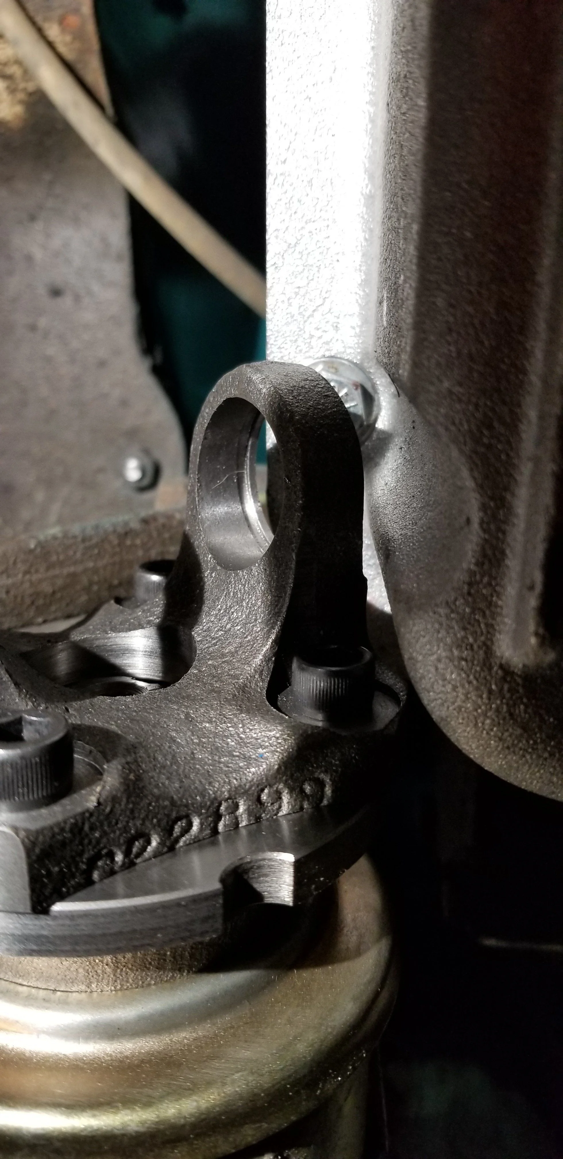

Started to investigate why I was dumping so much transmission fluid. I think I posted earlier that I installed a speedo block off which was a considerable upgrade to the bleach bottle cap.
Then I noticed the heavily dented transmission pan (tb400) and ground down pan bolt. Went through 2 pans before settling on the B&M cast aluminum pan. Now the skid plate needs to be reworked to cover :confused:.
After research, learned about the clearance issue with the front drive flange/yoke and the turbo 400 trans. I bought the new kit from AA and installed the flange last night. Look at this clearance:
That's tight!
Now to have Drivelines NW replace the yoke, I'll be back in clear 4x4'ing.
