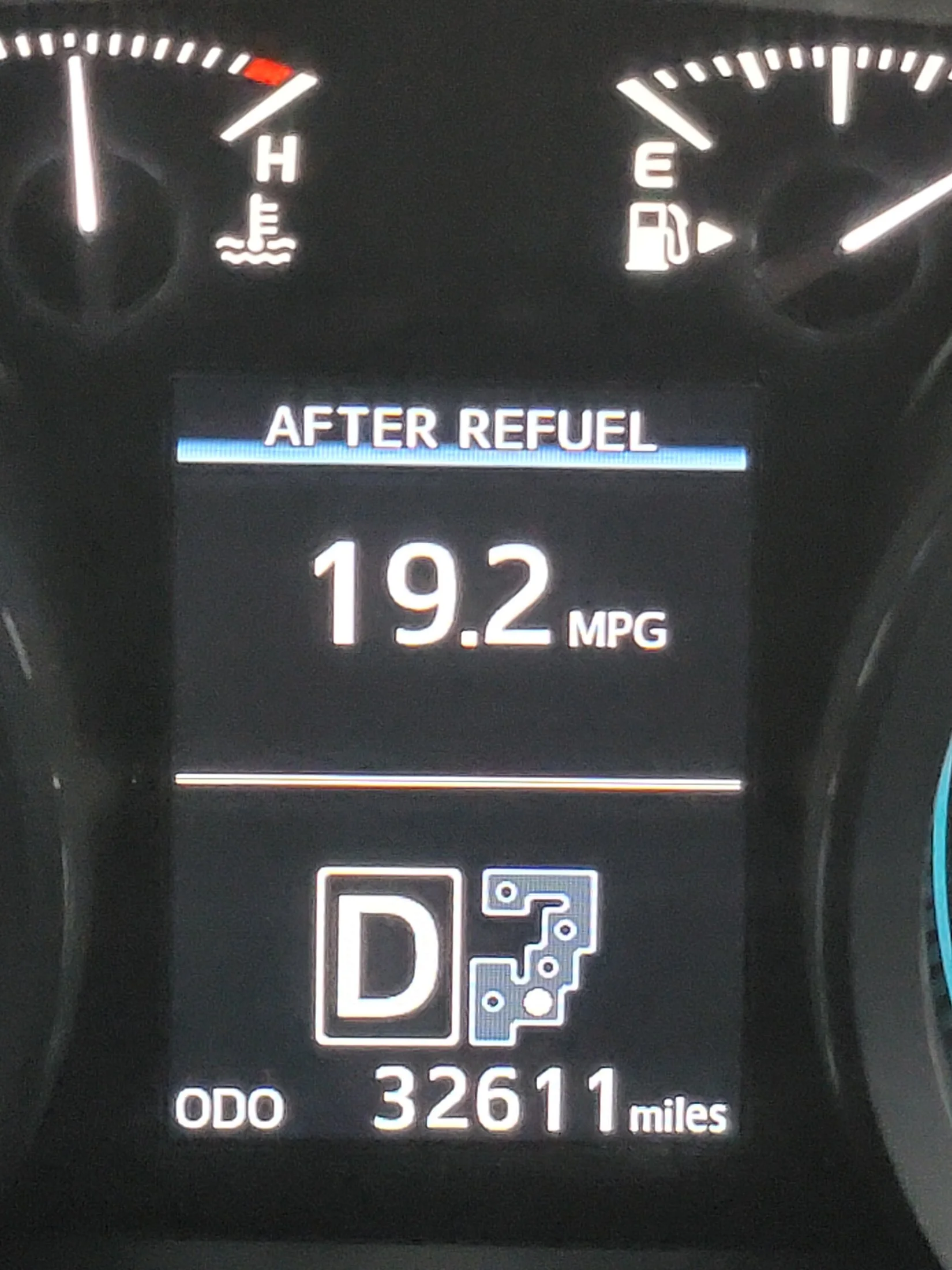

How? What kind of lift do you have? The best i'm getting is 13.5-14 on 285/75/17 and a 2.5" lift.
Just a guess, but low speeds, tailwind, and/or downhill.
Stock-size KO2s by themselves will kill 1-2 mpg all else being equal.
Wow, that is pretty bad! I'm only seeing that mpg in city driving.
Mine has Eibach Stage 1 suspension - 1.75" front, 1" rear on 285/65/18.
Surprisingly no. This was achieved going 65 mph on a highway, just normal driving over a roughly 20 mile stretch. No cruise control, no downhill, etc.
I'd consider 65 relatively low speeds, personally.
