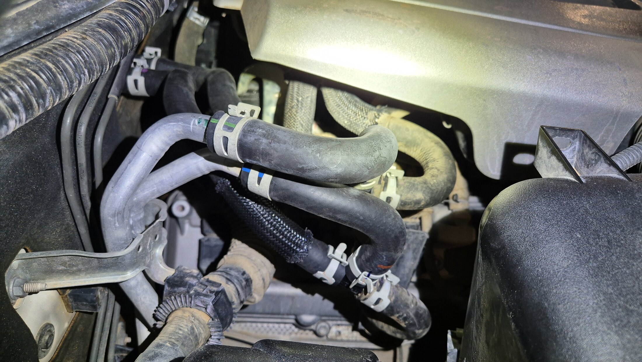

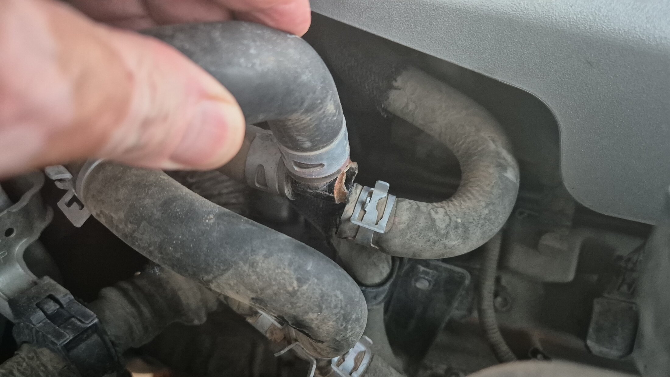

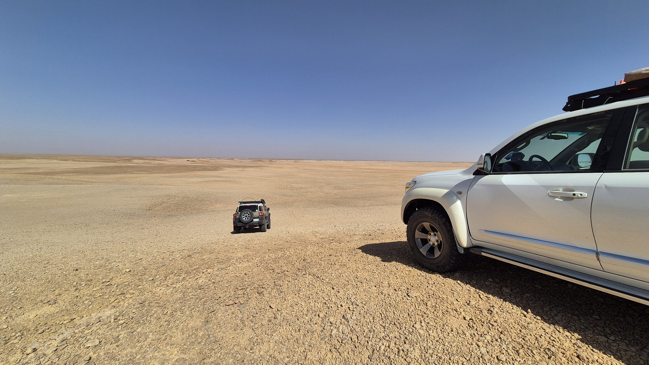

Short daytrip to the Khasm Nufayk area north of Riyadh. Started good enough with some nice scenery but at some point the LC suddenly quit without warnings or alarms. Trying to restart didn't work, seemed like the battery had died. Upon inspection under the hood it appeared a T-junction in one of the cooling hoses had snapped, dumping all coolant so quickly it never registered a temperature warning. The failure to start was due to the engine overheating so badly that it seized....

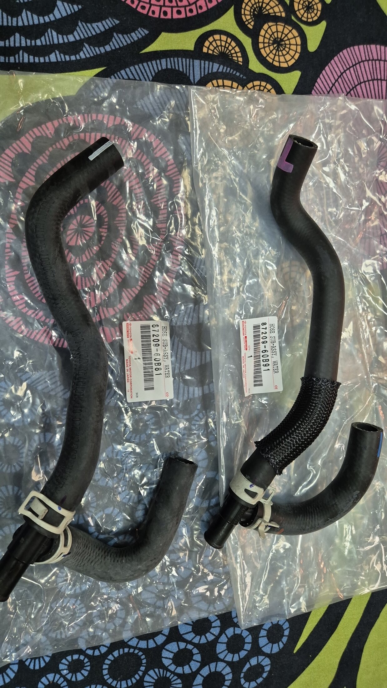

Towed the car back to the road, got a tow truck home, and ordered spare parts. Toyota doesn't supply just the T-junction, you unnecessarily have to buy the entire hose set but what else can you do. Upon further disassembly it appears the plastic of the T-piece was in very bad condition, you could simple tear it apart like wet cardboard. Just to be safe, pulled apart the return hose which was in the same sorry state. Reinstalled both new hoses a few days later, filled up the radiator and started the engine which works fine again, no obvious damage from the ordeal.
The cooling system is composed largely of high quality rubber hoses and aluminum tubes which are all in excellent condition. For the LC200 version with independent rear climate control, an extra branch in the coolant circuit is necessary for which this s*** quality plastic T-junction is used. Do yourself a favor, put some pressure on this junction and see if it breaks. Better in the driveway than out on the trail.... It is located on the right hand side of the engine just before the bulkhead.

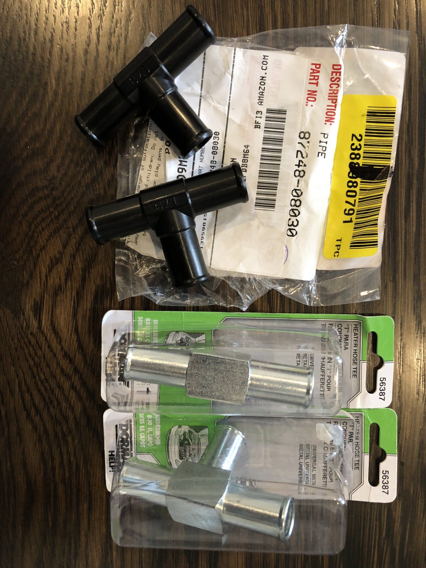

Dang, that sounds like a terrible place to experience this failure. It's good to hear you didn't suffer any apparent damage from the catastrophic overheat. There's a lot of discussion here about those heater Ts on the earlier 200s and the change in plastic Mr T used to remedy this:

I noted in the parts manual that the original part is discontinued, this updated part will have the better plastic I assume. Used new clamps on all connections.

You cleaned things up well after than catastrophic coolant leak. It must have been everywhere and a huge mess.

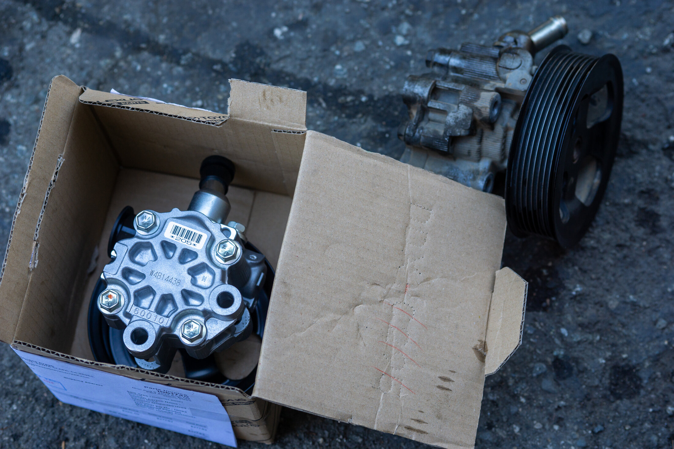

Actually it was a couple weeks ago, but I installed a shiny new power steering pump. The old one kept going out on me. I think it's because there was a very high probability the power steering fluid was original on this 150k vehicle. :doh: I tried flushing with fresh fluid but that only made the pump act worse.

It doesn’t look THAT shiny. Maybe polish it up a bit with Simichrome? How’s life in Santa Clara? I lived there for a short time way back in the late 70’s.
