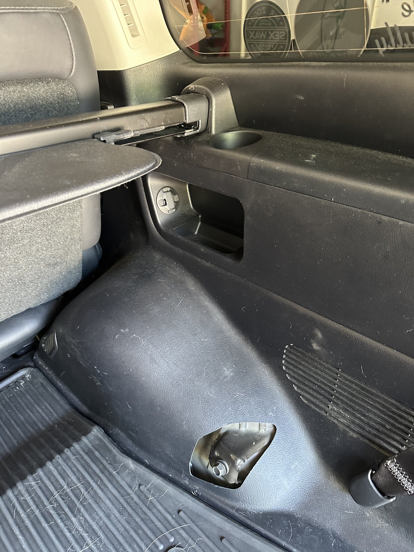

I've done this a while ago -- but I converted my regular LC200, to the Heritage trunk (rear seat delete) with all OEM parts to make it factory.
Can share pics if anyone is interested -- was fairly easy to do and costs circa $800 in parts
Yes please post pictures.. curious how far you took it..
Yes, sure thing -- I did EVERYTHING minus covering up the mounts for the 3rd row with new seats (as I wanted to have that option should I ever need to re-install them).
Here are a few photos of the whole thing -- can share part numbers if someone wishes to copy
- oem tonneau
- changed cup holders to mount tonneau
- heritage trunk mat
- tonneau mounts at rear hatch
- did NOT hide 3rd seat mounts and left seat belts installed and stored

Looks great, Was thinking of doing the same thing with my 09 LX570.
Do you by any chance got the parts numbers ?

I forget exactly which bolt it was (it was a small one) but I didn't order enough of them and had to run to Ace hardware to get something similar -- it wasn't a critical part but it did it's job.
I think I was short 4 of these tiny bolts.
What are you going to do with the original cup holders? I have one of the original KAON shelves before the side panels were included. They later sent the side panels to all purchasers, but they interfere with the tonneau mount. So if you're willing to part with them, I'd be interested.

Where did you order the mat?

Yes, I'd totally be willing to let them go. I have all of the takeoff parts sitting in my garage.
Send me a DM and I can get these over to you.
@CactusHopper I believe I ordered all of these parts from Toyota of Long Beach, CA even though I live out of state -- they had the lowest prices at the time

I hadn't seen that mat available in the US (only australia) that's why I was curious. Thanks.
