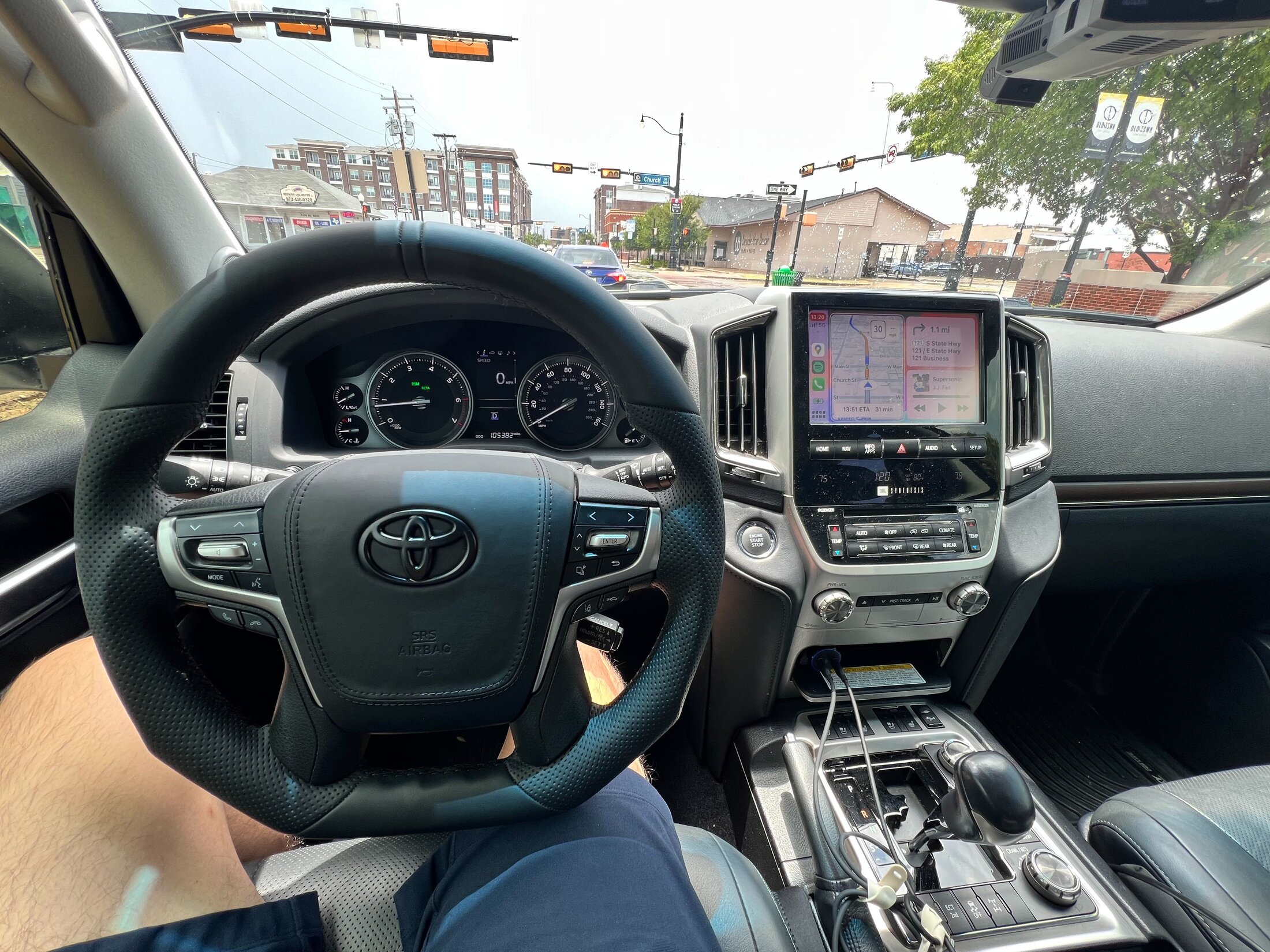

Upgraded my steering wheel and added Beat-Sonic Apple Car play harness.
How did you murder out the toyota logo?
I had a custom wheel made for my Supra and made such a tactile difference I looked into making the same style for the LC200. Logo can be chrome, glossy, matte, and even carbon fiber. Just came in yesterday and got it installed today with the Beat-Sonic. Berktuning.com is the company in Florida. Philip sources the OEM core from various places and that gets shipped to Hong Kong. Once completed, sent by DHL to you. Took 32 days from order to delivery to my door.
were they able to retain the heat and all of the controls in the steering wheel?
Yes to heat. Volume and phone buttons all work. The only thing that does not work is the toyota voice command (which I don't use at at all) which is locked to the toyota system. This video was helpful.

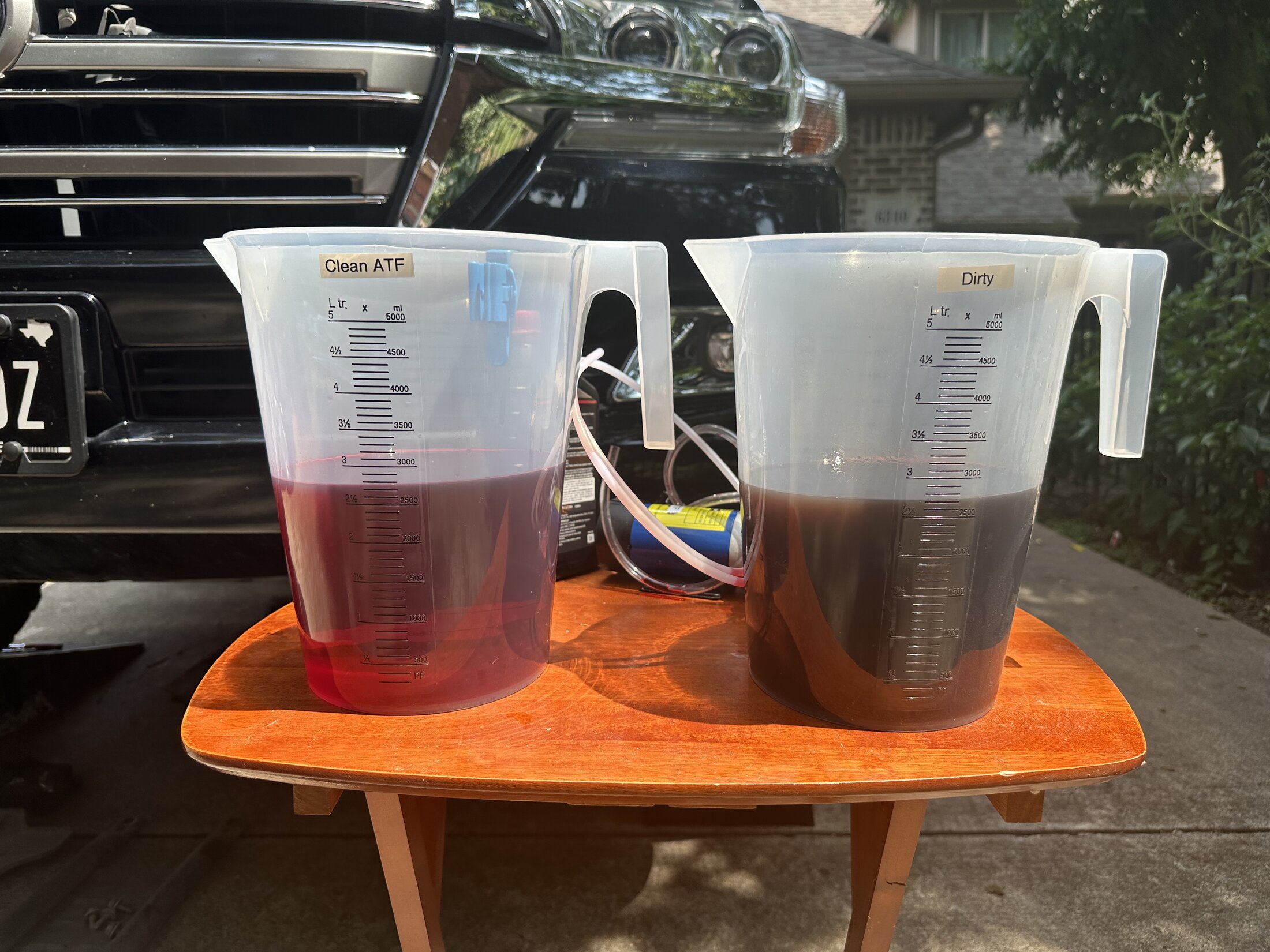

We had a “cold front” coming through this weekend (high of 92) so I knocked out the ATF exchange I’ve been putting off. Figured out the hard way that the return line is the bottom line on the 8-speed, not the top. Now I’m pressure washing my driveway.

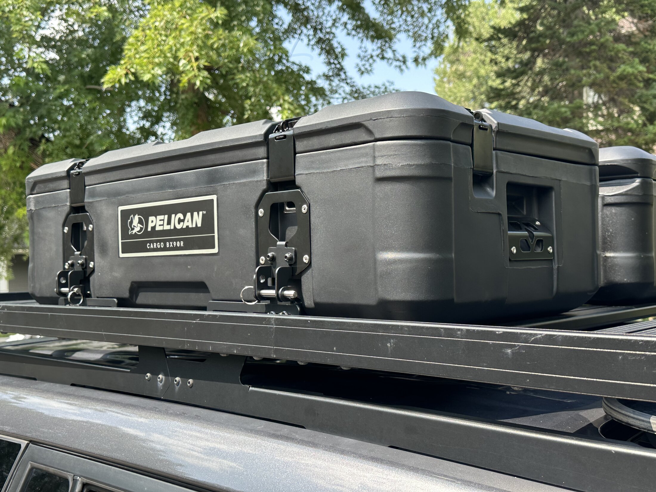

Added two Pelican BX90R Cargo boxes & mounts to the FrontRunner rack. Mounts are quite sturdy and easy to use.
Could likely fit two more if I moved the mounting from center of rack to two in front / two in rear.
No noticeable additional wind noise at 85+ highway speeds and no rattling at all. The sealing of the box is typical Pelican - expect it to be quite good. But - haven’t driven in a big T-storm at highway speeds yet to confirm
Loaded them up and am off with 4/5th the family from CO to see the remaining 1/5 who’s in MT for the summer. Surprisingly large capacity. Helps alleviate the overpack tendencies of wife & daughter leading to much lower stress trip prep… “Sure honey, we can take that, toss it in…”. That’s worth the price alone.
