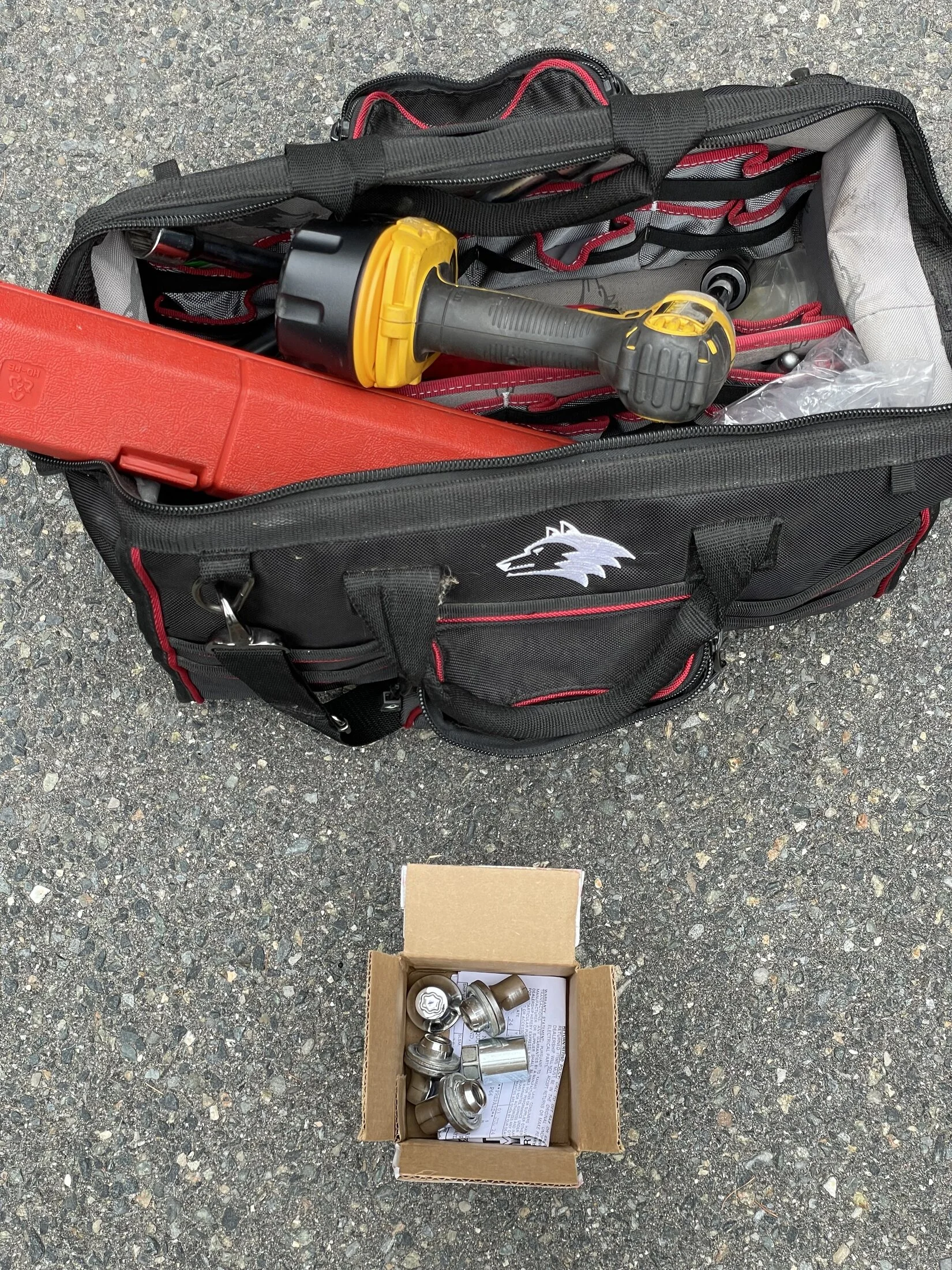

Finally got the Icon wheels installed. They were sitting in our back room since last October.

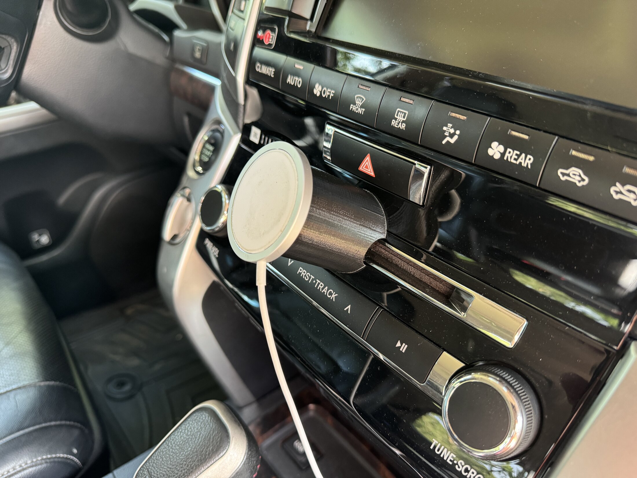

Designed and 3d printed a MagSafe dash mount. This is a work in progress, but for those of us that have modern iPhones, don’t want to block an AC vent and don’t use the CD slot, should work great for charging and navigation.
I’ll probably widen the upper contact area to better distribute the load and rotate the phone more toward the driver. For now my free version of Fusion is struggling with the 3D scan I have of the dash profile.. but the whole thing is an interesting project that I’ve been wanting to work on for a while.
Looks good! Interested in the finished product for sure!
What 3D scanner are you using? I need to get one to start making things for my 70 series.
Thanks!
It’s a revoscan pop 2 that I got used from a friend. It has given me a fair amount of trouble but that could very well be user error. Too many irons in the fire to really dial in any specific one.
I had to use blue painters tape on the dash to get a good scan (no surprise - piano black) and now the real challenge is that even with a number of simplification steps the number of triangles is a lot for Fusion to process into a solid. But as I said, I probably need to work on my processes. Just wanted to get this thing in place for a trip in a week.. will work on the details when I get back.

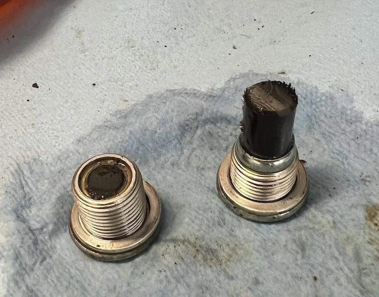

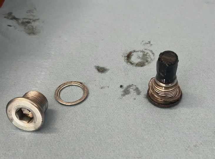

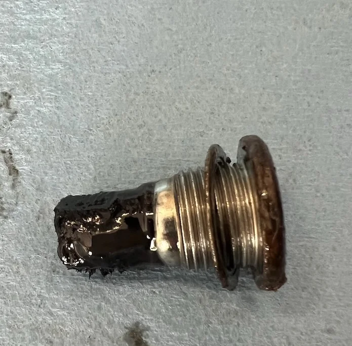

Did a fluid change on power steering, front and rear differentials and transfer case. These had been done before at 28k and back then I upgraded the drain and fill hardware adding magnetic versions where applicable. No problem getting loosened.
Used Ravenol 75-85 again on the diffs and Ravenol 75W on the transfer case. Old fluids didn't look too bad.
Rear Diff (easiest) with sludge on the magnet drain.

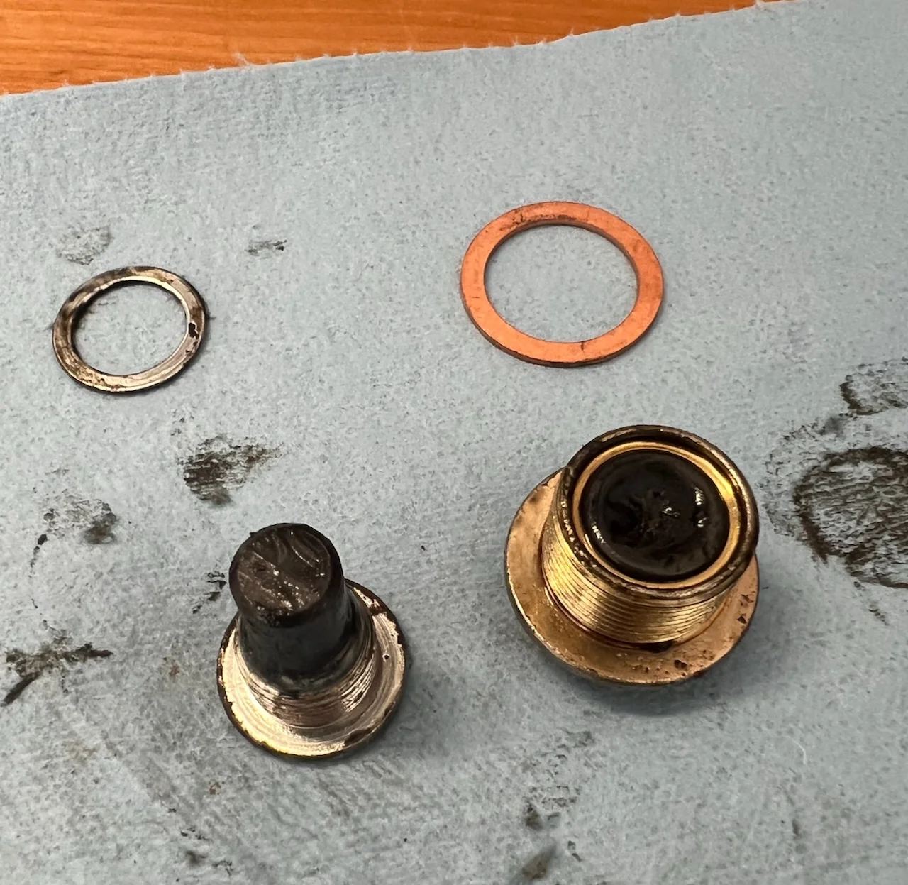

Front diff. with sludge on magnets.

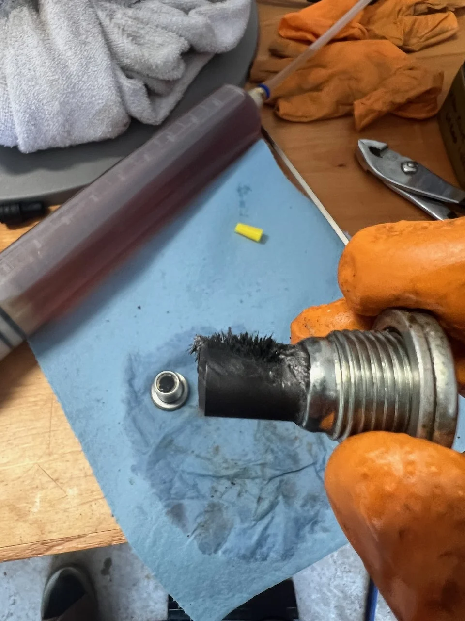

Transfer case had some fine metal on the magnets.

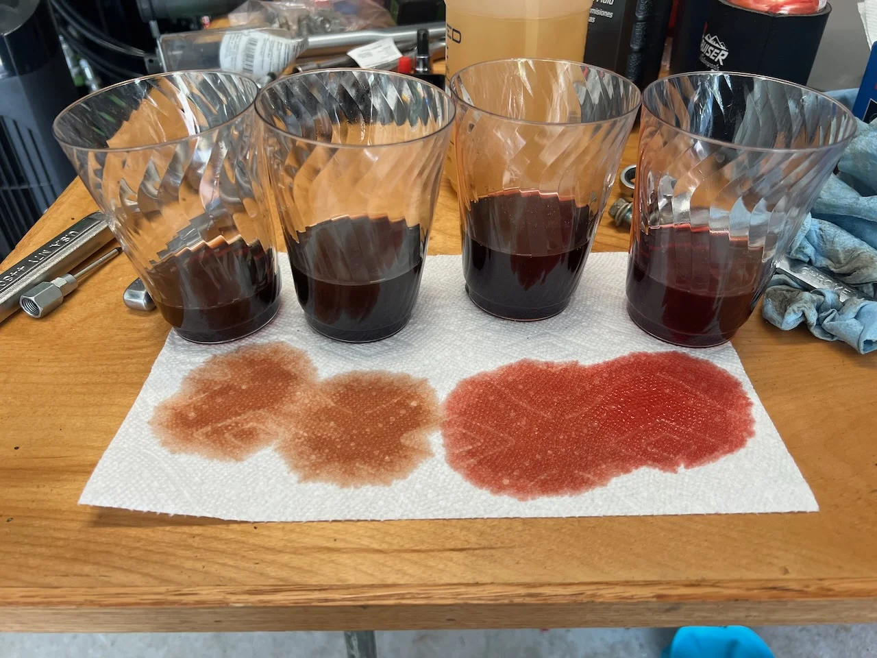

Finished up complete transmission fluid swap this AM after ATF cooled down.
More info on the transmission fluid flush on another thread.

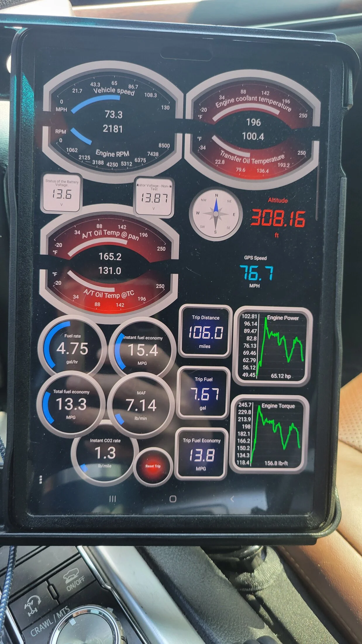

Getting close to 100k miles, Decided to hook up the obd2 to tablet for real time monitoring durinh trip to Montana. Nice to be able to see what's going on at highway speeds and on trails/mountain roads. Definitely a permanent addition going forward.

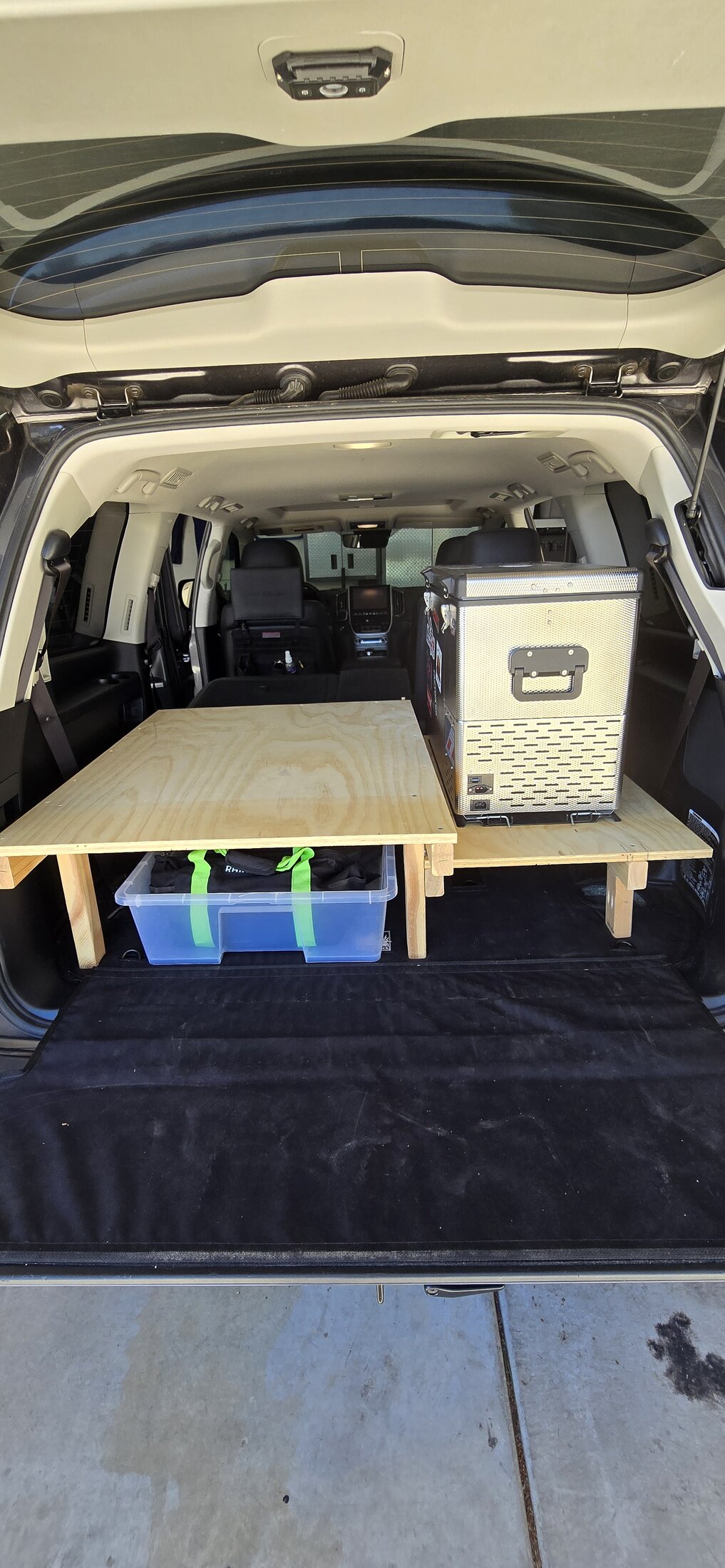

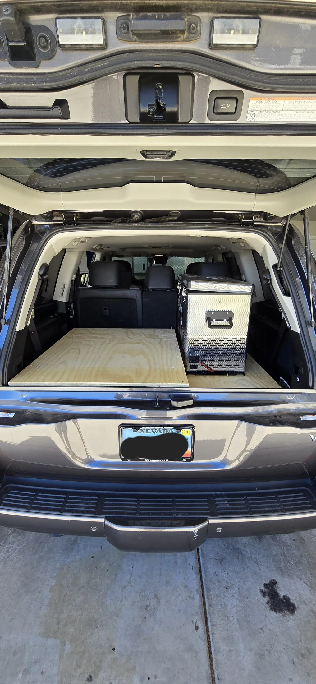

Modified my DIY low rent sleeping / storage platform after removing 3rd row seats and acquiring a fridge. The sleeping side fits the Exped Megamat long x-wide I picked up as a steal at the REI resupply section yesterday. It was returned after one inflation because they said it inflated too slow. I paid $96 after the member coupon. I couldn't believe it. I still need to mount the fridge base to the platform and then try to optimize packing all my crap back there befire July 4th trip departure.

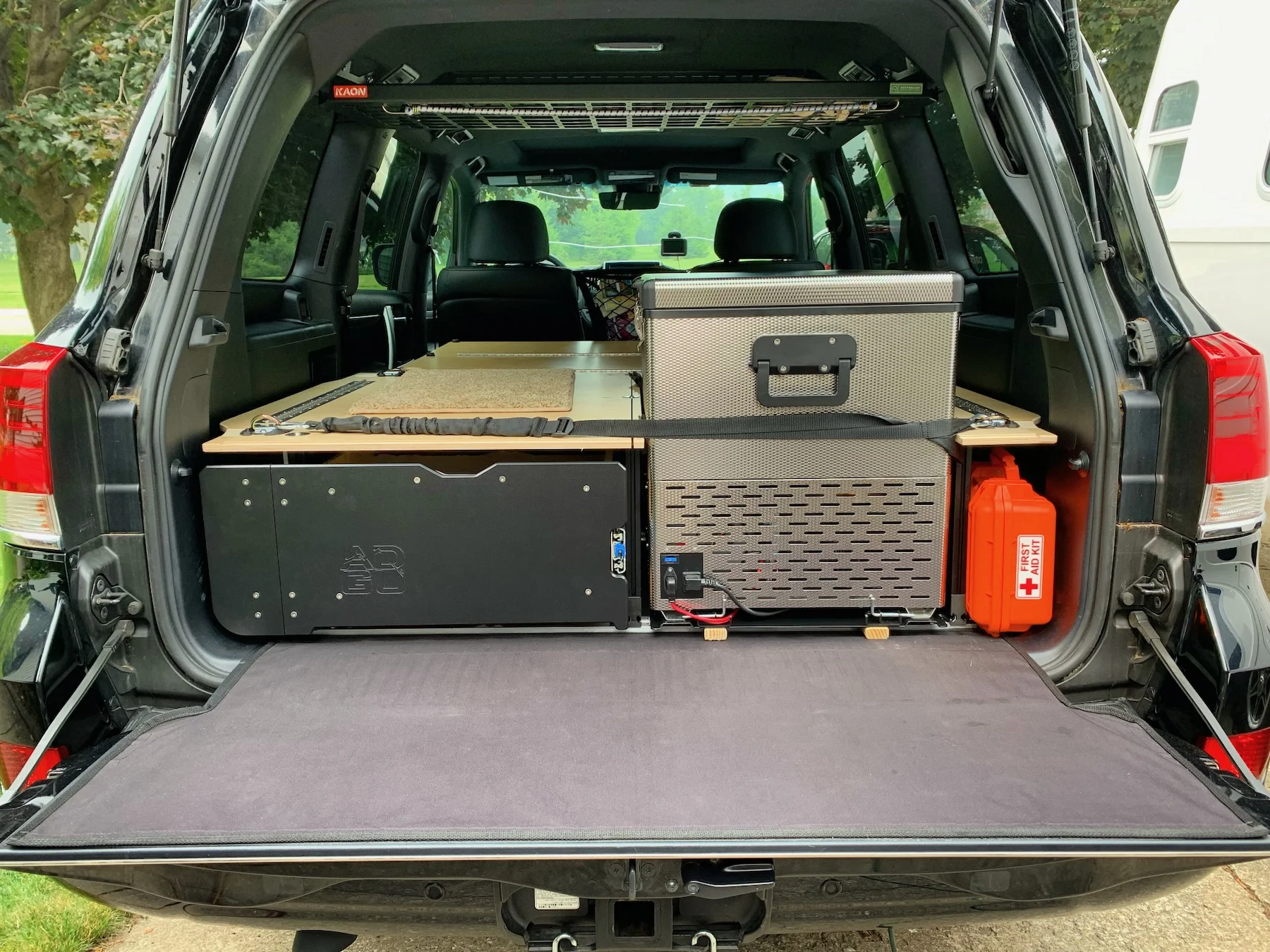

What are you going to use for a slide for the NL Base Plate?
In my setup, I didn't have enough width to run a pair of slides vertically. So I used a pair designed for flat mounting with 180 pond rating per pair. But pulling the fridge out about half way and it sags enough to require I help by lifting it a bit. And that's with the slide empty. Currently, I lay a 2X4 on the tailgate before yanking it out to minimize sagging...
Photo from mocking up the slides to make sure I would close the lift gate struts.

I didn't use any slide. I bolted the base plate straight down to the platform and I have to use brute force to get the fridge on/off the locking base plate and in/out of the truck. It sucks but the point of my DIY platform project for me was that it was free and quick. Fridge slides are like $500 from what I saw. If I ever upgrade to professional drawers or storage then I'll go with a slide setup. Or maybe I'll build my own fancier setup with a slide someday. But for now I'm still young and dumb enough to brute force the fridge in and out of the truck when needed.

Yep, I did too. But mine is just the basic platform, one drawer, and the second row seat delete. So less than 1/3 of that price. I built my own fridge slide with drawer slides and aluminum bar from McMaster~Carr, so under $300 there. And at 70 years old, there's no way I'm moving that 90 liter fridge It's 70 pounds empty!
