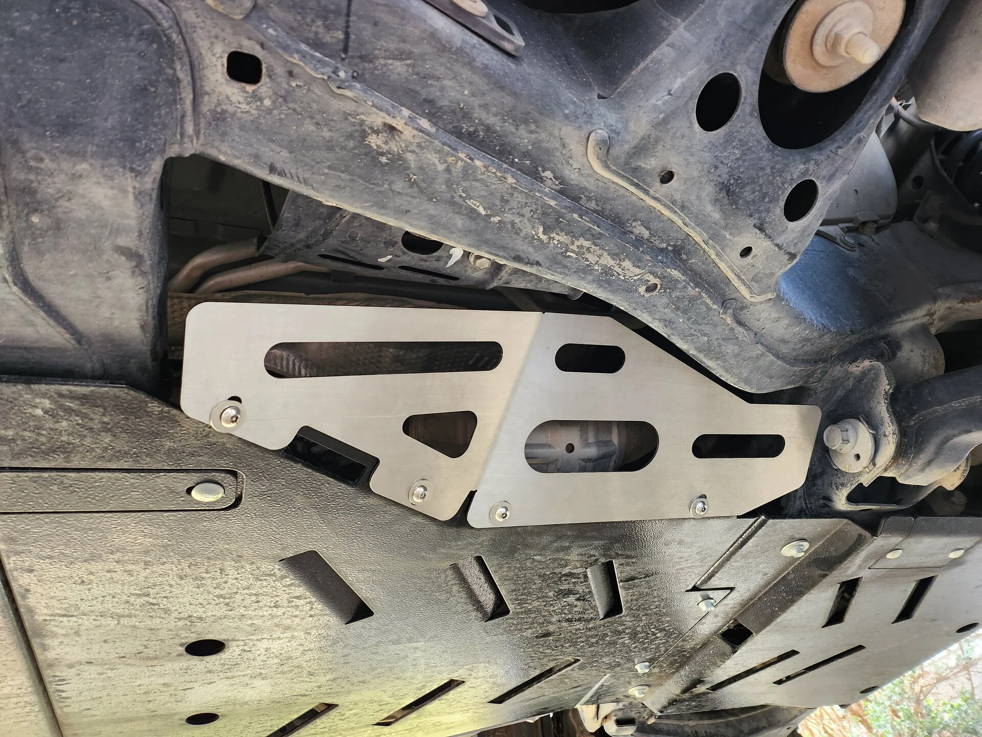

Added Slee cat guards to the skids. Straightforward install, but the security (keyed) allen bit they provided was barely too small and started stripping the bolts at 10 ft-lbs (their install video says to tighten to 15 ft-lbs). I had to switch to the equivalent security torx T30 that I had on hand.

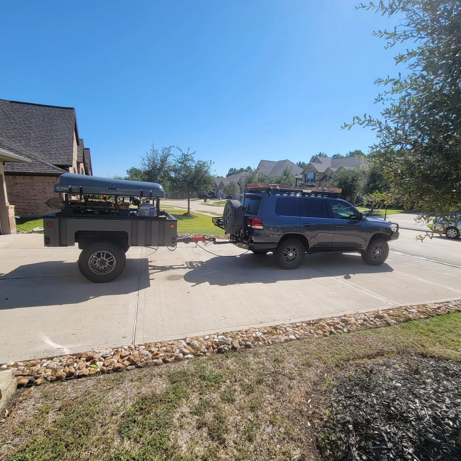

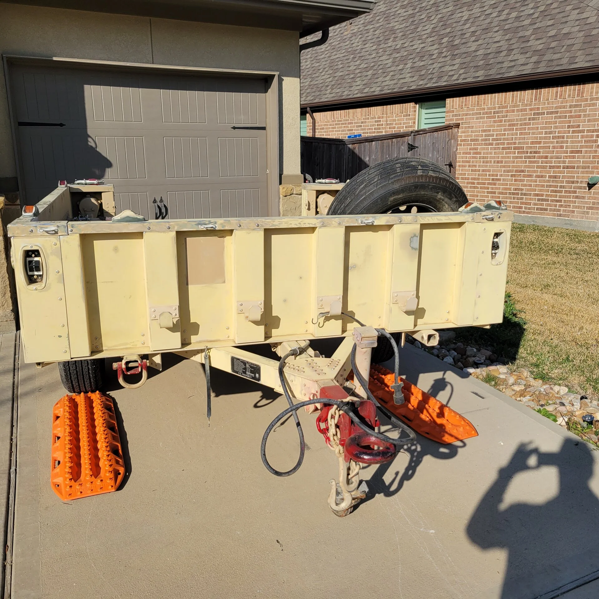

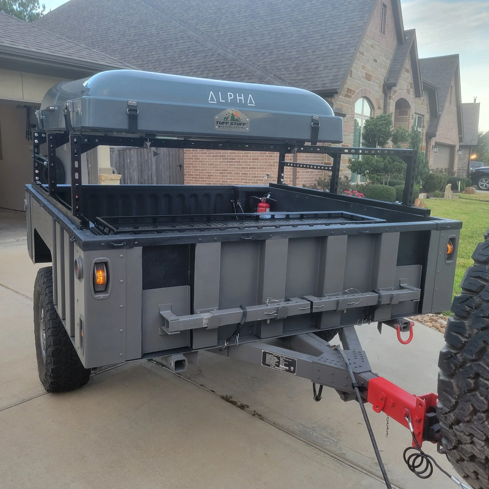

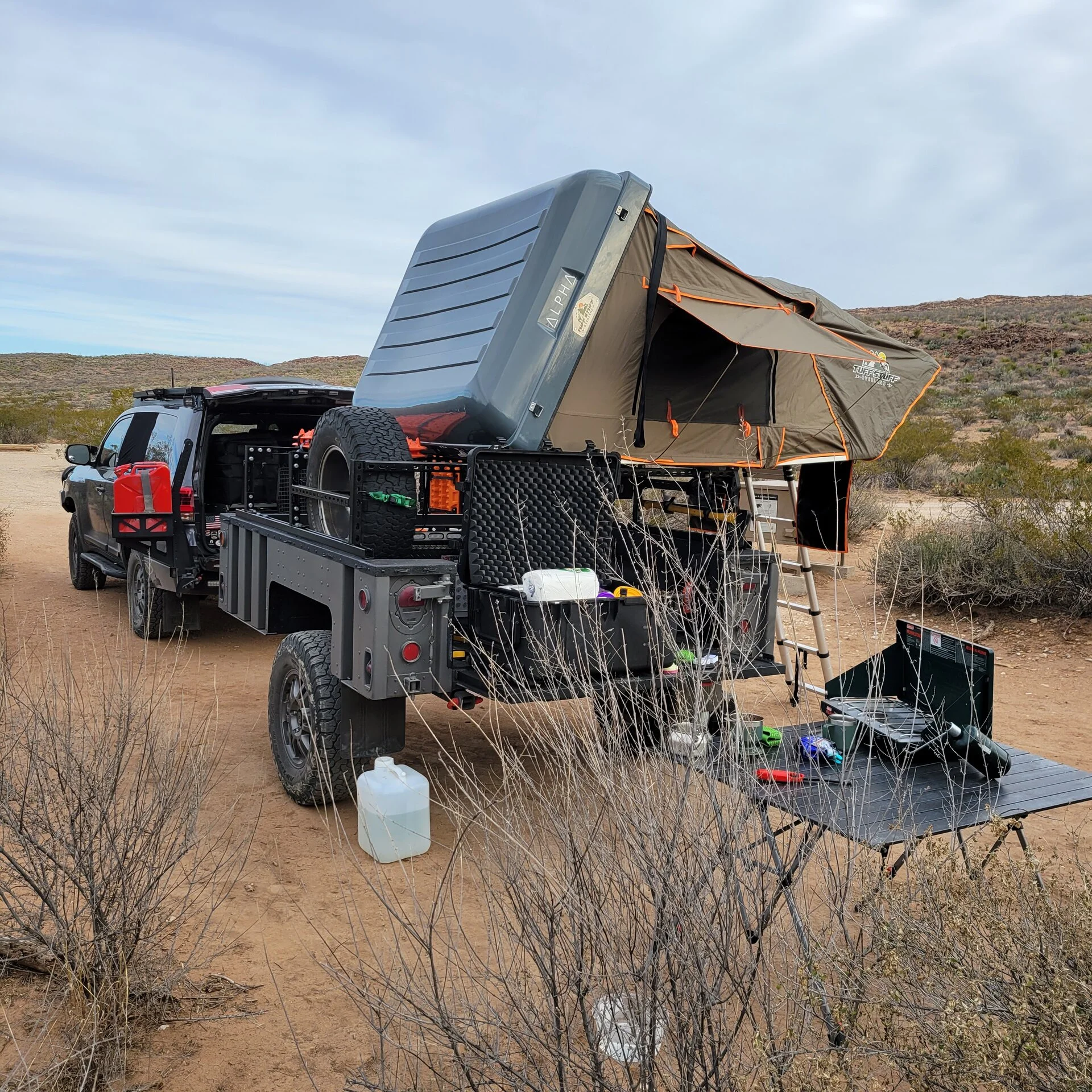

Can you show how you went about mounting the lock-n-roll hitch to the neck of the 1101? Crazy how long of an extension you need in order to clear the bumper/swing-outs. Also, a side shot of the trailer behind the Cruiser would be appreciated as well.
Sure. No problem. And yes that hitch is stupid long. I've tried a few different sizes but this one is only one that works to allow access while hooked. If I run a trail to a backwoods or displaced location; I remove it to avoid dragging during obstacles.
For the hitch, the original "ring" was removed and replaced with the rock and roll. That red colored 4 hole "slip" was welded to the trailer so I could make adjustments and or switch between "hitches".
If you're in Houston I need to come by and see it in person. I like the idea of having an easily replaceable connection versus altering the neck entirely.
