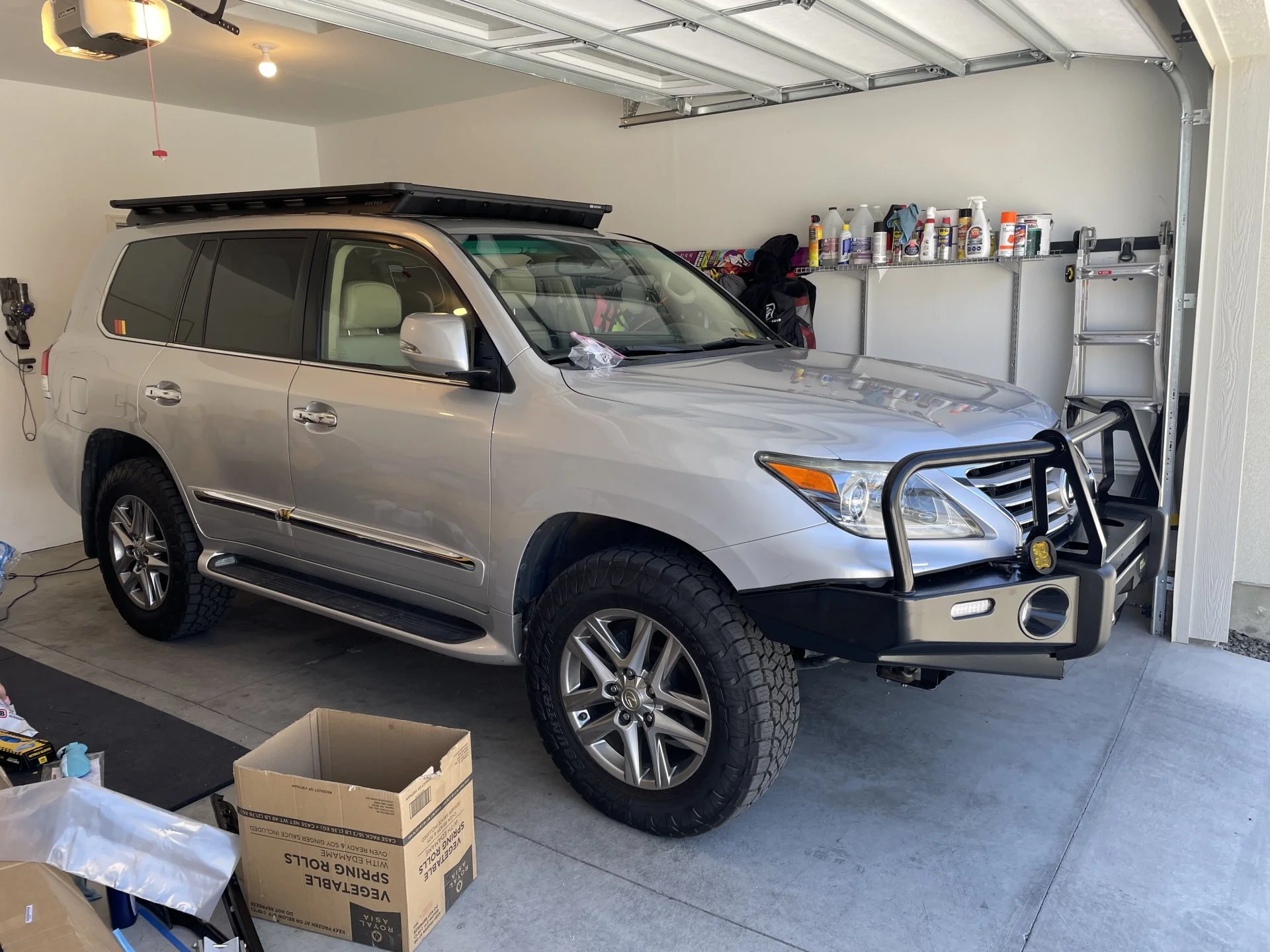

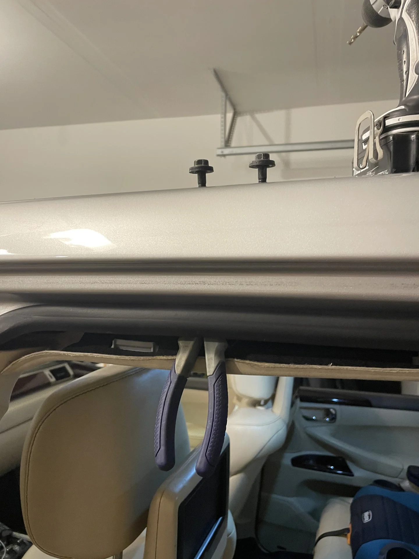

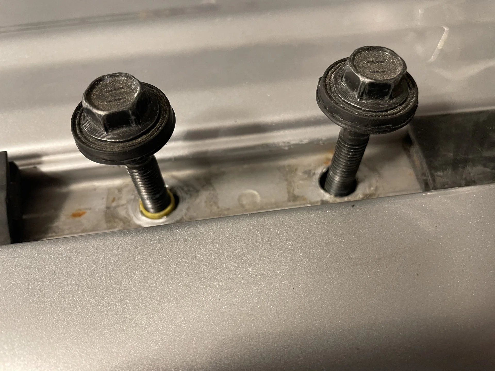

And since I wasn’t really in the mood to do real work today, I went ahead and got my ARB Baserack installed. Previous owner dropped a couple of the roof rack brackets into the headliner and just squirted a glob of JB Weld into the hole and ran the bolt into that so that’s what half my mounting points for the rack have been since I bought the truck. Decided to go ahead and fix that with the rack install. Was able to fish them out without dropping the headliner, just pulled it back enough to access. Very tight but doable.
Wedged these needle nose in there to hold the bracket from the bottom while I thread the bolts in from the top.
Really digging the rack. Very stout. Clever mounting system. Haven’t had it on the highway yet but around town with the sunroof tilted or open it’s great.
Had to do the same thing on mounting my rhino bars, rig looks OUTSTANDING! Goals for sure.

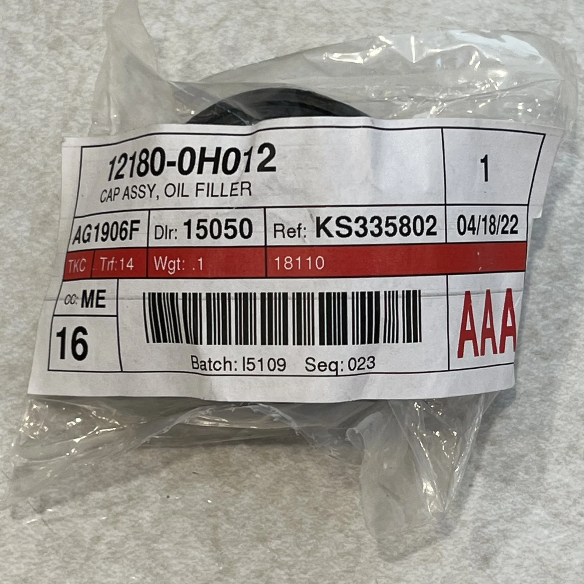

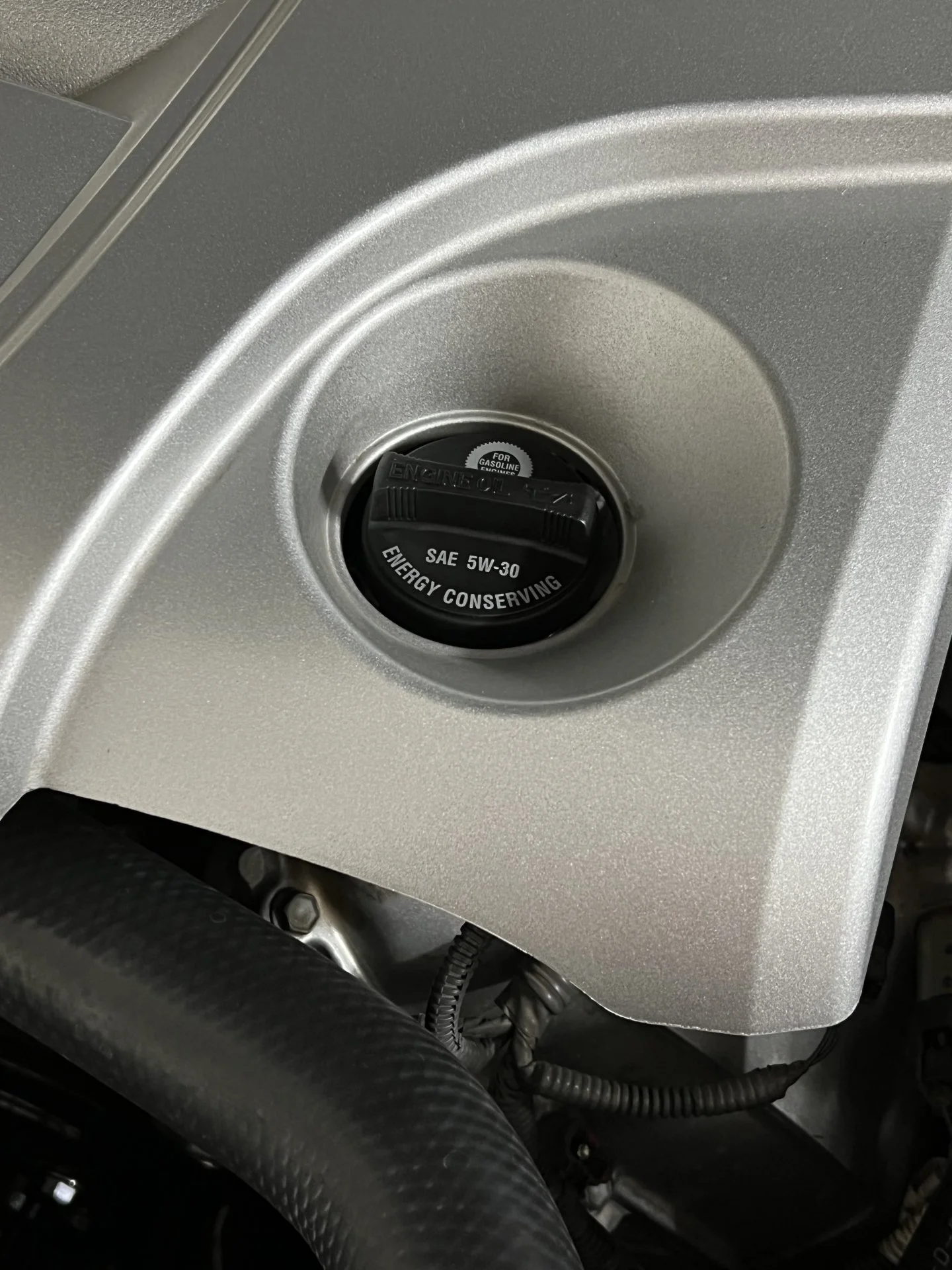

I am planning to do the same in a couple weeks. What's that oil cap part#? I know it was posted somewhere recently, but now I can't find it.
Here's a pic of what the cap looks like in its official Toyota packaging:
And on the back side:
Made in the good ol' USA!
