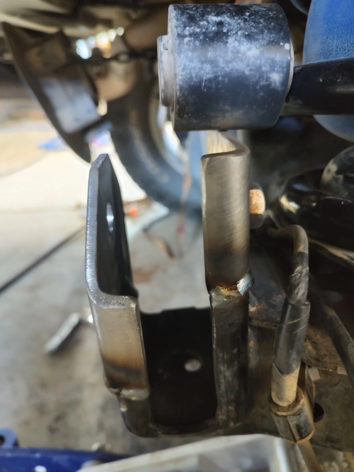

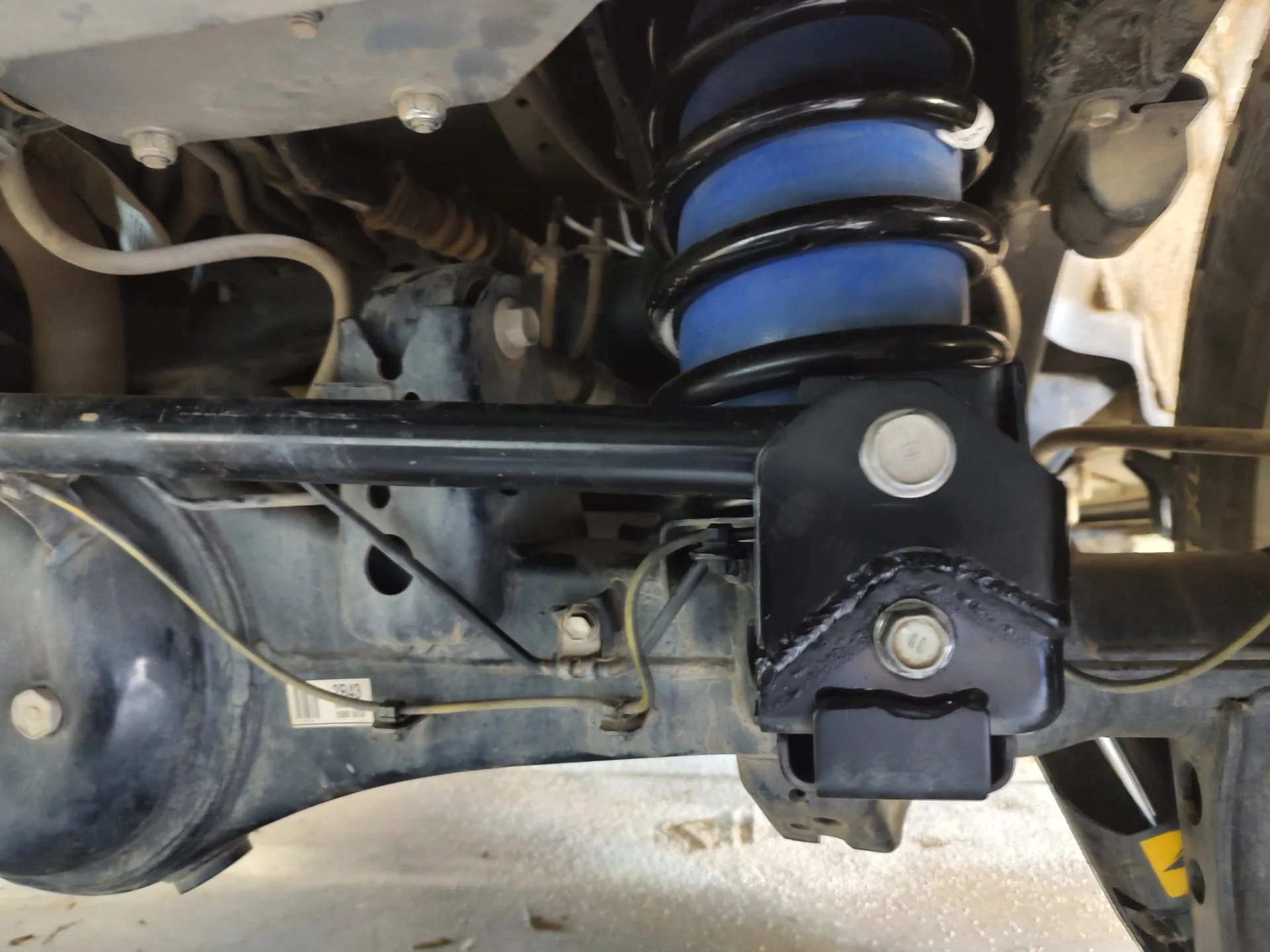

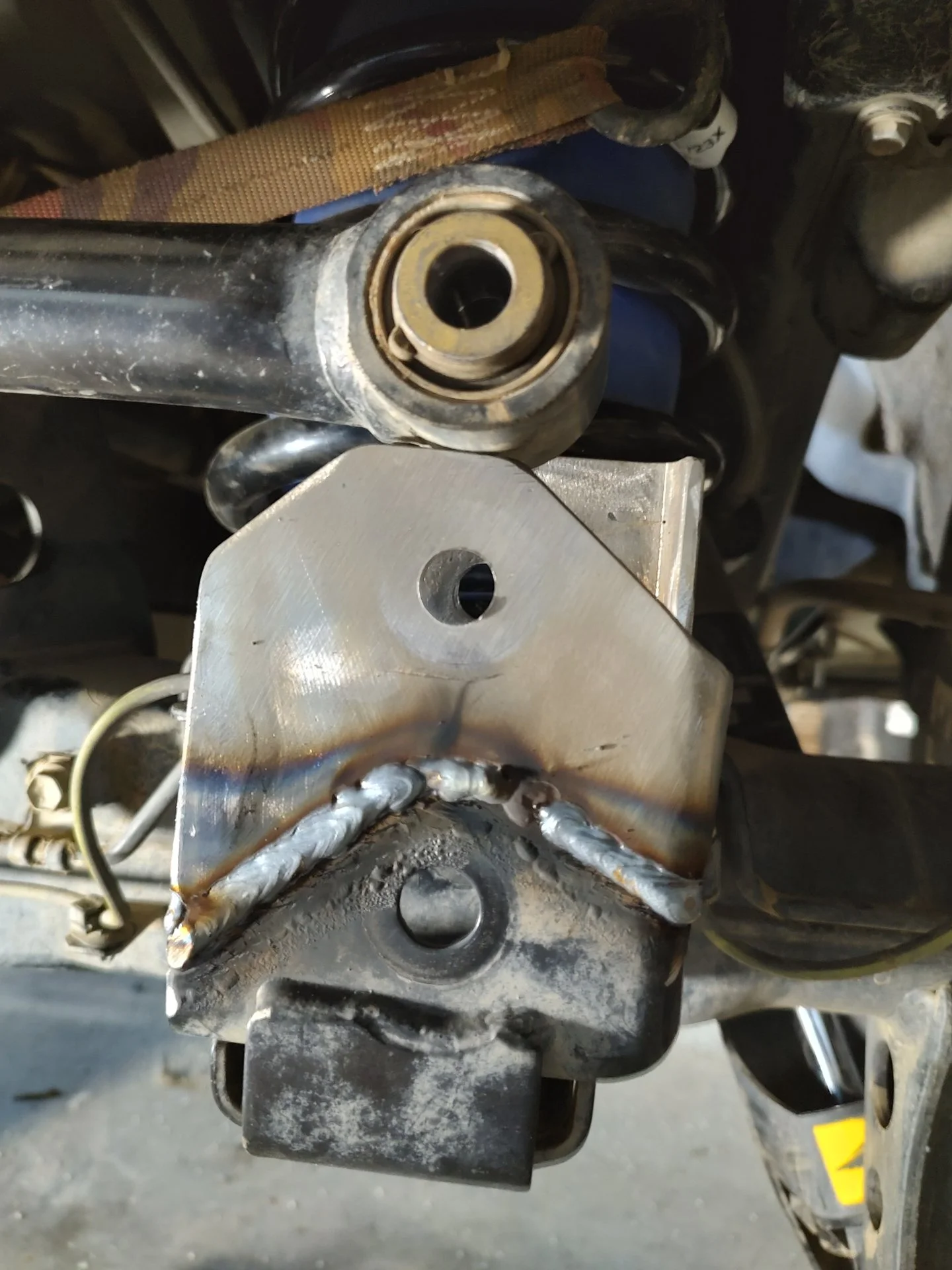

Moved the panhard back to where it should be. 2.5" higher on the axle mount.
It's amazing how much more well-behaved the truck feels with that small adjustment
Would you elaborate on this adjustment? Never seen that done. Thanks.

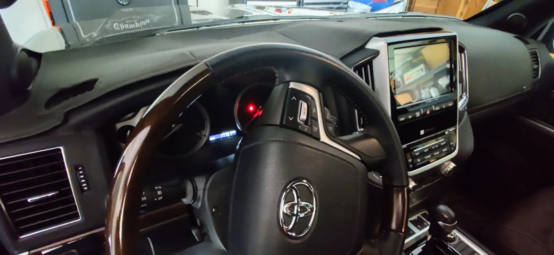

Installed this sweet new audio system when my factory system went down 2 days into a 20 day trip. It has Bluetooth radio and Weather band unlike the factory unit, but the sound is a little lacking. 😂
At least the climate control still works! Adventure on!
Read through this thread, it has some good videos, Panhard drop bracket option? - https://forum.ih8mud.com/threads/panhard-drop-bracket-option.1268657/
Basically the adjustment brings the panhard back to the angle it was with the factory suspension. I have a about 2.5" lift in the back, so lifting the axle side mounting point of the panhard 2.5" brings it back to stock.
You can see in my pics I put a bolt in the stock mounting point with a bushing inside to tighten down on.

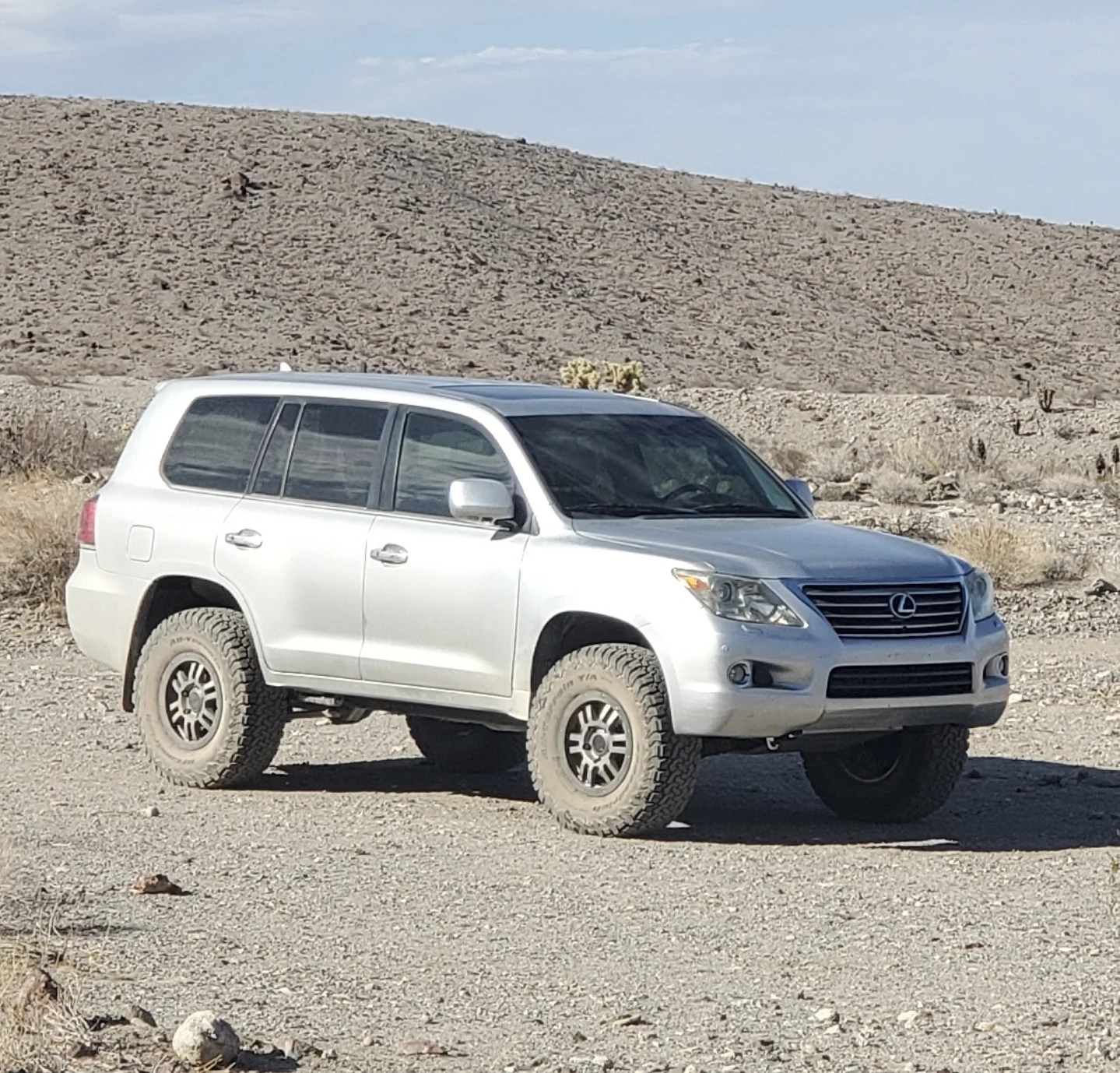

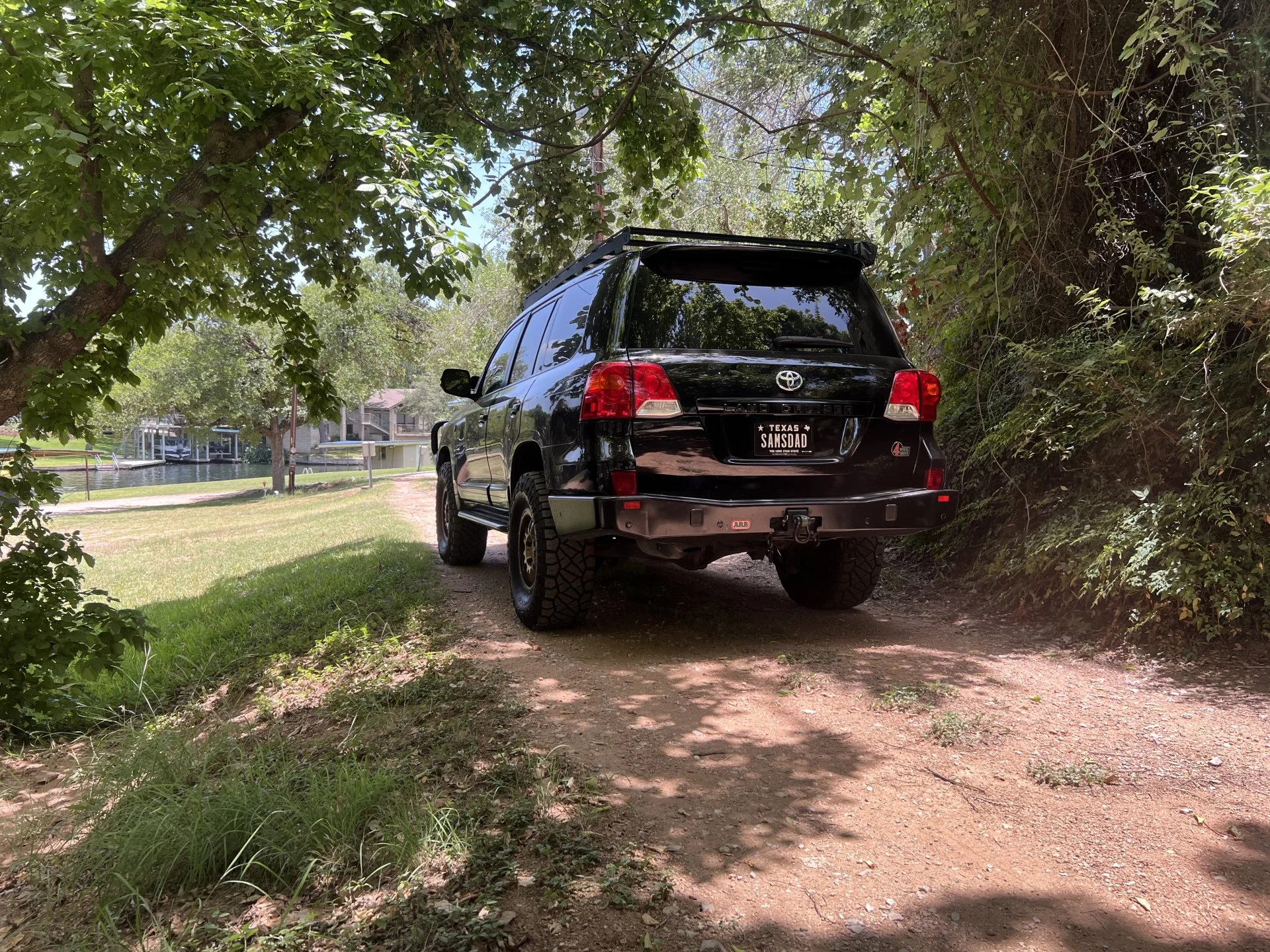

I put some bigger tires on. 35X12.5R17
Did you need to chop the body mounts for those 12.5's ?
