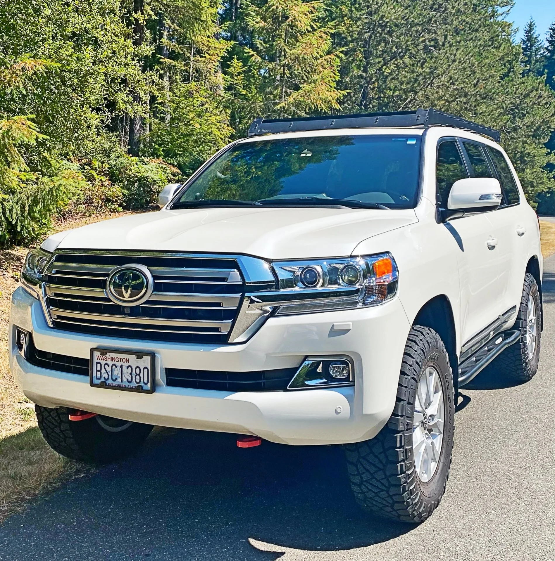

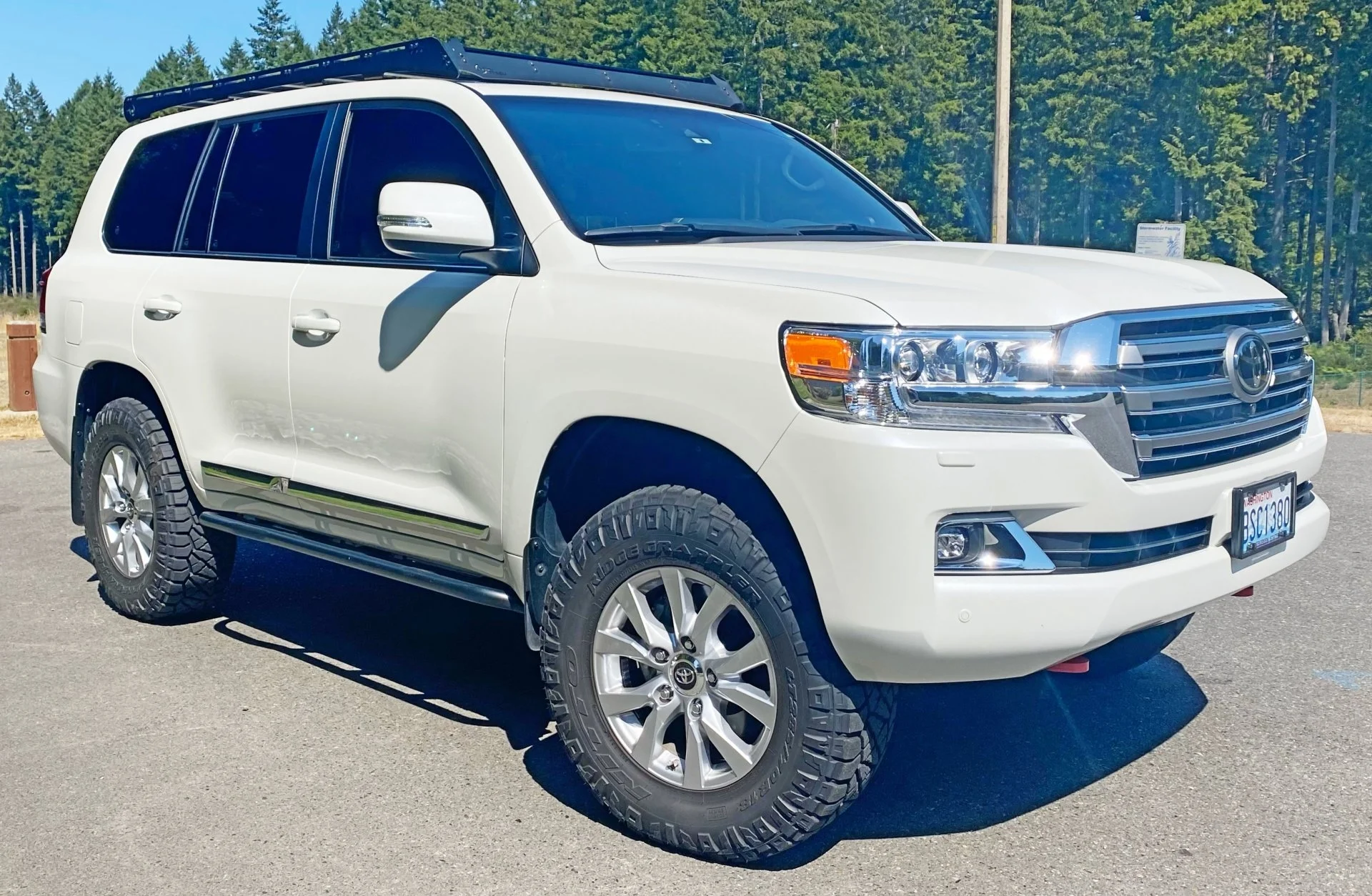

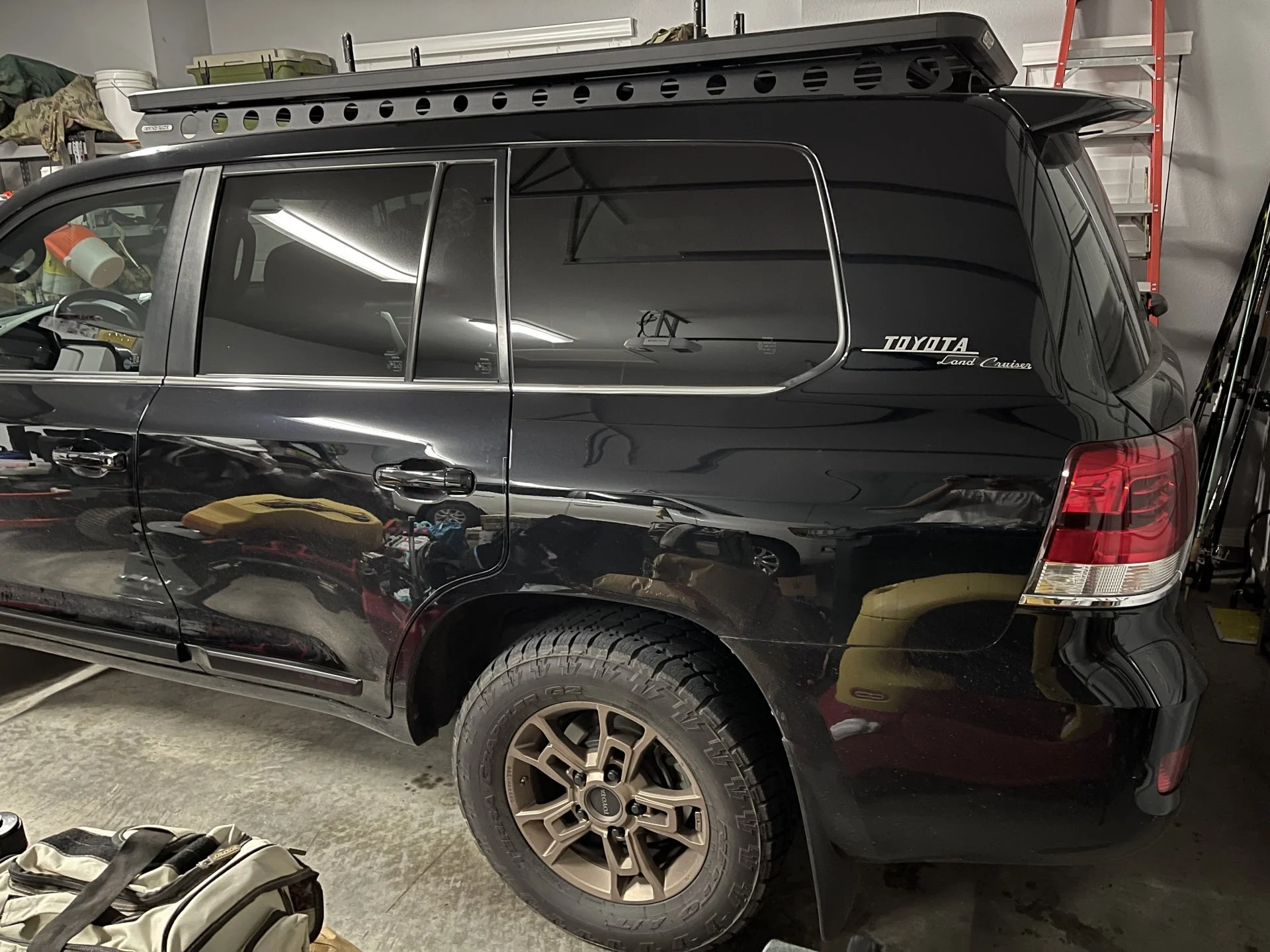

Had my Prinsu rack installed. Ordered the 40” lightbar cutout for the wind fairing. Not sure I’ll do a lightbar or not, but I preferred the cutout look anyway. Gobi ladder is on order too. Hopeful that will allow more convenience when loading and strapping down my camping gear.

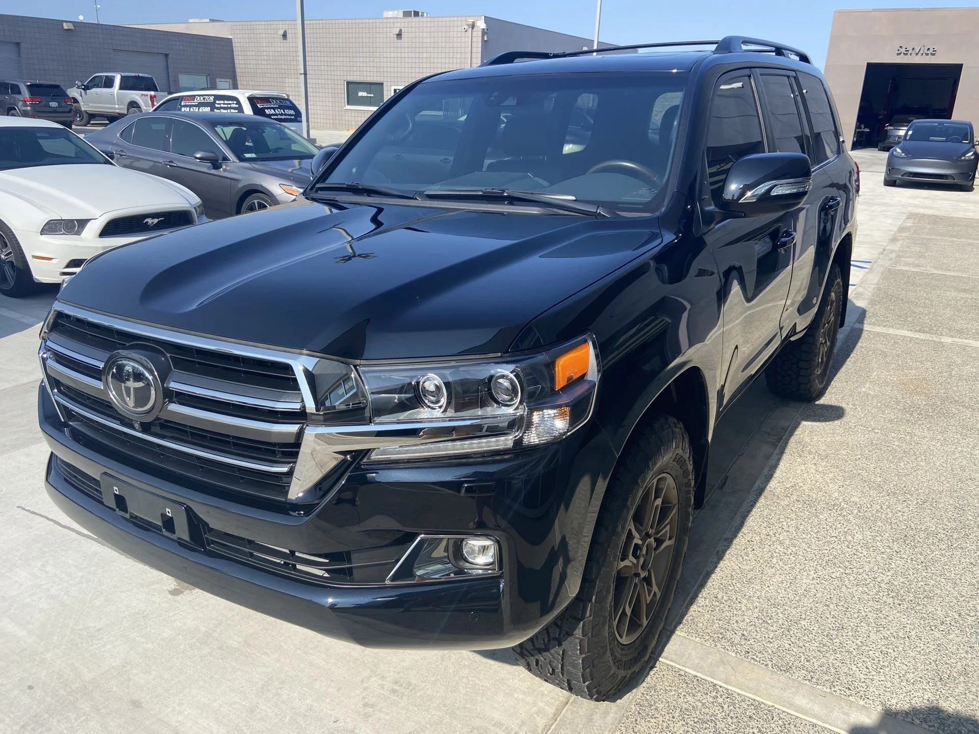

This looks good. What suspension setup are you running?
Med OME…. ARB2702 front springs/N91005-S front shocks, ARB2722 rear springs/N61029-S rear shocks and SPC UCAs

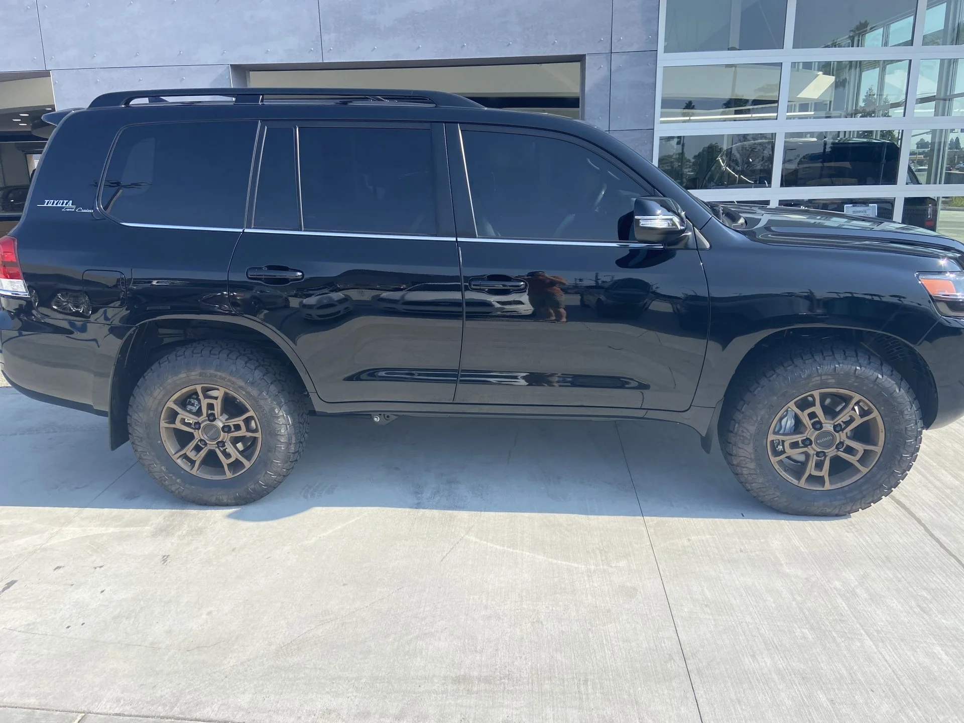

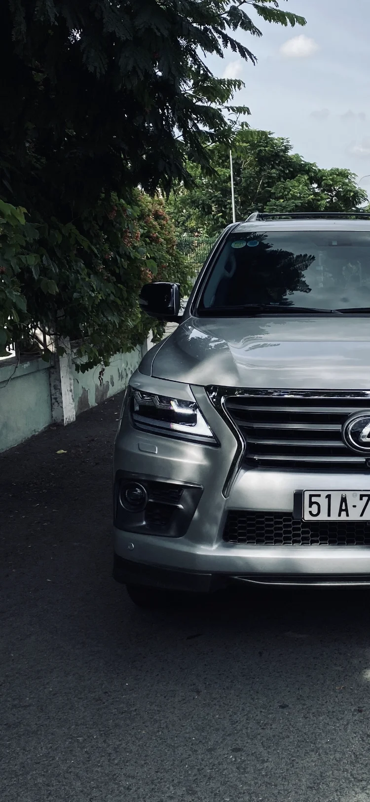

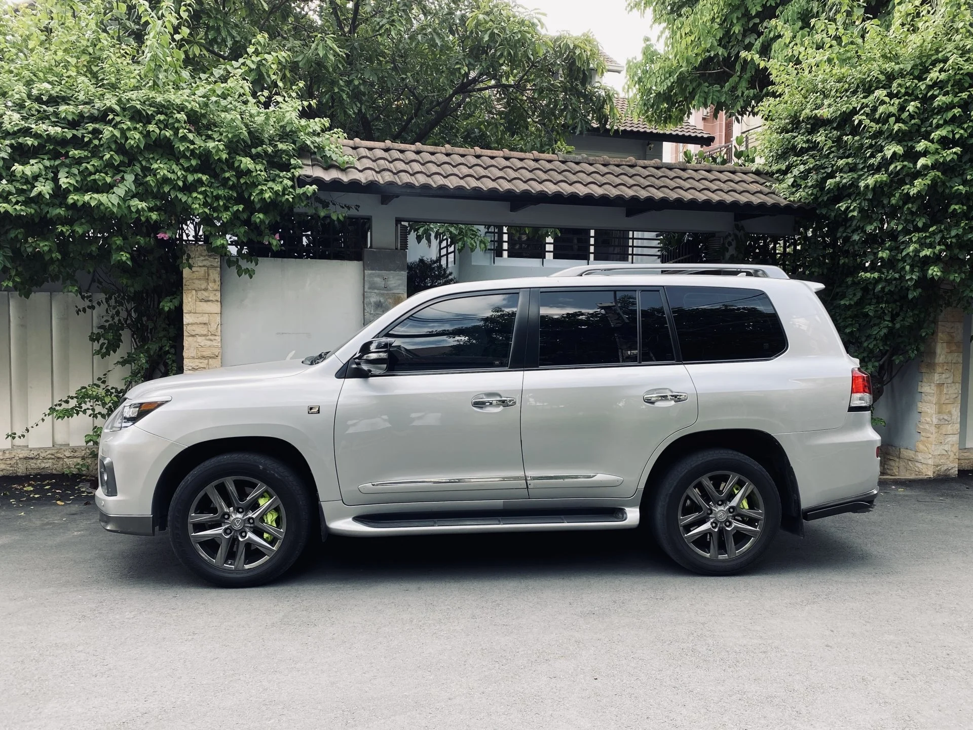

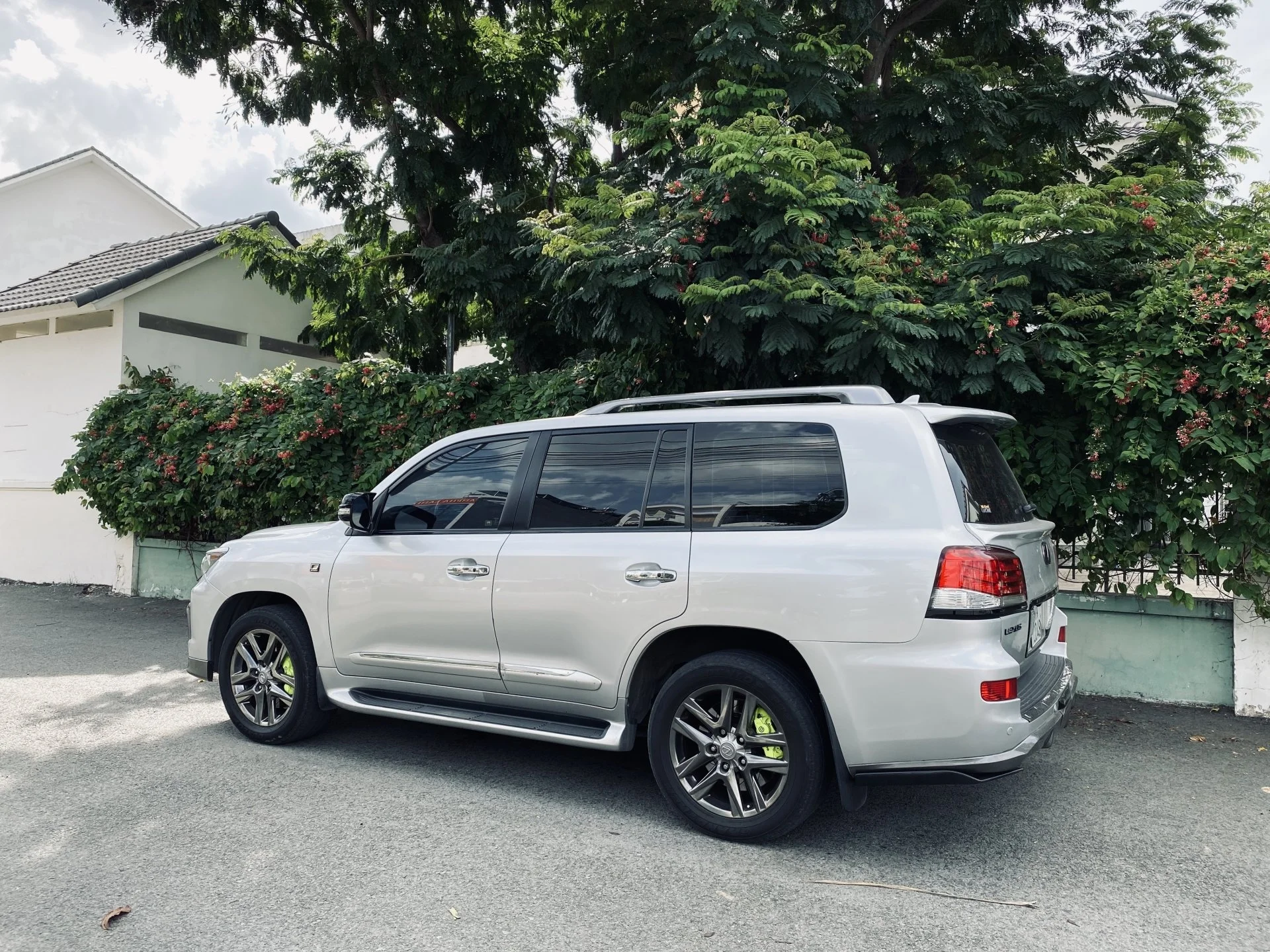

Door molding chrome delete, HE badges done today on the 17’……

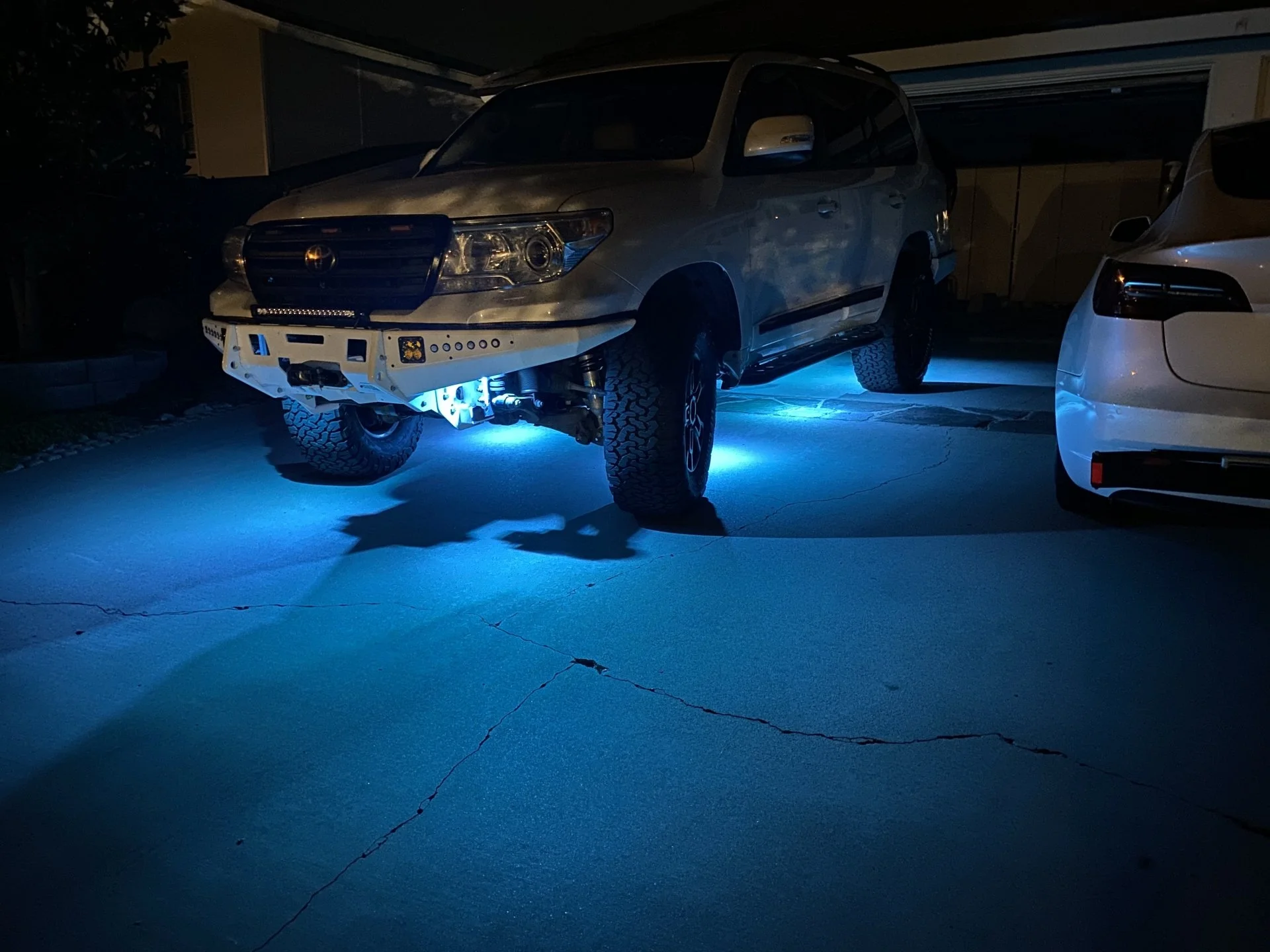

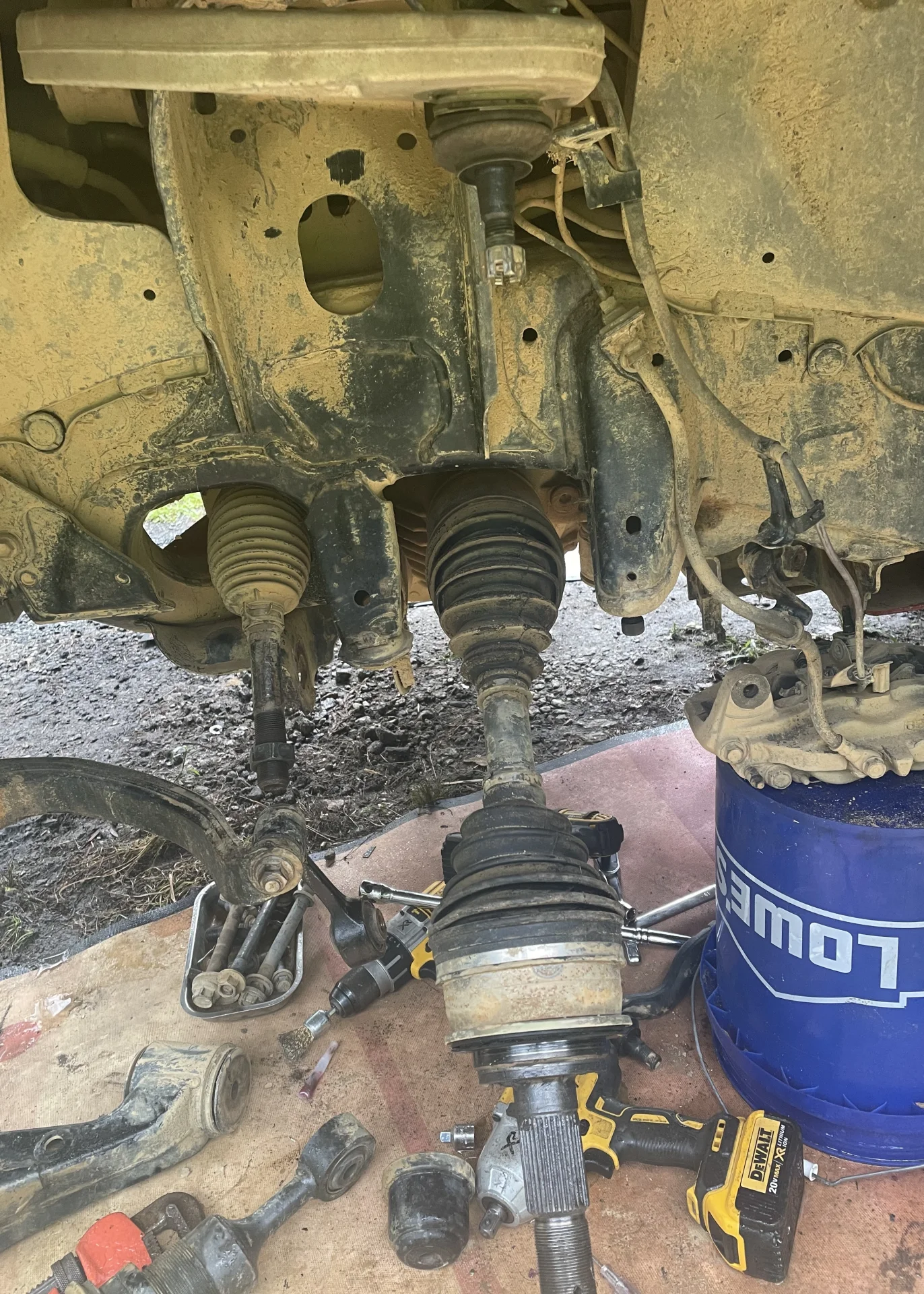

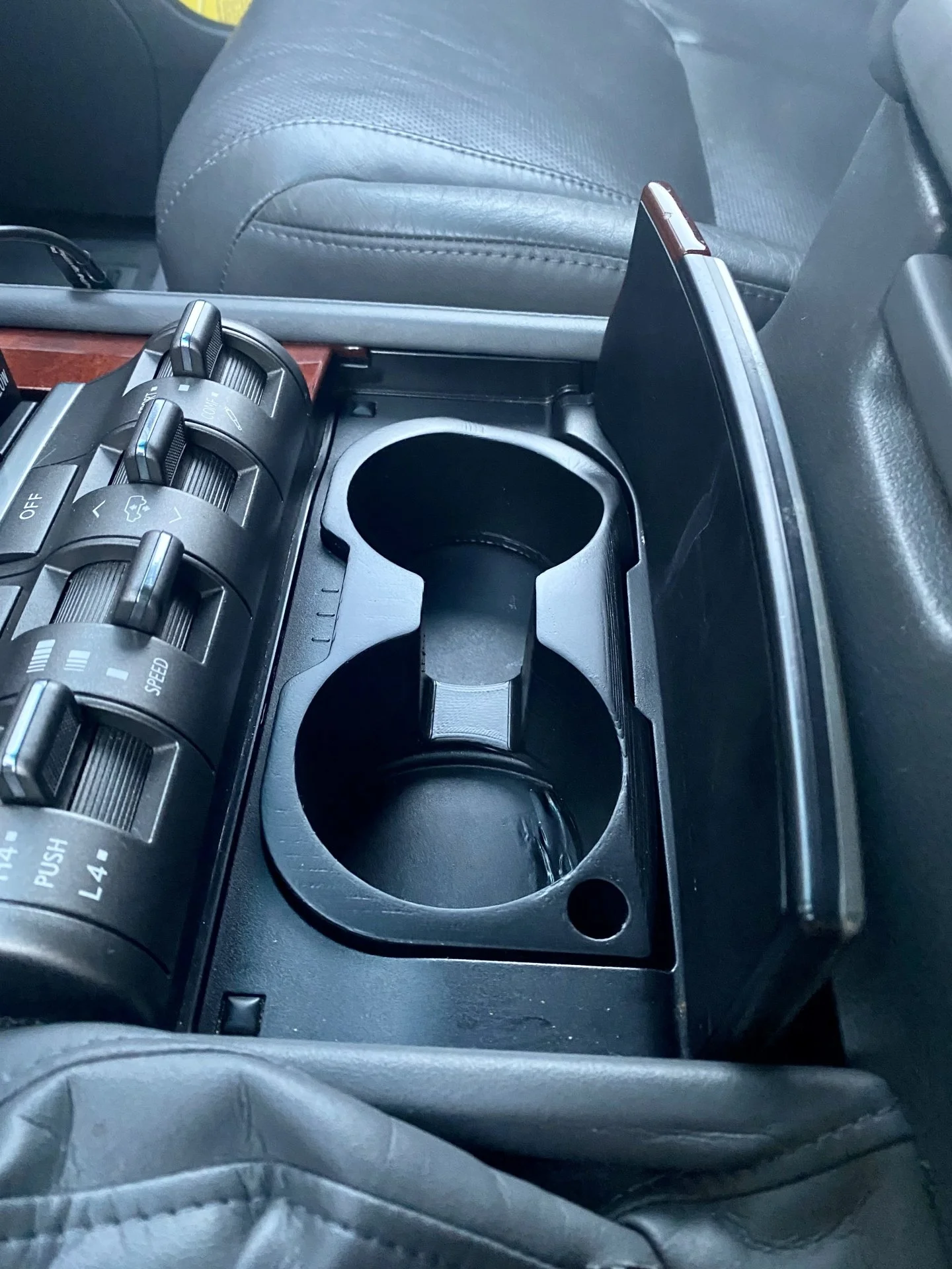

What could be going on here...😎
how did you go about sourcing the tundra parts? OEM picked off a tundra? New OEM? Aftermarket? Thanks!
Yes OEM from tundra salvage and NTO Tie Rod Ends.

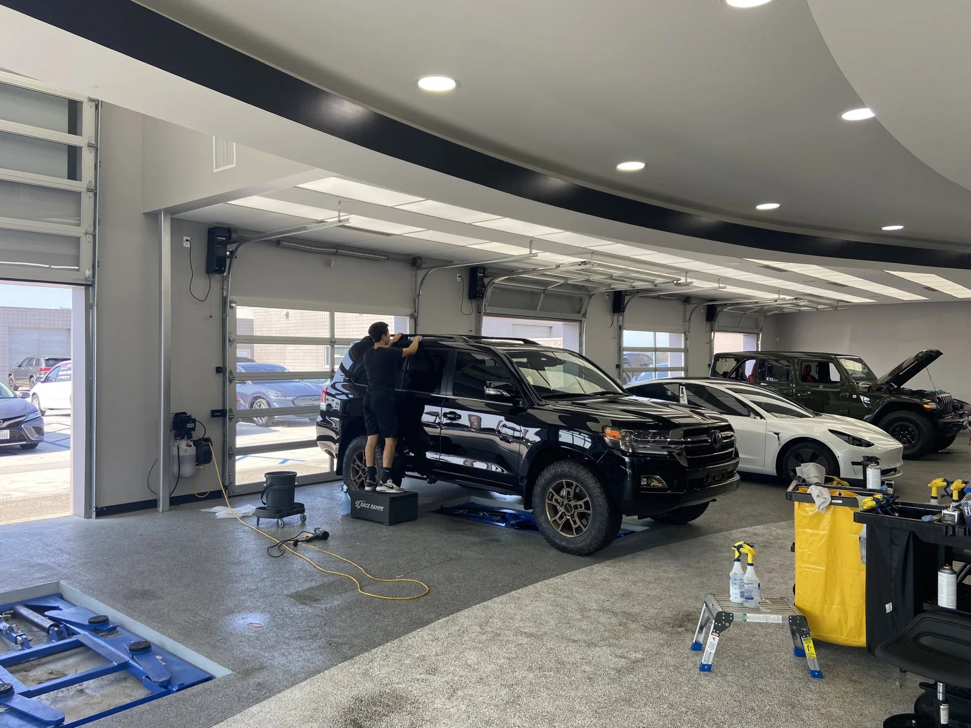

Got my entire front end and Rocker panels coated in XPEL film. Had them tint the drivers and passengers windows as well.

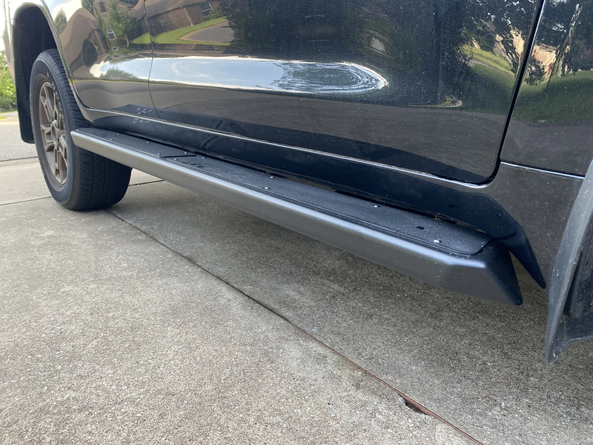

Dissent slider-steps installed, what a bitch to install, rivnuts need to install in places that would be better suited to body off work. Beautiful pieces, almost too pretty and non aggressive enough to think of them in the field.

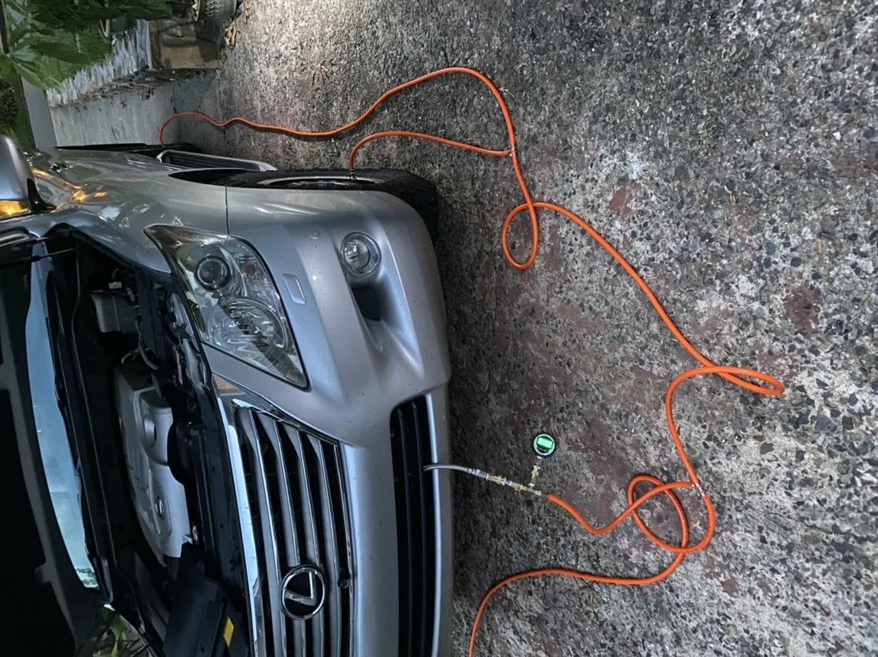

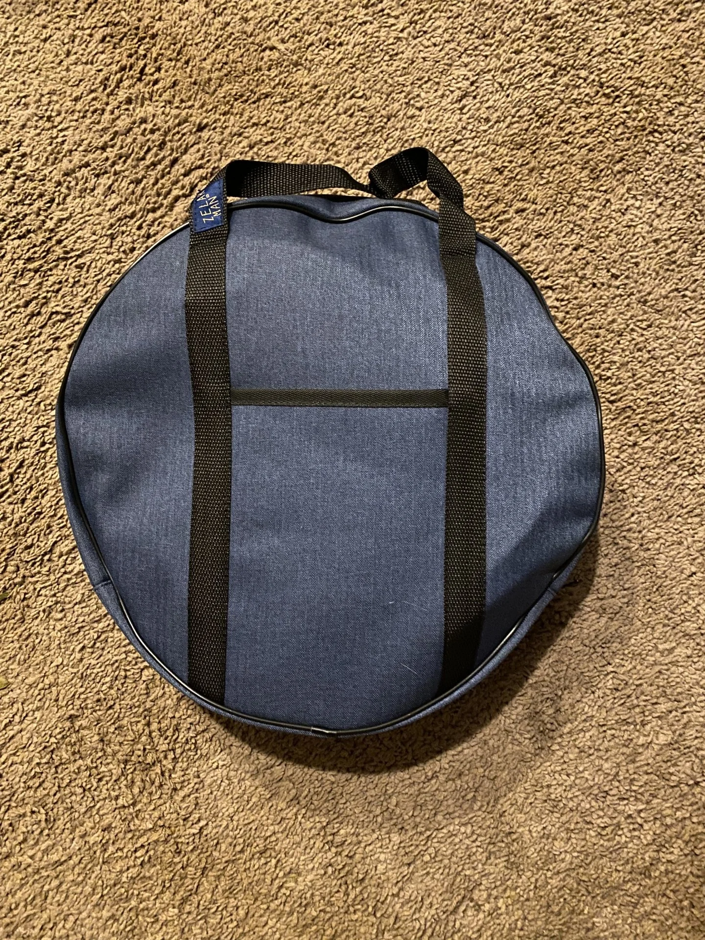

Finished my 4-flator. A few Amazon purchases and some old parts from the shed. Connected to my Viair 400C that’s about 80% installed. Still need to install the manifold with pressure switch and safety valve and a bracket to hold the quick coupler. Airs up 1.8 PSI / minute on all 4 tires. Drops about 5 PSI/minute when valve opened. Ordered a canvas bag for jumper cables and it barely squeezes into that.

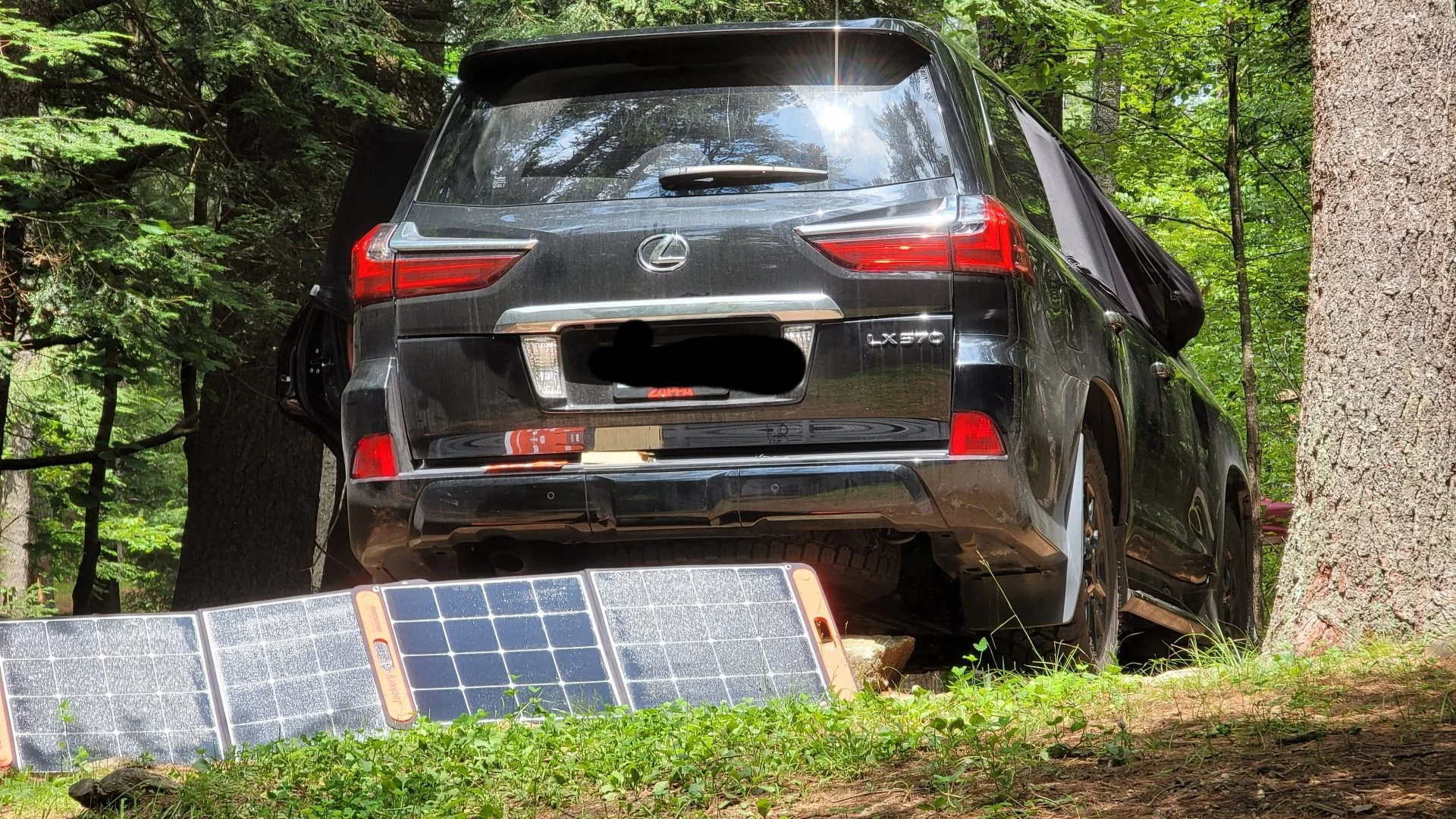

My first step to over landing... But really just at a close campground. First time sleeping in a vehicle. Have the ADGU SS1 with sleeper platform, an Exped Megamat XL, window screens, Jackery 1000 powering an Iceco JP42 and phones.
First night was a little rough. It was way too hot out for me, but would have been the same in a tent. I hit my legs on the sides and feet on the Tailgate.
After one night, I'm thinking I may either want to get a small trailer or a roof top tent in the future, but I've got two more nights here to continue to evaluate.
