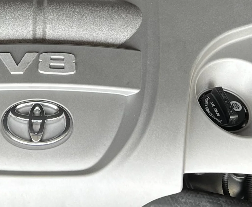

Found the part number for the cap on the forum somewhere. I believe it is for an FJ but fits perfect and calls for the good stuff.
Genuine Toyota Parts - Cap Assy, Oil Filler (12180-0H012) https://a.co/d/bmdFWLu
Amazon link
I thought the oil pressure gauge was stuck until switching to 0W30, it actually builds pressure under load now.

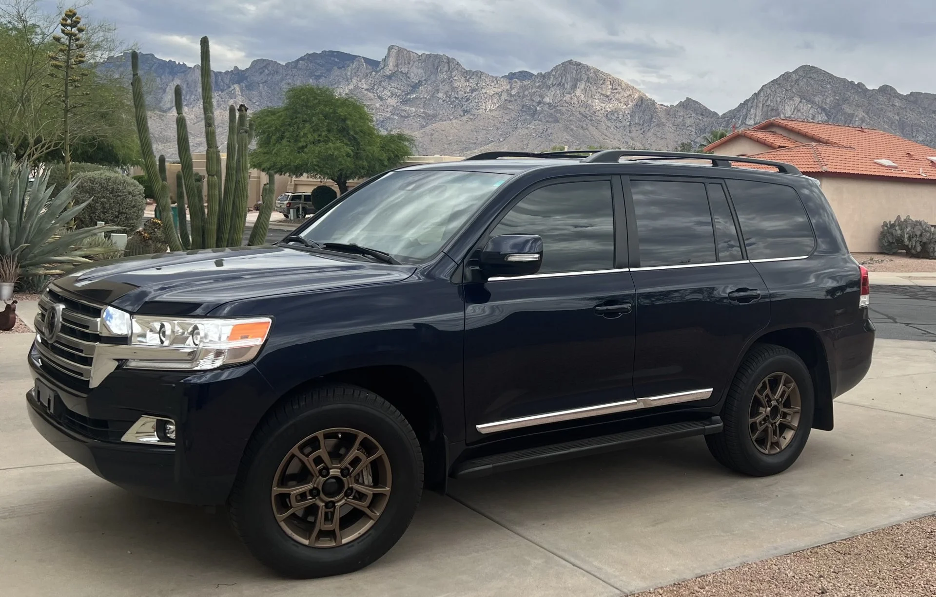

My first step today on my 2019 I got Monday was to tint the front windows. Looks and feels better!
Next wheel, tires and front bumper...

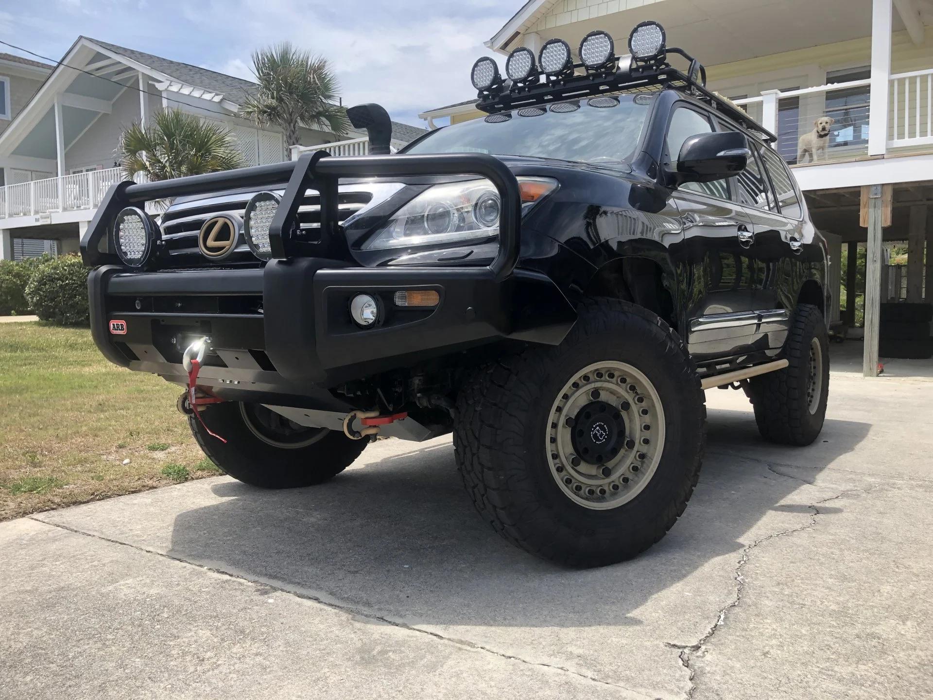

I give you my work in progress. She now has an ARB front, with factory fog lights modified, Primeluxe LED spot lights, Warn 12k VR, and camera remounted.
Also added bloc diamond plate to fill some of the holes that were not used in the bumper.
New angle of attach makes the 37x12.50s look even meaner!

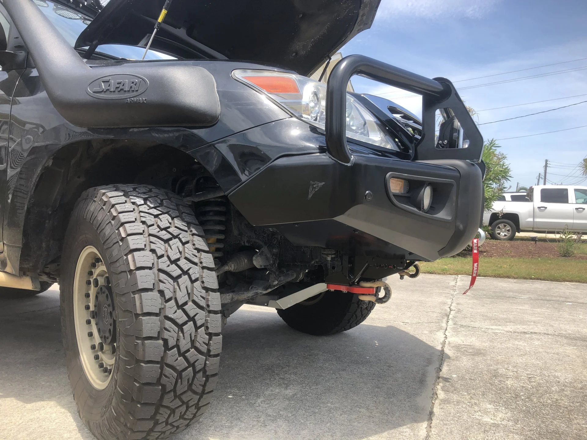

Couple more
That bumper is way too close to the plastic. You can’t mount it flush like that because the bullbar is like a big torsion bar between the frame rails. Ok corrugated roads it moves a lot. You need like another 1/2” of plastic trimmed back or you’ll break the tabs off the bumper skin that tuck it under the headlights.
You can get thicker bulb trim to keep the flush look but allow some movement: Amazon product ASIN B07KY4J7ZR
The trim is flexible rubber. There is also a good bit changed underneath already, to fit the 37s. Not much original there.
Looks great how much lift did that take to fit the tires?
OME heavy, 1.5 inch leveling kit, all the plastic removed, some of the medal removed, body mounts modified and moved.
Nothing you did to clearance for wheels really matters in this case, as far as what @tbisaacs is referring to. Here's a good demonstration of what he means. Look how much the bumper moves relative to the body over bumpy terrain. It does not appear you have enough room between the bumper and the remaining plastic to allow for this movement. This can cause at best case, popping the bumper off while on these bumpy roads, and at worse breaking the headlight tabs.

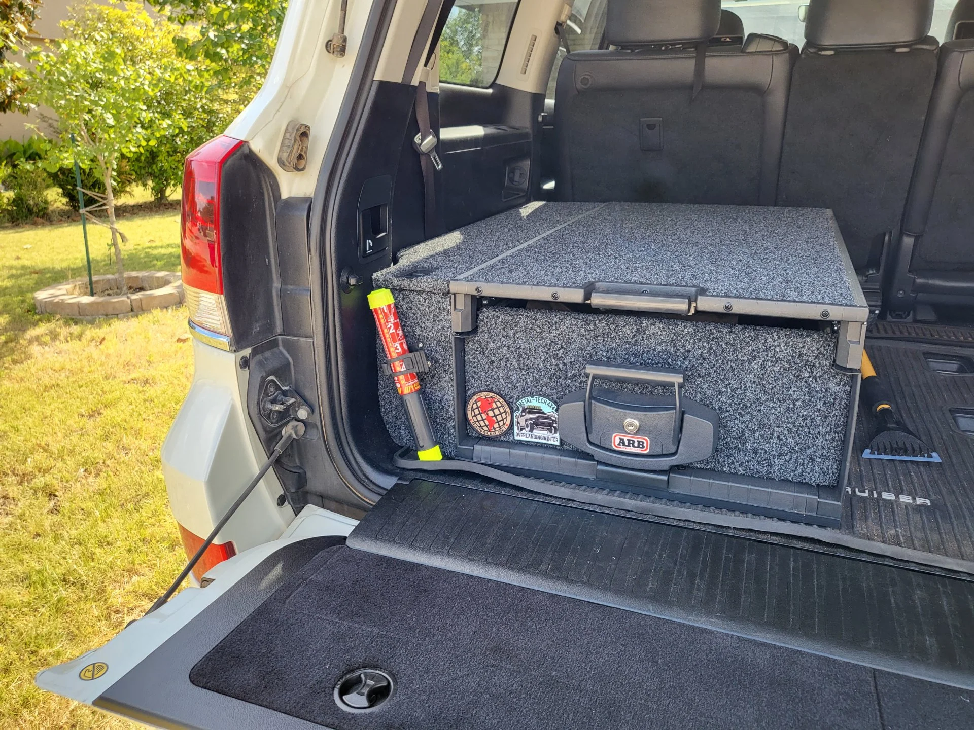

Took the Element fire extinguisher out of the drawer and mounted to the back drawer trim panel. Not in immediate reach from the driver's seat, but easier to get to than before.

Roger that, I am aware of what you are saying, and accounted for it in the instal. This is not my first ARB bumper on a cruiser.
What I am saying is, everything rigid is out of the equation when touching. There is the arb bumper, then soft rubber on the edge, then the plastic facia lays above, and forward of the inner portion of the steel of the ARB.
Thus, there is plenty of room for play between the flexible plastic, and the metal. If it come into contact, there is an overlap, with soft rubber barrier, not point to point where the plastic would break.
I have a 100 with an ARB, like the video. There, it is metal to metal. This is not so on the 200 where the tolerances are close on mine.
