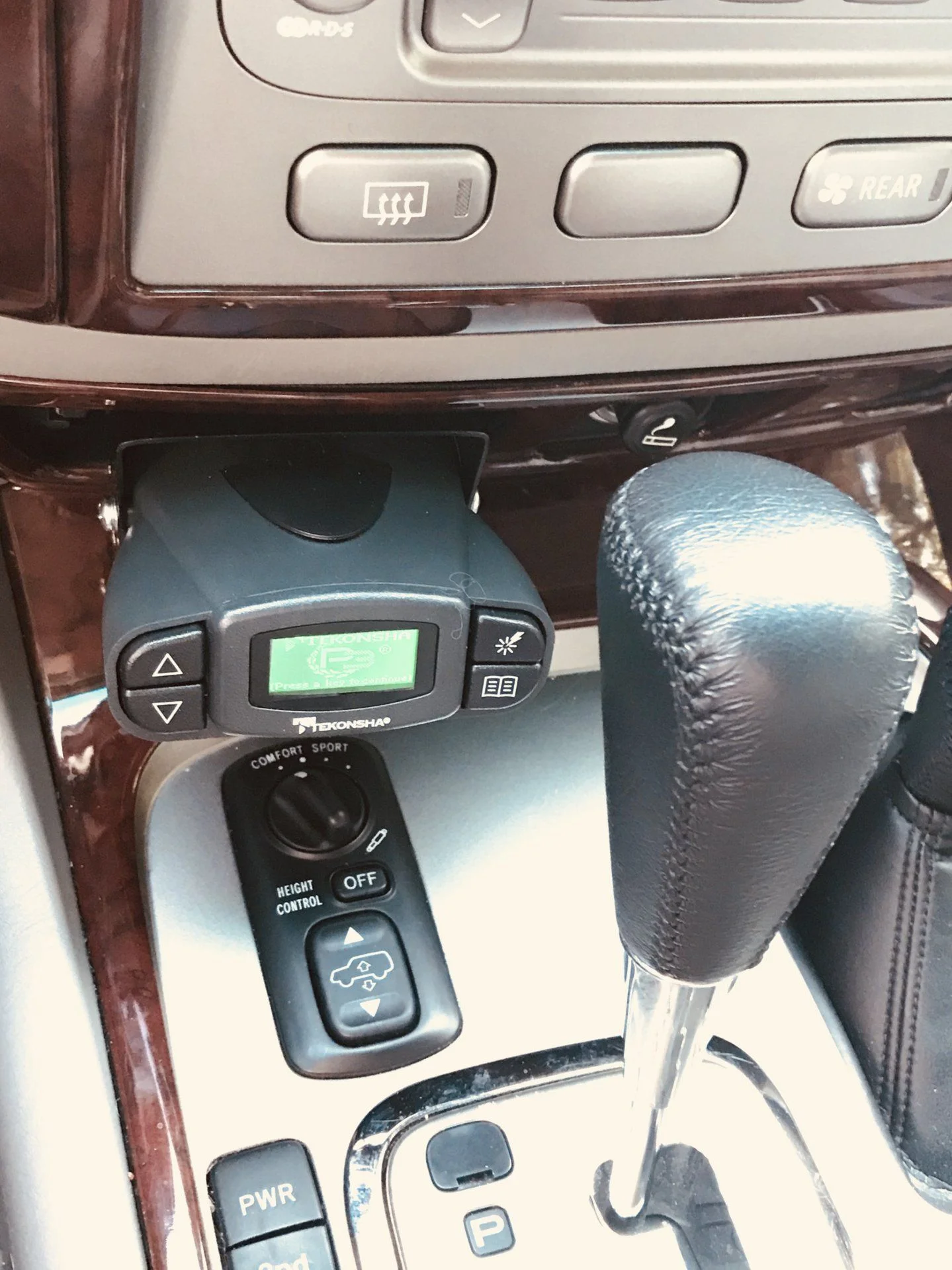

Installed a brake controller in my 06 yesterday. I was way easier than I thought it would be. 30 minute job:banana:
Next up will be my 2000. That’s going to be the fun one:beer:
Gotta do this soon. I hate running wires.

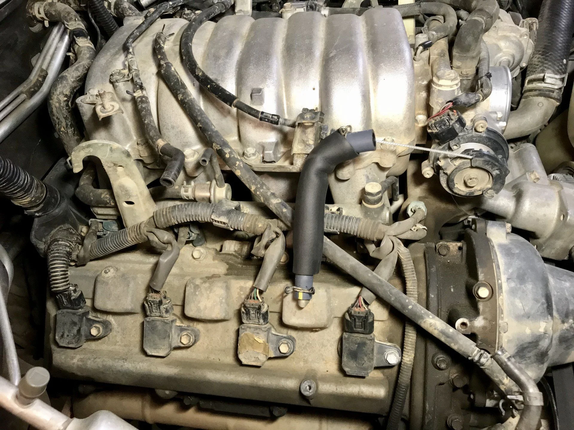

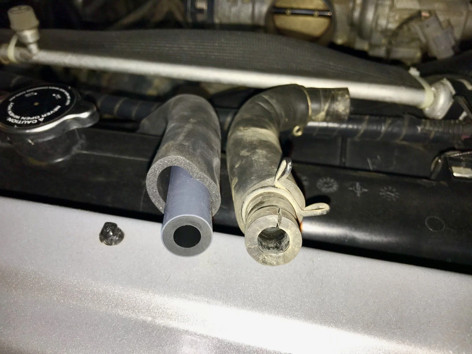

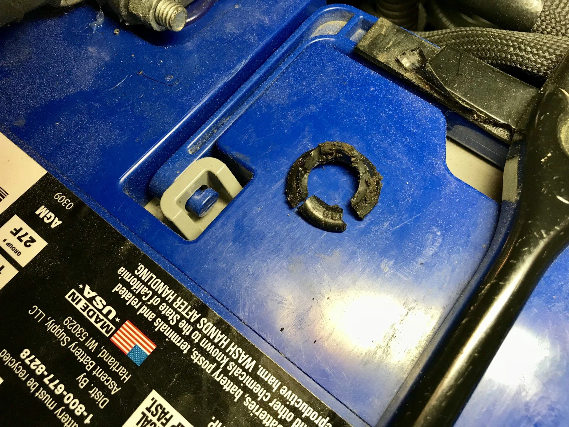

Replaced PCV valve & hoses. It was a much easier job than I had anticipated and I could do it in 15min with a couple beer breaks in between next time. These were original after 18 years and 203k miles and they definitely showed their age. Both hoses showed significant rotting and splitting on both ends and the grommet (I have a ‘00 so no threads) completely disintegrated trying to remove it. Luckily I got it all with no pieces falling into the block.
This is just part of the original grommet, the rest of it fell down in the bay and I believe landed on top of my skid plate.
A thorough engine bay cleaning is next on my list.

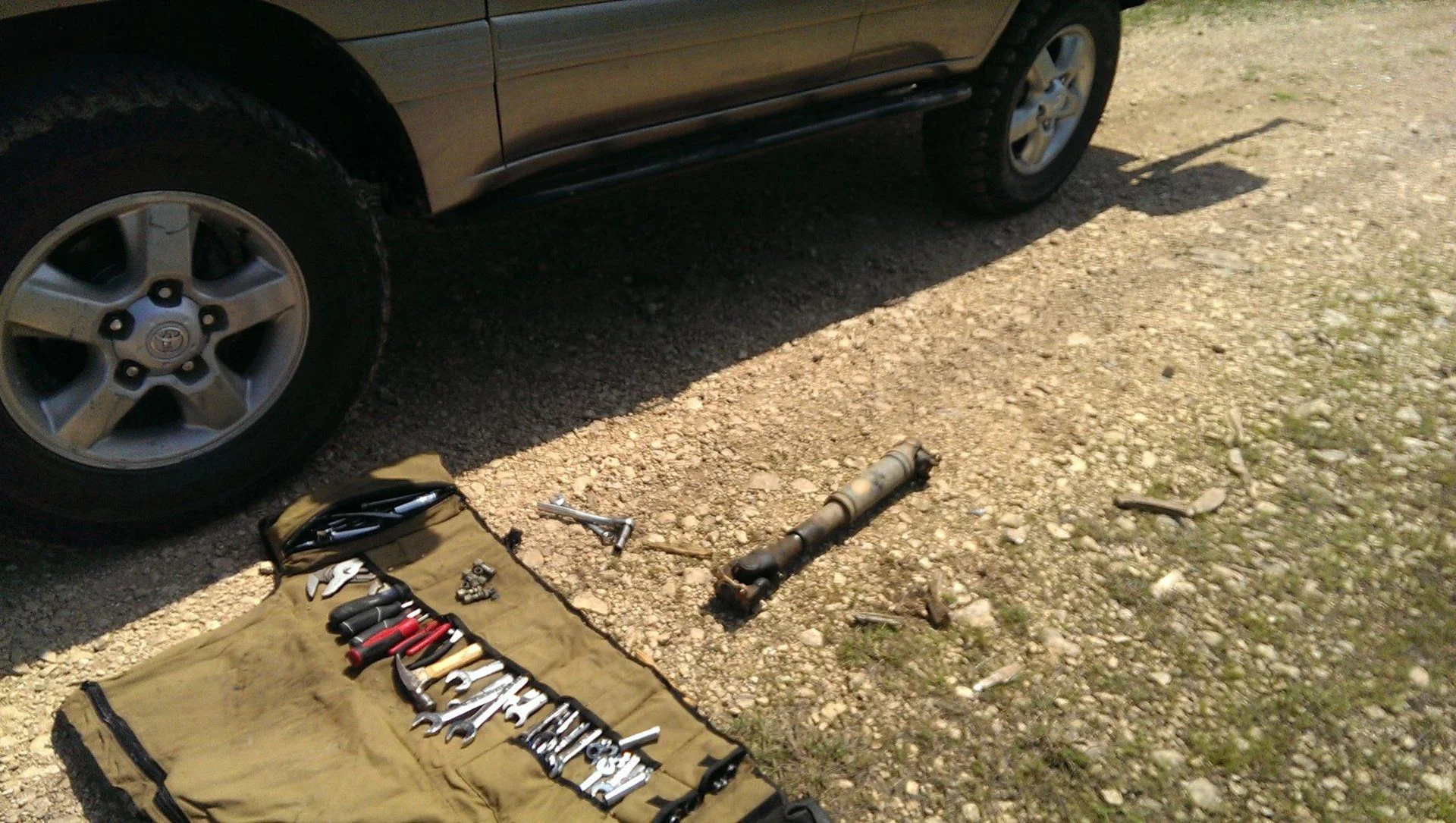

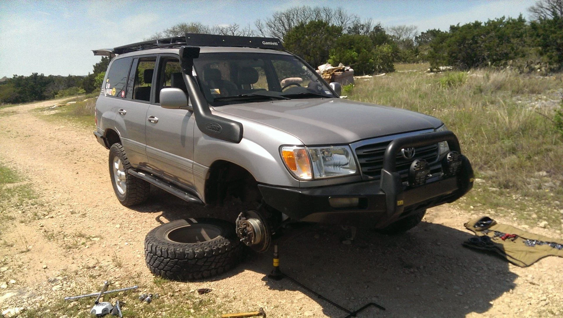

Really awesome mod! Broke some teeth off my front ring gear today!
4LO climbing a ledge with the center diff locked and rear air locker engaged.
Got off the trail by pulling the drive flanges and front driveshaft and locking the center diff. I'll be in 2wd for a while now. The silver lining is I might have a front locker in my future. Pretty pricy. I hate to cheap out and just do the ring gear but a locker is a big $$$$$ unexpected surprise.
Oh yeah and it's a 2004 with the "stronger" front diff.

@nmatcek were you bouncing/ hopping or just wheels spinning? I think I will go ahead and put a front locker in sooner rather than later
No hopping to speak of. Front wheels were bumping into the ledge while one was spinning. Front got up the ledge actually. Then I was trying to bump the rear tires up the ledge. I don't actually know specifically when the failure occurred because I never heard a bang or any unusual sounds. What I did hear was just my rear lower links banging into the lip of the ledge.
Then after clearing the ledge I heard the thunk, thunk, thunk while driving straight and level.
@nmatcek bummer! At least you were prepared and made it out. Thanks for sharing

Sorry dude- that sucks/ but nice work on the trailside get-home procedure. Mechanical self sufficiency is a excellent attribute on the trail.
Had you not busted your front diff, I would have never seen that well equipped tool roll. That is an impressive kit.
Good luck with the locker install.

Do you by chance have a list of what you carry in your tool roll? I am fearing the same issue and wanna make sure I am fully prepared the next time I am out on the trail.
