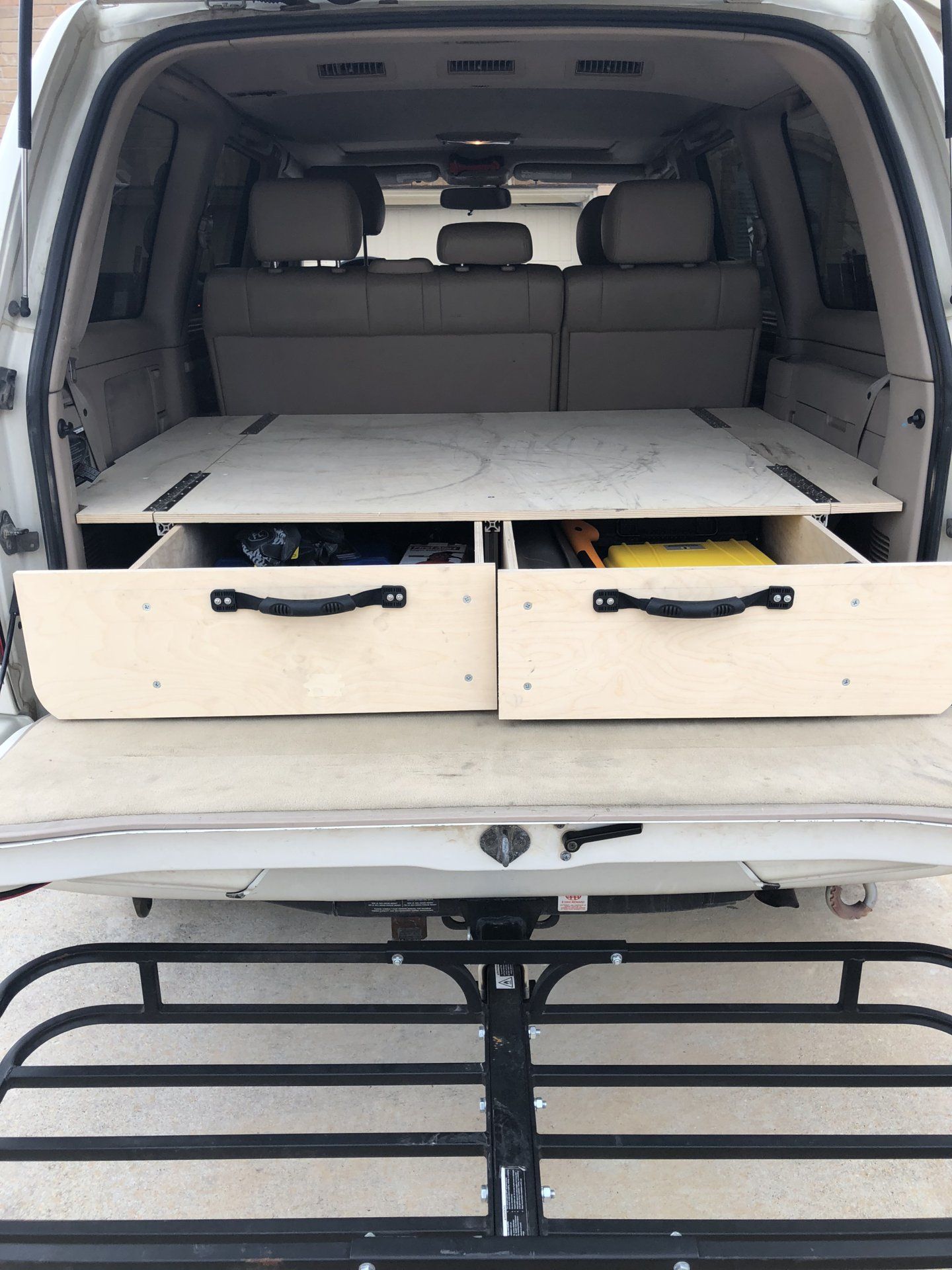

I built an attic rack for the back of my '99. Needs some fine tuning, but it works pretty well so far :)
Also had an idea for using some wasted space on the outside of the drawers... needs some refining, but here is a proof of concept. Could be good for keeping maps, silverware, thin stuff...

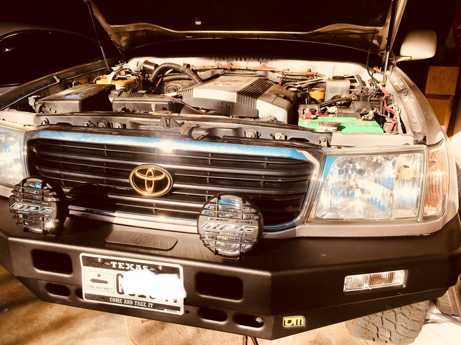

Got my neutral pressure readings, cranked the TB’s and we are back in spec now with a Dissent front bumper and Warn VR12 winch.
View attachment 1615159 View attachment 1615160 View attachment 1615161 View attachment 1615162 View attachment 1615163Also had an idea for using some wasted space on the outside of the drawers... needs some refining, but here is a proof of concept. Could be good for keeping maps, silverware, thin stuff... View attachment 1615159
Love that idea for the drawers! I am definitely going to try that out

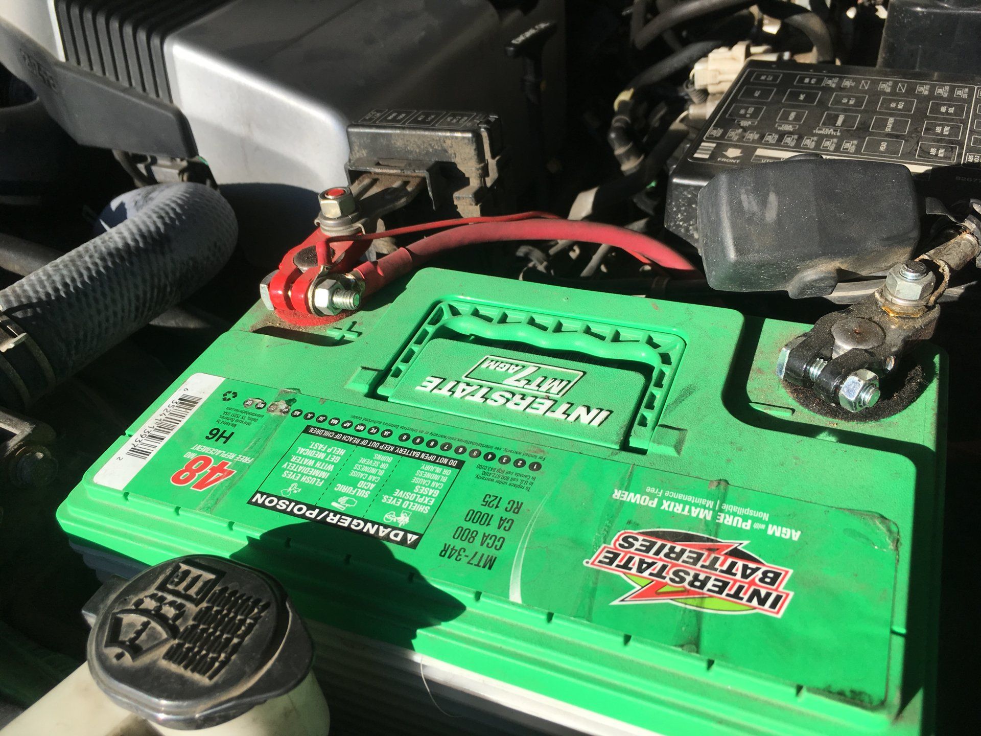

So in the past two weeks I’ve replaced four coil packs and now the APPS sensor went out. Thankfully, it was windy and 22! I was also able to replace the hood struts and battery terminals as well. Pitfalls be damned it is nice to step back and take stock of your efforts to keep a clean well running rig.

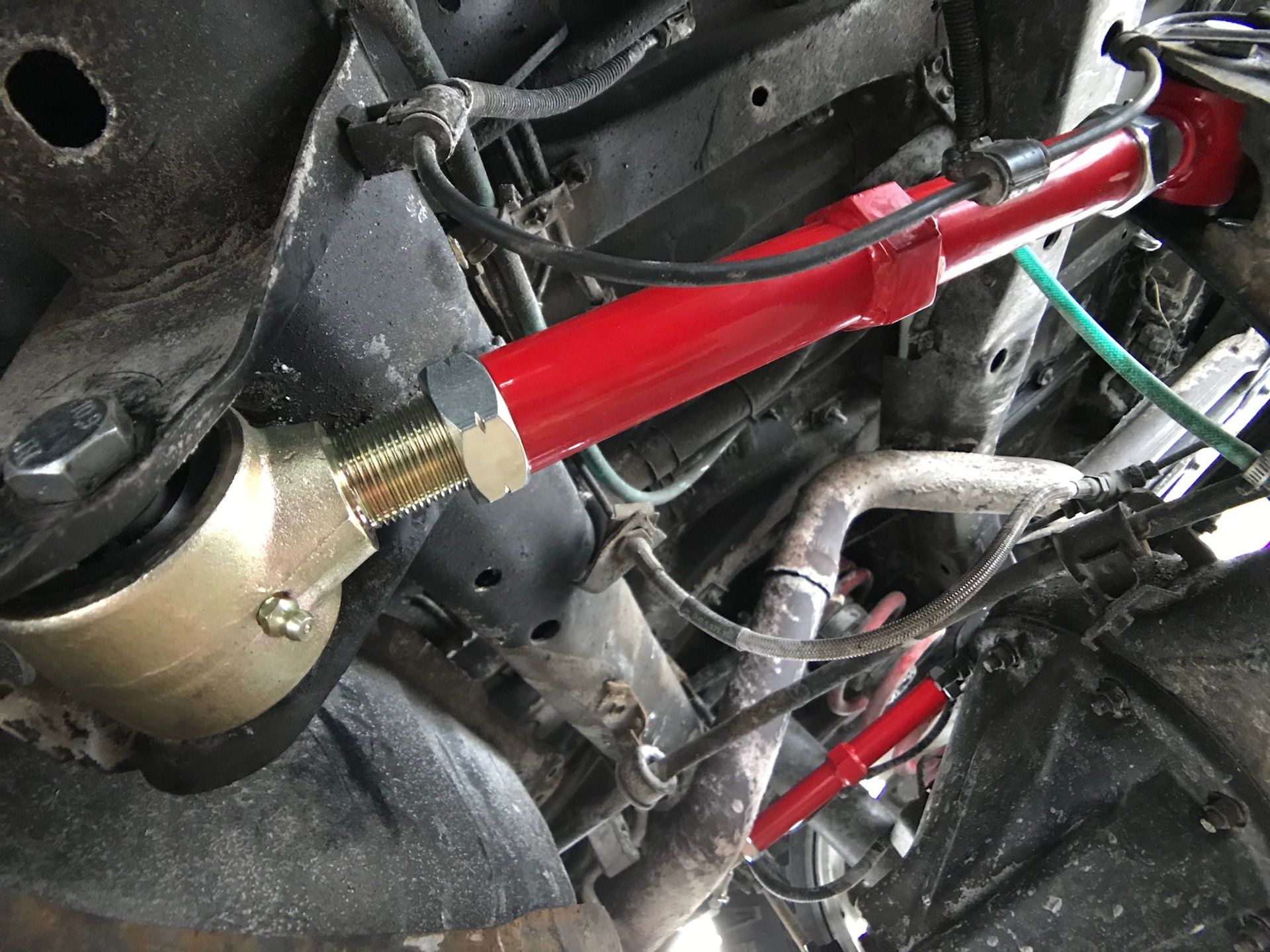

Shoveled the snow to clear a nice spot on the drive then wrenched. Replaced the OME Nitros with the Tough Dog 53 Foamcells (to match the rears). Then added the @reevesci TrailTailor fully adjustable upper control arms with Curry Johnny Joints for a nice upgrade with new greasable bushings. The red powercoat looks awesome. I was detecting a subtle vibration at speeds over 72mph. This should allow me to adjust the pinion angle and take that right out.
Wish these adjustable uca's were available when I bought the MT uca's. Being able to adjust with out removing one end of the uca would be so much easier. TT makes some good stuff.
Now that they are in place, I can just loosen the lock nuts and count my turns on both sides. Agreed TT @reevesci is making some great stuff at a makes sense price. Just replacing the bushing or doing factory uca’s again didn’t make sense when these are available.
Install Note: I installed them the same length as factory one at a time with the weight on the tires. To align the holes I just put a small upward force (floor jack) on the front of the diff to create the length needed.
