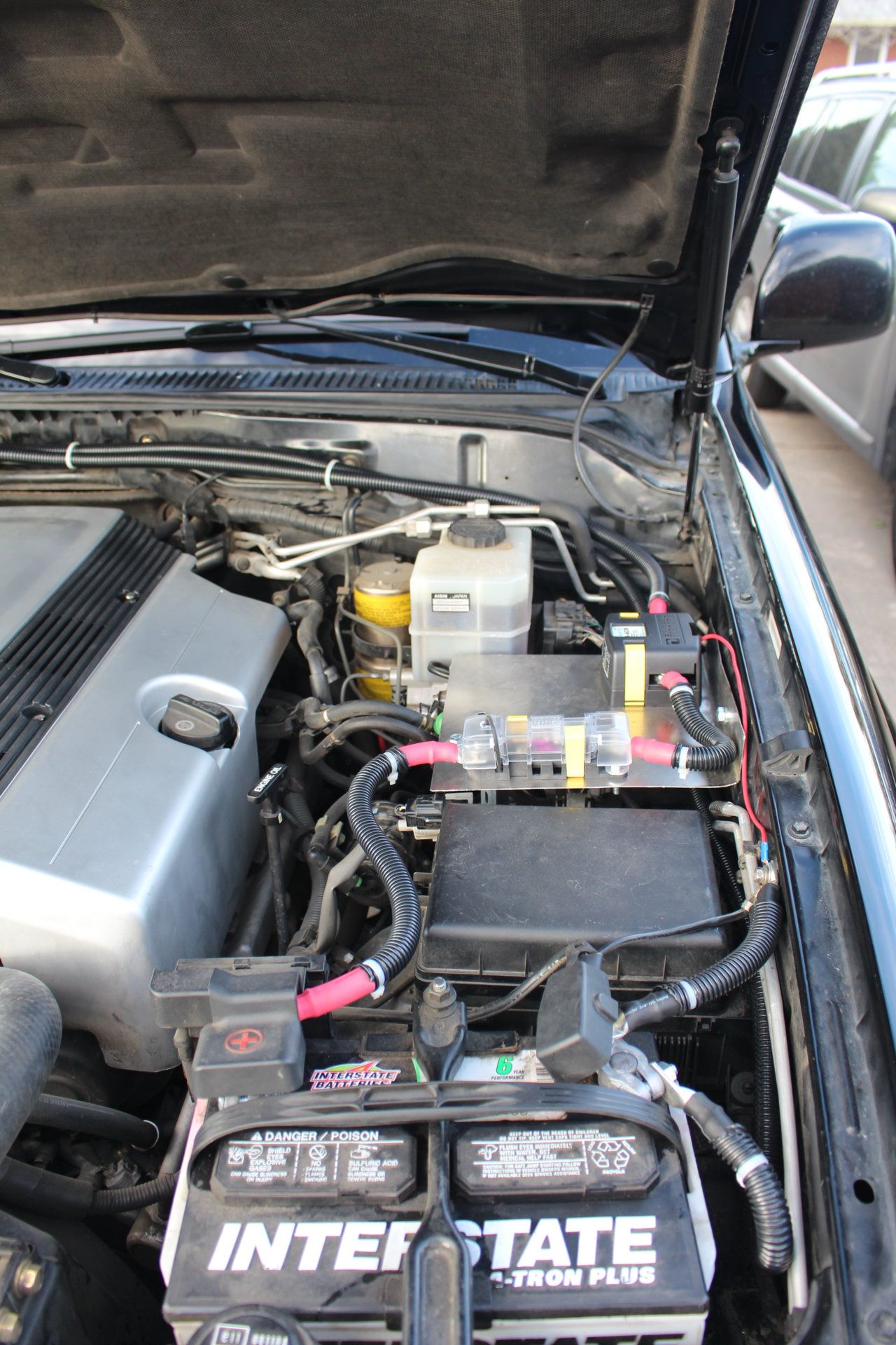

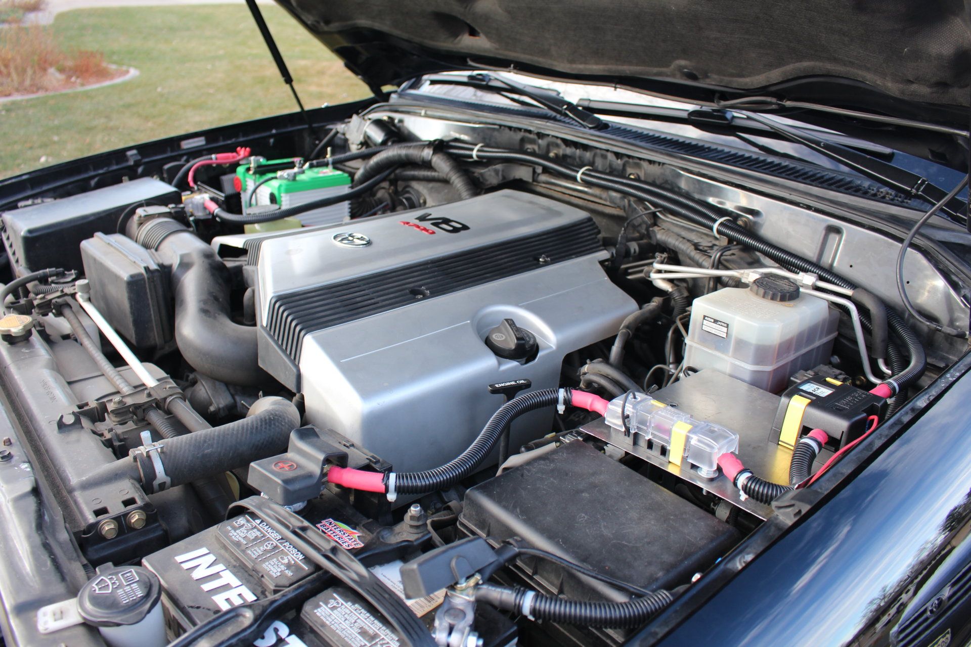

Added a dual battery system to power the fridge, USB's and a light or two. Thanks to this forum for the inspiration and confidence to try this myself.
Looks Nice and Clean....... now find the good quality black wire ties and replace all the white ones. :rofl:
