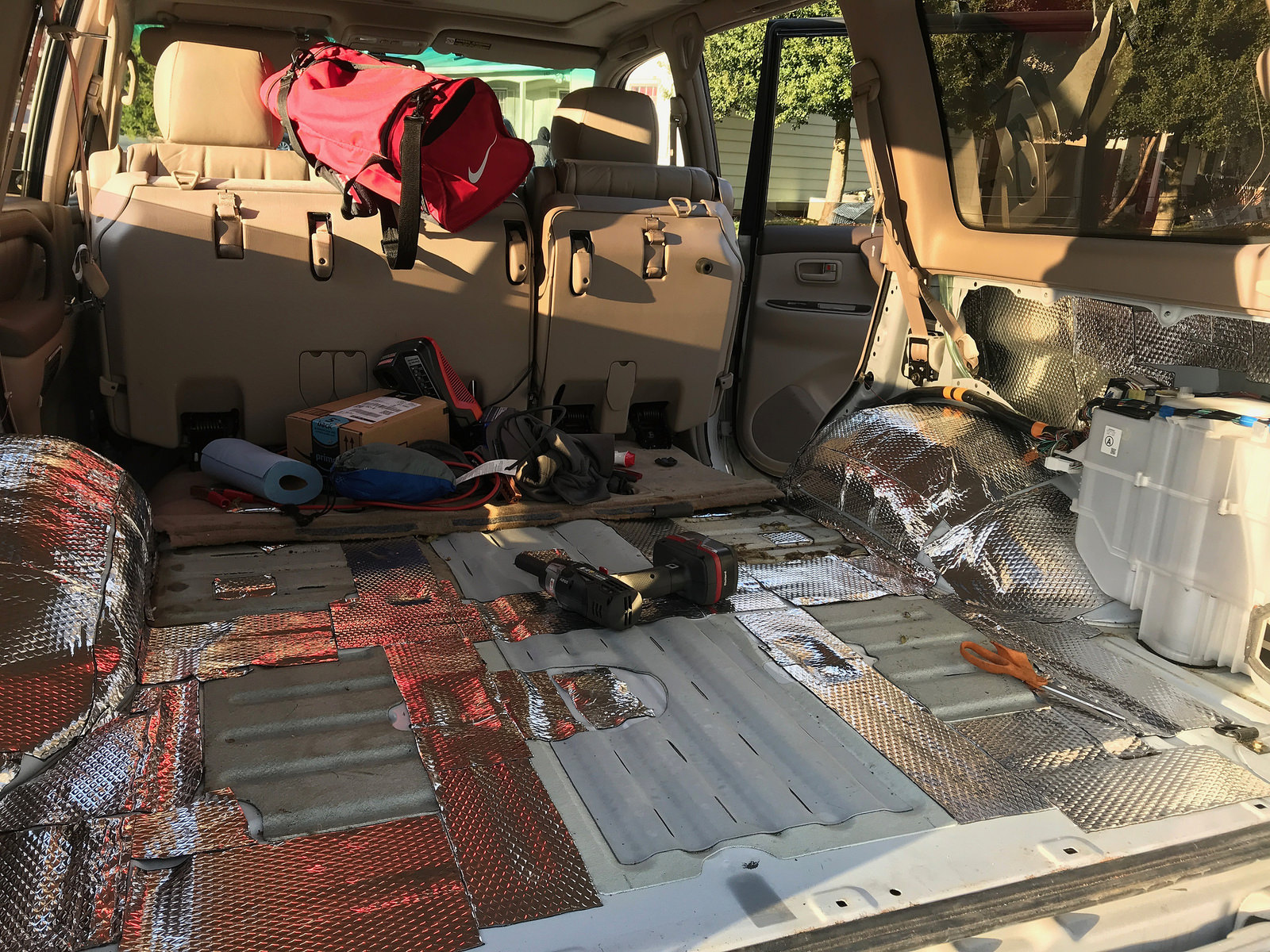

Started working on sound dampening the rear, hopefully this adds a little layer of insulation for me as well when i sleep in the truck. The cargo floor already have sound dampening in some parts, i just laid material on parts that is just metal.
Boy there sure is a lot of usable space if you take out the panel, and that white box to the right, is that some kind of ventilation thing? I see an opening that goes down to the bottom of the truck.
The white thing is the rear ac/heater unit. Runs up to the vents on the headliner behind the second row seats. May she be as quiet as a Prius......
ah that's what it is, yep, just tested it on the freeway, all i can hear is wind noise, not much of road noise. I lined the front doors, rear doors, rear cargo area, and floor. crap ton of work but i think it's worth it. The rattles have been cured too, stereo sounds nicer. Could be placebo for all we know but i'm happy with my results.
Wind noise is from a crappy windshield install, wish i knew which part was whistling so i can fix it, drives me nuts.
