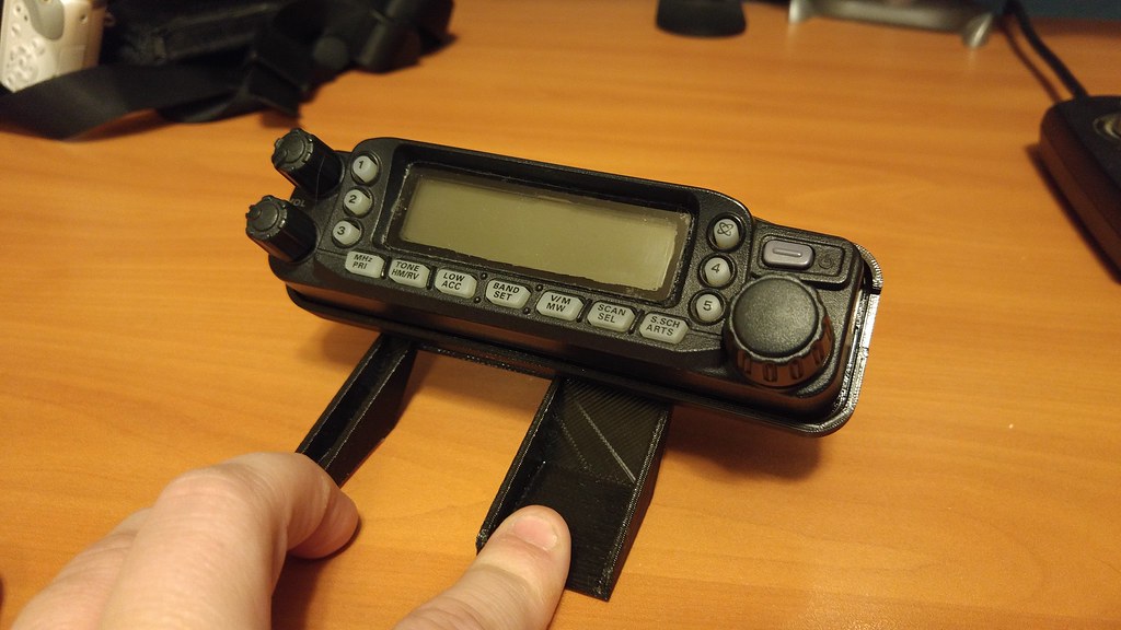

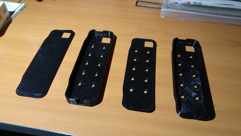

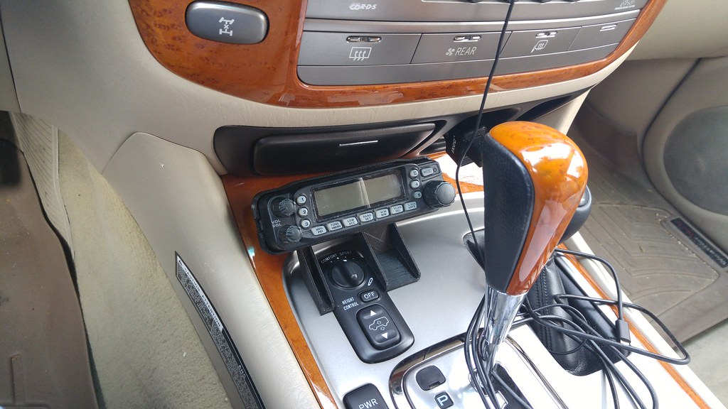

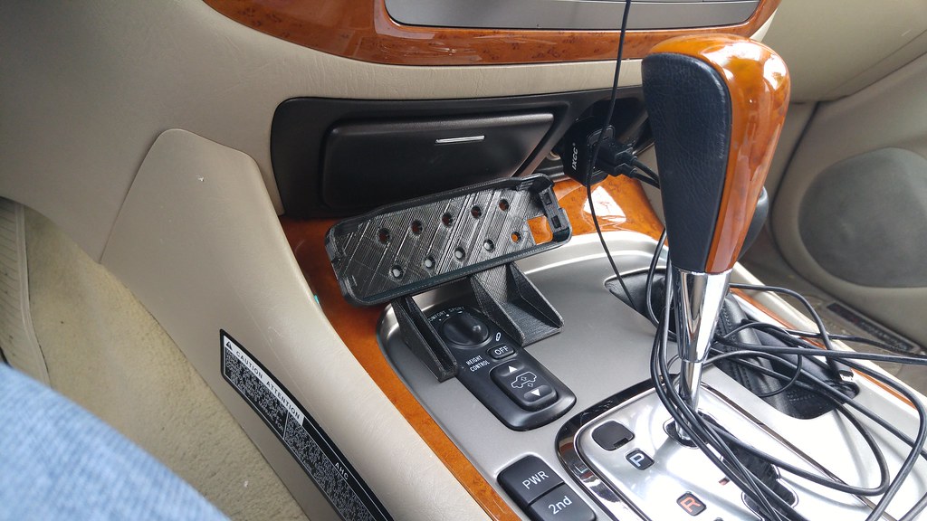

I used my long weekend to design and build a mount for my Yaesu FT-7800 face plate.
On the printer (excuse the blur):
From left to right: Print failed due to power outage, print successful but locking tabs were too low, print failed to adhere properly to the bed, final successful print.
Whipped up a quick 45 degree bracket:
Installed:
I can still remove the face plate if needed:
This is just a prototype. I will reprint in nylon this spring when the temps rise and the PLA plastic starts to fail. I am sure I will make some changes (I already have to both parts, but these are usable).

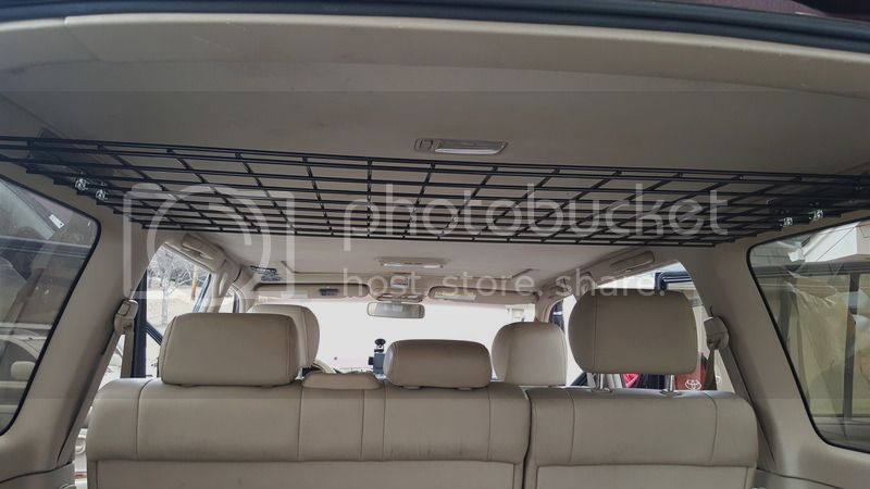

Installed my Cobra CB and a storage attic over the cargo area. Had some brackets made and bolted them in where the 3rd row grab handles go. Got a 2x4 wire grid and 4 U-bolt / wire rope clips, works great for light weight bulky items, like jackets. Also good for hanging bags from. No more jackets or coats laying in the rear seat.
