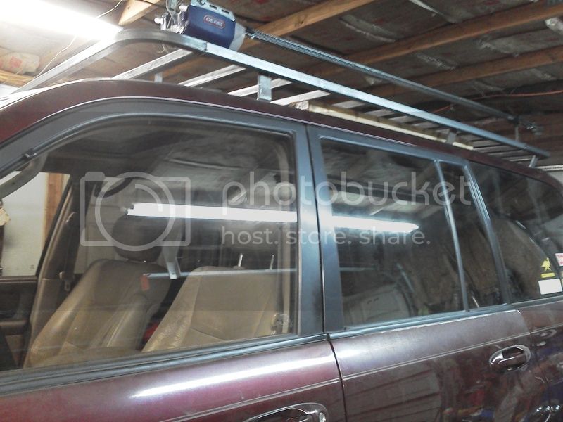

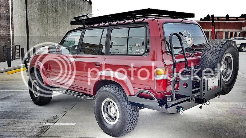

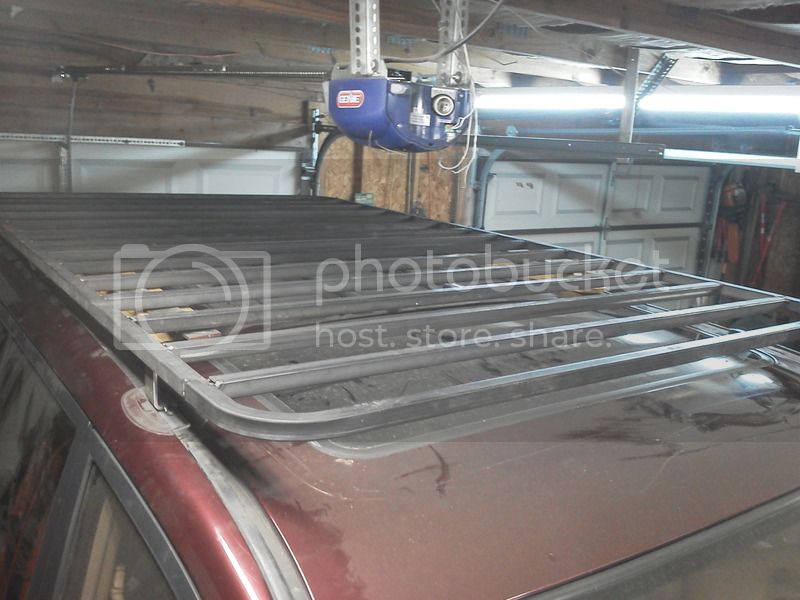

Roof rack, sliders, rear bar, and front bumper with fender guard rails are done. I was going to powder coat them but couldn't find anyone that could get to it for a couple months so I dropped it off to my paint guy yesterday. He took everything off today and prepped it, going to spray them tomorrow. After that I have to mount the winch and wire up all the lights including a new 50" light bar and a couple rear lights mounted to the roof rack.
I have to cover those damn ugly gold badges up as soon as possible.
Front reminds me of the 80- AOE
J
I was going for a mix between the Slee and ARB. I like the sides of the Slee but also like a full bull bar, this was the best I could come up with. The rear is modeled after the bumper I had on my 80 series. I'm really happy with the way everything turned out. I'm looking forward to getting it back tomorrow, it's been gone for almost 4 weeks
