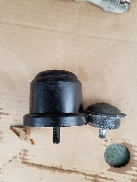

Pulled out my Wheeler's bump stops on my 06 LX. Just was not the combo I was looking for. One of those deals that loved the pros but couldn't take the cons.
What cons? Last time I checked they didn't really limit travel.

On the stock AHC LX the bumpstop at N height is in contact with the lower A arm. If you try to go into the low setting the truck will drop about .5inches. The ride was firmed up and the truck handled well in corners but they limited travel and really limited the factory shock to operate through the full range. I had high hopes and thought they would compress more and be softer.
I think they would be a better fit on a lifted truck. I thought about trimming and still might but, after pulling them I like it better.
I do think they limit travel quite a bit with my experience and will take some measurements and update in the Superbumps thread.

I agree and think they should only be used with extra weight/in a lifted application.
I just remembered seeing fully compressed in the other thread they were only about .5" longer than OEM fully compressed. But at stock height that .5" really matters.
