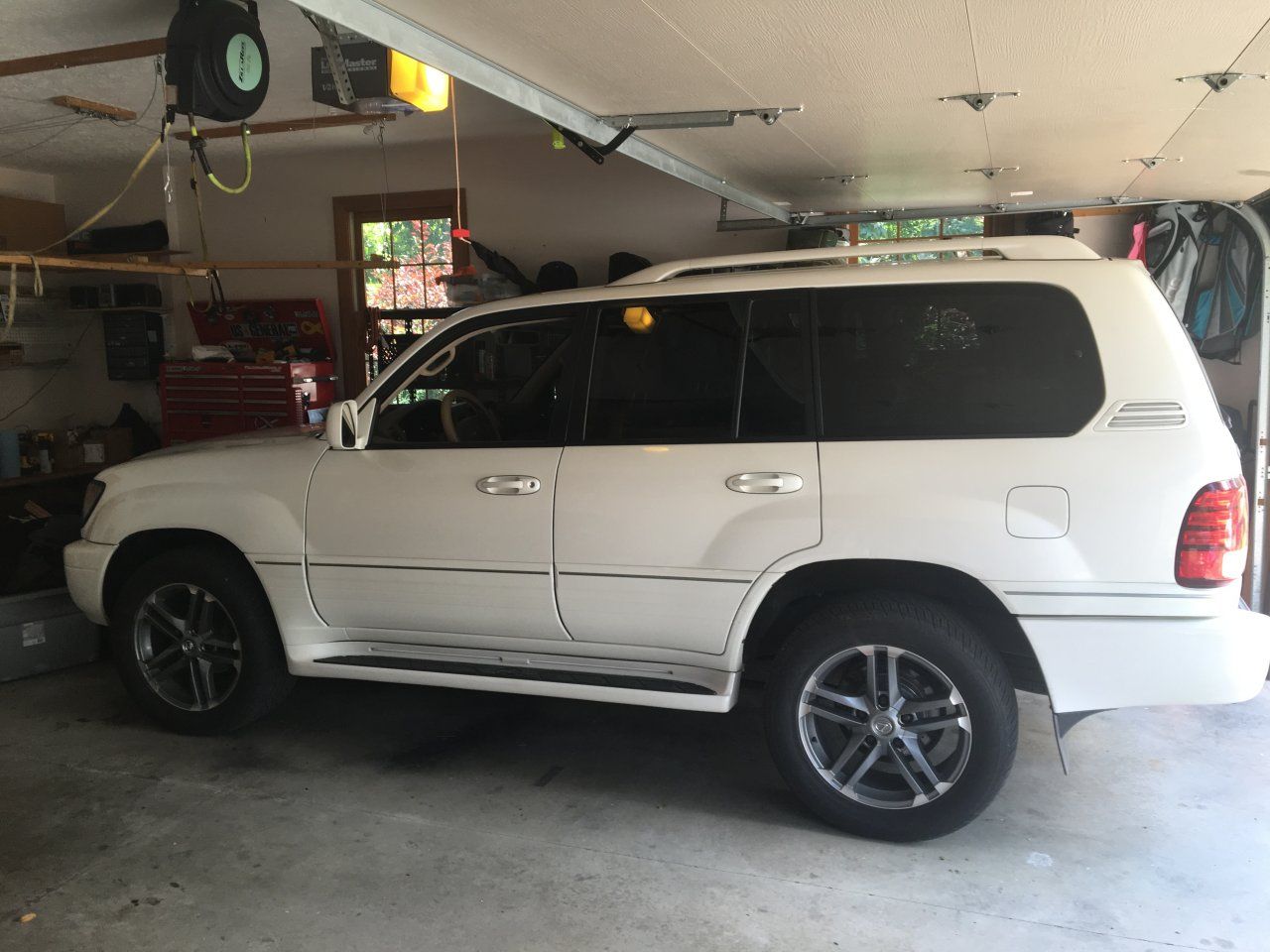

Some rough body work to clean up some damage from Hawk Pride a few months ago, four coats of paint, four cots of clear, new molding = time to hit the trails again:

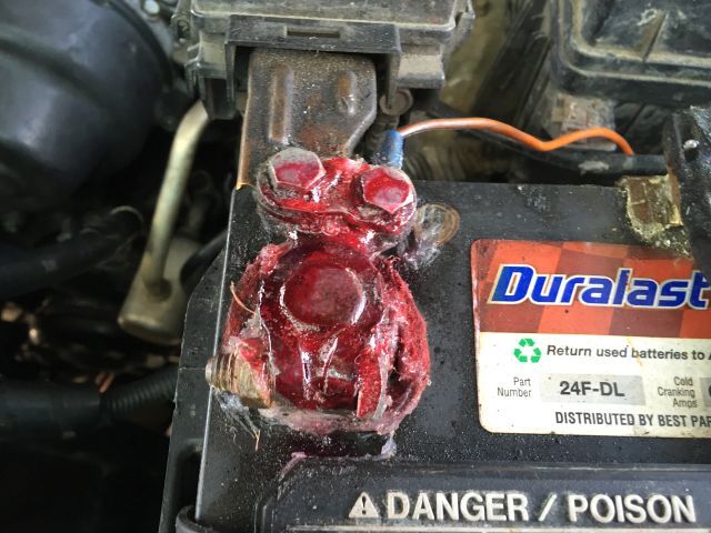

Two weeks ago changed out water pump, old one was leaking (1st pic). Put on new timing belt while doing so. used instructions here spressomon and here scottm great help. Been having battery light coming on and off sporadically for a few months now. After searching threads decided i will change the alternator, did that today. Next on the list is the power steering pump. First i removed air box, took off negative lead at battery, then i drained radiator coolant in a bucket so that i could reuse it. i then removed the lower radiator hose made it a lot easier to remove alternator from top of truck, i then took the belt off. First pic of alternator showing where screw is to remove battery power lead. 10mm i removed this while alternator was still attached. I then removed power steering pump and pulled the alternator out and unplugged the electronics power lead. Then i wiggled it out of the top. Wiggled new one in and plugged electronic power lead in then mounted it on its mounting screw. Then put power steering pump on, then serpentine belt. I then put the battery power lead back on and put on some dielectric grease and placed cover on the screw. Then cleaned battery post and put dielectric grease and battery terminal spray on them. I also changed the upper and lower hoses with new ones and poured coolant back in radiator.

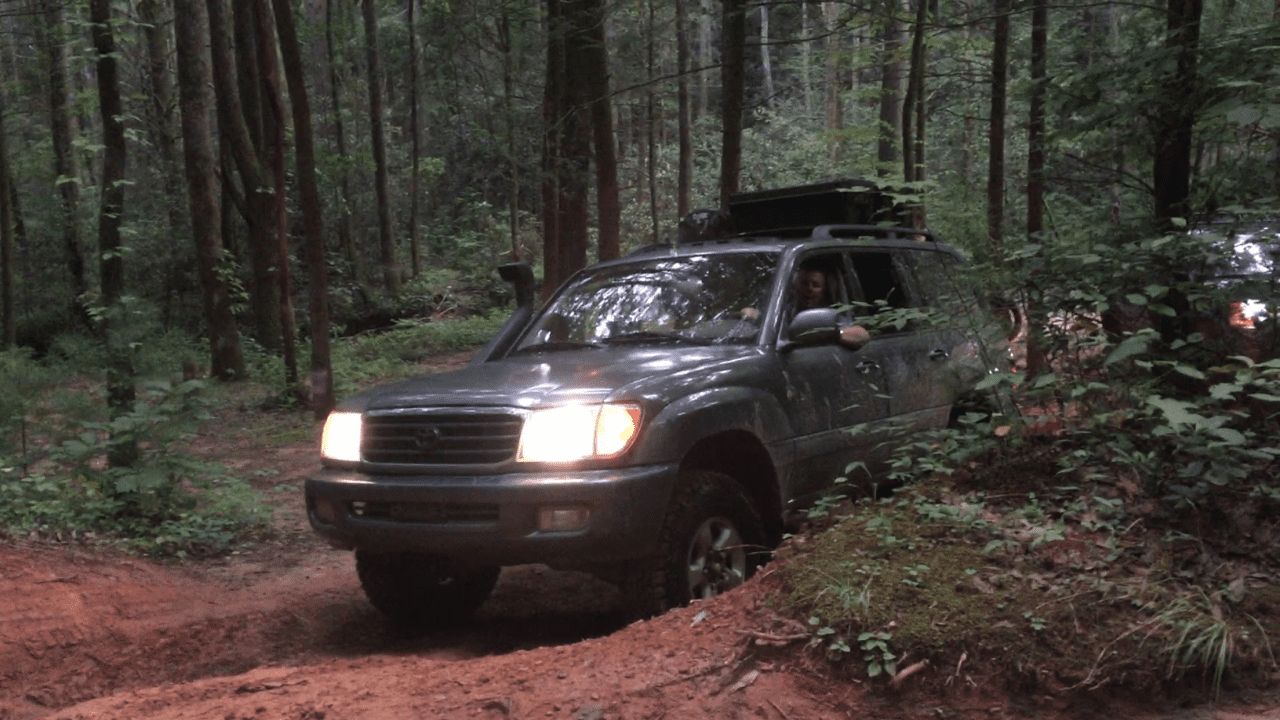

I drove it to the Mohonk Preserve to trail run. Met some turkey vultures. It was downright primordial in the woods today; I felt like I was running in a swamp.
