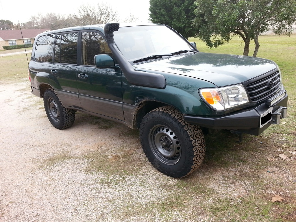

Any other shots of the front end of your truck? Looks really good...
