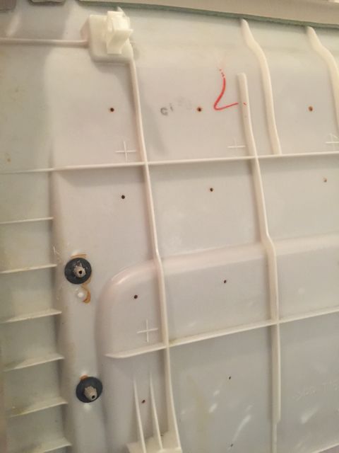

Fixed the sagging seat back net on PS front
Damn kids
Takes some "encouragement" with a razor shaving down the plastic tab to get the metal compression washer/clip off of the top right.
Measure, tie knot, cut and heat with lighter to keep end from fraying
Put it all back together....
Still looks like it has a very slight sag to it but that's only B/C I didn't want to pull it so tight that I couldn't get anything in there. Most of the elasticity was gone. There are other ways to fix this by buying new elastic cord from a camping supply store or buying the replacement net and the entire housing from Toyota for about $30 (I even found a write up where someone put the LX 'pockets' on a TLC for about $60). Went with the free fix first since we don't use these except occasionally on a road trip to keep an extra activity book or movie handy for the kiddos.
This took all of 20 min of time on the couch with my wife trying to have a conversation with me. Worth it if your net is sagging.

Do you have that link for the LX conversion? I tried to find new elastic cord locally, do you have a link to an internet supplier?
sure, here's the link i used for doing my "el cheapo" fix, which, like i said, i figured i'd try to just tie-off/cut my existing:
How To: Repair Sagging Seat Back Pocket on LC
if you want to replace the netting set entirely with new:
Seat & Headrest : CruiserParts.net, Toyota Landcruiser Parts
or you could use tent pole shock cord, like this - disclaimer, this is just an example, i didn't check diameter or anything. the 'hole' on the frame it fits into is pretty small, but could be drilled out a little if necessary
Tent Pole Elastic Replacement Cord 1/8" x 26 ft Gold Tent Pole Shock Cord
lastly, here's a write-up on doing the LX conversion if you can track down the pocket itself (i just don't know the part number).
Seat Back Pocket, LX470 & Landcruiser interchangeable?
down the road i will probably put in the LX pockets just b/c cleaner look and less snagging points for kids feet, dogs and gear; but thought i'd give the free fix a go and while it's not perfect, it was super easy/fast.
be sure to read up on how to pop the panel off by pushing down on white retention clip and actually pushing in to release the panel from the seatback. it almost feels like you're going to break the tab you have to pull so hard. but they're not that expensive and easy to replace if you do bust it.
