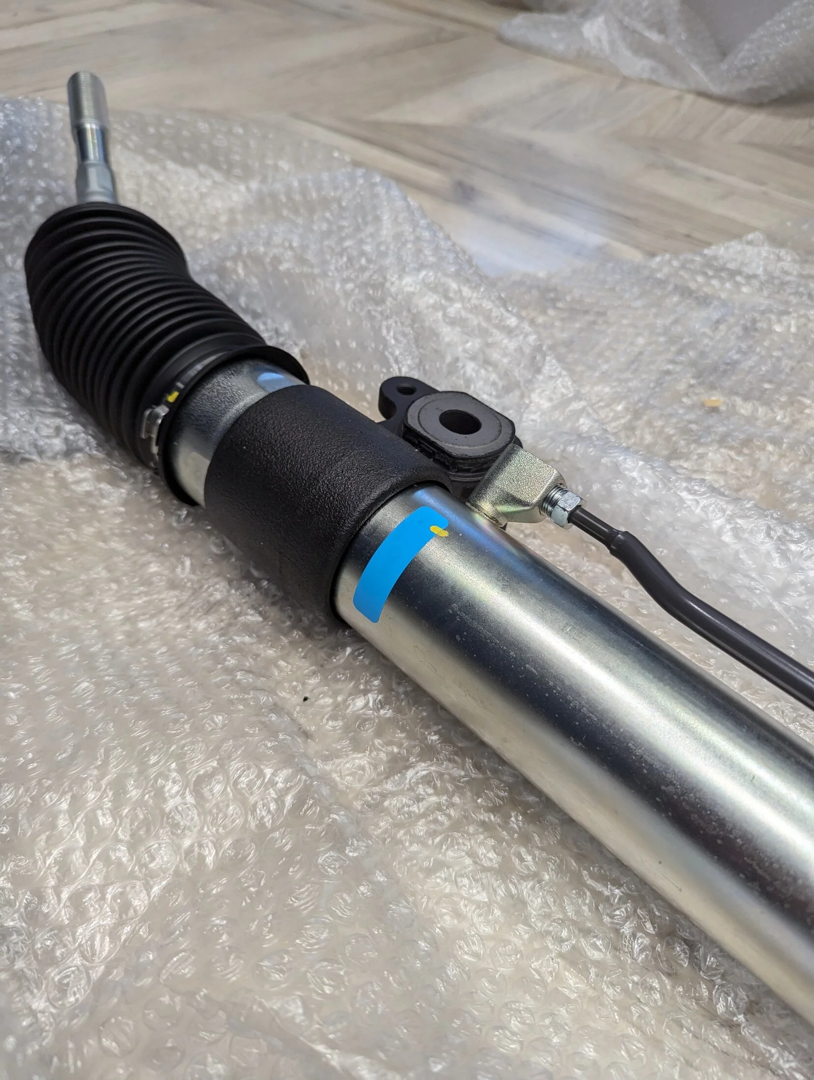

Well the remaining 2 parcels arrived from Japan, a steering rack in one, and then all the odds and sods (bushings, droplinks, filters, rear height linkage, bolts, nuts, washers), the sort of stuff that costs a ton when you add it all up.
Tail end of last week I was watching some videos posted by one of our resident 100 series aficionados (2001LC) about CV/hub wear/play and tested my own, sure enough the inner and outer CV joints on the front axles were absolutely cooked.
Fast forwards to today, I just had two new OEM CV axles drop at my door courtesy of a seller on ebay in UAE, to say I'm spent out is an understatement.
Now the fun part, I actually need to start fitting these parts and doing it on a sloped driveway is far from ideal. I've been going through my list of jobs and being realistic about my time/facilities, and I've decided I'm going to be contracting out some of the more involved jobs right now through fear of tempting fate. The farmer I had hoped would support my efforts is currently using all his buildings for storage so I'm exploring other options.
