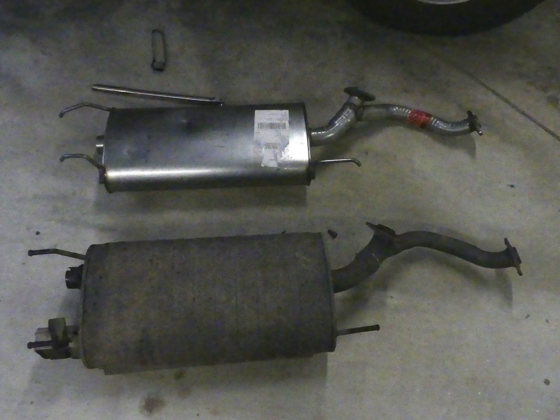

Enough blather - onto the pix. The first photo shows the hangers I had to bend - they are fairly stout, so heating them made it less likely they'd snap off the muffler. Murphy's Law and all....

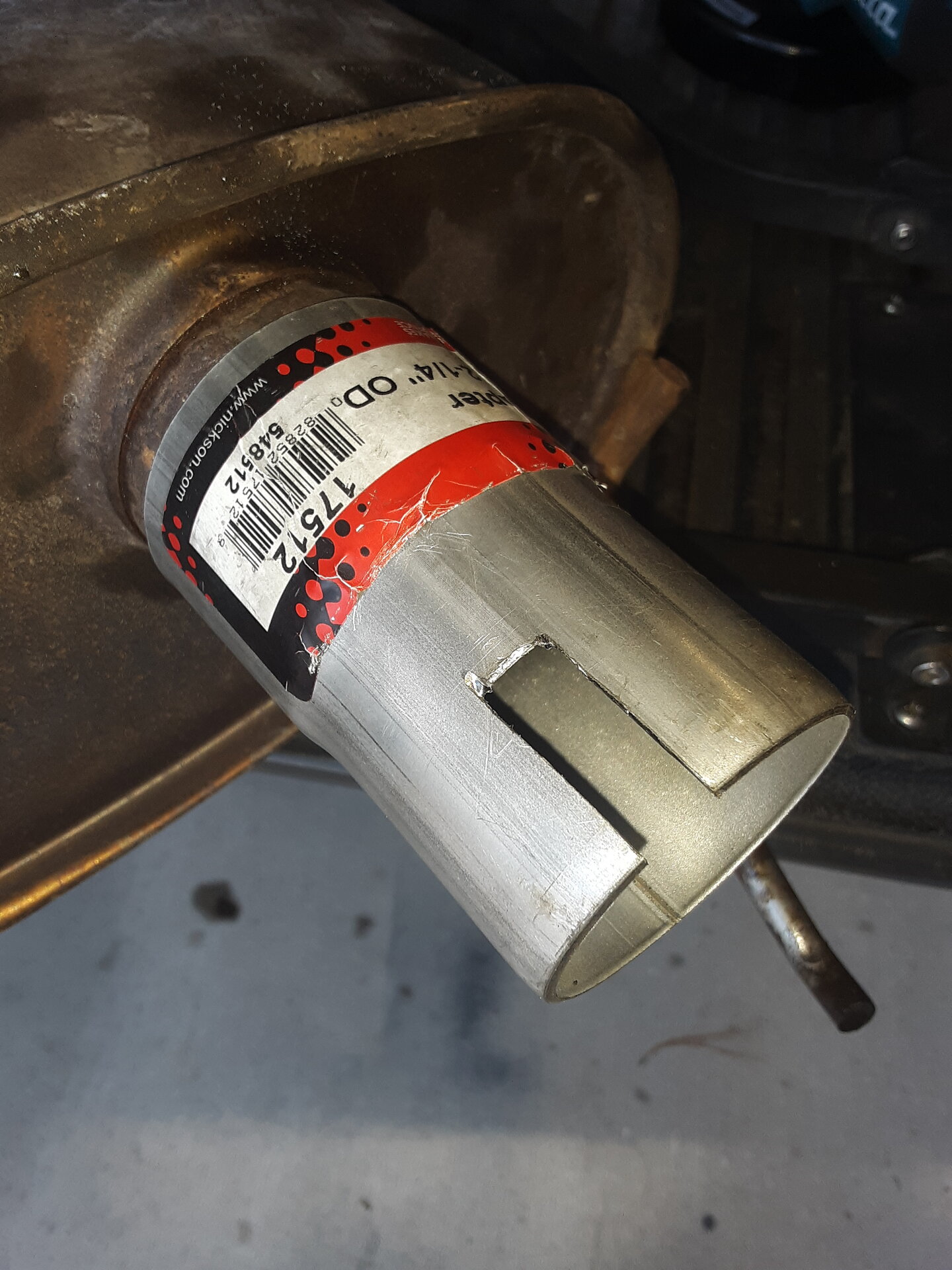

Fourth photo - I slotted the adapter (small side) to clear the pip. At this point the entire affair slides together under the truck. You have to juggle getting the 3 'rubber bands' onto the exhaust hangers as you engage the tailpipe. Use WD40 as lube for this. The last step is attaching the inlet pipes with new gaskets from Toyota or Walker. I used all new bolts/nuts with anti-seize on them.
Fifth photo - shows slotted adapter slid into tailpipe.

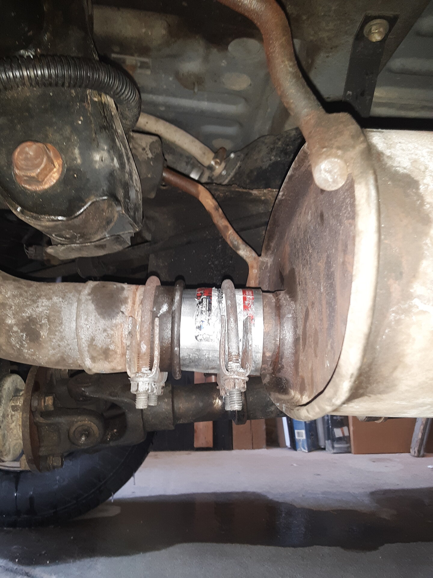

This reply shows the slid-together adapter on the back of the muffler and tailpipe, and then the added clamps. Seems very solid.
