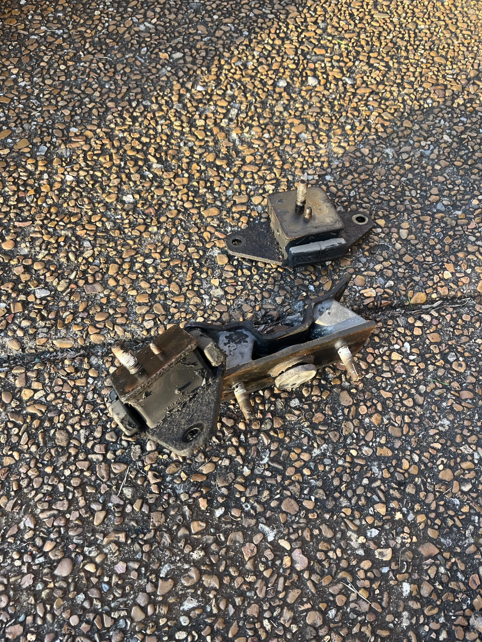

on a 1-10 scale how hard was this DIY?
Maybe a 6. Just awkward getting to the bolts. I used a long flex head ratcheting wrench on the top nuts through the wheel wells and had enough space between ahc stuff to get them off. Did one side at a time.
Rear bolt and nuts on the back are easy from bottom. Got the driver front from bottom, passenger front from top.
