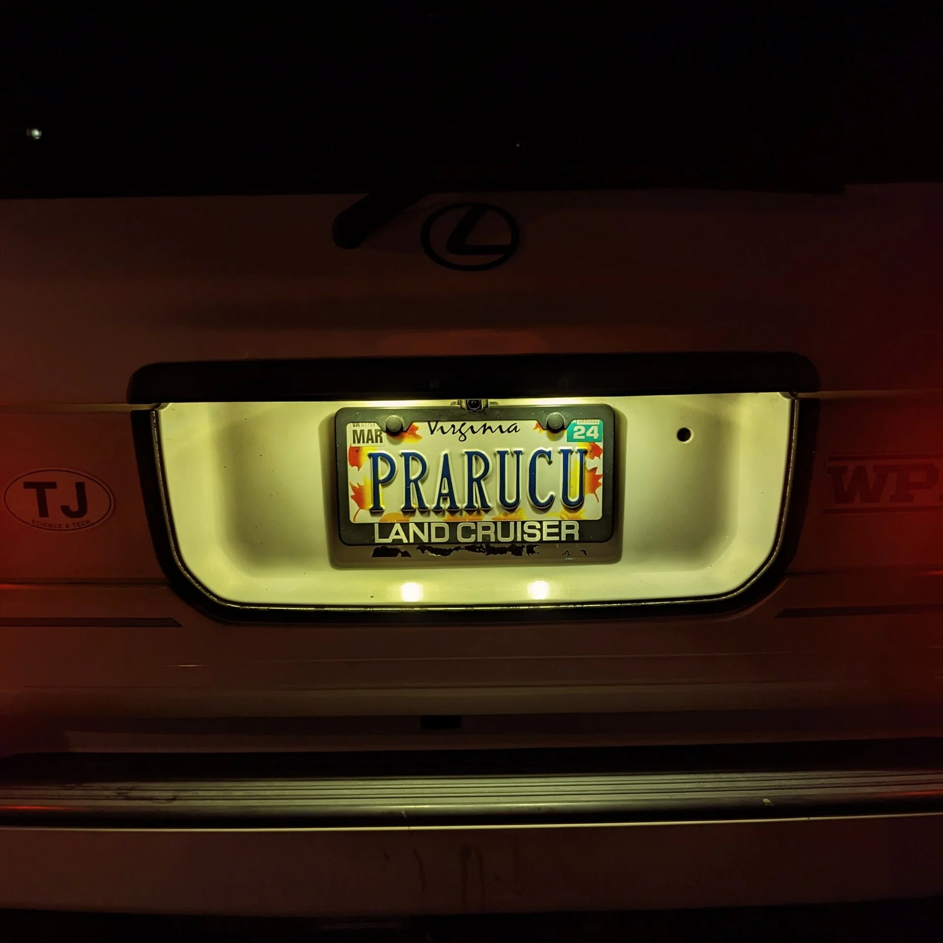

Interior 168/W5W bulb to LED upgrade. There are 6 of these in total, I believe - one for each door's courtesy/puddle light and two for the license plate. The front driver's light was broken since before I got my LX 1.5 years ago, and 1/2 of the license plate lights were burnt out anyway, so I was happy to spend like $13 for a 30-pack on Amazon and replace all of them at once.

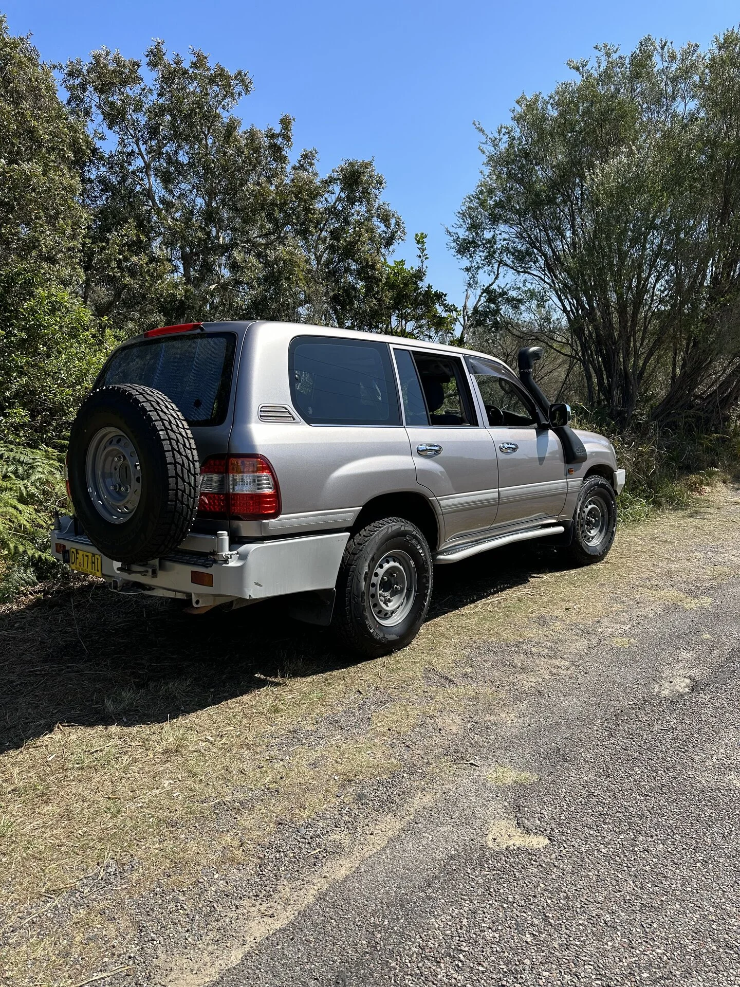

Put some 79 Series take offs on, got the set of 5 for less than one of the 17” tyres would have cost to replace
Are the lugnuts correct for steel wheels?
Looks like the ones for alloy wheels. I could be wrong as usual.
You’re correct, these have the flare and pressed on washers, I couldn’t wait to get the wheels on as I lost 2 tyres to sharp rocks last week and they were losing air overnight. I’ve ordered a set for the 79 series they’ll be here any day now

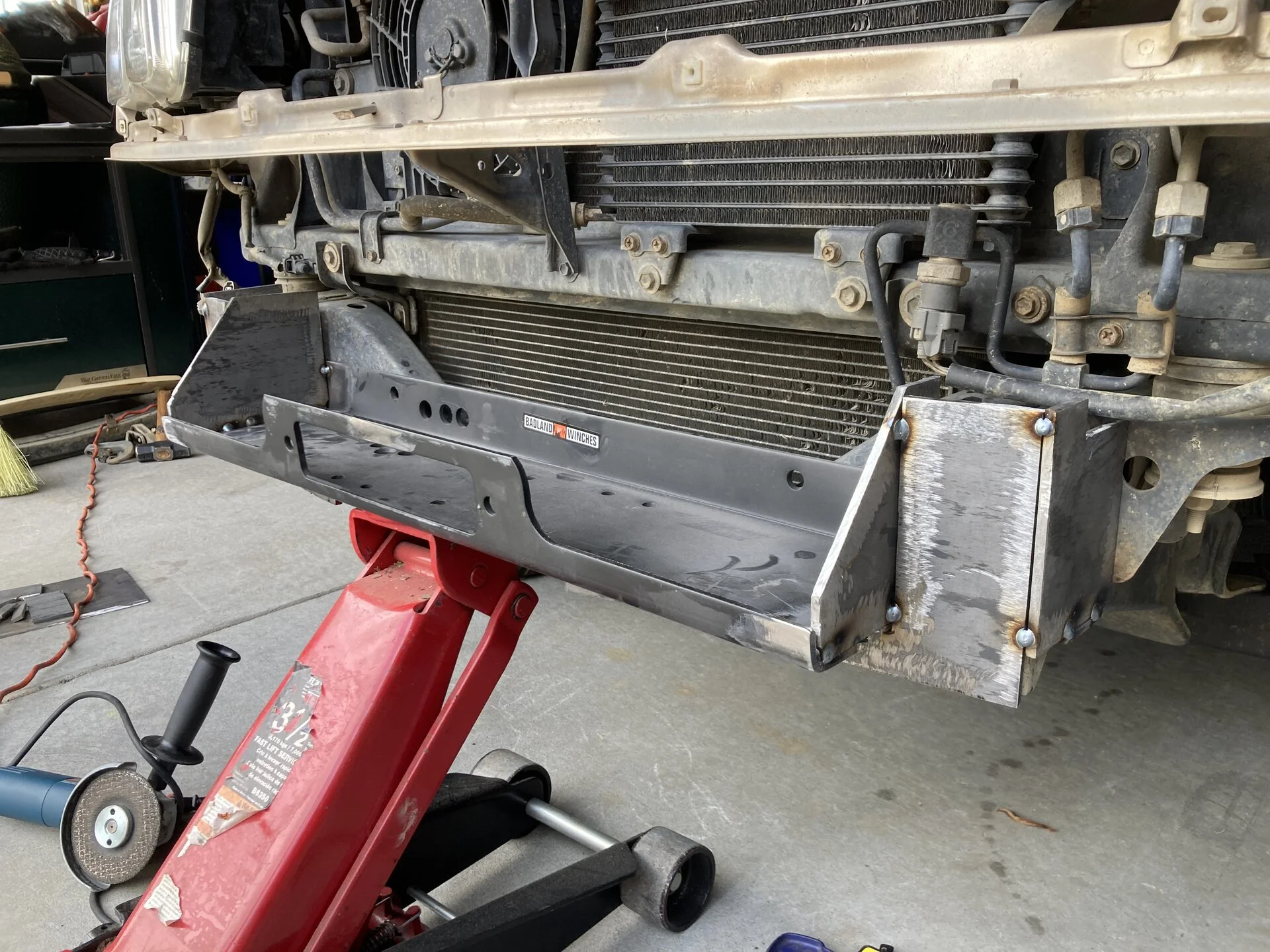

Made a hidden winch plate using the Harbor Freight one and some 3/16” steel plate. Pretty fun project so far!

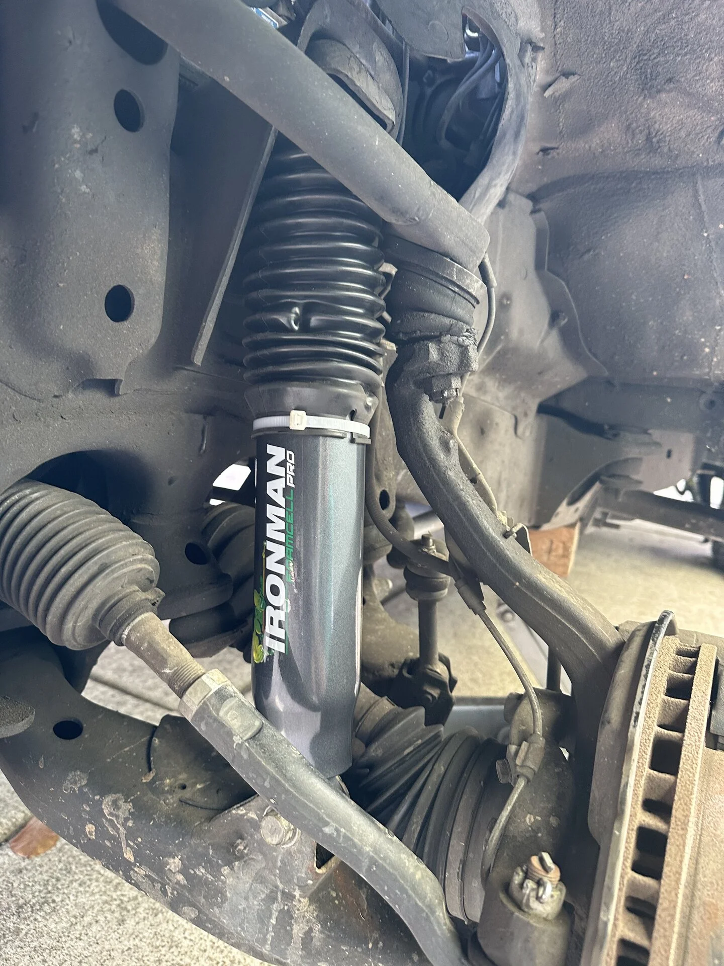

Its a little softer small bump sensitivity and mid stroke. Also a little less vibration and heim joint noise w the hd rubber bushings.
I think the fcp is a little closer to what I want for city driving. Also, the icon stage ones in the rear seem a little small for a 100. I had one blow early on.
I got the FCP on sale so I would wait until they do another, otherwise they’re like $1200 (I think?)

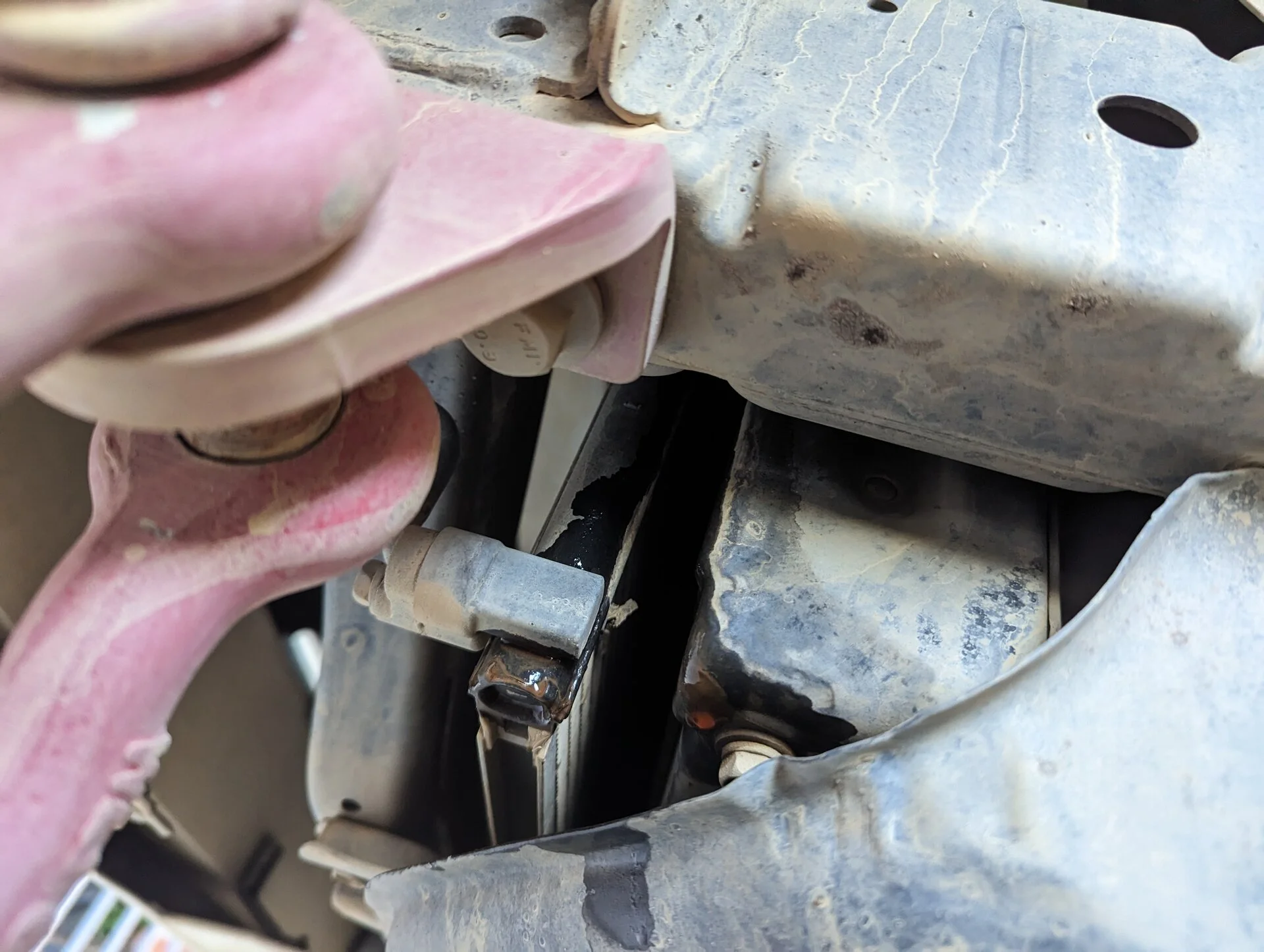

Heard a loud pop yesterday while turning. Also might have flown through some speed bumps beforehand.
Didn’t spend enough time figuring out whether or not the nut broke off or backed itself out. Anyway, great excuse to get those extended end links I always wanted.
