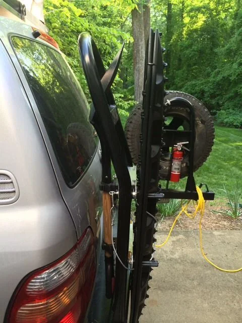

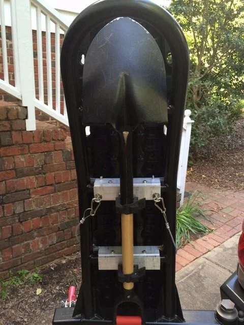

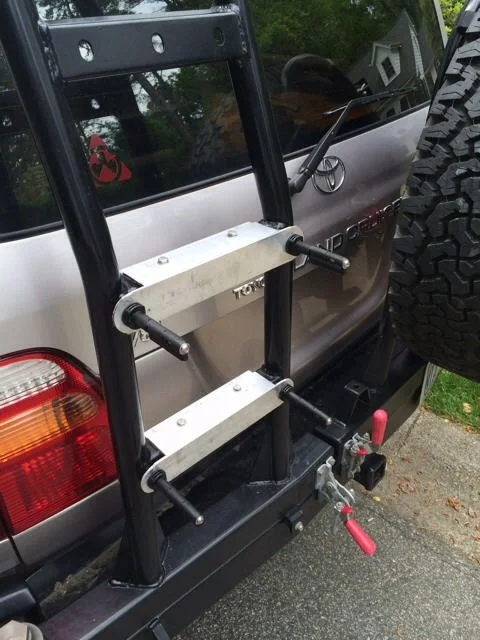

Made a Maxtrax and Shovel mount for my Slee ladder swingout. The system is removable for those times where you don't need the accessories. Includes cables to hold more securely and offer some additional theft protection.

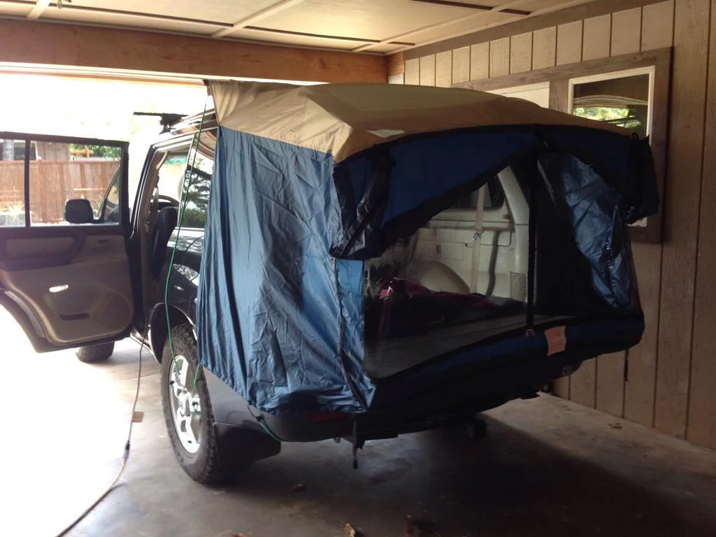

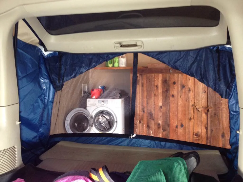

I didn't do anything to her... But I bought her a tent! Some Chinese built, over priced buggar. But it beats sleeping on the ground and it's cheaper than a roof top. Lighter weight too. Cost $139 on amazon. And I kinda like it. The doors are kinda short in length. I thought it was a fault as I need to lower my top hatch a little to get it stretched over the bottom, but I think it's actually as designed for water shed purposes.
...via IH8MUD app
Just curious, what purpose does this serve? Ventilation? I know a lot of people that just sleep on a platform in the back.
I dont have a platform built up. in the past i had just tumbled the seats forward and slept in the back with under 6 feet of space to lay down. ive dropped the tailgate to gain extra foot room and stretch out, but then the bugs came in... Now i have a screen/nylon condom i can snap on and ill be good to go :) Plus, when it gets hot in the car while its raining outside, rolling down a window isnt the greatest. while i havent tested it yet, im sure the extra ventilation will be one of the better benefits here in the tropics.
Andrew, I have one as well. It comes in different models. I'm not sure which model I have but it seems to fit fine with the lift gate all the way open. If you have a platform, you probably don't need this, otherwise, it adds ~18" to the length of your sleeping area.
The material is cheap nylon. I wouldn't mind reproducing it in canvas. LBPtaco on Expo did just that.

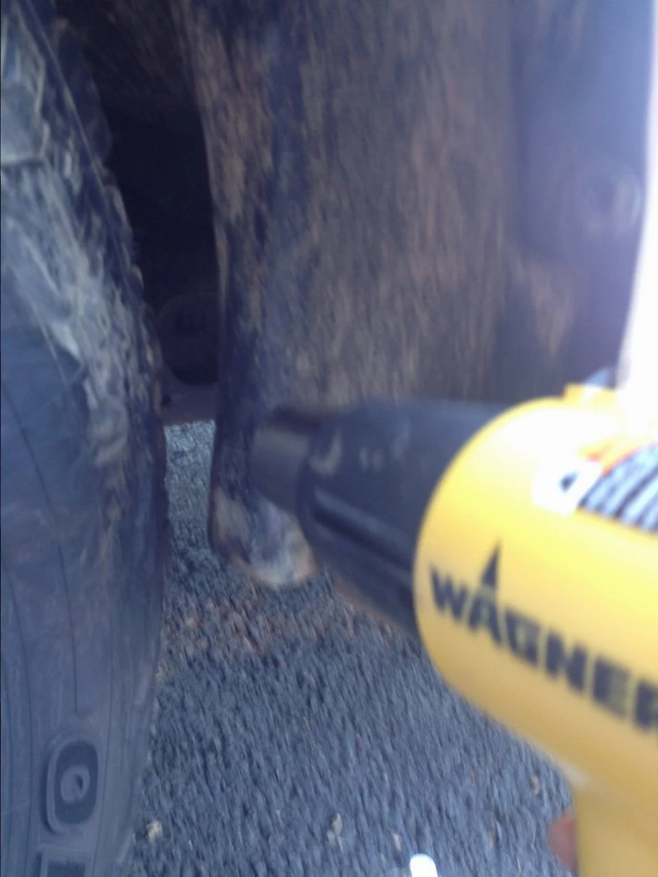

Removed the 33" spare.

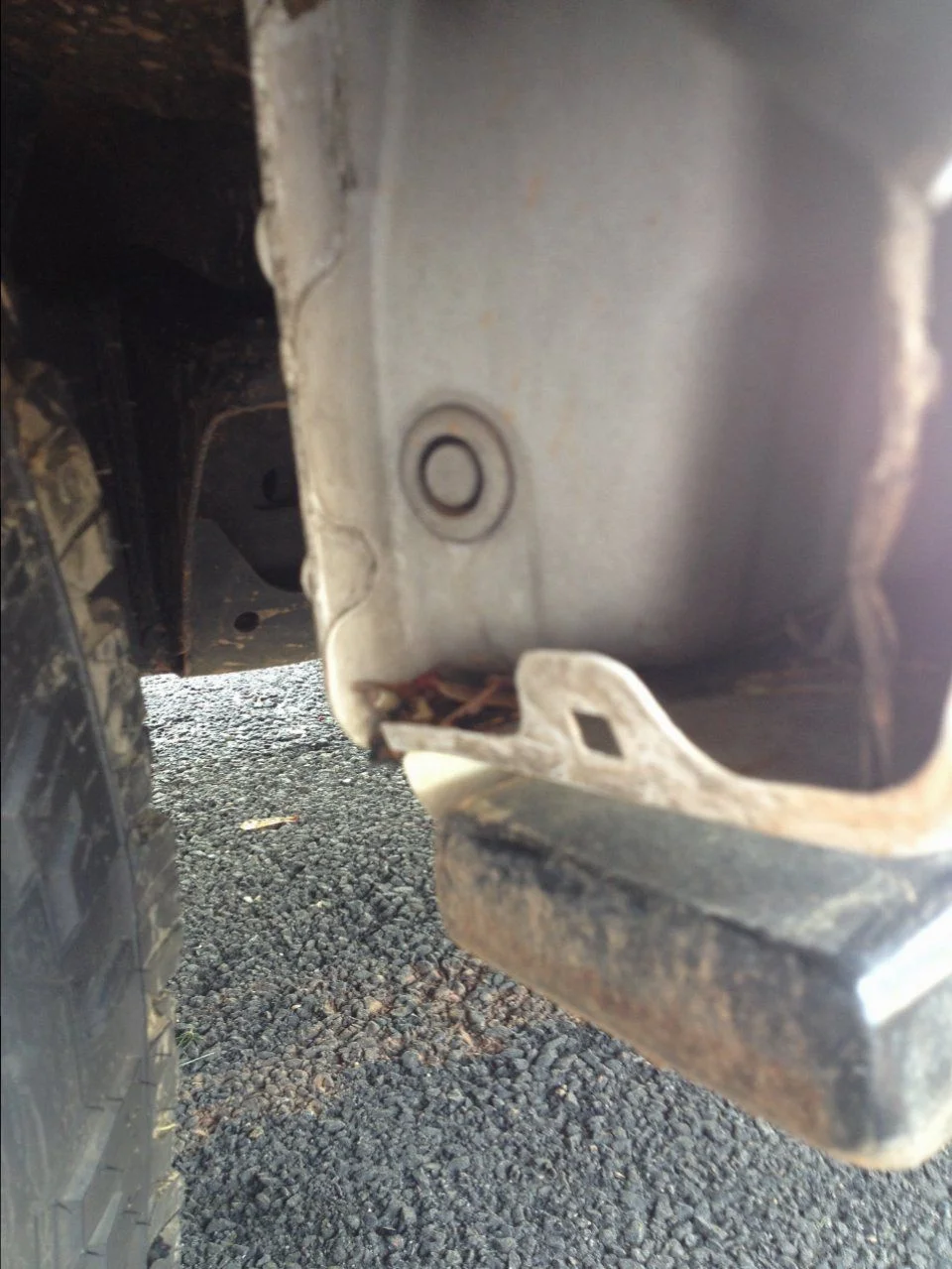

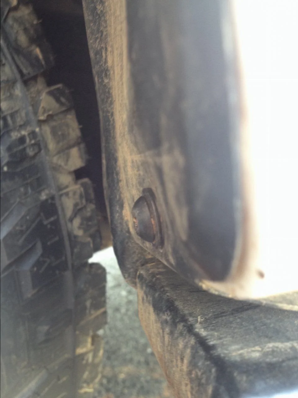

Pounded back the pinch welds and reformed the wheel well liner with a Wagner Heat Gun. No more scuffing!
I need to do both of these. Did you remove the liner before pounding back the pinch weld?
Here is how mine went:
1 pop two lowest plastic insterts (May also have Allen bolt holding them in) that attach inner fender liner to the body
2 pound away
3 peel away chipped paint, and hit with some primer, etc. (took a monster shard to the finger, so use gloves/be careful)
4 use Wagner/other heat gun to reform liner and flatten it out.
200 miles and no scuffs since

Nice! I'll have to pound mine this coming weekend.
Thanks!

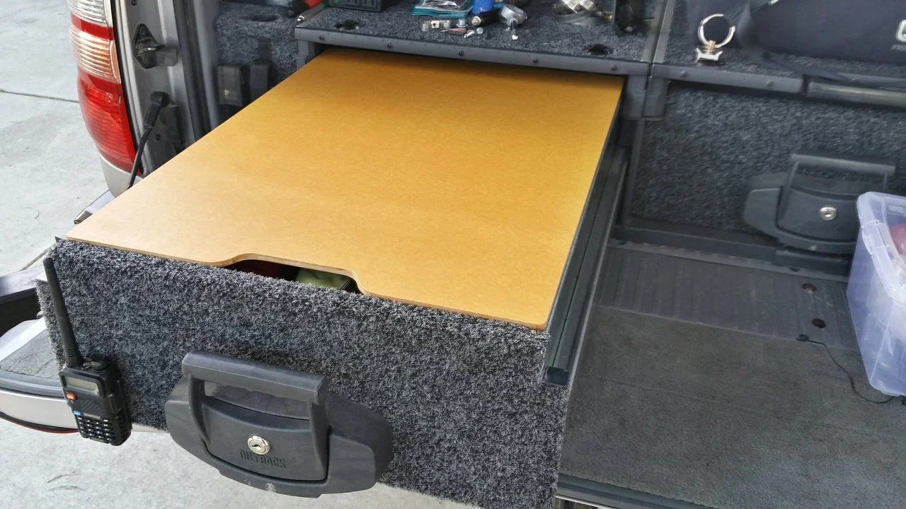

A cutting board / work surface for my one of outback solutions drawers. It's made of Richlite and uses neodymium magnets (epoxied to the underside) to keep it in place. Thanks to 1407Driver for this one.

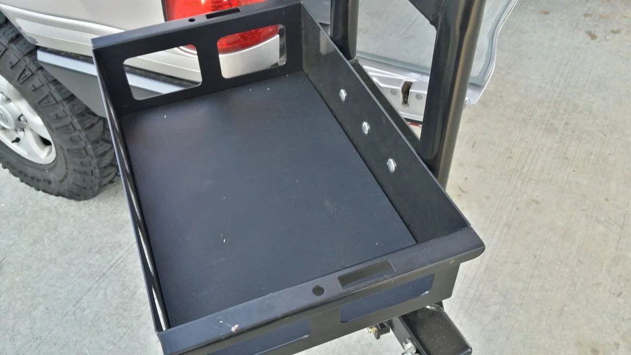

If you have a slee jerry can holder you know it has essentially an open bottom... I had some scrap HDPE so I cut to fit. When the cans are not living in it I now have a shelf to hold tools or whatever when I'm parked.
