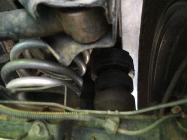

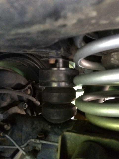

Installed Timbren SES to level out my 100 when towing my AT Chaser. Originally I had planned airbags, but after reading some of the issues with offroad use, tangled airlines, bags walking up the coils and talking with Slee Offroad about options with the Slee Heavies, these sounded like a great option.
Biggest issue was sorting which spacers I needed to keep things from stinkbugging without the trailer and keeping sag to minimum with it on. Installed in about 30 minutes!

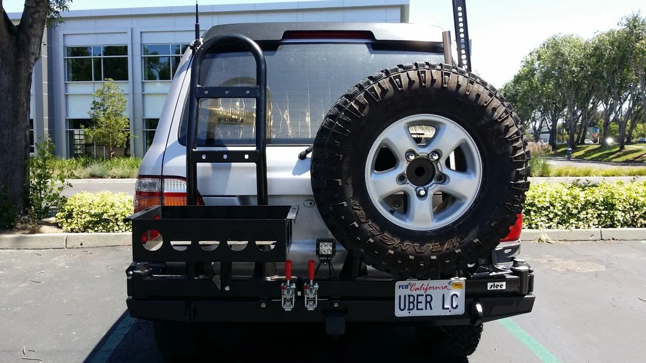

@cboyd, you're making stuff happen! Are you not planning to use a reverse/aux light in that location? Did you add some sort of connection to your wiring if you want to remove the tire swing out?
Also, can you tell me more about the Timbre SES or share a link? I've never heard of them. I recently posted this thread after the first fully-loaded week long family trip had us hanging like a pair of pants of a teenager!

Edit: Here's a link to the Timbren part for The 100:
http://timbren.com/timbren-ses/
The part number I used was TORSEQ with 1" and 1/2" spacers (based on guidance from Slee).
Slee is a dealer and sends the Kit with spacers and hardware suitable for your setup. Talk with Ben or Christo... I'm running the slee rear, drawers (full of gear) and and RTT, so I'm heavy in the back. With the Slee Heavies the Timbrens have about an inch of gap sitting still without the trailer, which is what you want. Once the kids and dog get in, they touch slightly. With the trailer on they are fully assisting the load and no sag!
I'm putting LED lights up on the rear of roof rack, that will serve as scene lights and utility. I could still mount a work light there, I'd just need to fashion a bracket so the camera could mount to the light stud.
I don't plan on removing the swingout. It's our dedicated adventure rig!

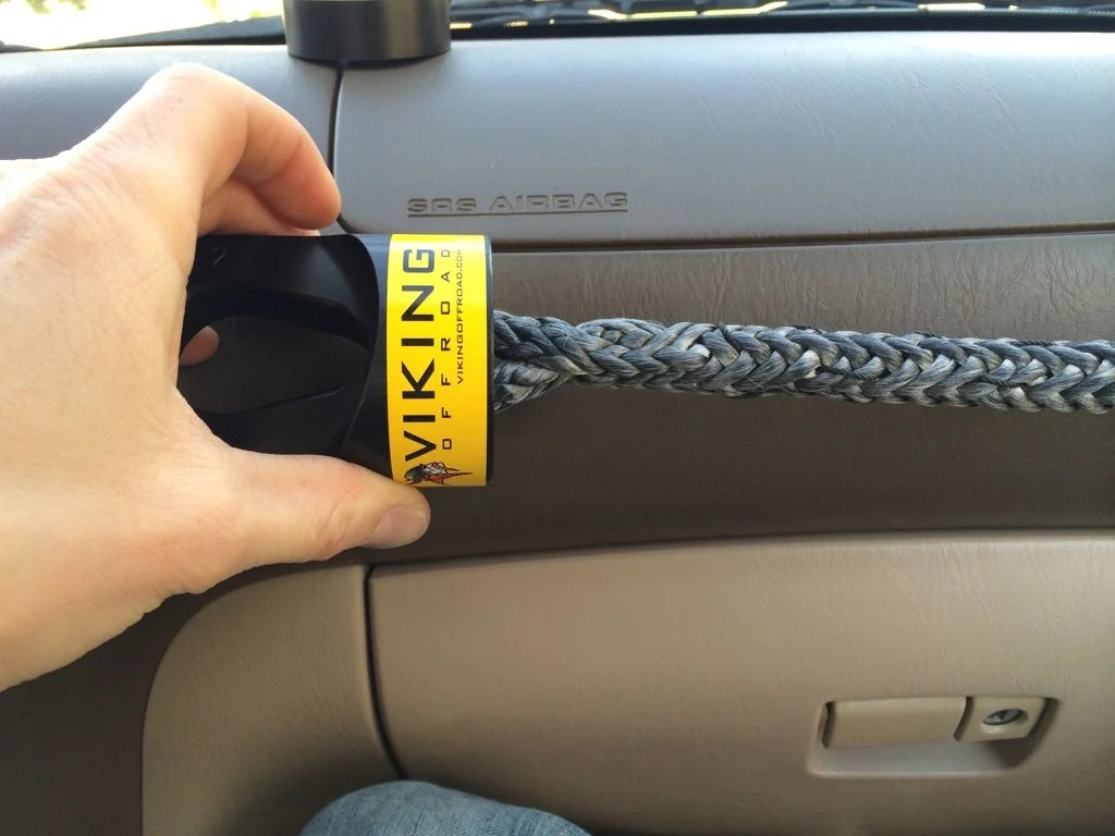

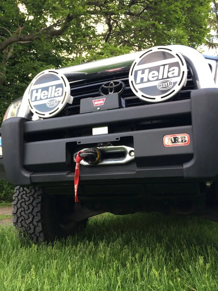

I cut the hook off my Warn winch line and spliced in a Viking thimble:
Looks a bit better mounted there, I really wish the ARB would have recovery points. Didn't like running the line down under the front bumper to attach to the Jonsey's recovery pts.
