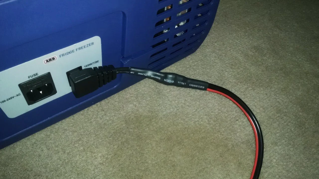

Hacked the 12v cigarette lighter plug off of my ARB fridge cord and wired it directly to the battery with 10ga wire. Fridge is much happier now.
