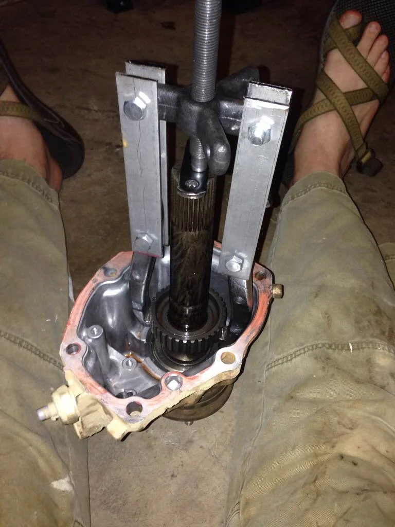

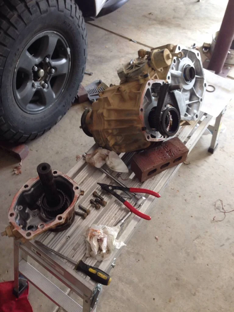

Replacing front transfer case seal. Way more of a PITA that I first thought.
...via IH8MUD app
Holy hell. When i did mine i kept it in the truck, just removed the front housing, and when it was time to remove the shaft i took it to toyota and they charged me $70 to remove it.
Where did you get that tool?
How did you remove it in the truck? Beno said it had to be removed and I tried removing the front housing on the truck but it wouldn't come off.
The tool is a regular jaw puller with some extension in the arm. Worked like a charm.
I think i just loosened it on the mount, so it dropped down a little. Then removed the housing and fenagled it off.
i couldn't find any jaws from the local places to rent tools that could slide between the gear and the housing. I like your method though, hopefully wont do that job for a while but i have done 2 rear seals in the last 12mo. Mud kills those things.

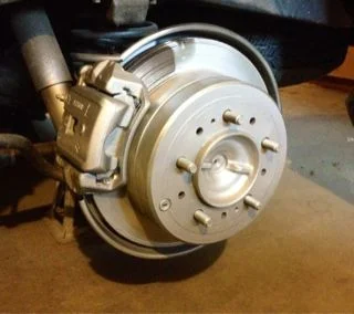

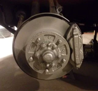

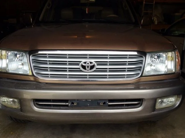

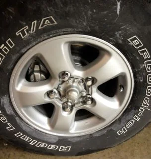

Finished freshening my rims and calipers. Also decided to use the rest of the paint to fake a newer grill on my '98. Cheaper than buying the later model grill.

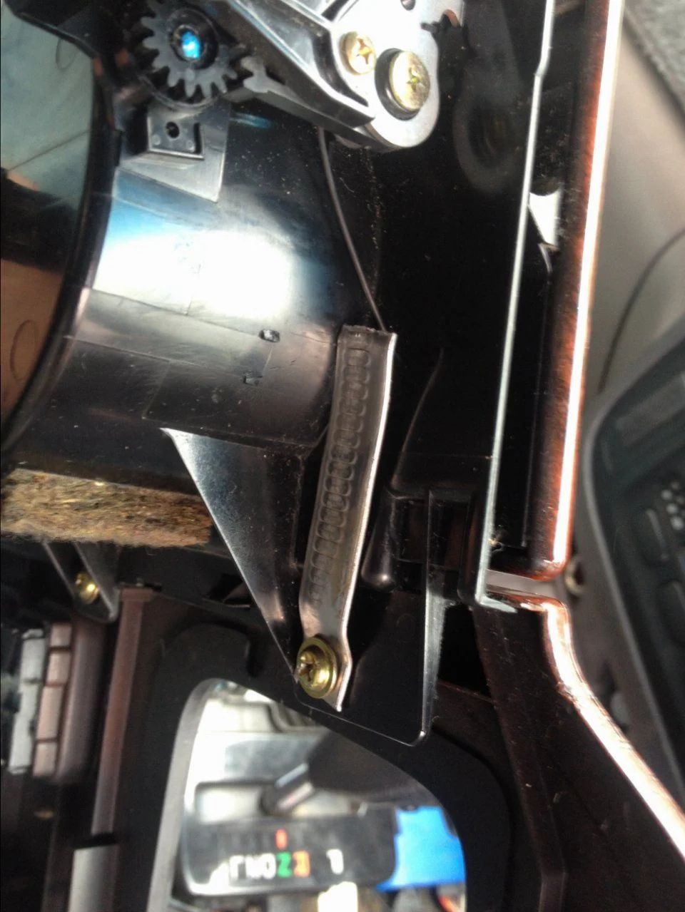

Few bits and pieces done. I fixed the automatic opening lid on the front cup holder in the console. If looked like a retainer for the spring had broken off, I just used a small piece of stainless steel (from a worm drive hose clamp!) fixed to one if the screws under there to give the spring a new locator.

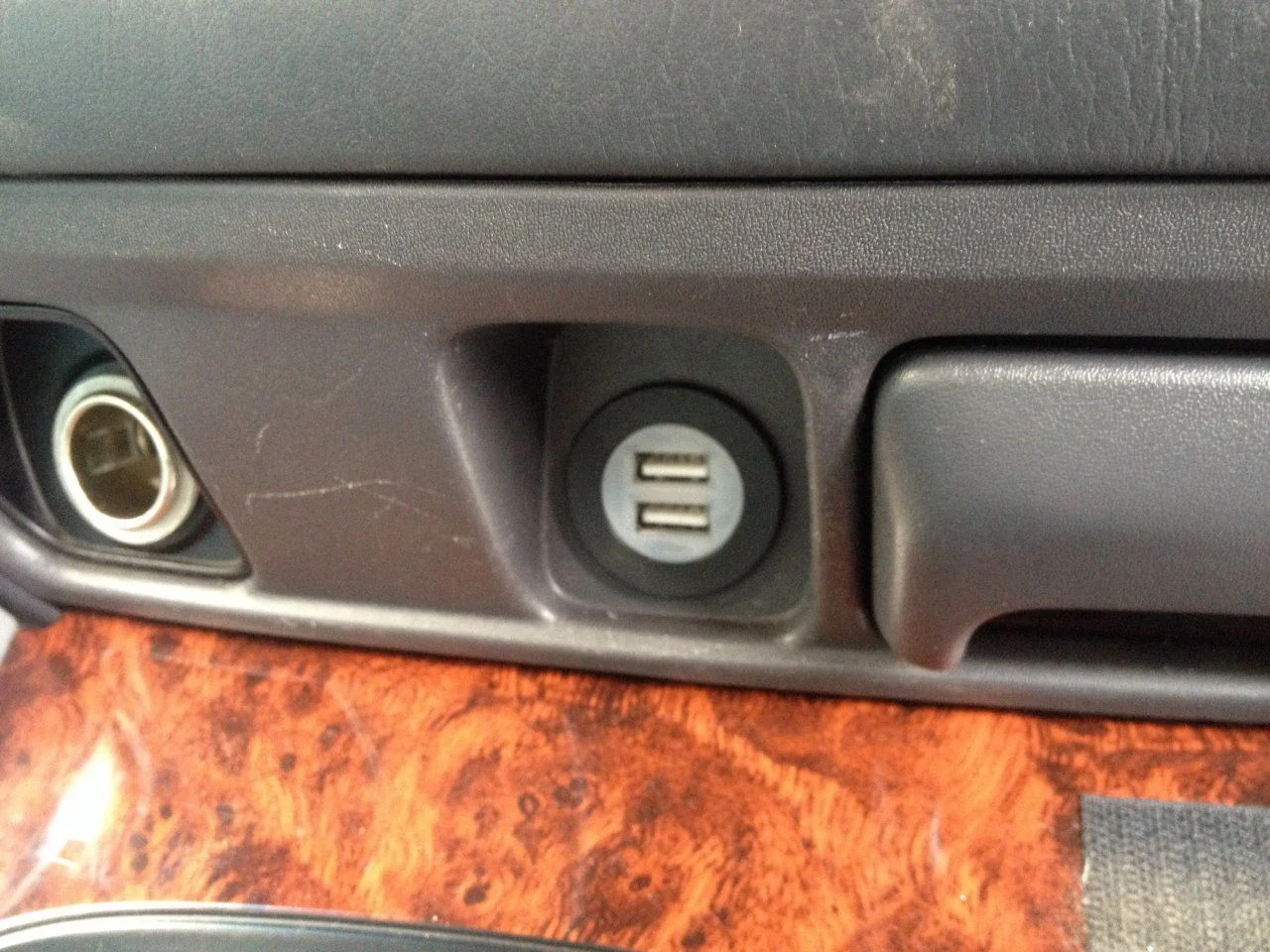

Changed the power outlet up the front to a dual USB outlet.
