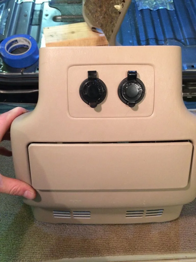

You can install them anywhere that a normal socket can be added. I added one normal 12v socket and one of these in the rear of the console in the blanking plate for the rear audio controls. I will try to snap a picture later.
Here's what I did. One 12 v and one double USB.
Here's what I did. One 12 v and one double USB.View attachment 888011
Looks great! I've got the same two plugs in my garage waiting for install.
Basically what I did too, though I just went for the single USB-dual port and dropped the cover.
Do you have an image you can share? I'd like to see how it looks. I imagine it looks a little cleaner, but I wonder if there's any benefit to the covers - only thing I can think of is protection from those crazy southern Utah dust storms.
Sure, I'll grab some tomorrow in the light. I didn't do the cover for two reasons: 1) I see it lasting about one trip with my kids. 2) they'll have cables inserted in the ports the whole time when we are underway, I'm sure.
Easy enough to add in if I change my mind.

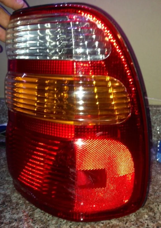

Is the yellow removable? Or are they new lights.

I was rear ended on the way up skiing a couple weeks back.
Instead of using the insurance money to replace the parts with OEM... I did this!
Picked it up Friday afternoon and it was on and ready to go on Sunday.
It does however highlight the need for those Nitto Trail Grapplers!
NIck, great news on the lights.

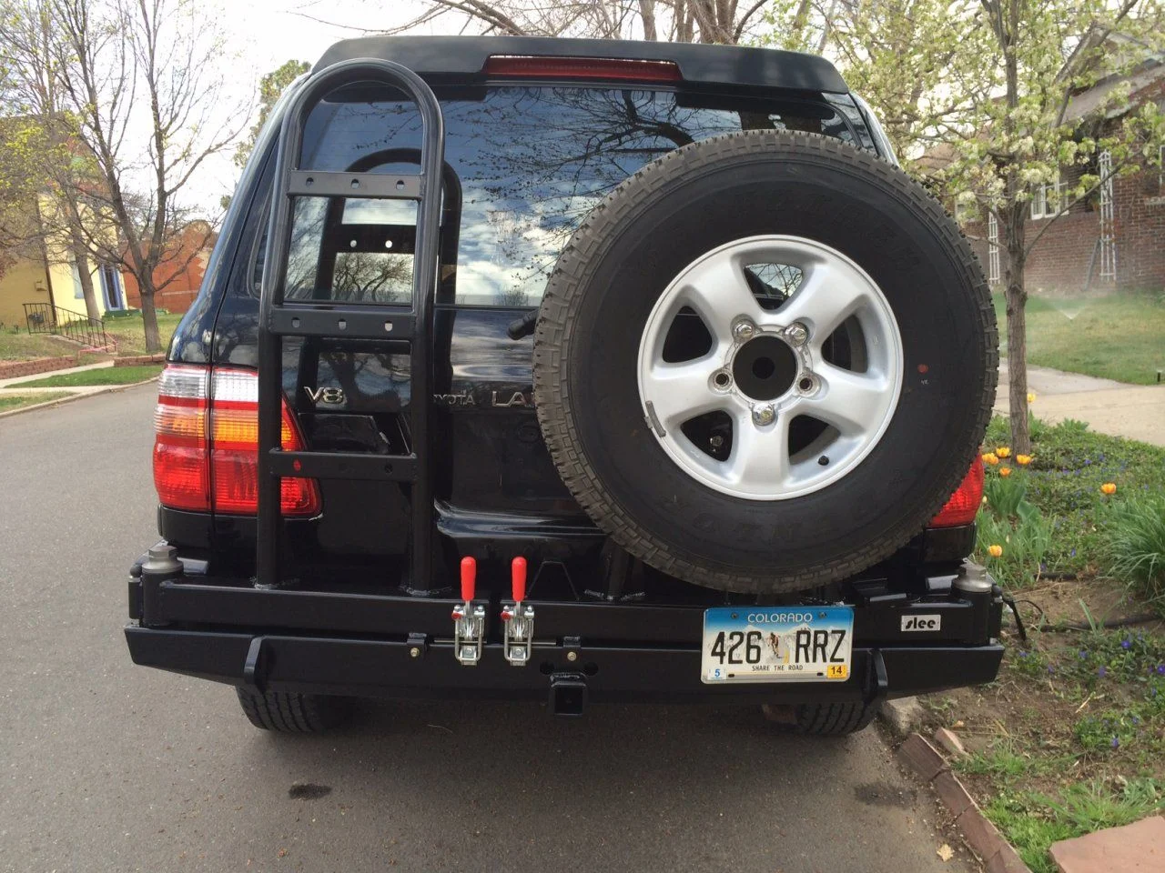

Tell me about your rear bumper. Is that a modified oem plastic bumper cover?
Yes I believe Nick said he just chopped a few inches off the bottom.
Nick where do you keep your spair?
That's exactly correct, it's basically parallel with the rear frame height wise. He keeps his spare ratcheted down in the 3rd area as seen at the top right portion of this picture:
