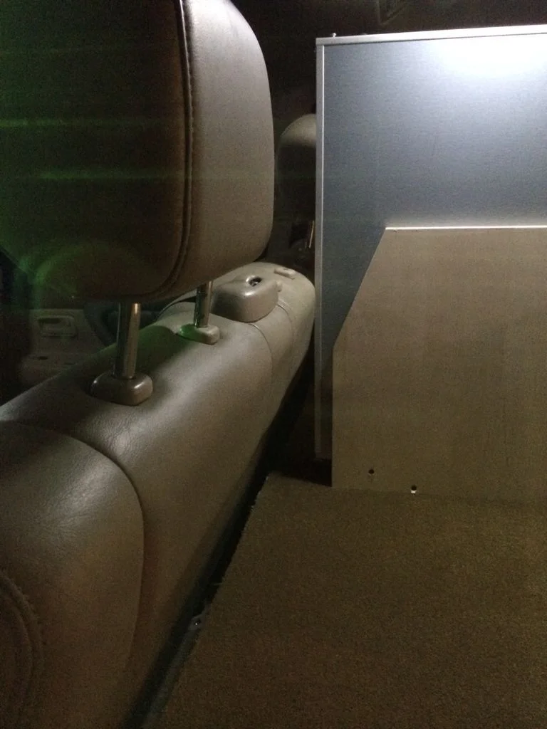

Put the finishing touches on the rear cargo area to get ready for our spring break camping trip. The area to the right will be for the dog, the divider holds the camp table and 5 gallon front runner water jug.

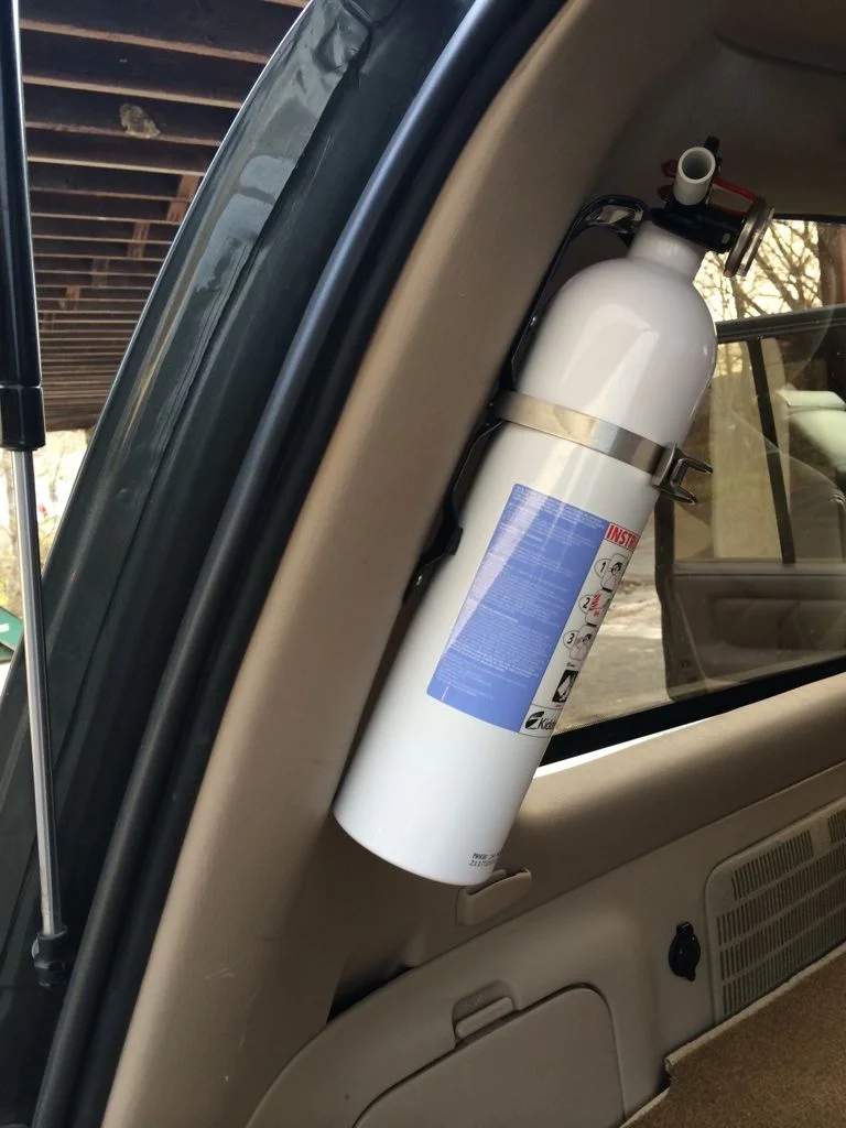

I also mounted the fire extinguisher, probably not the best location due to difficulty of access but couldn't find a better spot in the cab that wouldn't be intrusive.

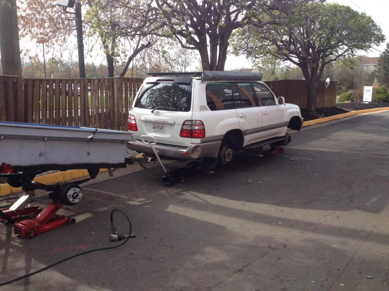

Psych! New shoes. 295/70R18's Toyo At2 Extreme on Tundra Steelies.... thanks to a hot tip from @Bomar
Had to remove the mud flaps I made, and there is some light scuffing on the frame, but otherwise they're a good fit. Here is some driveway simulated flex where I checked for rubbing and close-ups. Old BFG 275/70R18's are on the right.

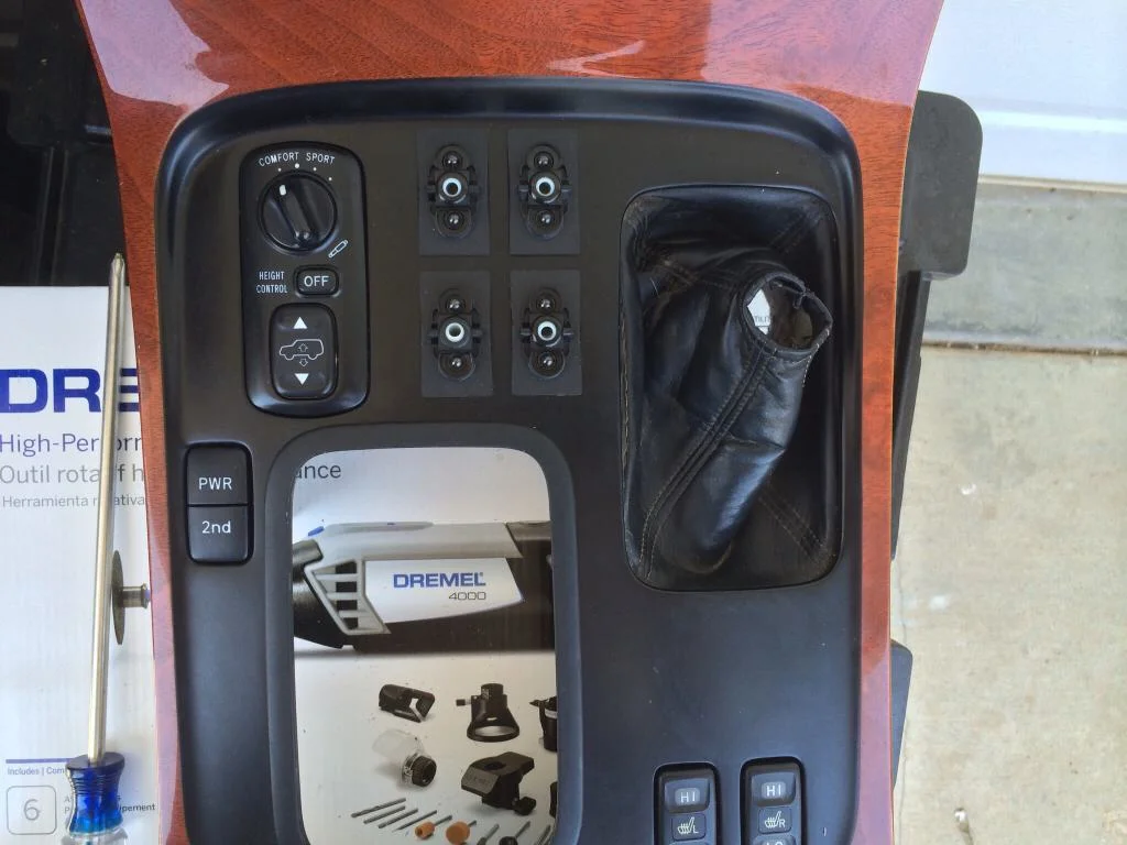

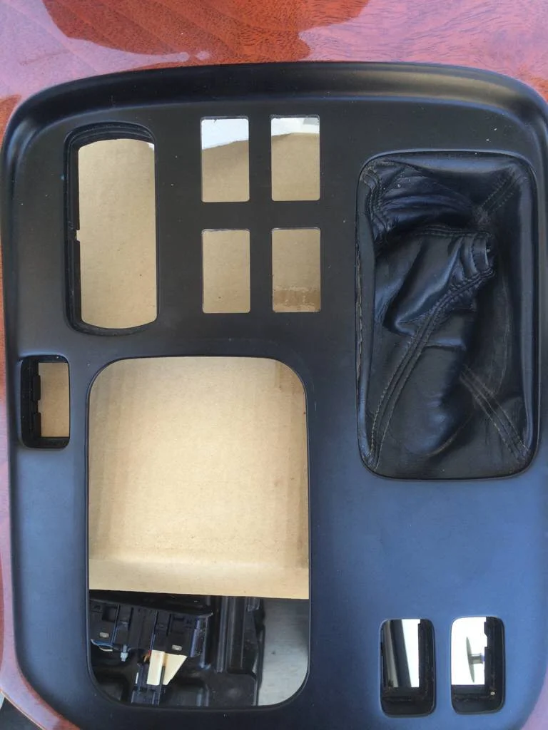

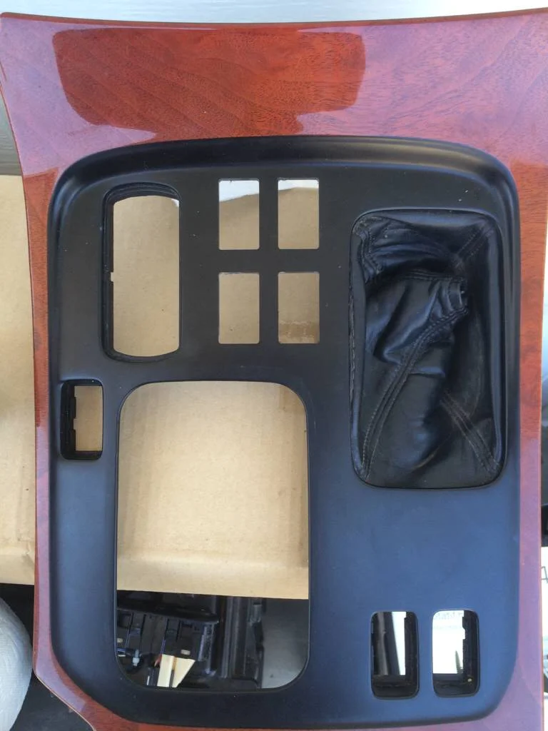

I had my neighbor machine out some switch holes in the center console.
We were able to get four between the transfer case cutout and the AHC controls. For now I am going to use these for the compressor, f&r locker switches and a fridge outlet cutoff switch. Once I finish converting to the 80 series locker dial, I will repurpose the two locker switches for light switches and leave the compressor and fridge switches down on the console. I am using the factory blanks to the left of the steering wheel for two OEM light switches controlling Rigid Dually D2 driving lights and spot lights.

Careful, that one panel is over $2k to replace. ;) I cut into mines as well.
Holy overpriced Lexus parts Batman. That is crazy! Wow.
It turned out awesome. Much much better than I could have done with a Dremel.
