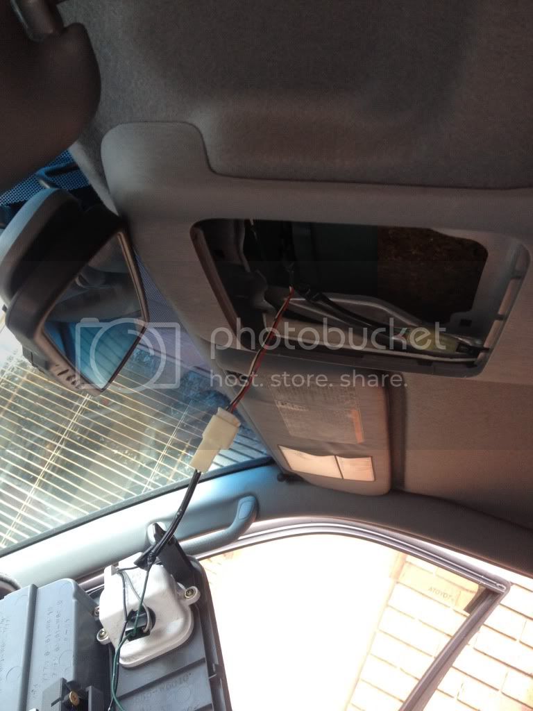

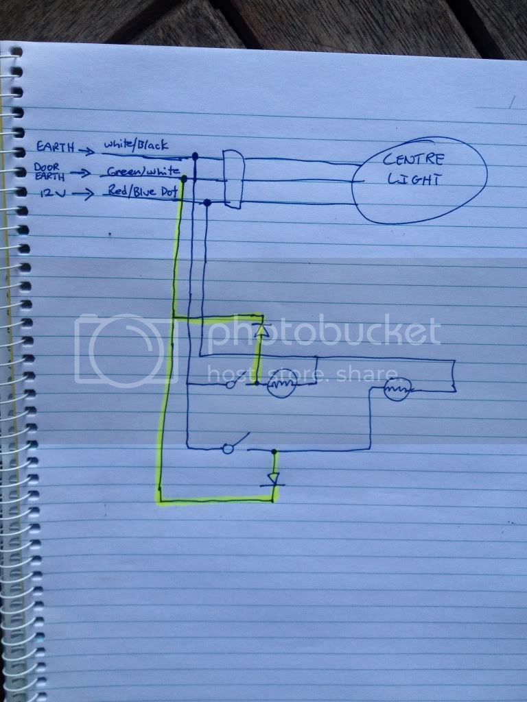

I'm doing this very mod today - what did you run your power source from?
Also modified the wiring for the front map lights so that they come on when the interior light comes on. A couple of diodes and some soldering, easy job.
The power source you need is actually a switched earth, the lights have +12v all the time.
The loom going to the centre interior light runs straight past the map lights
And a mud map
The hilighted part is the wiring and diodes to be installed. Note the diodes need to be put in 'backwards' as you're introducing another earth supply to the lights. If you don't put the diodes in, if you went to turn on a single map light, both map lights and the interior light would turn on.
