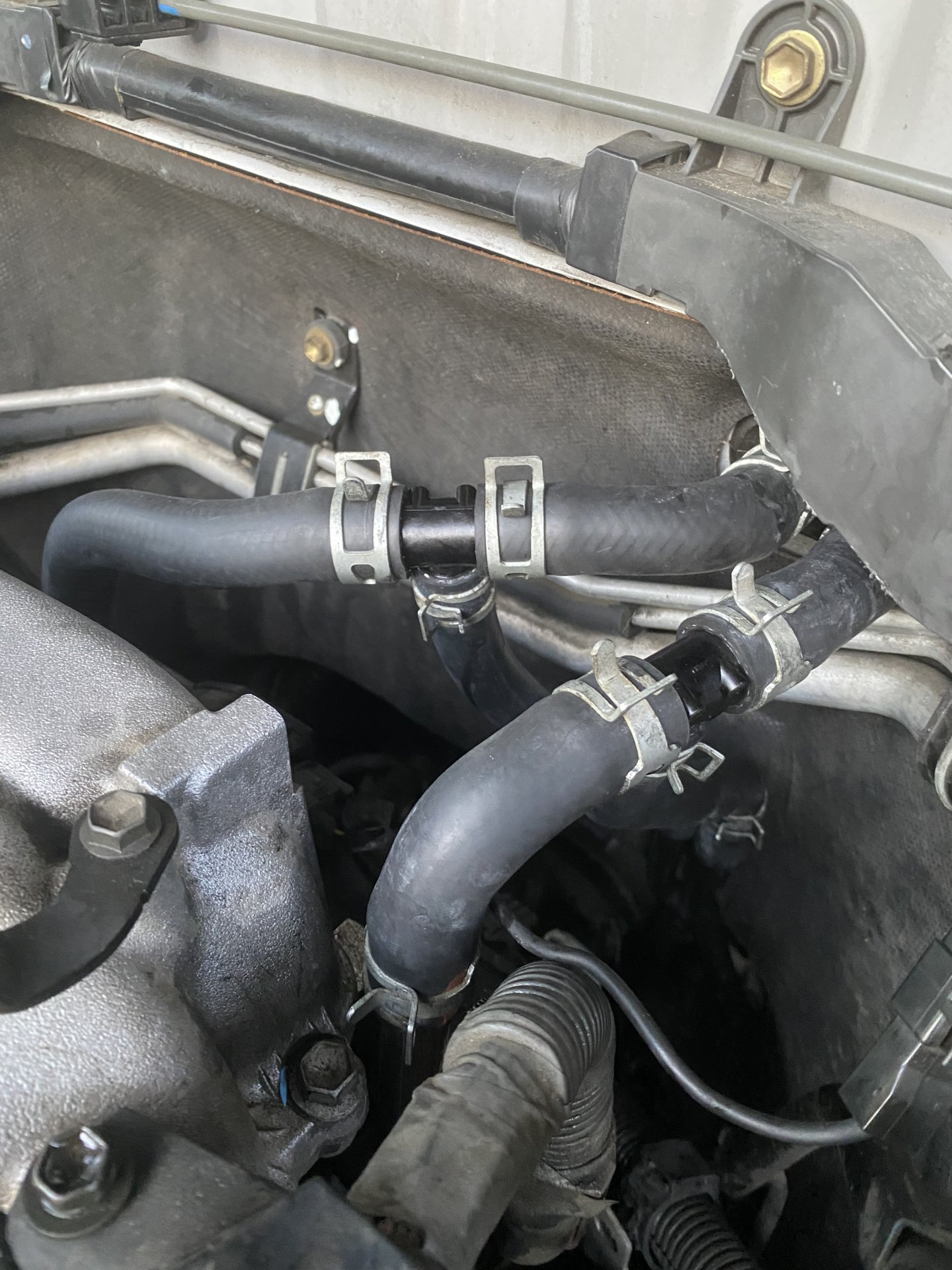

Swapped out the steering rack bushings yesterday. 2002 lx the bushings come out in minutes. I fought the new bushings until I followed someone’s write up here and used a longer threaded bolt to pull them into place. Steering is 10 times better. Swapped out upper and lower radiator hoses and replaced the heater t’s. The hot side T crumbled on removal. Had to go fishing to get the residual plastic. 196,xxx.

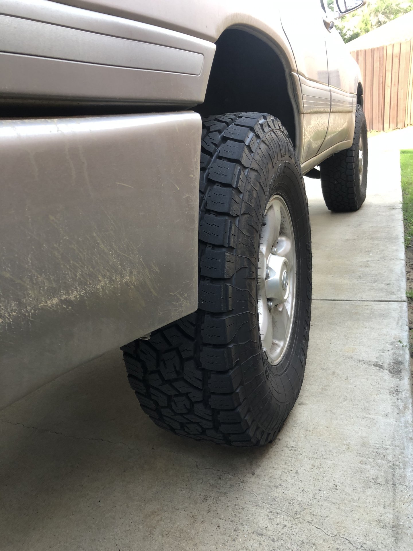

Had Slee install skid plates on my 100. After checking pressures on my TYT reader, looks like I will need to crank torsion bars a little more. Luckily, put on stock TBs, as AHC originals had run out of adjustment.
Ready to get out there and put some gouges in them!
Todd
2 turns on the torsion bars and I am back in spec!
