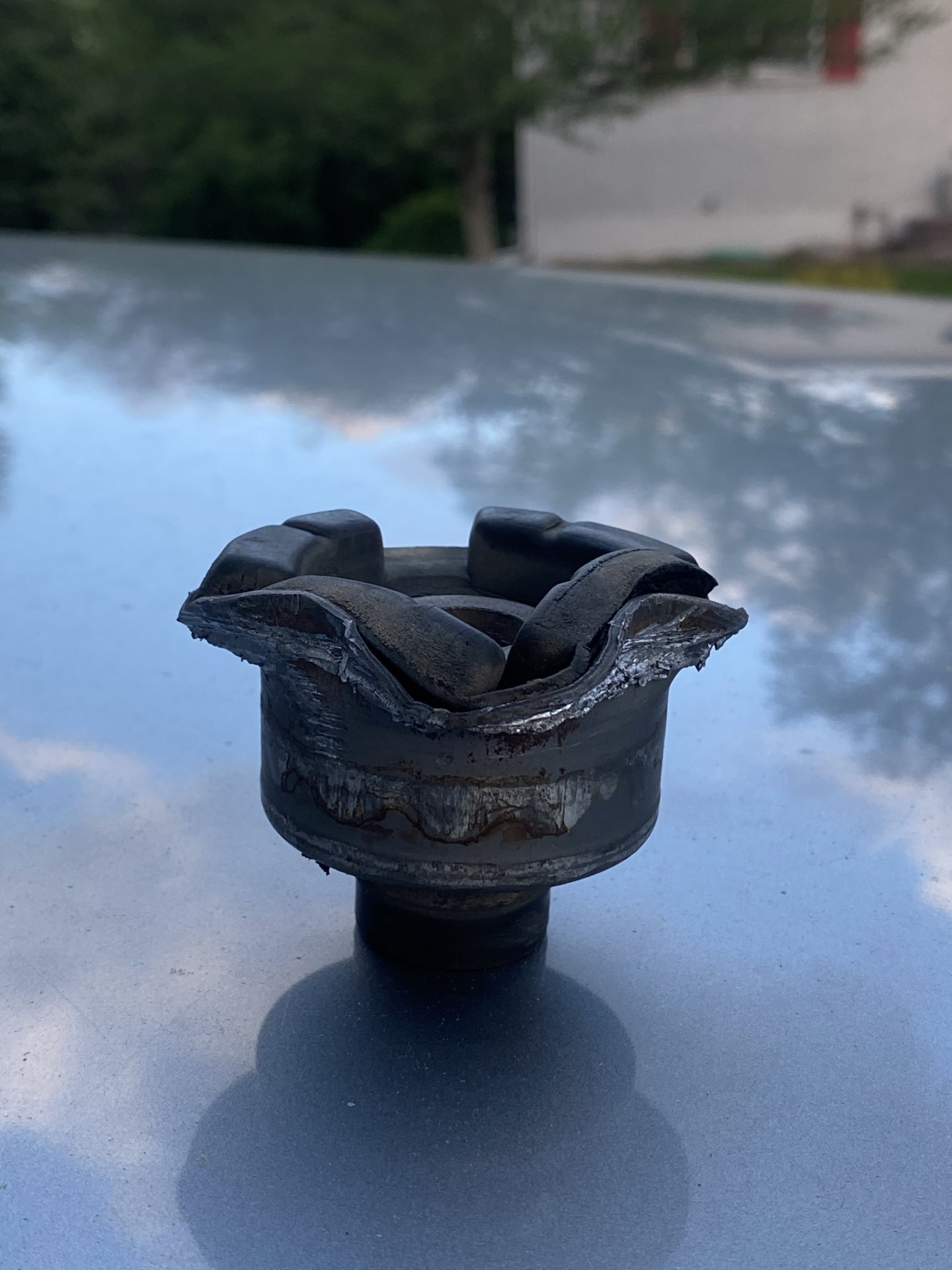

had a short, but hard fought battle with the front diff bushings on Sunday. 95% of clunk is gone now. 220k on the originals.

Im still avoiding this job even though its 100% needed. When you say short, are we talking an hour or 8 hours?
It's not actually too bad, maybe took 2-3 hours total while drinking a beer and taking my time. Used a hammer and chisel to start the gap in the metal bushing sleeve, then power tools to finish it off. Just replaced the 2 front bushings, left the rear.

Yeah @Tanner H go for it. Once you get the bushing started, it comes off pretty easy. Freeze the new bushing in your freezer overnight and lube it up before inserting, should go in easier too!

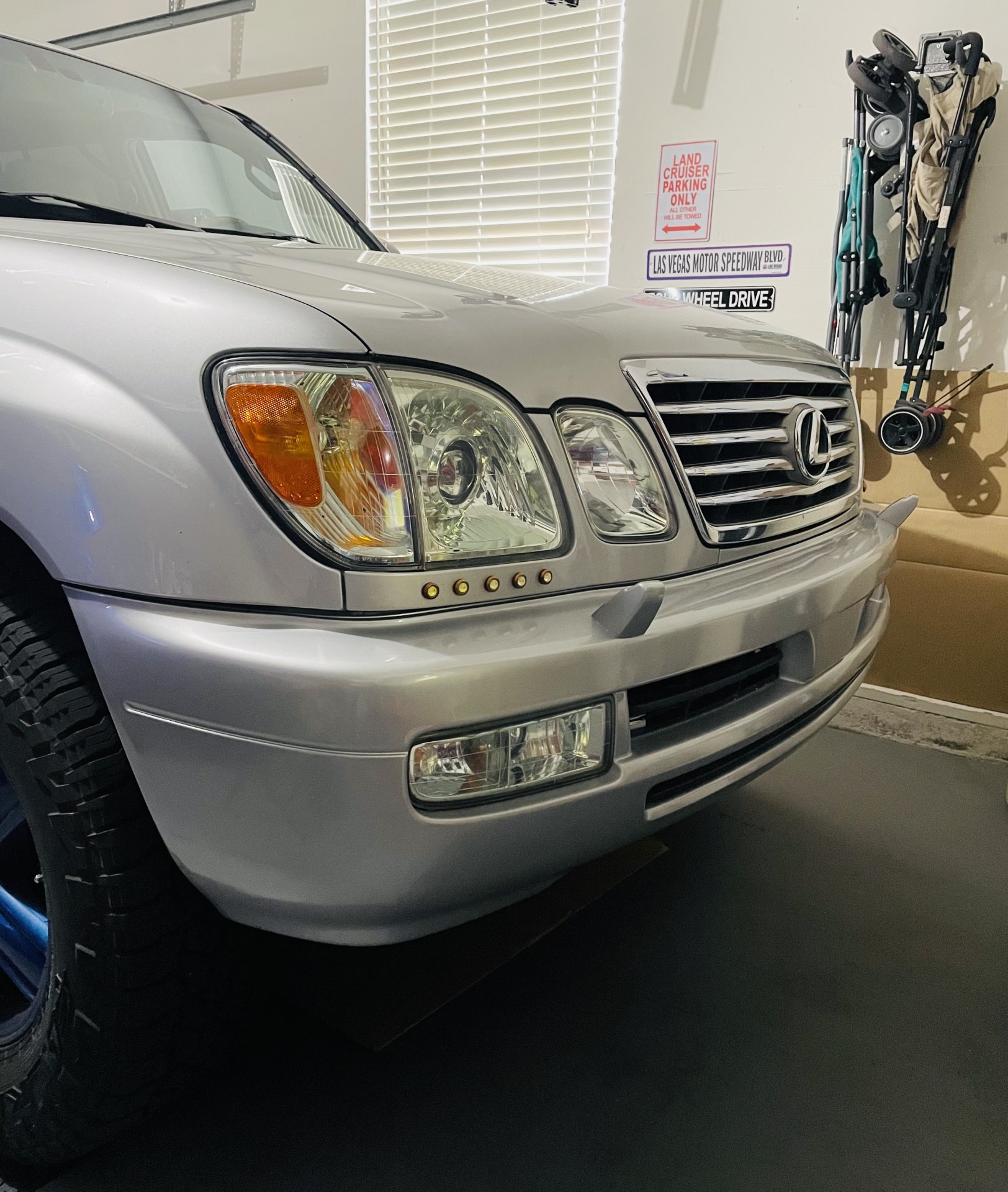

Finally got the front bumper body work and paint finished a couple of days ago. Next, those chipped side mirrors, probably after memorial weekend.

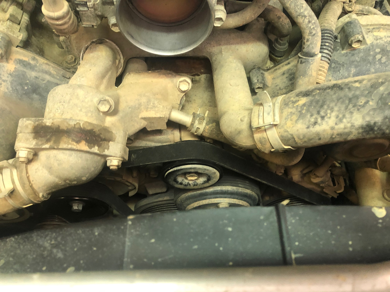

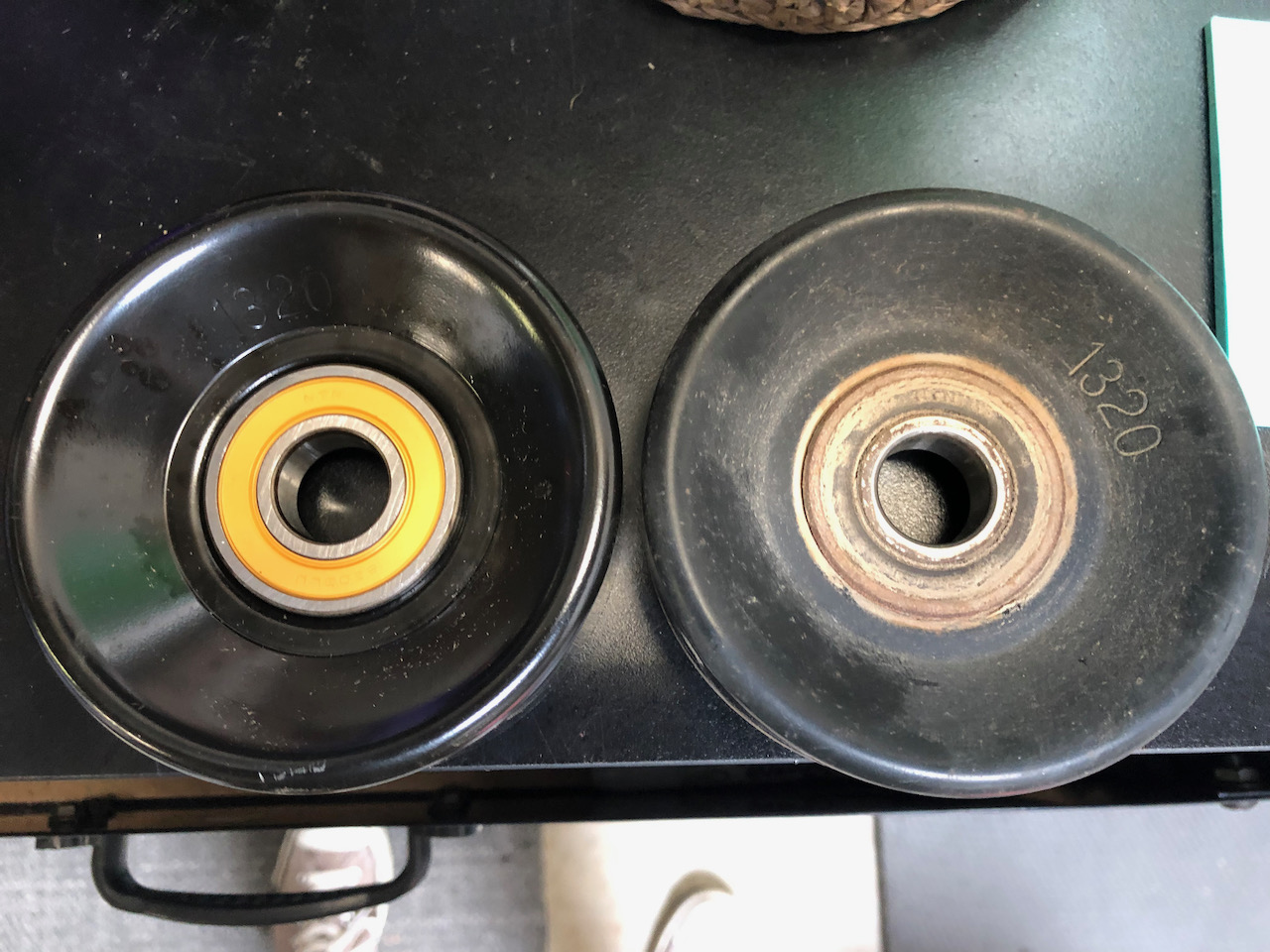

Developed a chirping when the engine in my 2003 is cold, so dug into the tensioner and idler pulleys following instructions here.
Old and new idler pulleys. Other than a bit of dirt, the original felt fine.
Ordered the entire tensioner, but got lazy after finding the tension good, so simply harvested the pulley. I didn't know there was a 1320 version, but that's great since that's how I live my life...you know, a quarter mile at a time.
Found the old serpentine belt had more cracks than I was comfortable with (despite the FSM saying small cracks are OK). Found one at the local dealership who matched an online price and I was able to pick up immediately.
Took all of 15 minutes too install...however looking at this picture, I probably should also address that seeping thermostat housing...oh well.
Fired the engine up and the birdsong was gone! Always nice when simple fixes go simply.

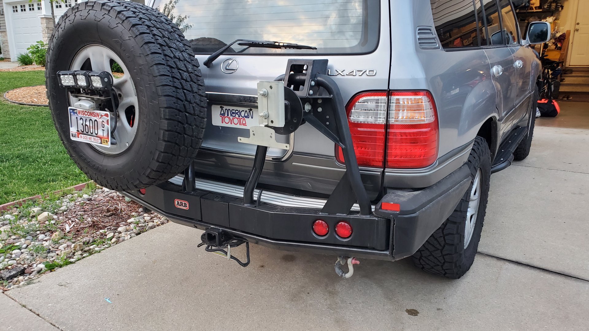

Had a local fabricator make me a hitch receiver that bolts onto my 4x4labs bumper swingout, to use for mounting my bike rack. So much better than mounting to the bumper. Very happy with it. Just needs powdercoat.

I love this idea! I have an ISI rack on order and am debating if it would be a good idea to weld a hitch receiver on the right side swing out.
How many bikes do you carry? My only concern is that with 4 bikes it might shake a lot compared to being mounted on the immovable hitch receiver.

I normally carry just 1-2 bikes. I haven't purchased the +2 add-on, but might at some point. Isn't the ISI rack custom made to order based on your receiver position, tire location, etc.? I haven't even tried this setup out yet, but the rack is rock solid on the car and I have no concerns about shaking. We'll see. I'm sure someone with the Dissent bike rack option can comment on this also.

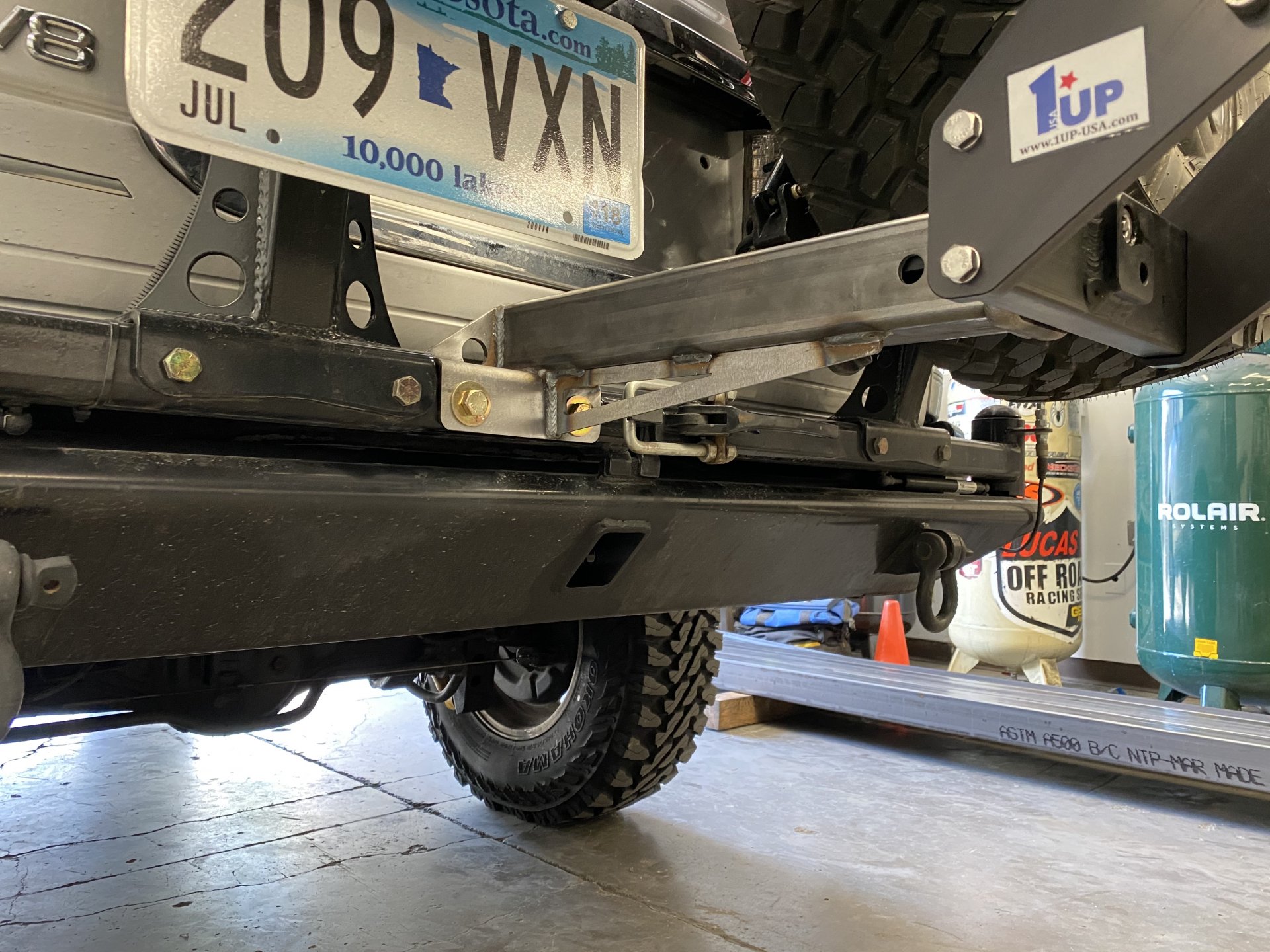

I have the 1up rack on my Dissent bumper. I've carried 4 bikes on it. But with four bikes, I add a ratchet strap to the roof rack to take some of the weight off the swing arm. I don't do that with two bikes, but four seems pretty heavy with all the weight pulling down and away on the latch. The weight isn't a problem for the arm itself. I can swing it open and it's totally fine. I'm just paranoid that the strain might cause the latch to let go. It adds an extra step to getting into the back, but it's not a big deal. Feels totally solid like that and I've done it several times without issue.
