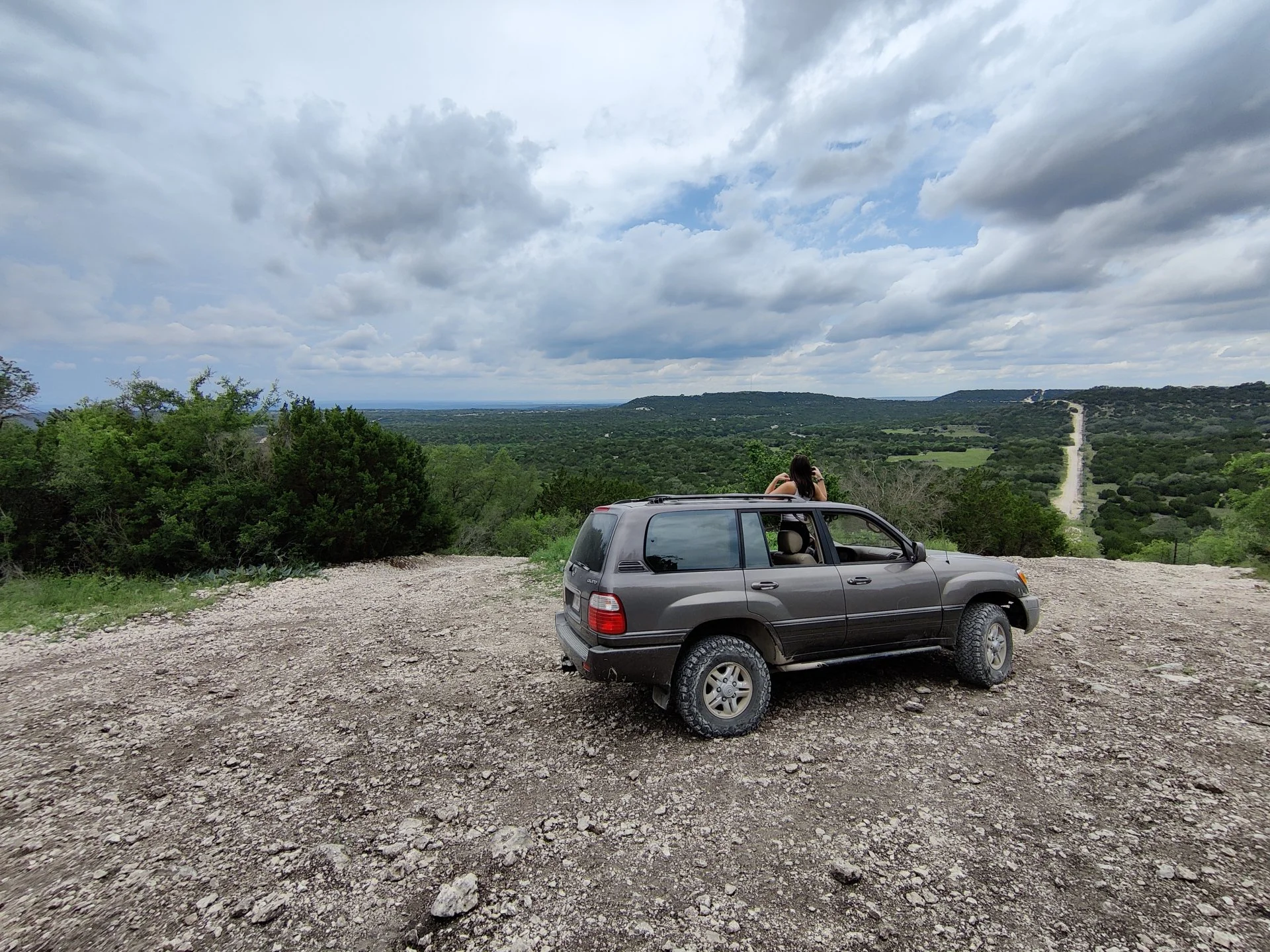

Hit the trails again, this time with the suspension and sliders in place. This thing just continues to impress me with what it's capable of, it handled everything that I was too cautious to attempt last time I was out there without at least minimal armor. Can't wait to get a bumper for better approach angle, skid plates, and some 34's on it.

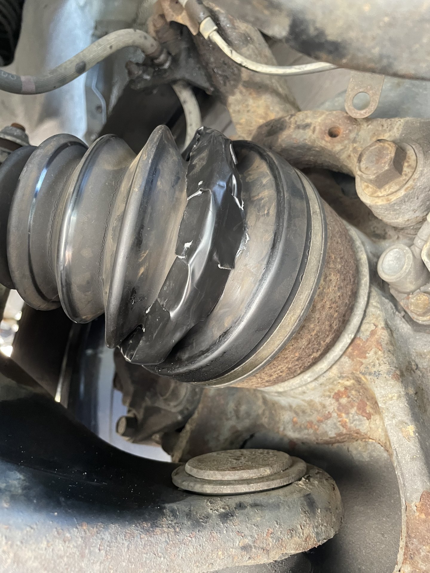

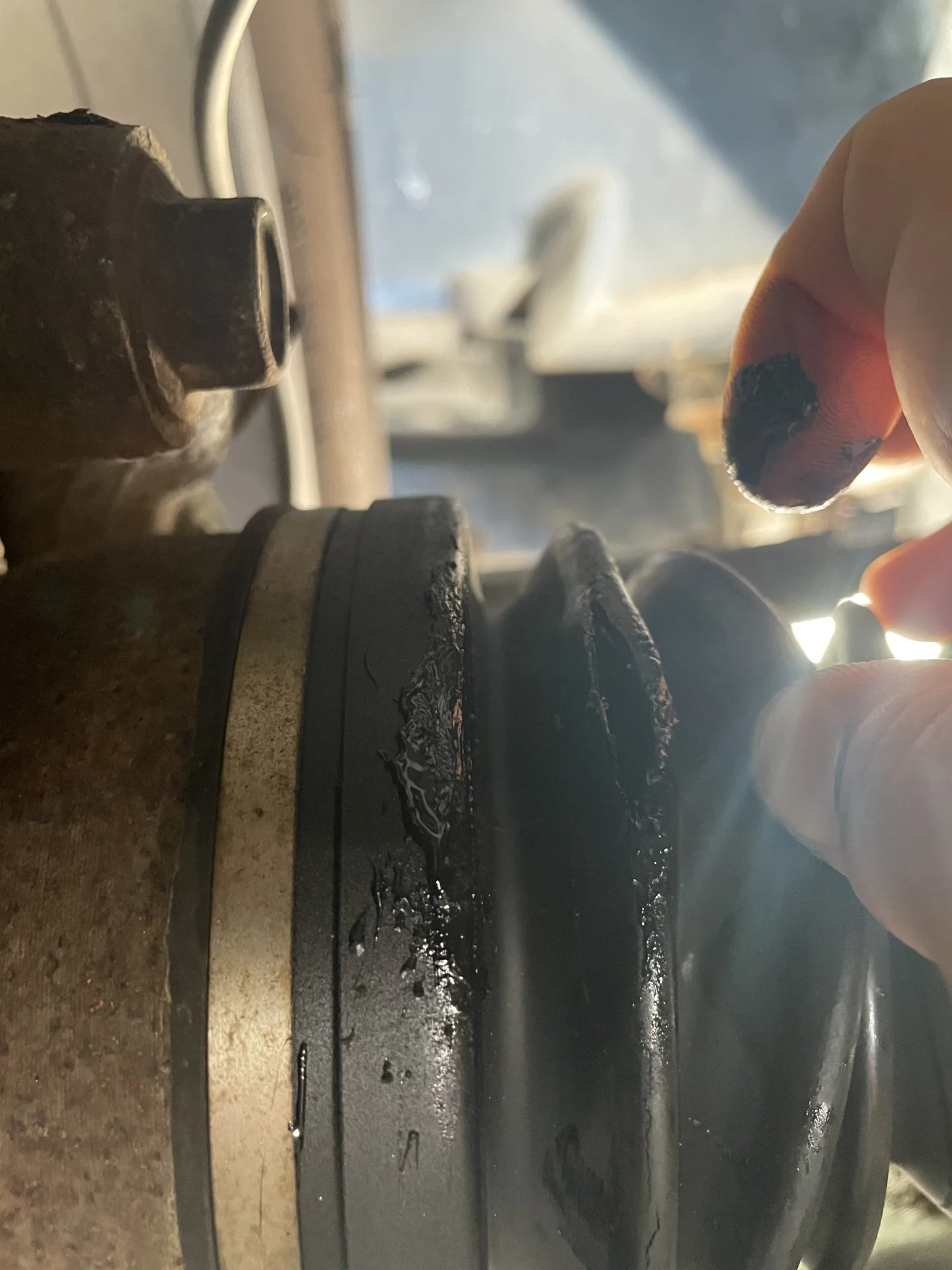

Figured a temporary fix was worth a shot. Gorilla patch & seal tape all the way around and back on itself, scalloped every inch so it folds on itself and doesn’t bunch up on the sides. Held for 40mi so far! Will keep an eye on it.
Figured a temporary fix was worth a shot. Gorilla patch & seal tape all the way around and back on itself, scalloped every inch so it folds on itself and doesn’t bunch up on the sides. Held for 40mi so far! Will keep an eye on it.View attachment 2676999
I remember wrapping my torn boot in ziplock bags and lots of tape. It didn’t hold up very well lol. But we went on a longer 150 mile-ish trip.

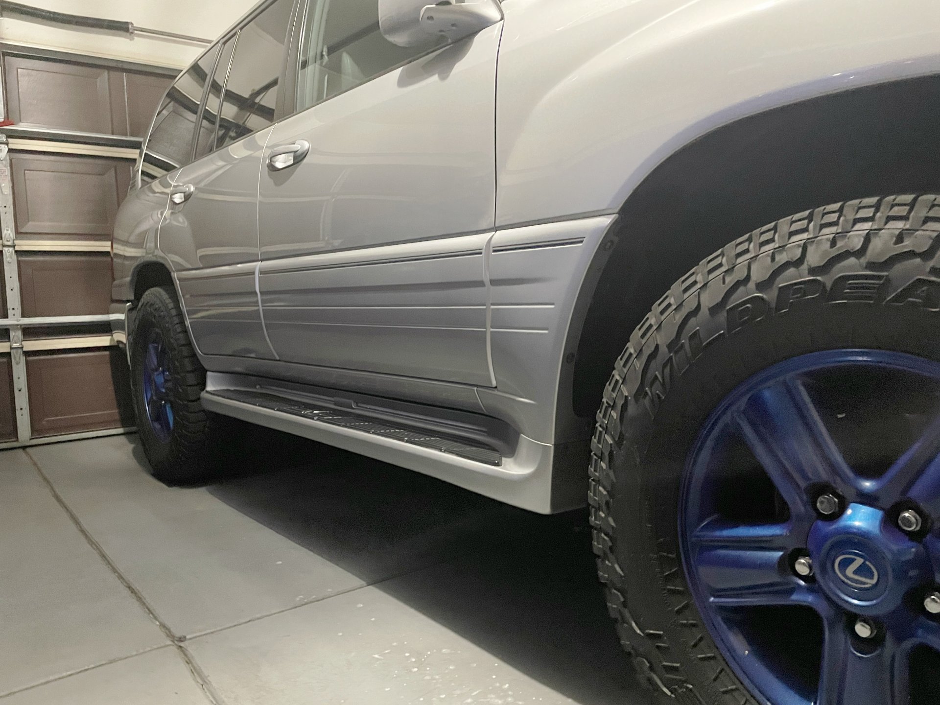

One thing I noticed with single-stage paint method (which was the method used on our 100s) on plastic components is that they don’t hold up very well, they tend to oxidize and fade prematurely than the metal body panels or maybe the chemicals used I really dont know. That said, it was the front bumper after the side claddings:
allowing the 2k clear to fully cure, next is mild cut and gloss using DA polisher then ceramic coat.
Front bumper rehab:
will check again for surface imperfections and if need be filler/primer will be done again. Plan to use at least two coats of base since the front always takes the beating.
The reason those plastic panels wear more is because plastic holds a lot more heat than metal. Your car is a silver metallic....it’s not single stage paint. No metallic paint is single stage. That’s a fact.

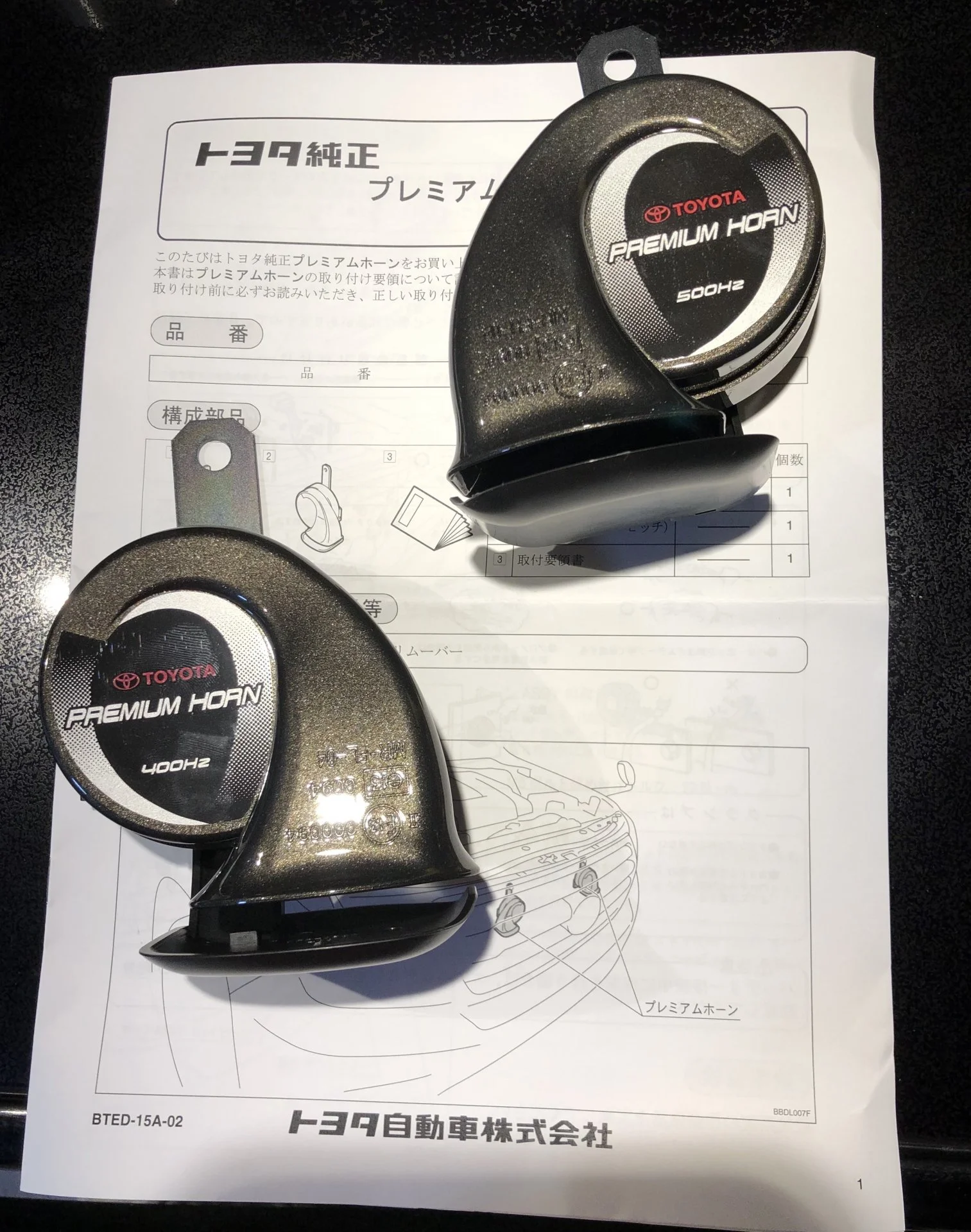

Finally did something about my inoperable horns. After complaining about them not working for the umpteenth time my wife made a joke saying I probably didn’t need it because the people could hear me from the window. Anyways, I did some research and found a bunch of complaints about the factory horns being unimpressive. I looked at Hellas and a few other, but ended up with some factory JDM Premium horns. They’re very robust and sound great. Plug and play is the best part.

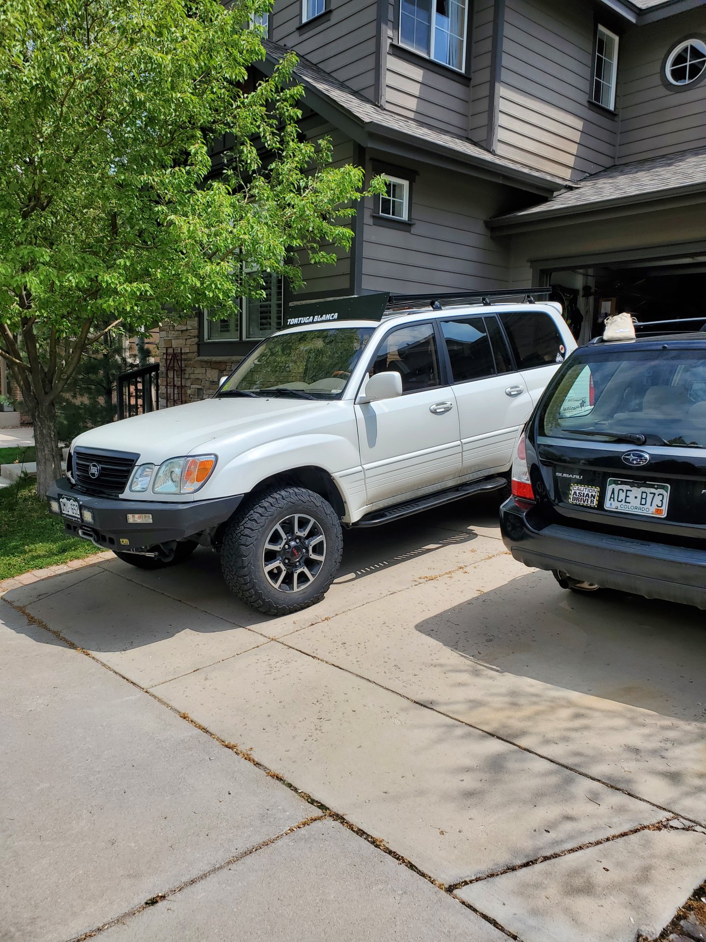

Meant to ask this when I posted it- I’m thinking of tossing the running boards. I’ll never put them back on and I don’t plan on selling it. Will I regret tossing them?
I didn't. I kept them for a couple of years. They just took up space and collected dust. (who would want them?) So out they went. It was relief actually.
