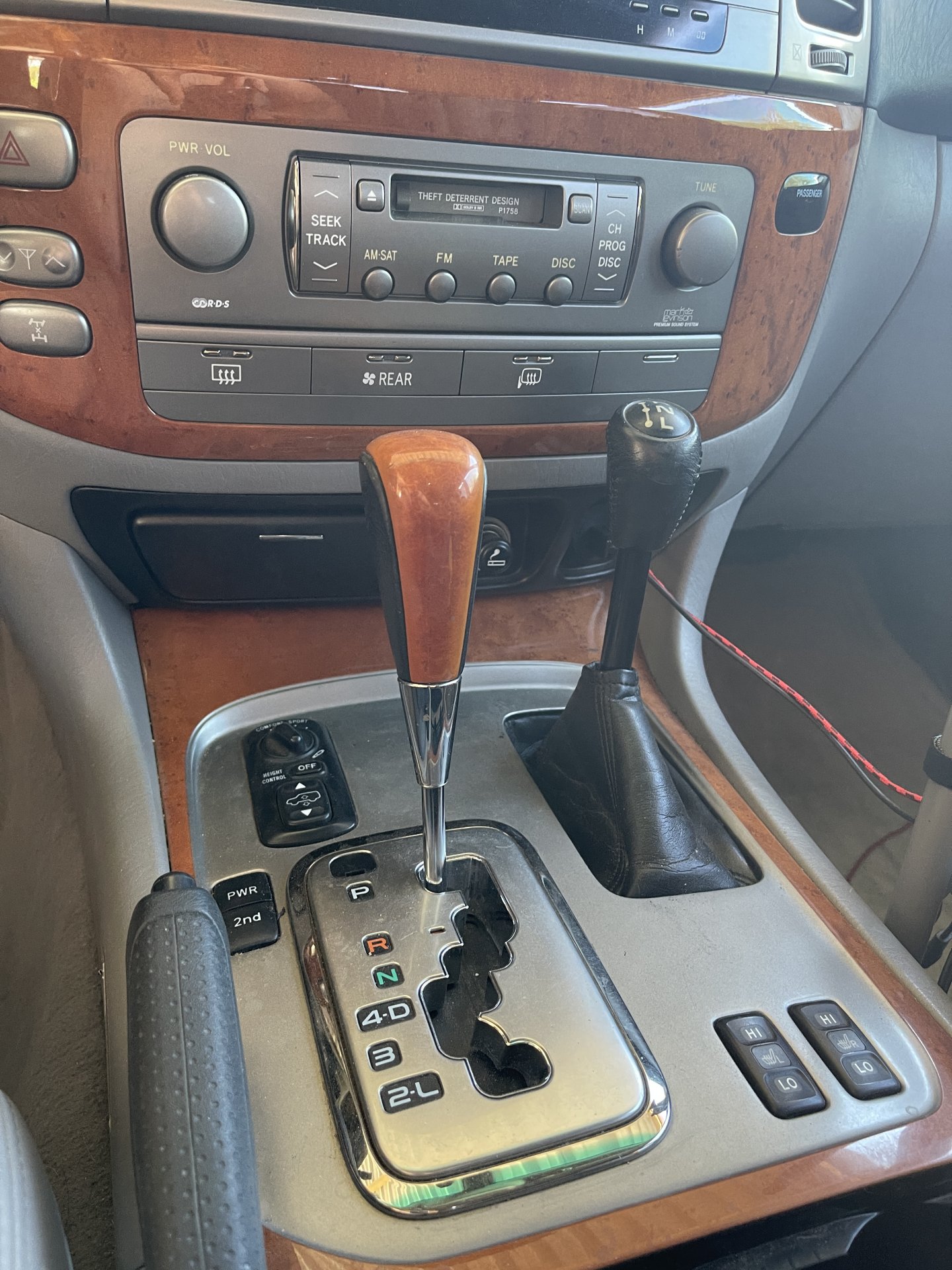

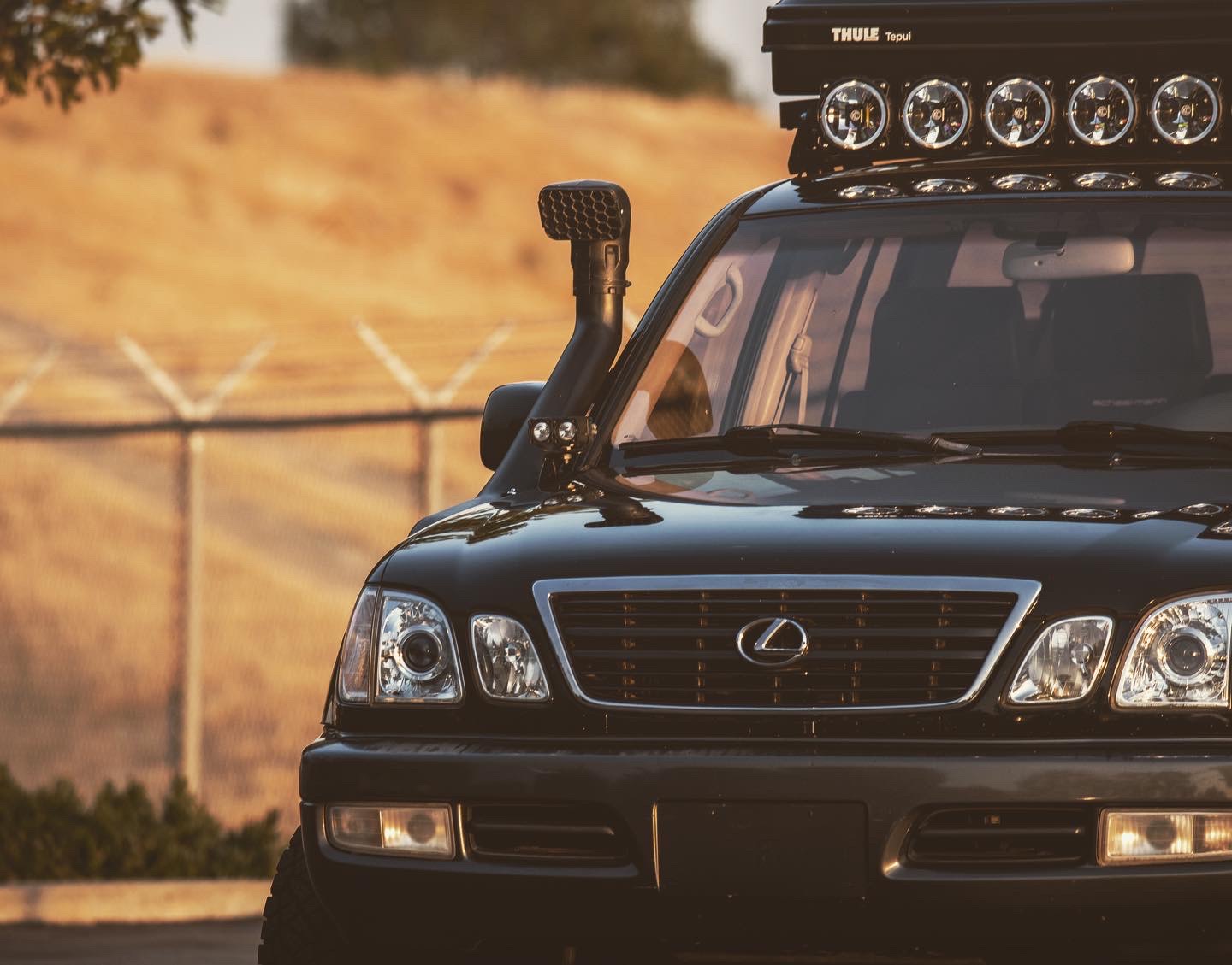

Took some pictures as i decided to sell it this weekend since we have 5 different trucks and sprinters at work i can use
to take the utv out and my new work commute is a bit longer than i want until our new house is ready so i decided to get back into an audi. gonna buy a 4.0tt s6, rs7 or s8 next.
View attachment 2680813View attachment 2680814View attachment 2680815View attachment 2680816View attachment 2680817View attachment 2680818
Looks DAMN GOOD! Rear bumper source??
