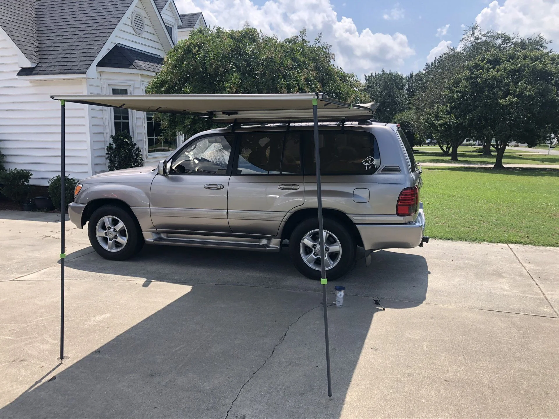

Installed new Ironman Awning, Ironman Stage 2 Nitro Gas 2" lift, and 275/70/18 Falken Wildpeak AT3s. You can't see it, but also had the drive shaft balanced to tackle a nagging driveline buzz I was experiencing between 65-72ish mph - pleased to say it did the trick.
Have a few more things I'm adding before beach trip next week. Will do a write up on everything at some point, hopefully it will help people looking to do similar and save some time on searches.
If anyone in Eastern NC needs a good recommendation on a mechanic and driveline shop, send me a message. I'm a little giddy with how things turned out. Can't wait to do some beach cruising.

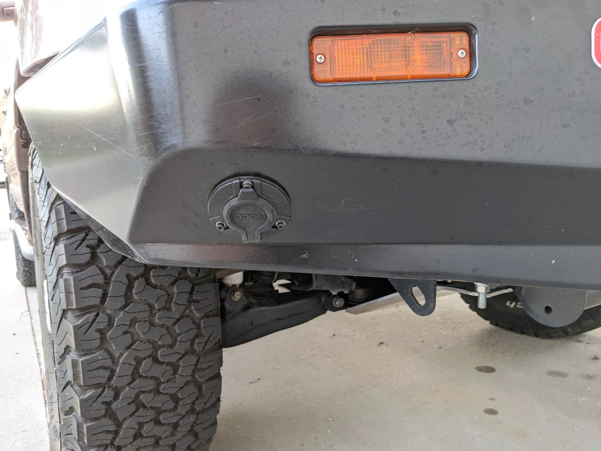

Installed a Noco AC plug in my bumper and a Victron Smart Blue 13A under the hood. Since I finished my dual battery setup last week I've been running the fridge constantly to learn the battery usage, and it was clear that driving a few miles back and forth to work wasn't charging enough to run a fridge at 0C in 80+F weather.
Yes, I know I installed it upside down. That way the cord goes up though, so it's less exposed to getting snagged. The cord routes very well in this bumper in this orientation.

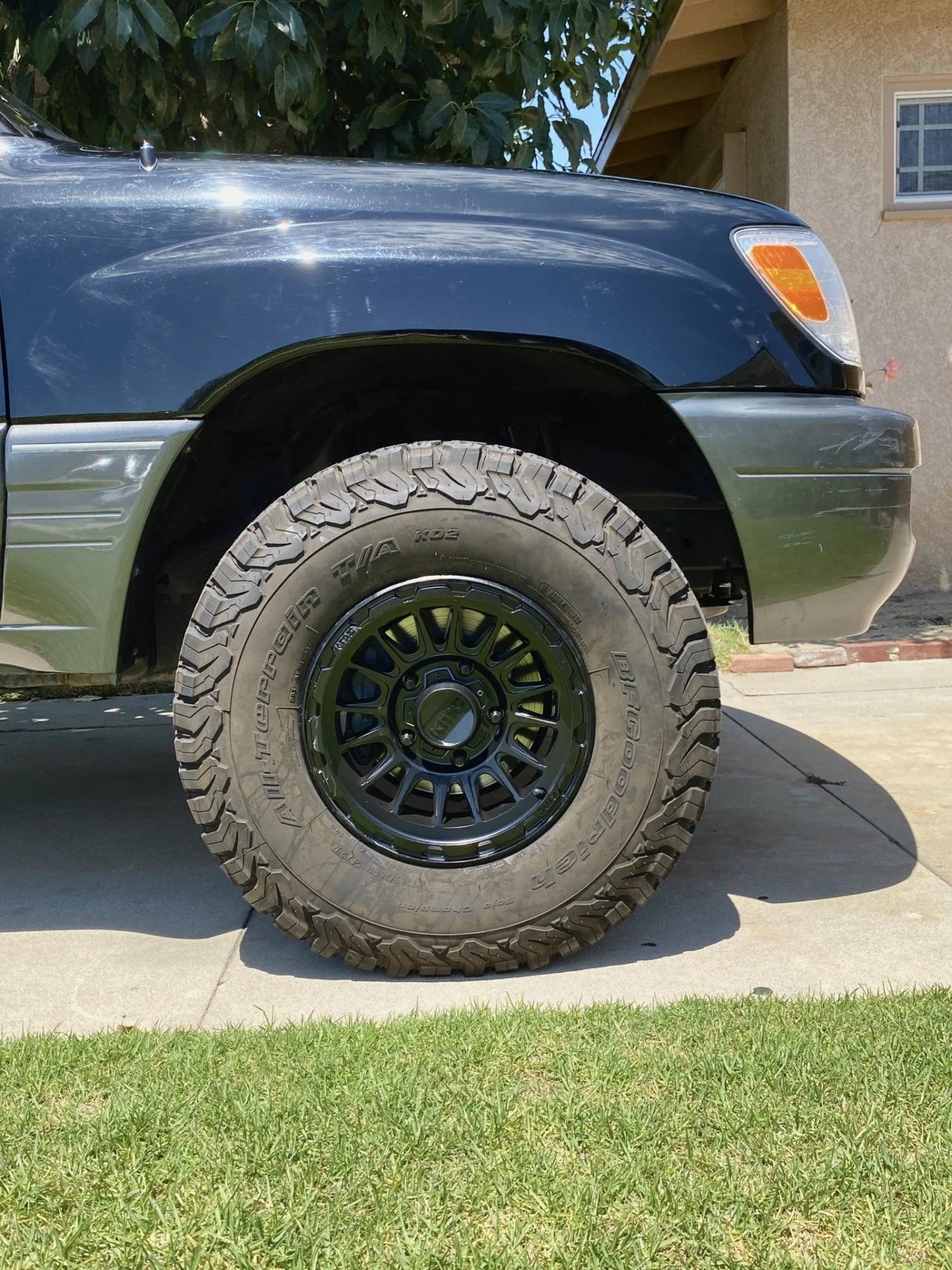

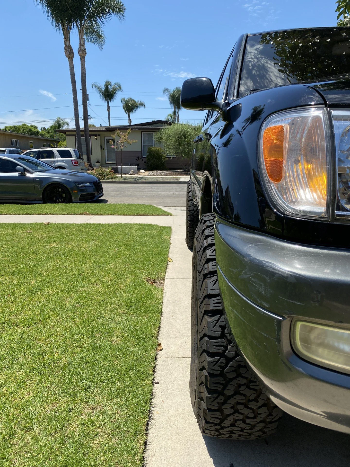

Those look amazing. I always wondered, why do the front wheels/tires look bigger than the back? It’s the same on mine, 285/75/R16 and when you step back and look at the vehicle, the fronts look bigger than the backs.
Probably because more tire is inside the wheel well up front as opposed to down below it in the rear due to rake. I bet if you raised the front so it was equal it would look the same, at the expense of ride quality of course

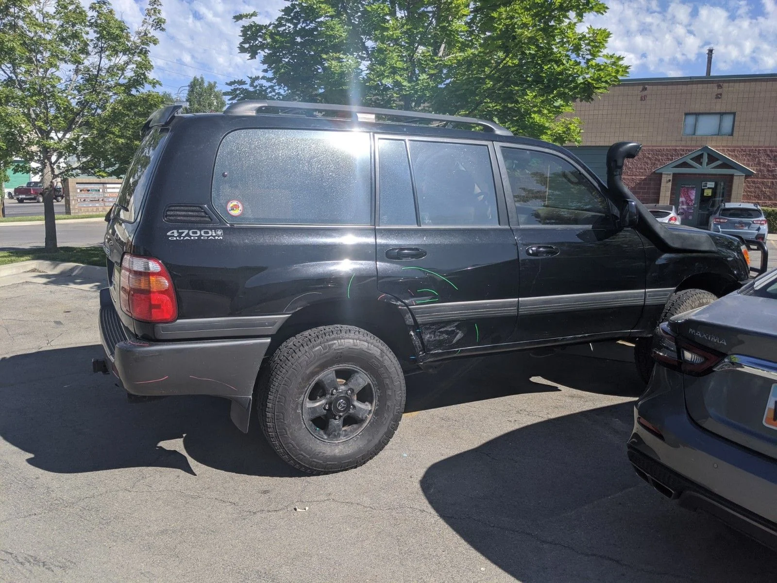

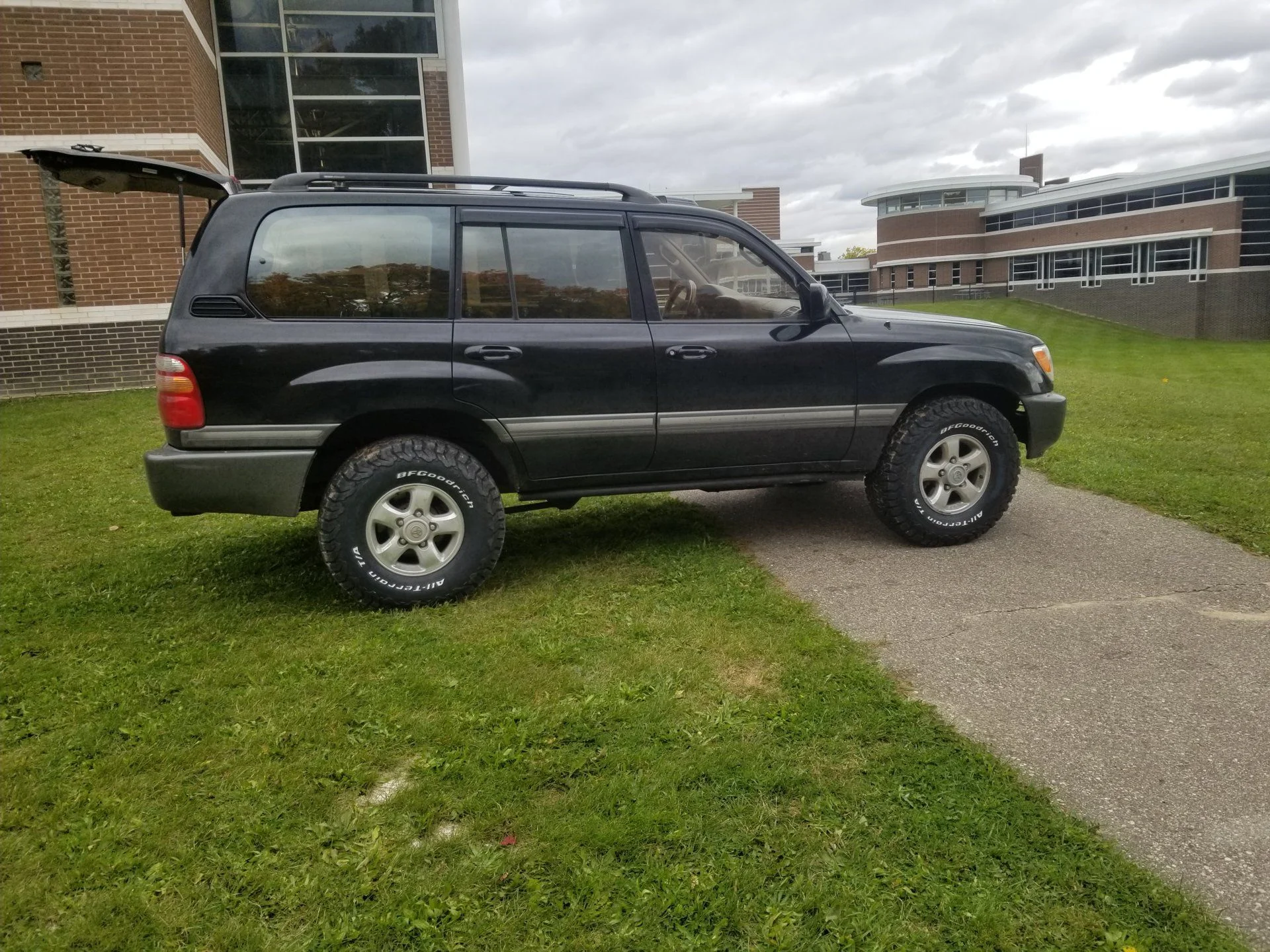

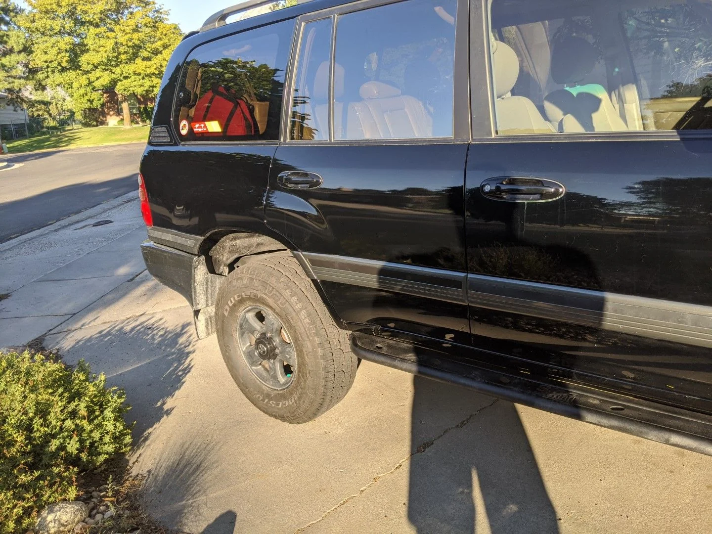

Big week. Got the truck back after 29 days at the body shop (most of that waiting on parts). New door and welded in new quarter panel. Adjuster for insurance kept commenting what a huge favor he was doing us with the "extensive rust" they found in the seam of the fender and rocker. I swung by after he mentioned that and the body shop guy showed me a nickel sized spot in the seam. Oh well, it's done. Initial estimate was $6,100 and they were going to total it, field adjuster took it down to $5,200 and agreed not to total, final bill was $6,500.

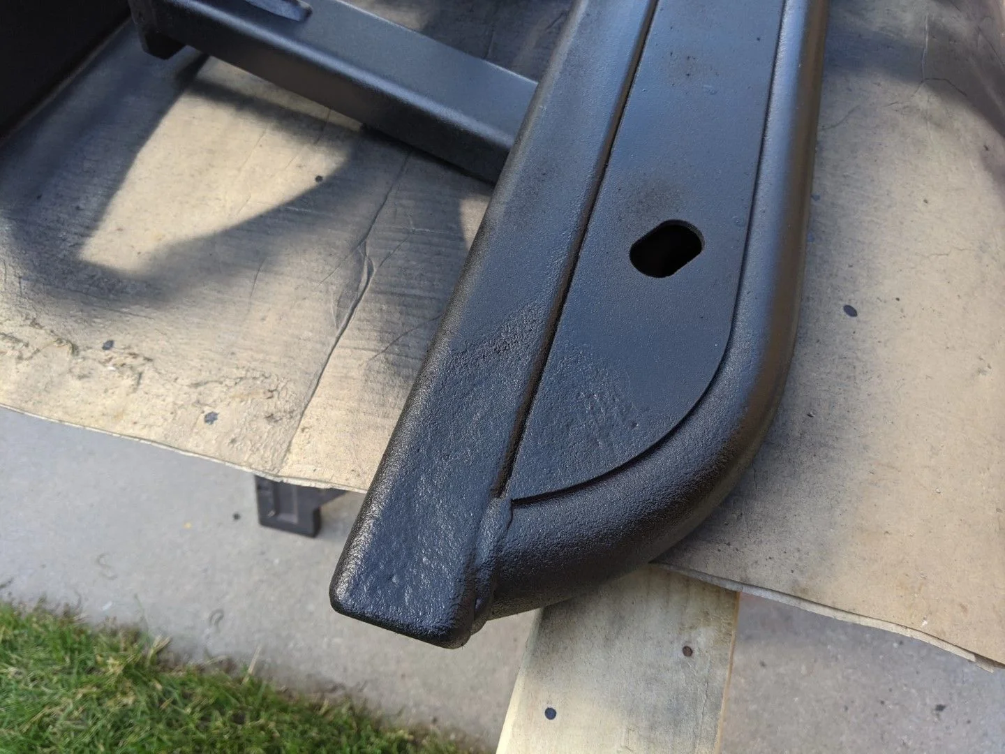

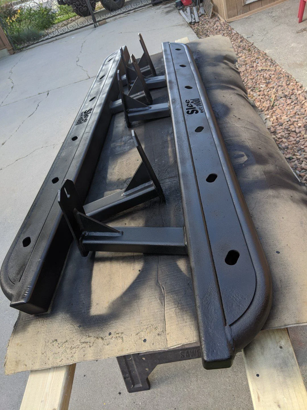

We had the Slee sliders off refinishing them from the rusting seams of the foot plates at the time of the accident. Really wonder how it would turned out if they'd been on the truck. First pic shows the amount of pitting. We had them blasted and this go went home brew with Rusto etching primer and spray on bed-liner. Not impressed with the Rusto spray on liner, just bumping them around installing them it rubbed off in a few spots.

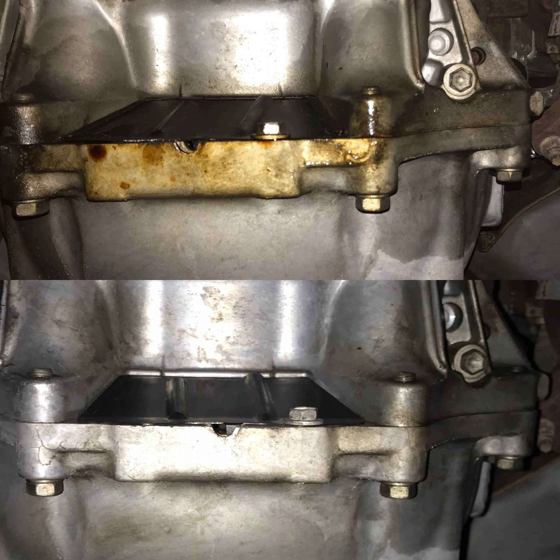

Just curious on how this turned out for you? Was working on my LX today and noticed mine is seeping a bit....
I just checked my undercarriage yesterday looks still the same on the bell housing.

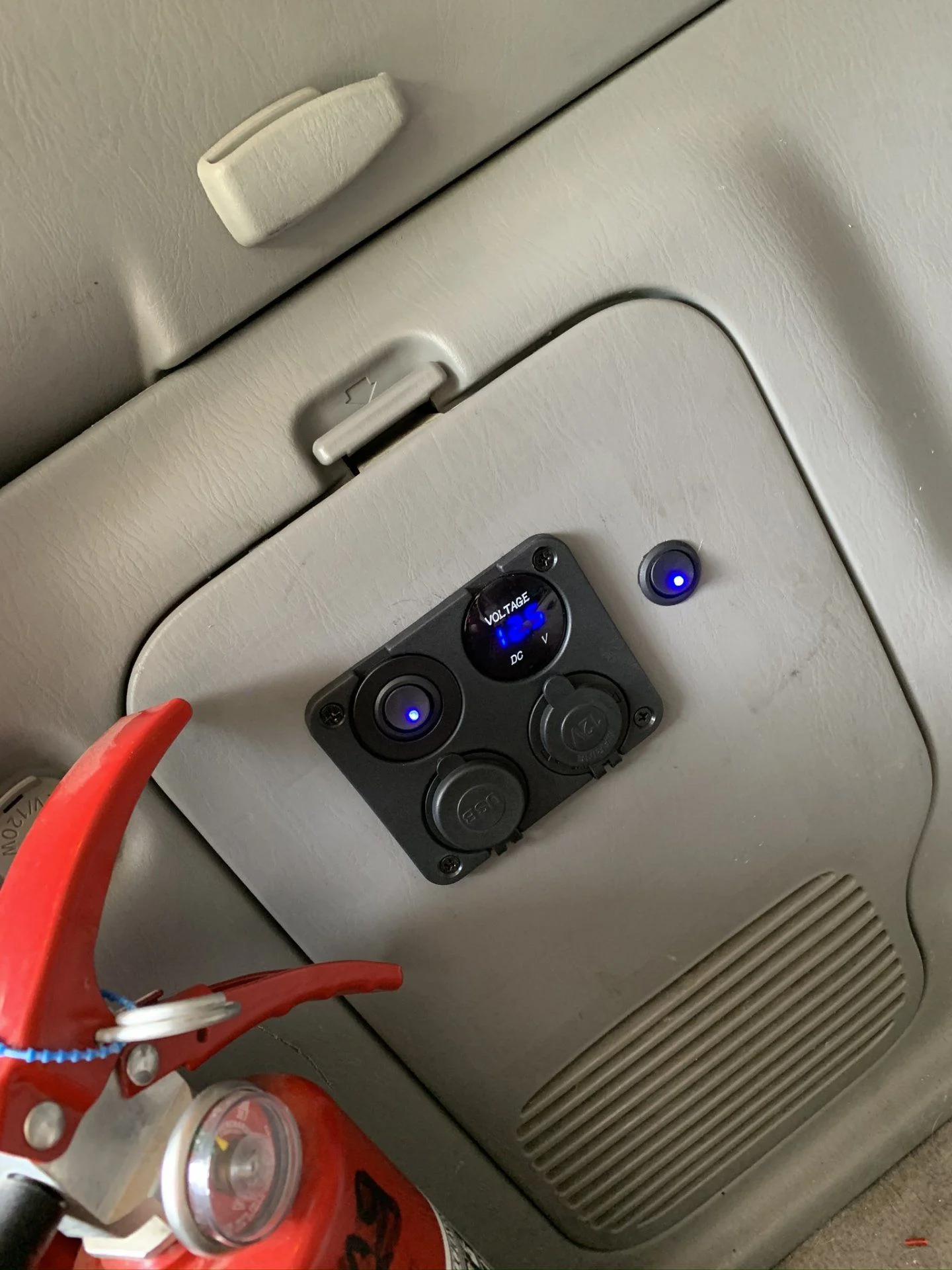

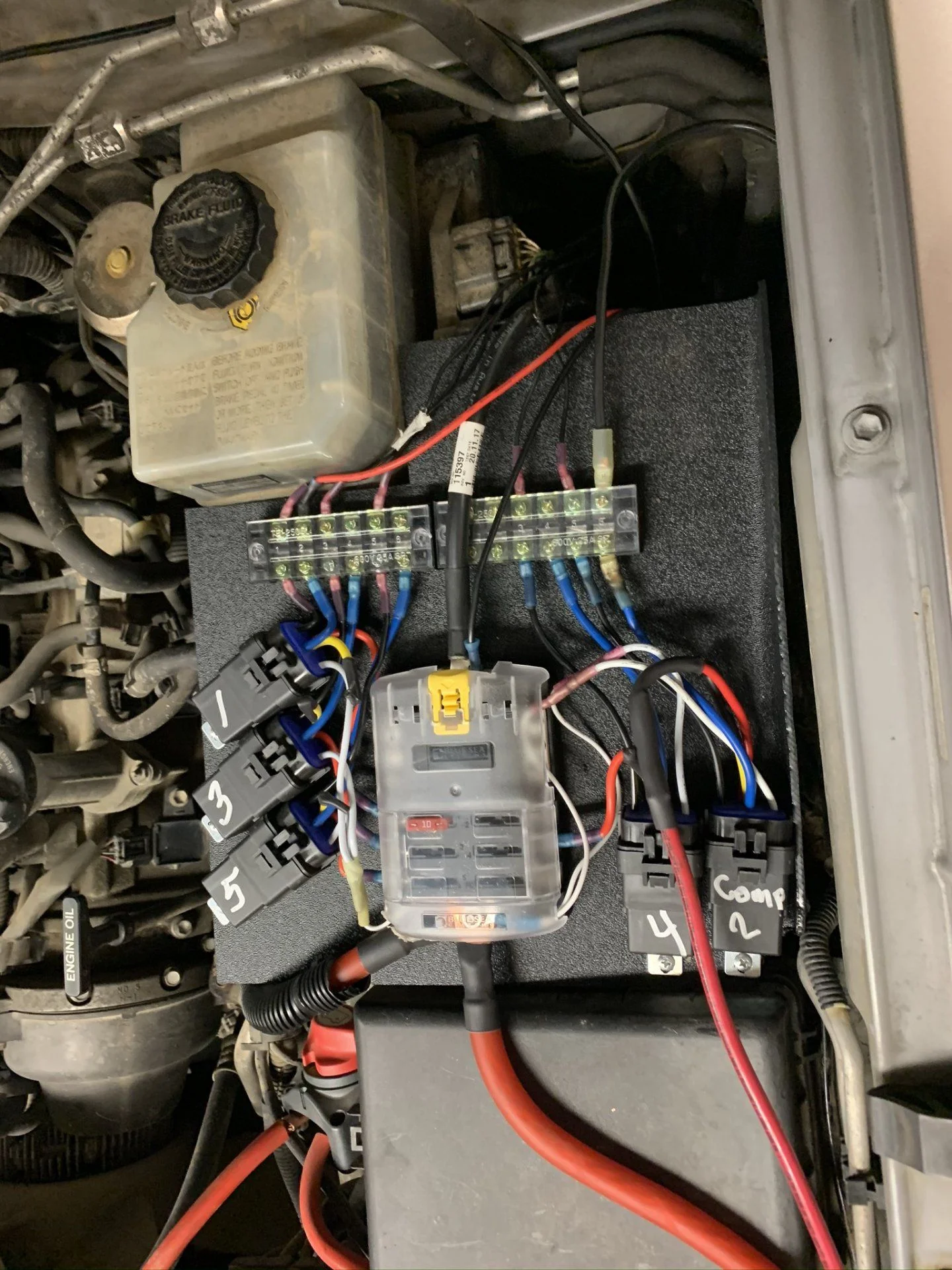

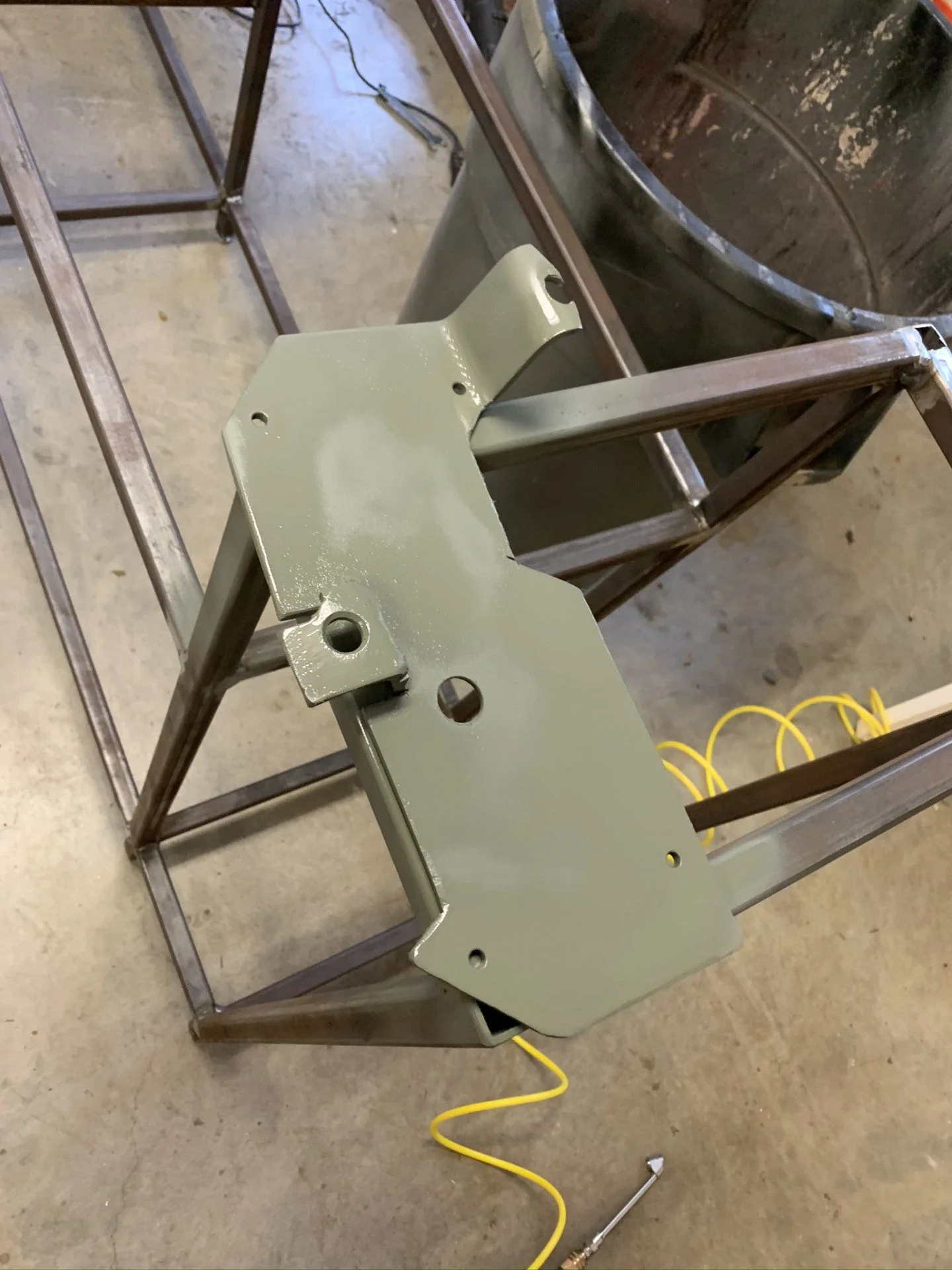

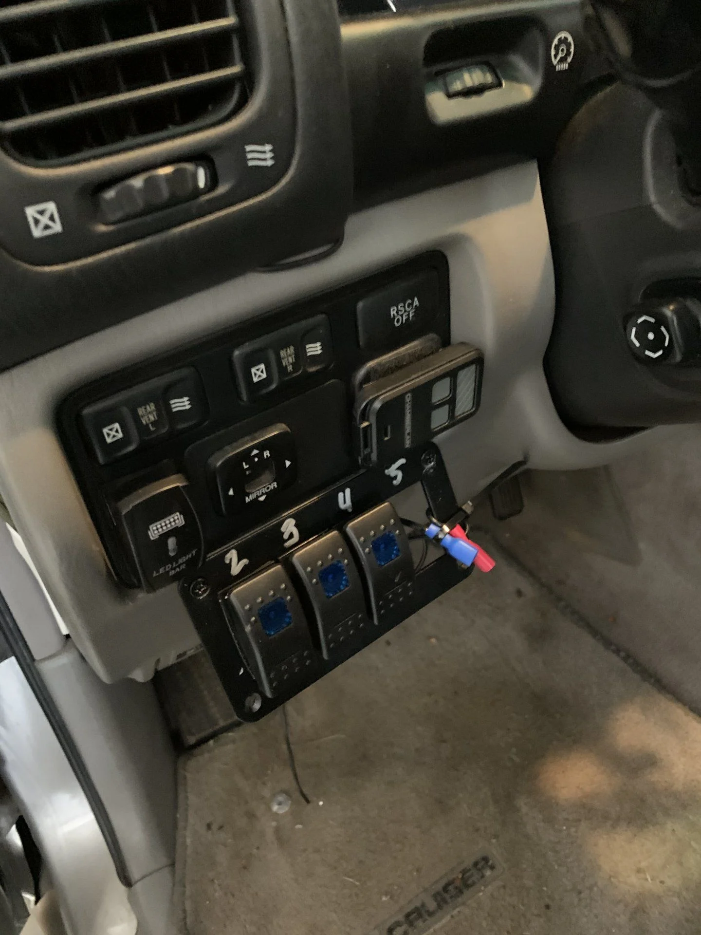

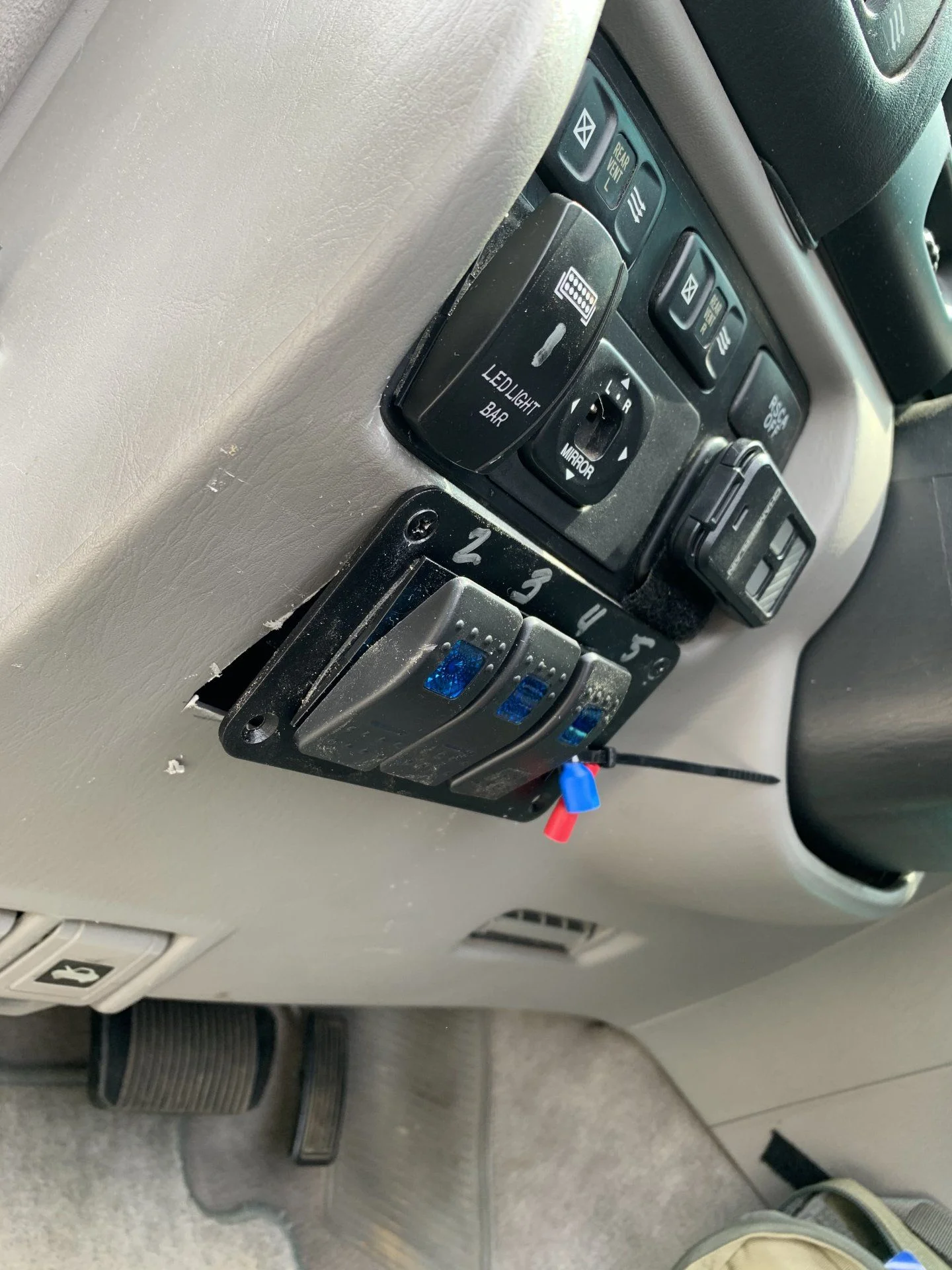

Finally have my electrical system sorted, decided against a dual battery system and went with a single set up with a dedicated powerline to the rear and a fuse panel/relay set up in the front. I will run the current battery until it fails and then get a dual purpose. Also installed a bulldog 41,000 air compressor, runs fairly quiet, I fabricated a custom mount from some mild steel I had laying around in the garage. Plan is to have an outlet on the outside of my rig for air and never open the hood. Five rocker switches in the cab to the left of the driver seat, only have negative leads running into those just to activate the relays. Only thing left to do is install the ham radio with a detachable face on it, body of radio will go where the compact disc changer was in the center console and the face will sit in front of the tape deck.
Rocker switches are not lit up when in use but I did add lighting under the dash to illuminate the footwell, 5th rocket is on the way. Comet helped me break the first rocker when trying to figure them out 😜 pics of the rear setup with fridge, added low level lights back there as well, round led light fir right in the hole where seatbelt used to be.

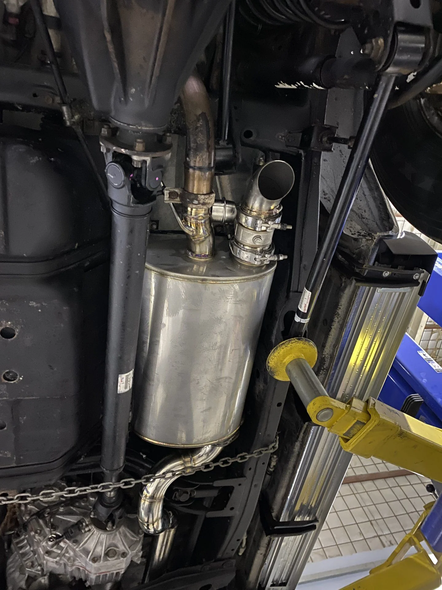

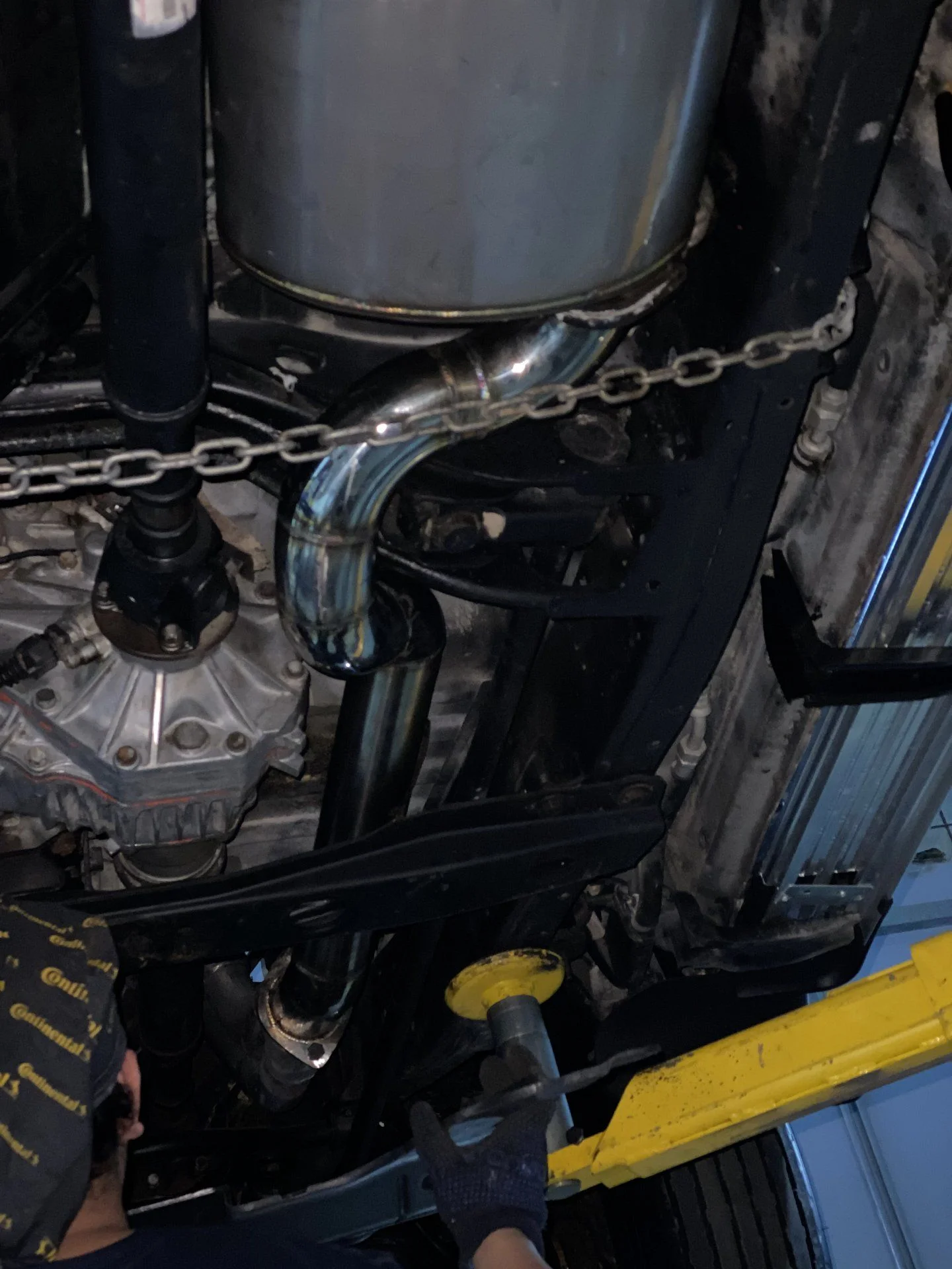

This week I finally installed headers and also an electronic muffler.
The headers are TRI Y 6-2-1, meaning maximum low-mid range torque boost as opposed to 6-1 headers which are for peak power. With stock engine internals not much of a difference though just sound.
Believe it or not, the 6-2-1 headers have a significantly different tone than the 6-1.
Headers have 1 5/8 Primaries and a 3-inch collector. The connecting pipe is also 3 inches, as well as the muffler.
I have it set up so when the muffler is opened it goes straight through without the resonator, when off it goes through the tailpipe resonator. The muffler is not straight through when closed, it sounds and flows similar to stock when closed.
Sound clips closed and open, in and outside cab tomorrow hopefully!.
