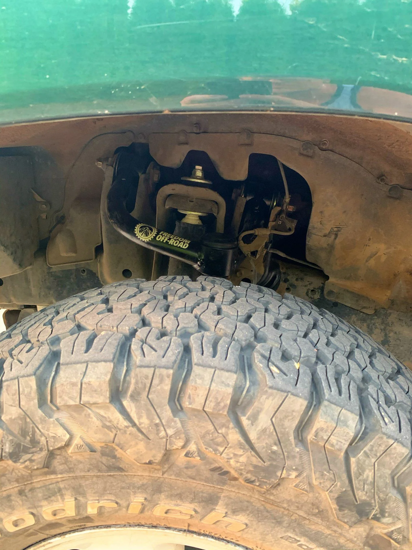

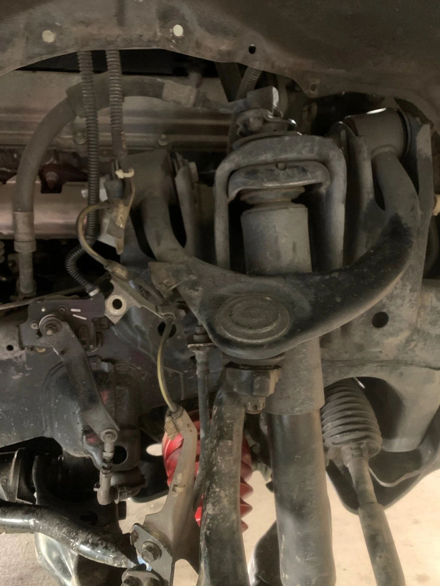

Just got done installing these Freedom Off-Road upper control arms, off to alignment tomorrow and then I can get some impressions. OE ball joints were completely shot and leaking.
Nice. You installed yourself? How long did that take you?
Yep! About an hour and a half. It's stupid easy. Jack up car, jack stand, support lower arm under floor jack, mark the camber bolts, remove (2) camber nuts, remove ball joint nut, break ball joint free with hammer, remove (2) camber bolts, remove upper control arm and reverse process.

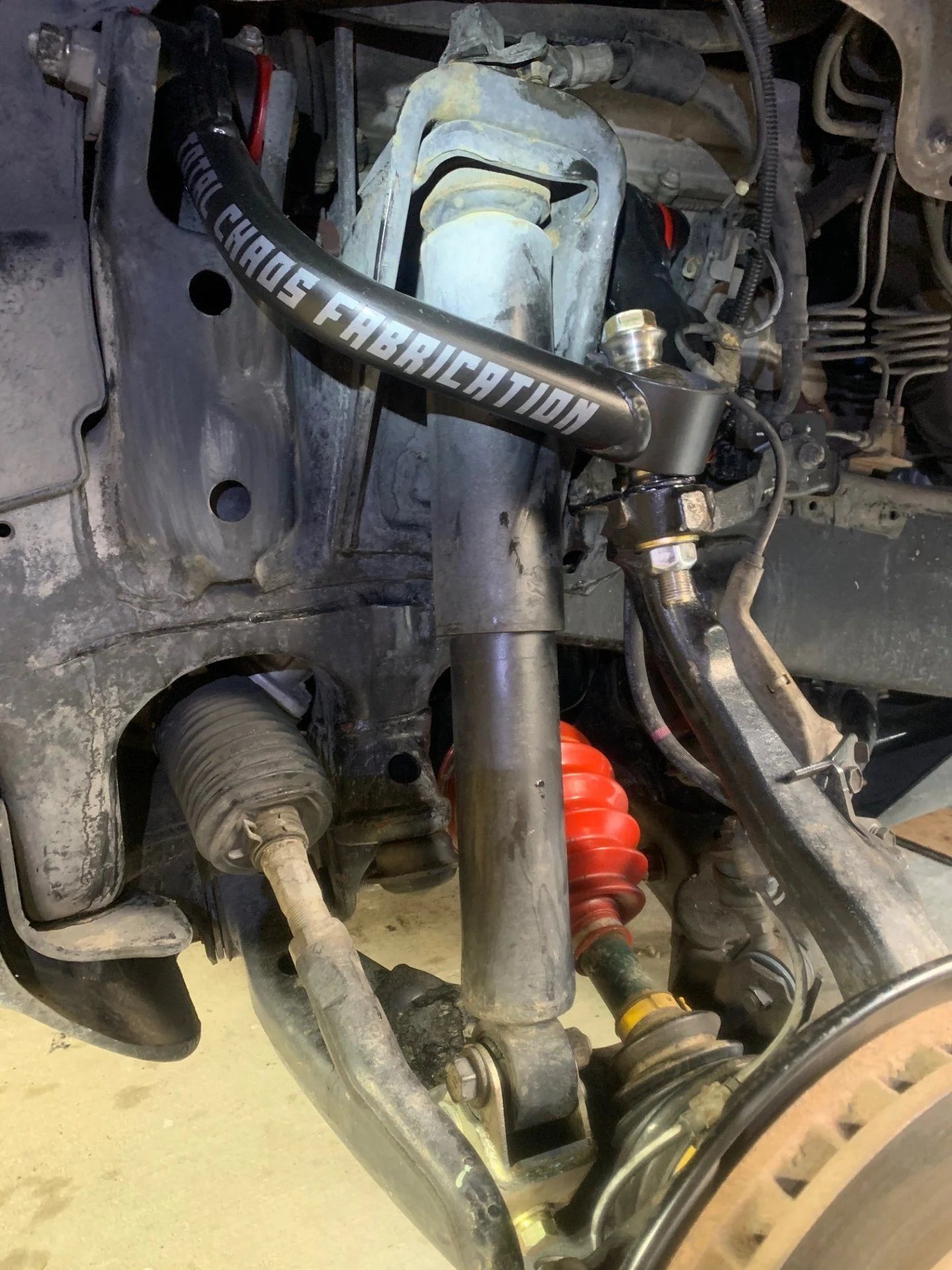

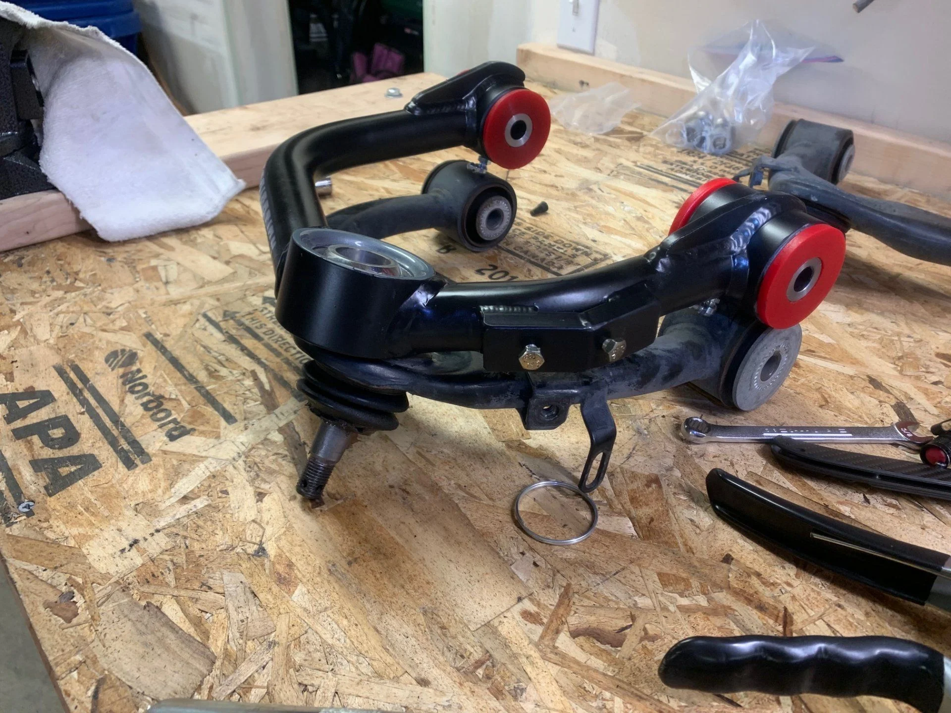

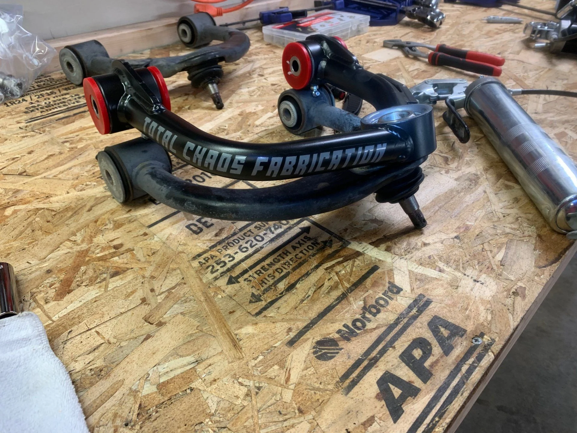

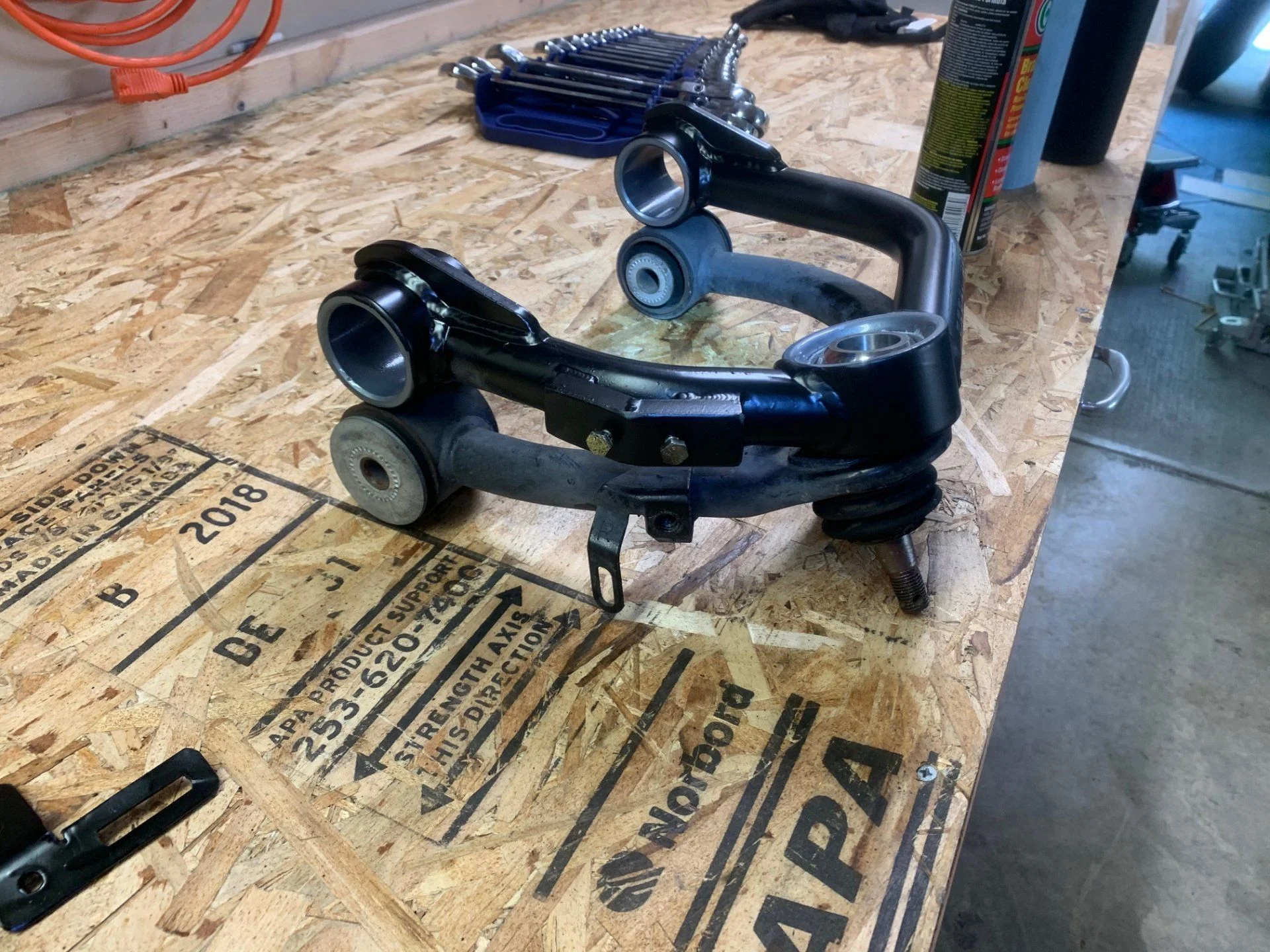

Finally installed my Total Chaos upper control arms (painted black). I had to weld a small piece of c-channel on the arm to mount my AHC adjuster to. I still need make some small changes, but they work and my AHC is happy. Best part is, if my AHC decides to crap out on me, all I need to do is unbolt the AHC adjuster off the arm and its ready to go.
Do these give you more travel with the AHC? Other benefits of upgrading?

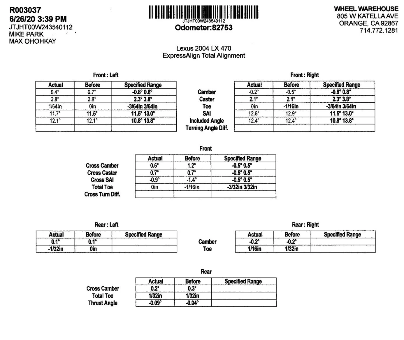

Can any alignment bosses tell me how this looks? I don’t understand why this wouldn't be any less than perfect with my new control arms on a 2.5” lift.
Can any alignment bosses tell me how this looks? I don’t understand why this wouldn't be any less than perfect with my new control arms on a 2.5” lift. View attachment 2408557
Looks like you should get a bit more caster on left front!
Wife dropped off the car but said the guy was struggling to adjust the left without it moving the right side? I don’t know what he’s talking about.

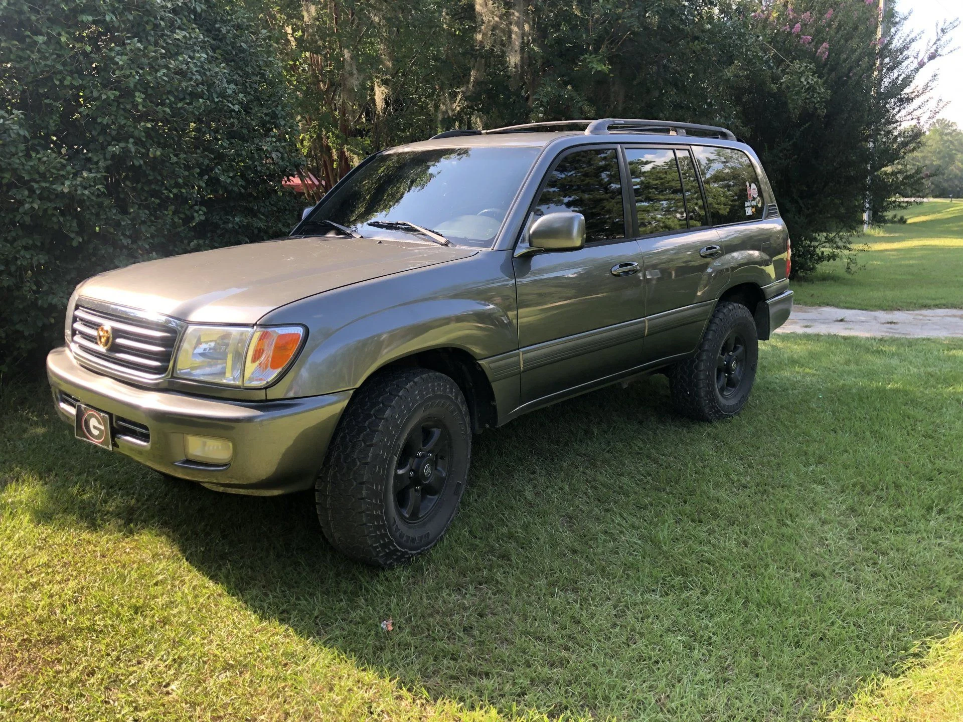

I just finished the build on this 2000 Land Cruiser. Deflared, removed all body trip, and repainted in Desert Dune. Level III SecondSkin soundproofing. Dobinson 1.5” lift and torsion bars. Nitto ridge grapplers on Toyota TRD BBS wheels. Prinsu rack. Sweeeeeeet! She’s beautiful. I am biased. She’s still beautiful.
Beautiful rig, it's amazing how much cleaner they look without the trim! PITA to do the work but worth it!!!!
Everything is within OEM range, except that left caster. Maybe it's an inexperience tech? Not sure...
What's your concern other than the caster?
Here's mine for reference
Just wanted to confirm I wasn’t out too much and how close I am to spec. Thanks for sharing this!
