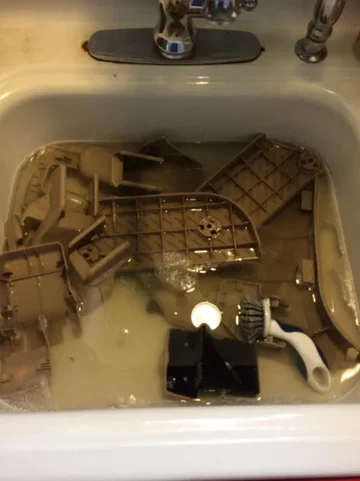

Had a big day today.... finished a complete clay bar/swirl remover/glaze/wax on the entire car, including jambs. Also got the interior completely torn out and started getting everything cleaned up.

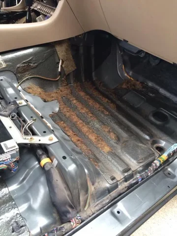

What are you using for sound deadening? Phil from the VTOWR here, did you ever find the source of you leak?
I was planning on buying from Don @ SoundDeadenershowdown.com I had used and referenced his site many times in the past. Unfortunately he has been super slow to respond to emails, so I will likely use RAAMaudio products. The water in the pass footwell was actually from a missing rubber plug on the footwell floor. I went home after VT ORW and doubled checked that both the sunroof drains and AC condensate drain lines were clear and they were. I was pretty stumped, luckily pulled out the carpet and found the offending missing piece. Pretty sure the rain on the drive up Thursday, along with the mud puddles and water crossing while out on the trail Friday just caused the water to splash up and wet that area. This isn't the greatest photo, but it's the silver-dollar-sized hole right near the wiring loom.

You can also see most of the interior has been removed for a thorough cleaning and to run CB and new radio/amp/speaker wiring. Might even get a wild hair up my arse and do some extra sound deadening.
