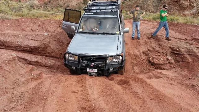

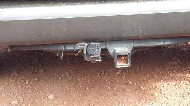

Tps install went well and the rig runs good after fiddling with the adjustment some. No fsm no feeler gauge to adjust. Spent 8 hours out on Onion Creek Trail off of the 128. Awesome day, beautiful scenery amazing views. My 100 got her first real trail carnage. All good!

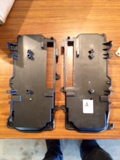

Surprising Find - Aus Spec LX470 Cabin Air Filter Retrofit
Well with the good help of Beno and Mike Gordon I got the retrofit kit to put cabin air filters on my Australian LX470.
First issue: the evaporator housing is "handed" (e.g. RH drive cars get the filter on the left; LD drive on the right).
So the cover I got shipped out from the US is a reflection of what I need!
So I pulled the old one and got into it with my little cuts anything tool and hand-crafted the opening in the cover. Nice. No problems (famous last words).
Then I go to fit the filters and I find that the space for the filter is half the depth of the US spec evaporator housing - duh!
Given I'm now committed to the small cover anyway, I decided to cut the filters to size... although one wonders if it may be constraining the air flow a little now - I can always take them out again easily if any issues arise.
It seems not only did Toyota for some reason think that Australia is less dusty than the US (What were they thinking!!! Kimberley bulldust can only be compared to the remotest Africa in my experience!), they also didn't even seem to make it possible to fit the full length filters!
All's well that ends well!
